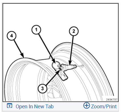

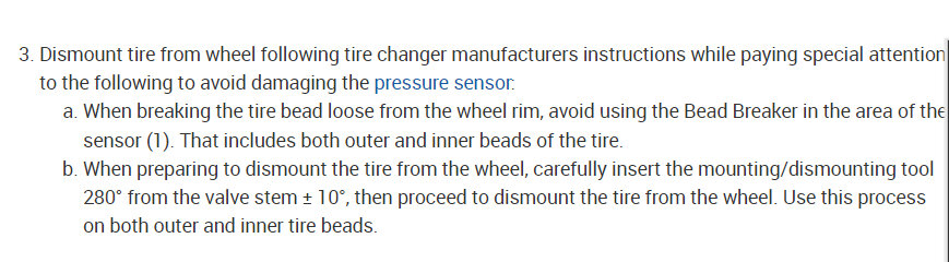

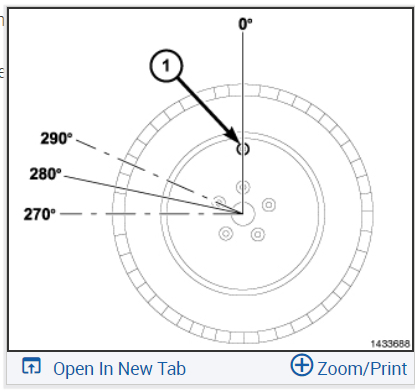

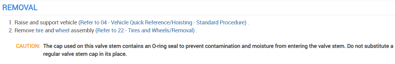

Did the problem happen on the same road before the tires? Electromagnetic Interference (EMI): Certain areas with high electromagnetic interference, such as near large power lines, radio towers, or specific industrial equipment. If not, then the sensors could have got damaged when the tires were installed which is common. The problem is for just one tire, correct? If so, chances are the sensor is bad. Here is information on the tires pressure sensors. Check out the images (below). Please let us know what happens.
