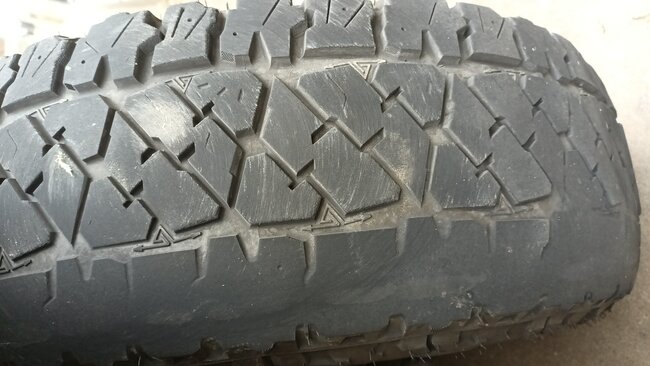

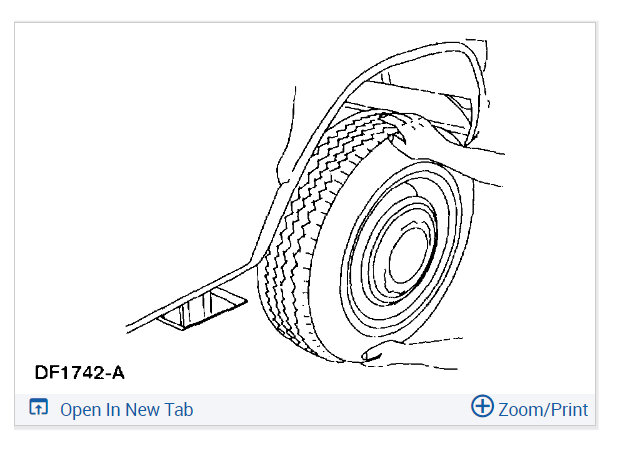

That tire looks like it is coming apart internally, but it could be caused by a bad wheel bearing hub which can cause the ABS light to come on as well. Here is how to check it out and if it looks okay, I would do a wheel alignment:

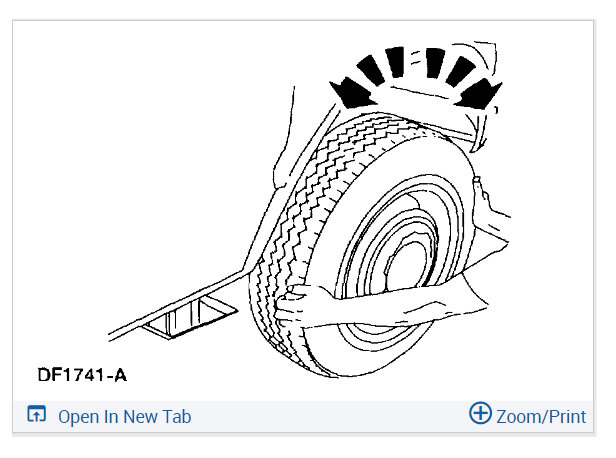

1. Raise the vehicle until the front tires are off the floor.
Make sure the wheels are in a straight forward position.
WARNING: The electrical power to the air suspension system must be shut off prior to hoisting, jacking or towing an air suspension vehicle. This can be accomplished by turning off the air suspension switch. Failure to do so can result in unexpected inflation or deflation of the air springs, which can result in shifting of the vehicle during these operations.
2. Spin the tire by hand to cheek the wheel bearings for roughness.
NOTE: Make sure the wheel rotates freely and that the brake pads are retraced sufficiently to allow free movement of the tire and wheel assembly.

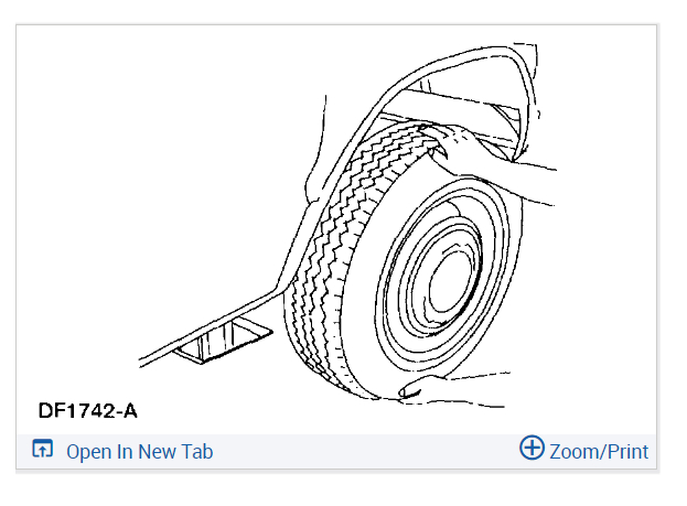

3. Grip each front tire at the top and bottom and move the wheel inward and outward while lifting the weight of the tire off the front wheel bearing.
4. If the tire and wheel (hub) is loose on the spindle, does not rotate freely, or has a rough feeling when spun, carry out one of the following:

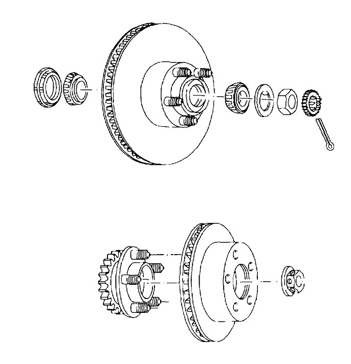

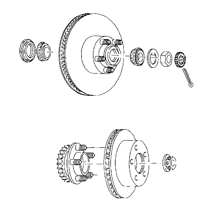

On vehicles with inner and outer bearings, inspect the bearings and cups for wear or damage. Adjust or install new bearings and cups as necessary.
On vehicles with one sealed bearing, install a new wheel hub. Refer to the service procedures.
