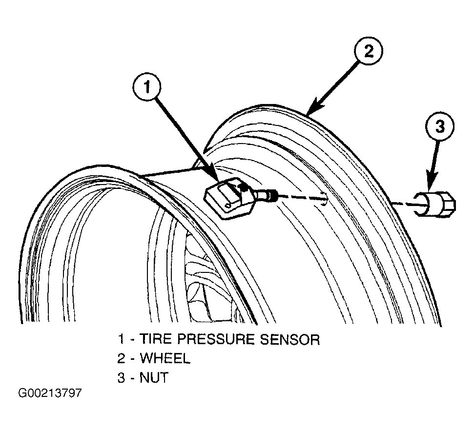

First, if you live in an area where the temperature drops overnight, it isn't uncommon for the light to come on. Air contracts when it gets cold, so the pressure lowers. That is a common issue. However, the sensor that is indicating 0 psi is a different issue. I will tell you that each sensor (total 4) have a battery inside them. The battery will usually last between five and eight years before it fails. So, that is a possible issue. Or, the sensor is just going bad.
I own a tool that checks for a signal from each sensor, so when I have an issue, I simply walk around the vehicle checking each wheel. When checking, I know if the sensor is working, the battery condition, tire temperature. That makes it easy, but most likely you don't have such a tool.
So, there is a good chance one of the sensors is failing. Therefore, you need to have the system checked to determine which one it is that causes the problem. Then, it will need replaced. To replace it, the tire will need removed and dismounted from the wheel. Then, the sensor can be removed from the wheel. The valve stem is actually part of the sensor on your vehicle. I attached a picture of the sensor's location in the wheel.
