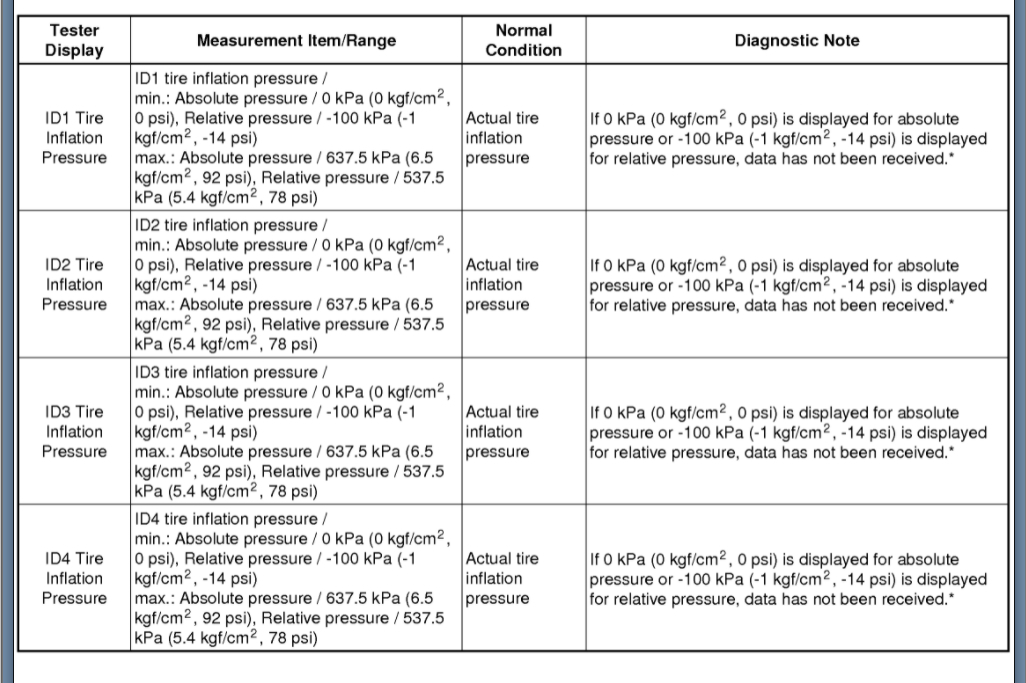

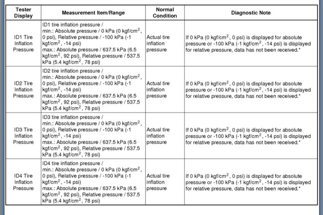

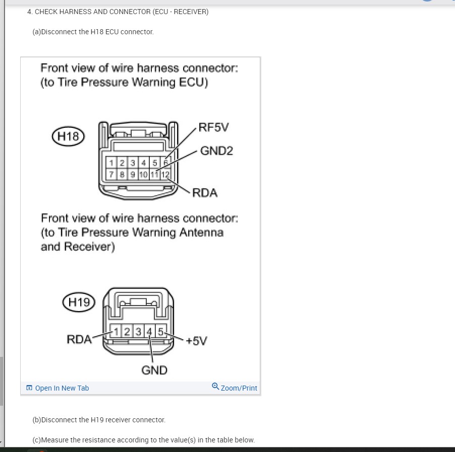

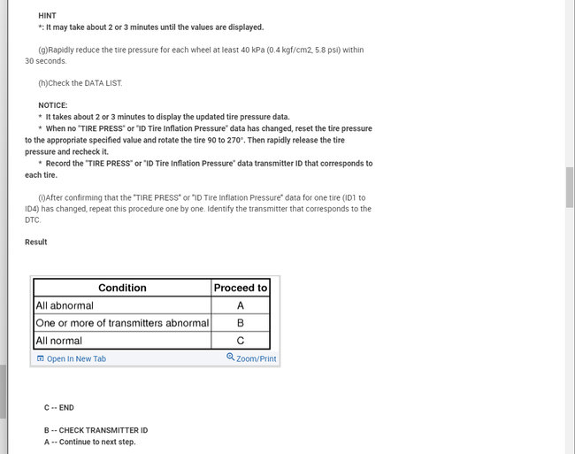

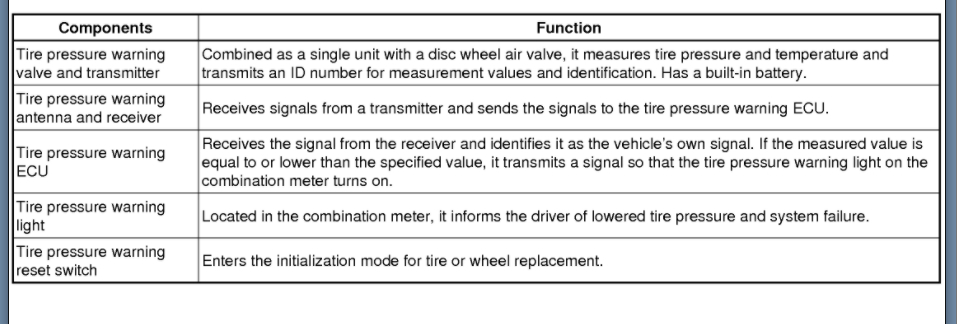

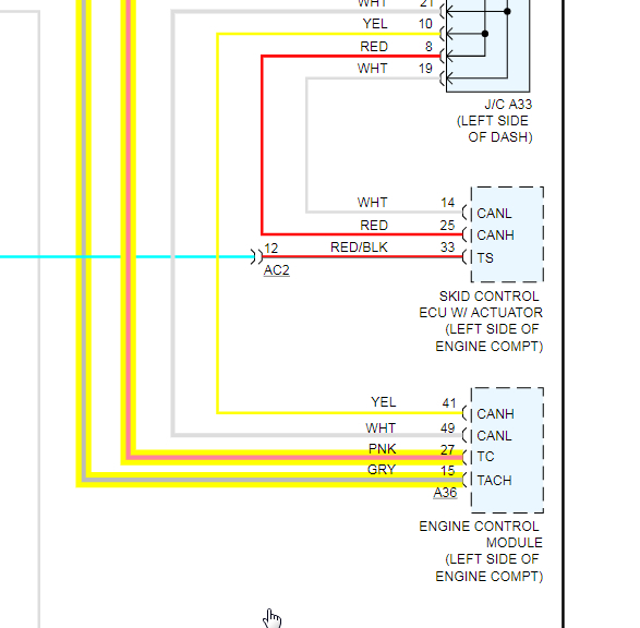

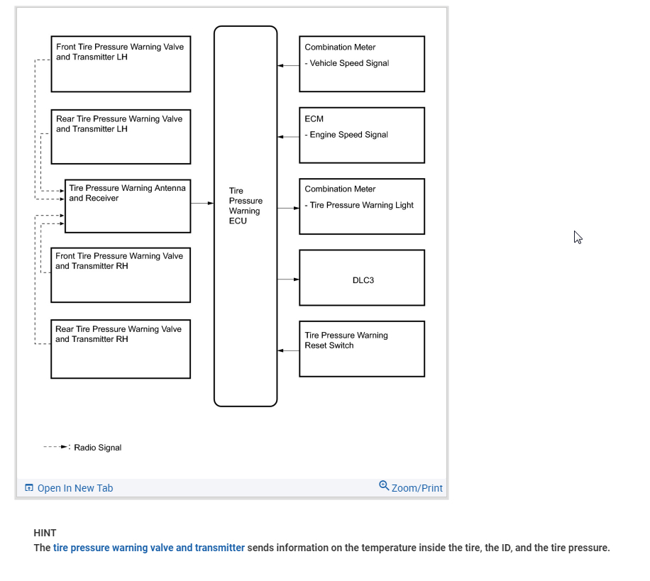

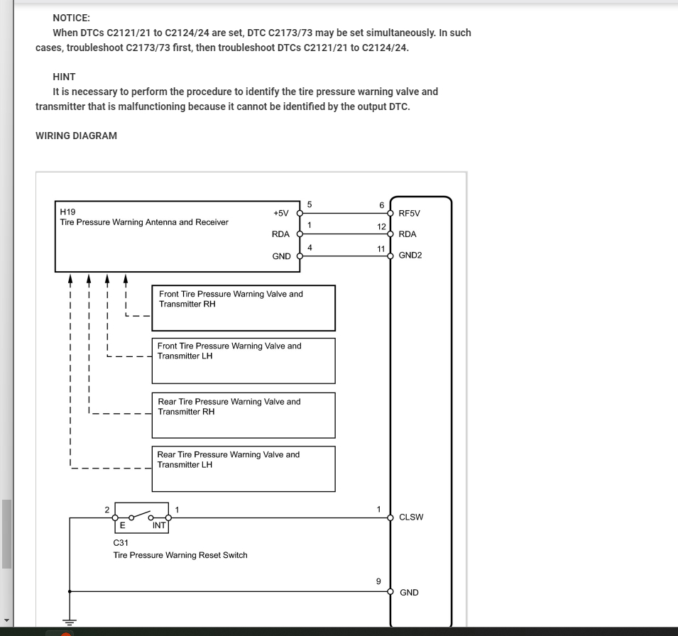

I have the tire pressure light flashing. Assuming I have 4 good sensors, is there something I can do to reset the car's computer to the pressure sensors? I am just looking for simple things I can do to reset the flashing light and see if that fixes the problem before I have to take tires off the rims etc.2001 Scion XB with TRD rims. I recently bought the car and it wasn't flashing when I bought it and prior to selling it the seller changed the two front tires.I'm sorry but my car is actually an XB not an XD.
