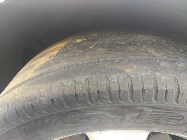

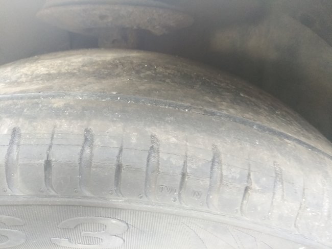

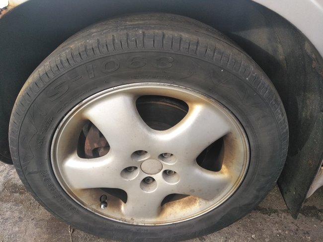

Hello, i actually went outside today and had not checked all the tires yesterday! And clear as day i think i may have found the corporate. But not quite understanding as to why the tire would do this! Will post what pictures and video in second.
Jan 28, 2018 at 12:19 PM
HARRY P
  • 2,292 POSTS
Yeah the tread is low on that tire, which made it a little weak. When you hit the bump, it appears that was enough force to break one of the aforementioned steel belts, which made your car ride badly. To confirm, put the spare on and take it for a ride.
