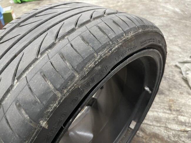

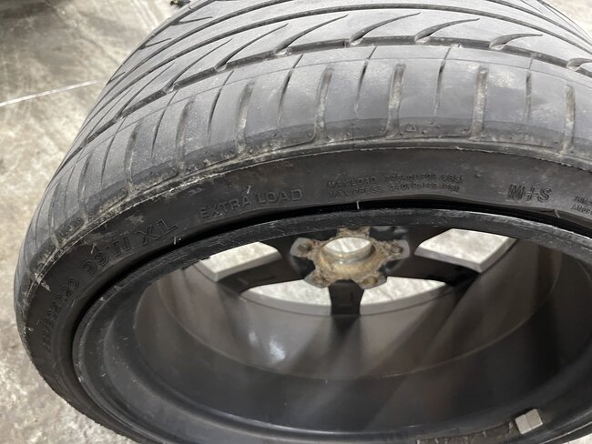

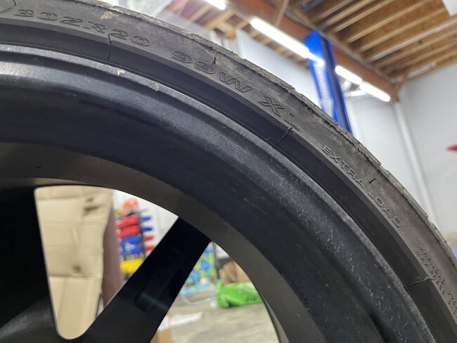

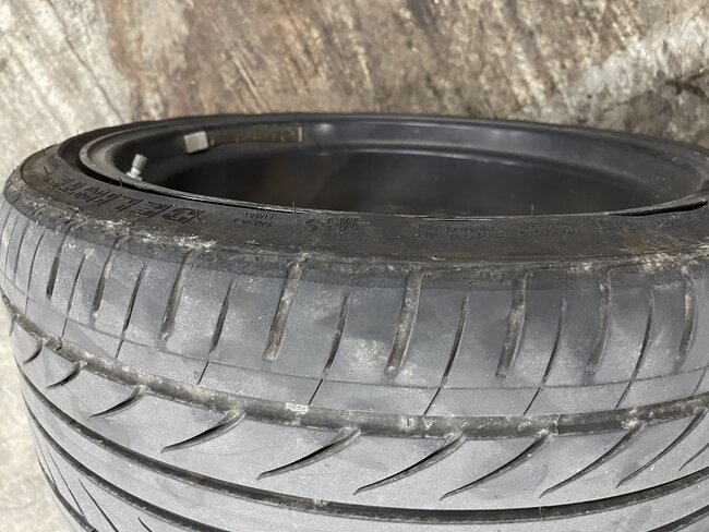

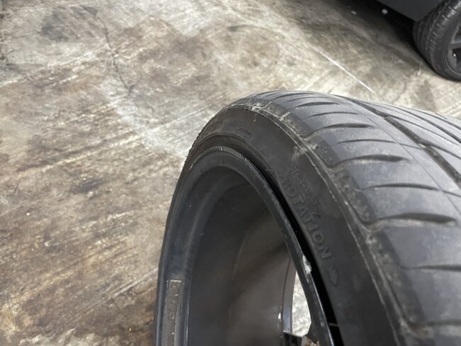

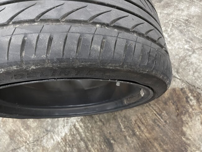

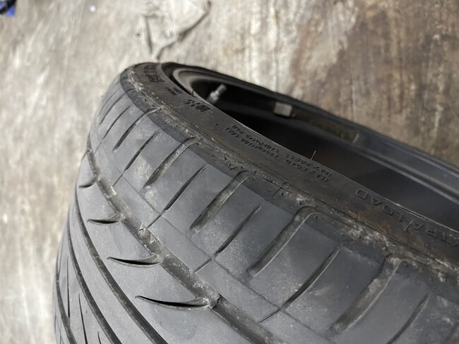

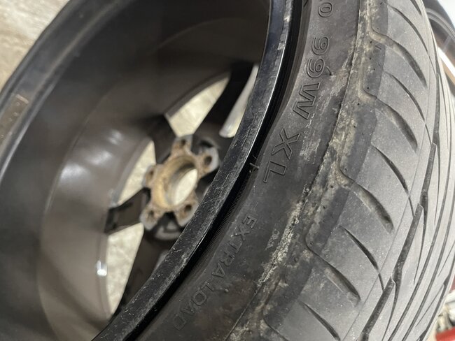

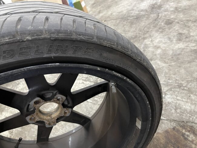

Does this look like a bad tire to you? It has aftermarket wheels and there is a harsh vibration, turned out ine if the wheels had a bad crack, replaced it and gotten better. Now I just balanced all 3 wheels and this last one on rear looks weird, do you see the inside of the tire?
I sent many pictures to give you different angles.
Aug 27, 2023 at 6:50 PM
If there is air in the tire, then I would replace it. It appears to have belt separation.
Belt separation in a car tire refers to the condition where the layers of belts within the tire's construction start to separate from each other.
This can cause vibration, a loss of structural integrity, and can lead to a blow-out. So, if the tire is fully inflated in the pictures, I recommend replacing it.
Let me know if that helps or if you have other questions.

Yes, fully inflated.

Something is definitely failing in the tire. It's likely related to a belt issue. If it was my vehicle or if you were my customer, I would recommend a replacement.
When the belts shift or become damaged, the tire will lose its structural integrity. That could lead to a blowout. That isn't something you want to happen at any speed, especially at highway speeds.
Let me know your thoughts or if there is anything I can do to help.
