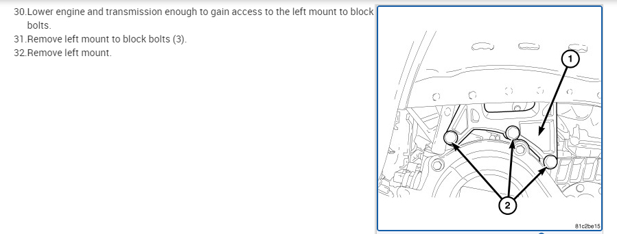

I need to change the transmission of the vehicle listed above SXT. Is there something tips or not to do specific for that vehicle? I already did some similar jobs for manual car manual and on some Ford and Hyundai and Mitsubishi but never on a Dodge Caravan or automatic transmission, so I would need some what do not and to do for that vehicle thank you for everything.

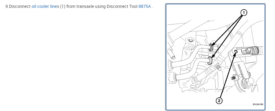

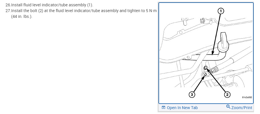

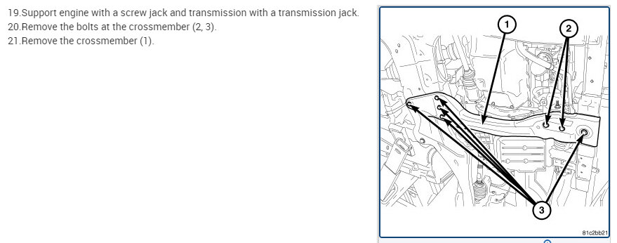

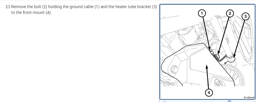

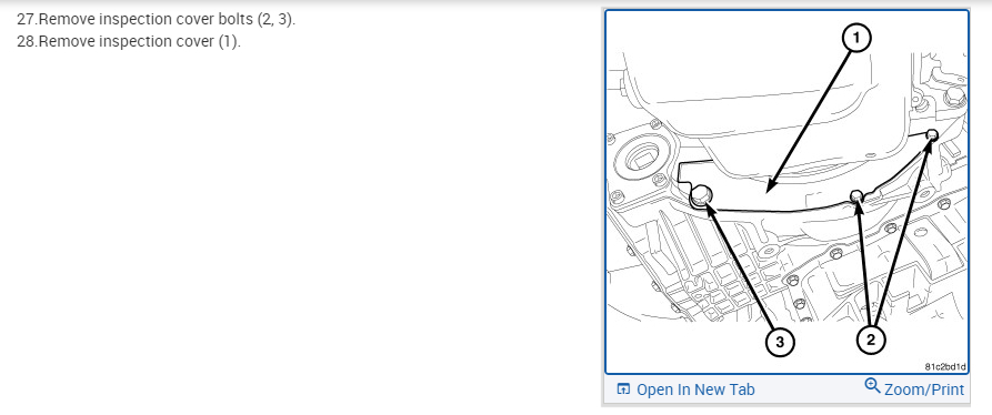

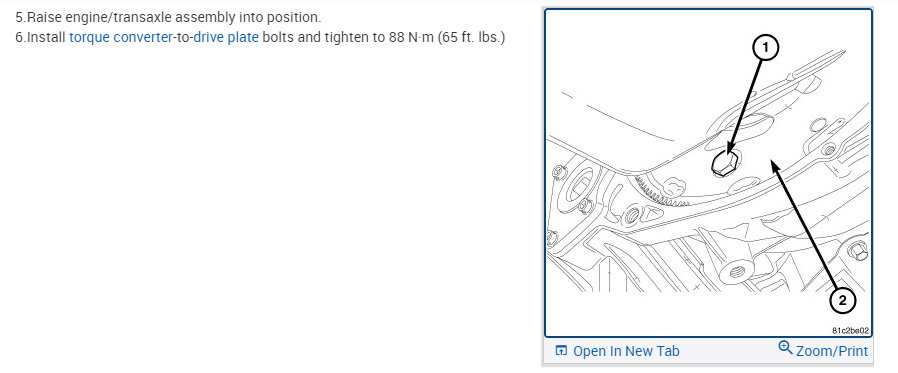

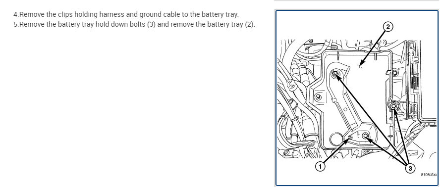

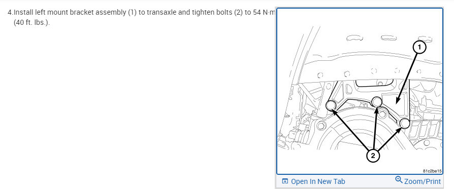

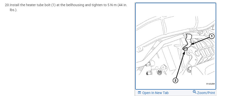

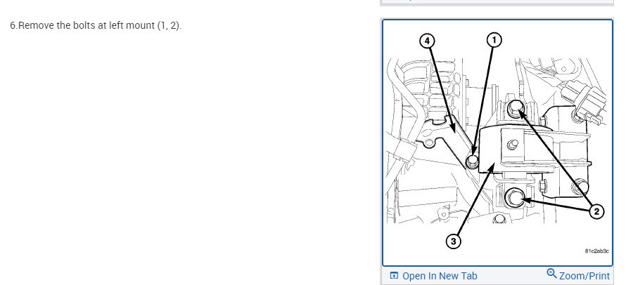

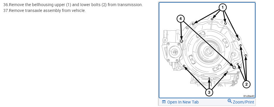

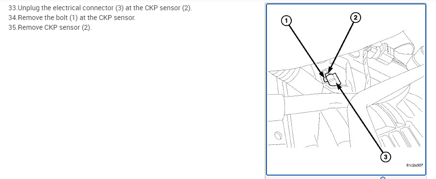

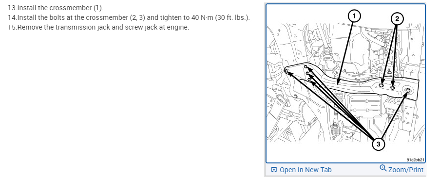

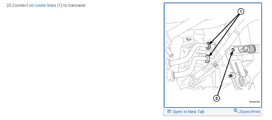

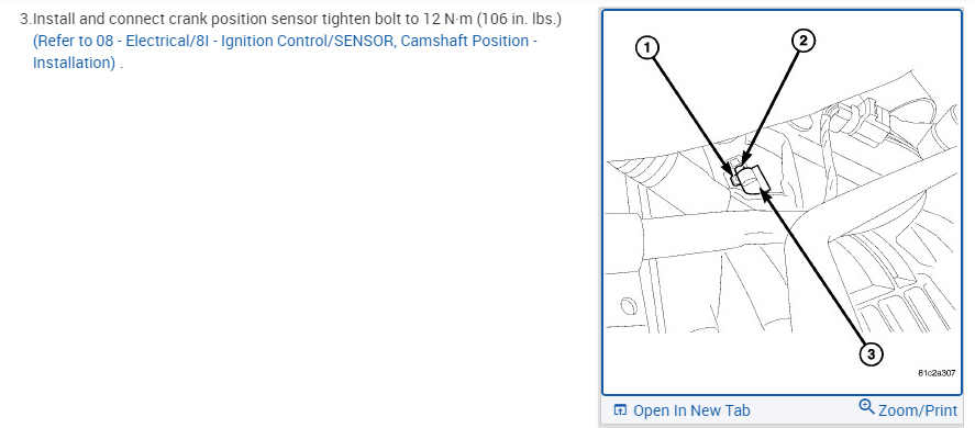

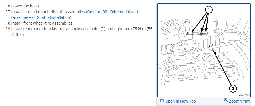

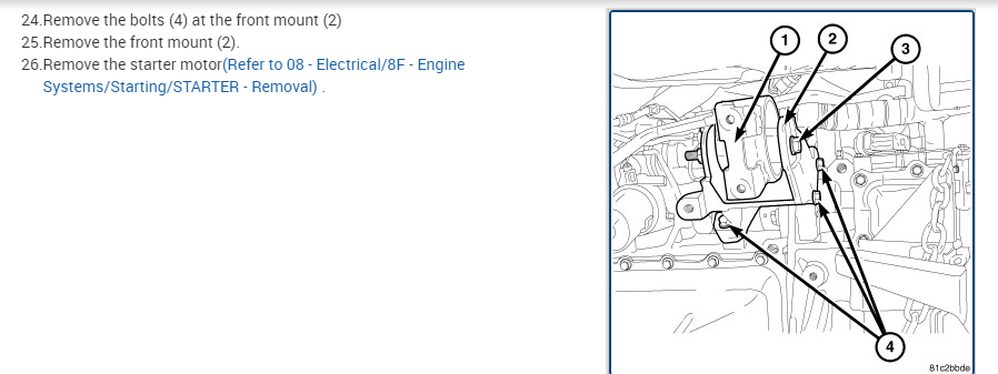

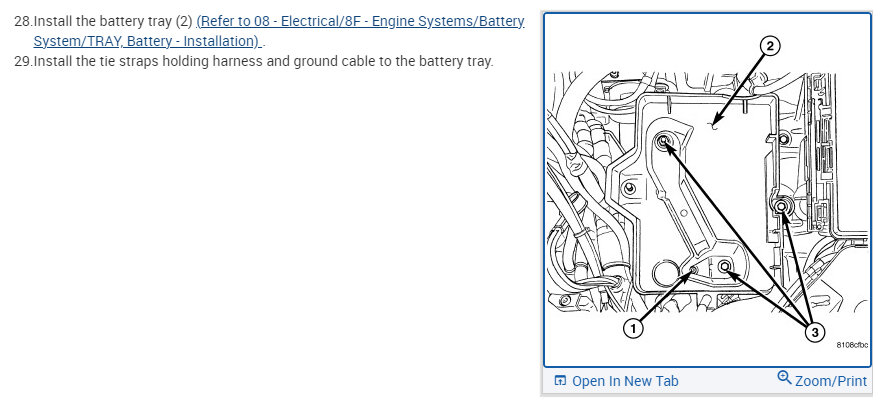

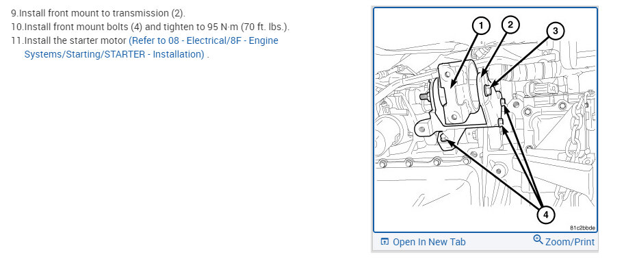

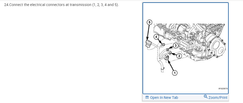

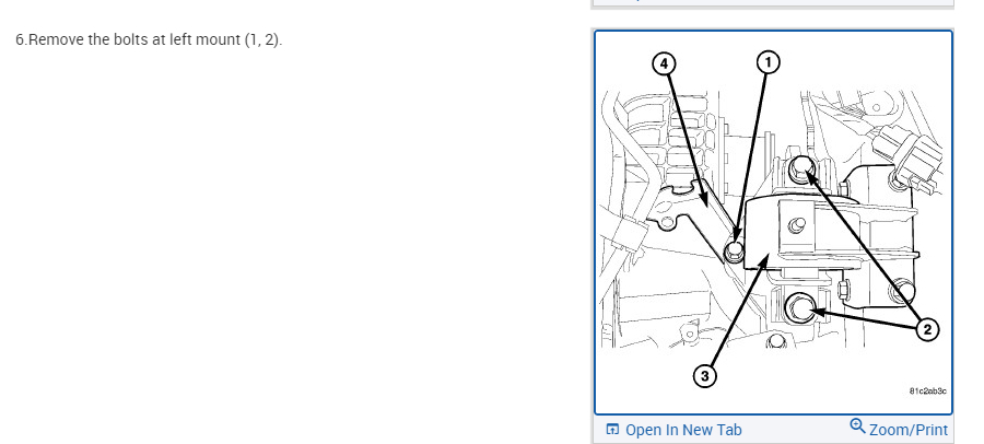

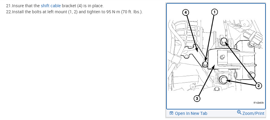

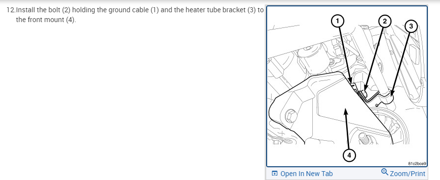

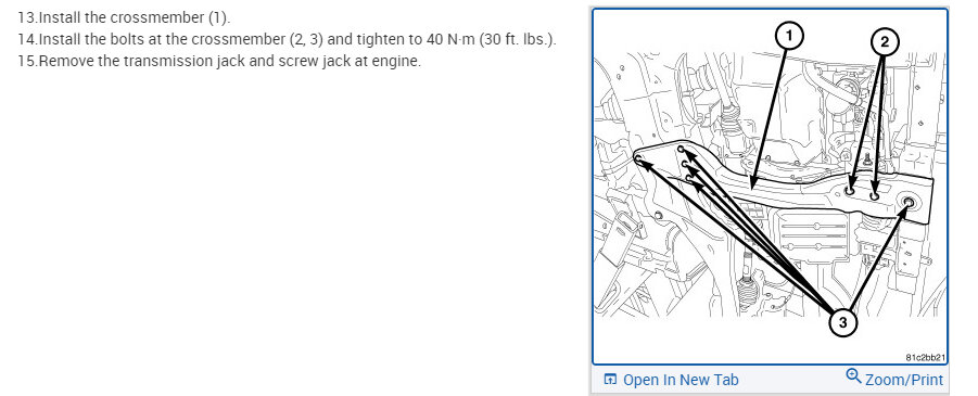

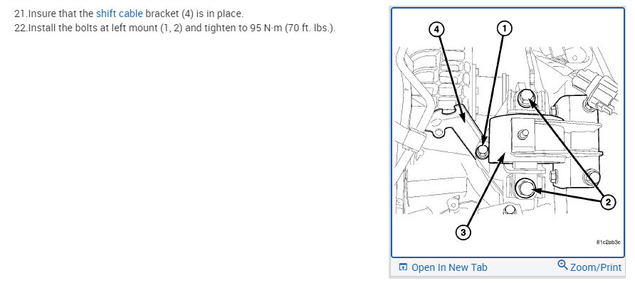

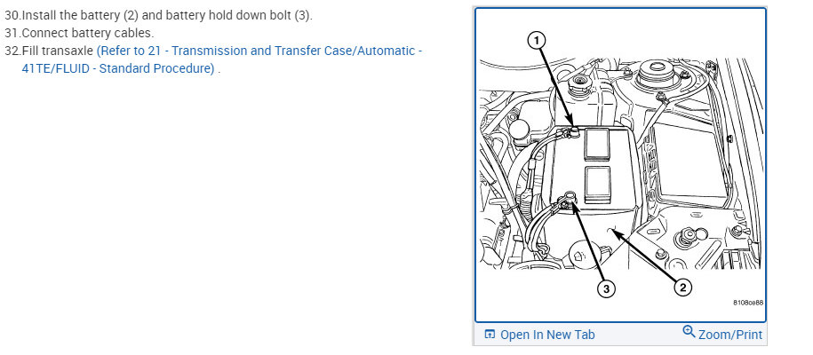

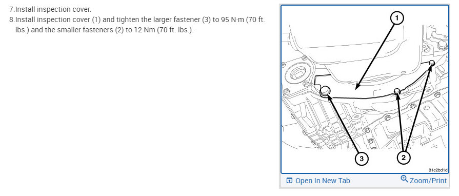

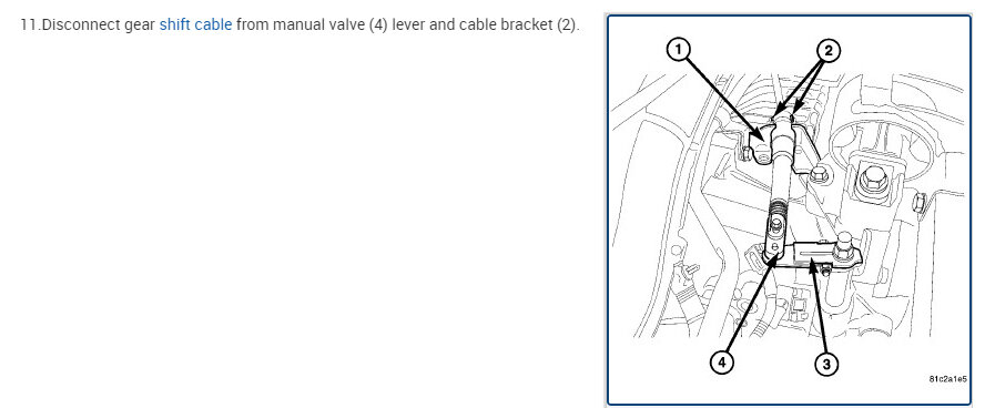

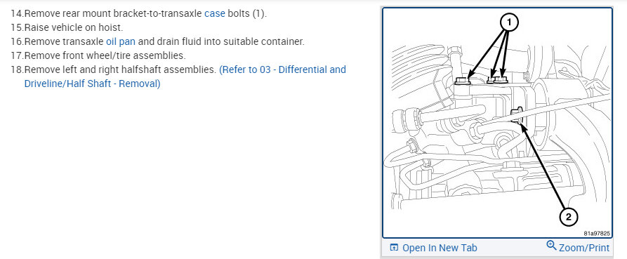

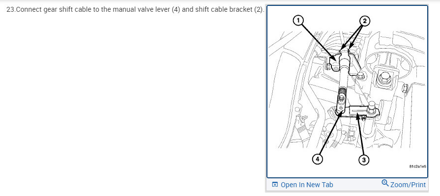

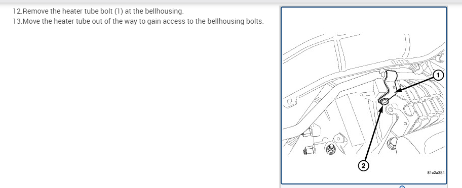

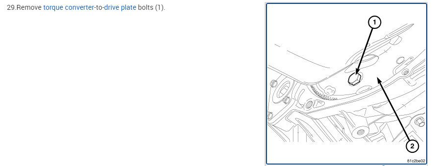

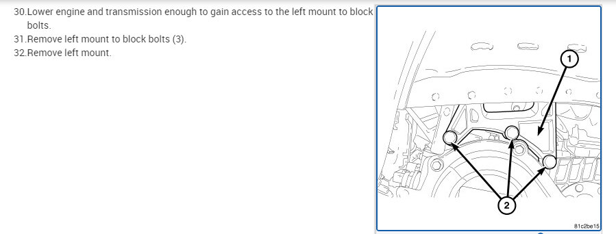

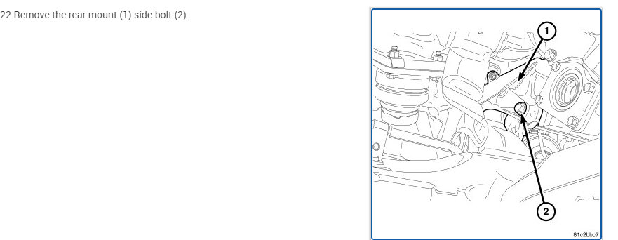

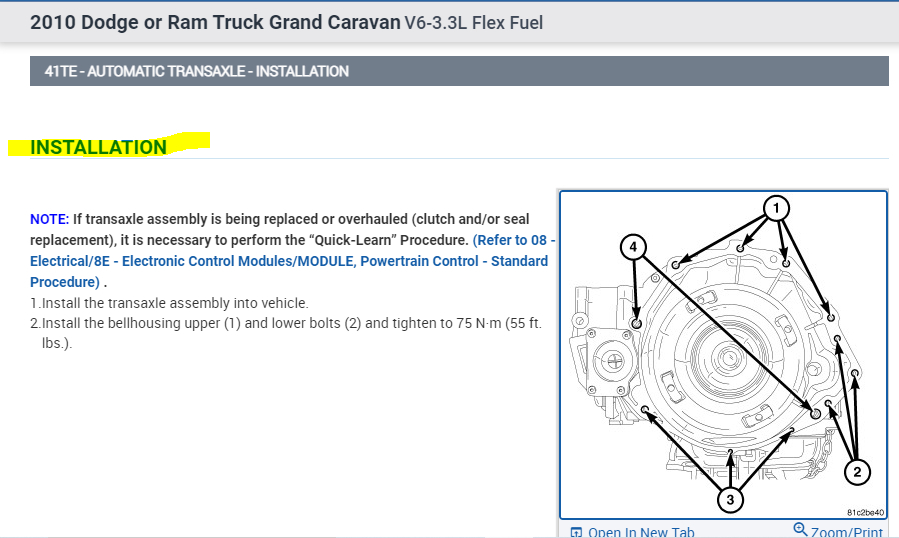

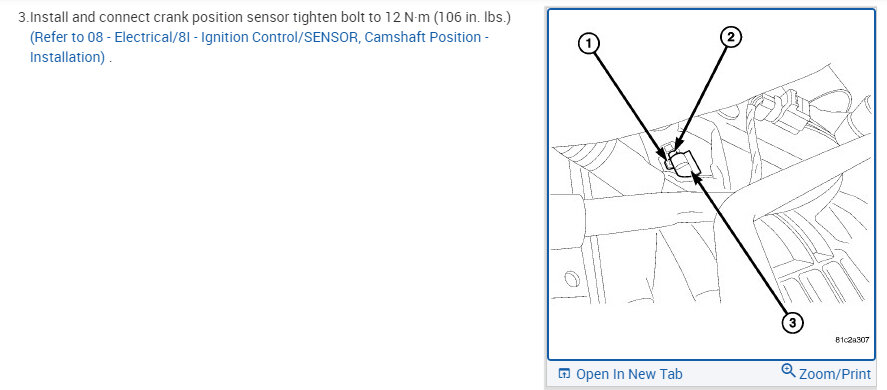

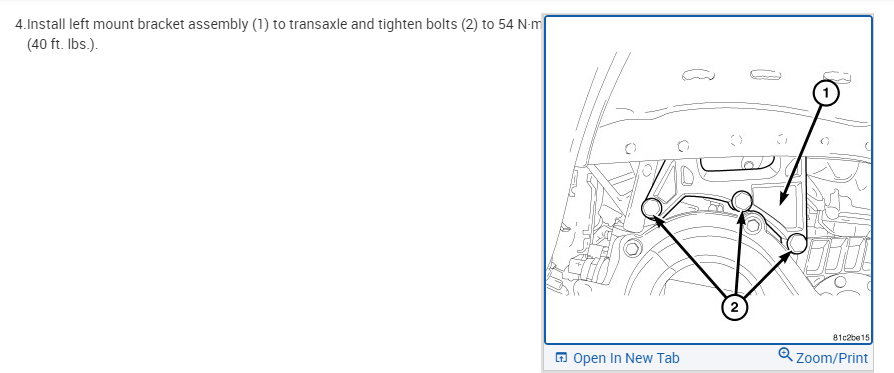

It really isn't too much different than what you have already done. The one thing to keep in mind is you will need to lower the engine enough to access and remove a mount to the engine block. Other than that, you will remove the transmission separately.

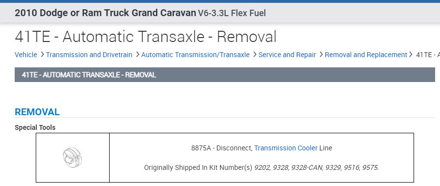

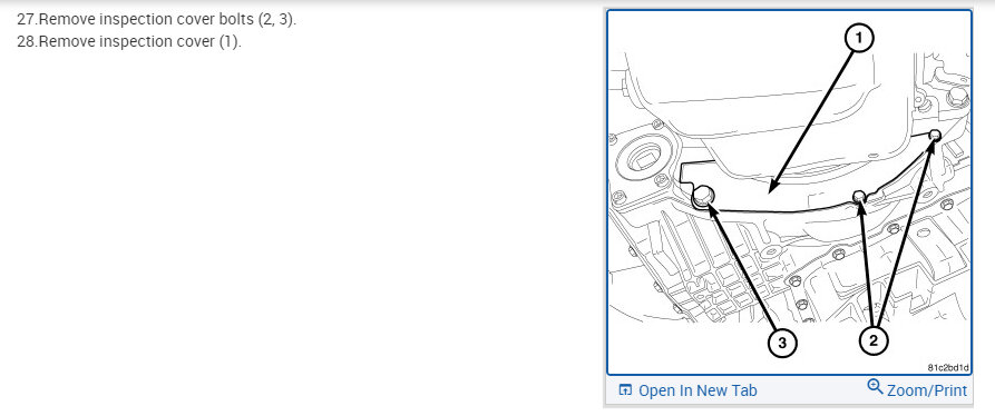

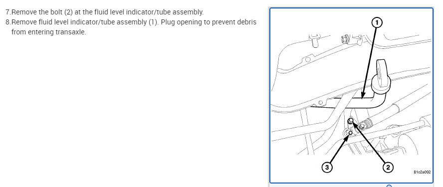

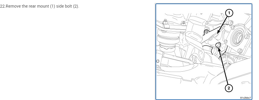

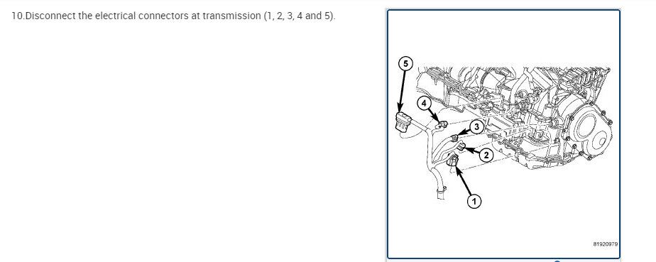

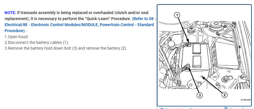

I attached the directions below for the removal and installation. Take a look through them and let me know if you have questions.
See pics below.
