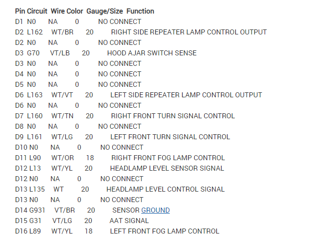

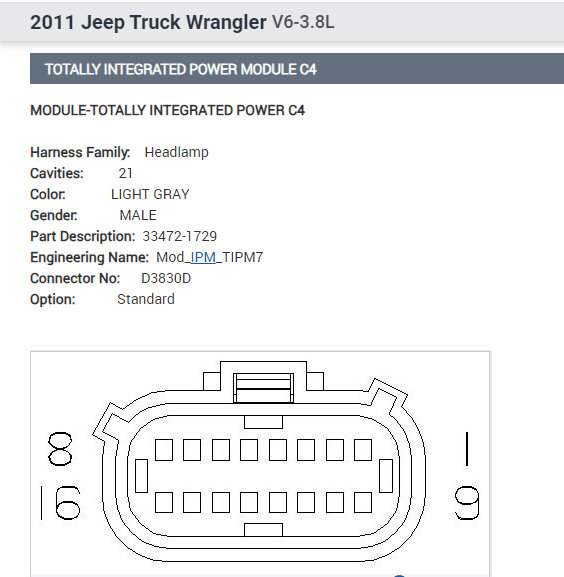

Thank you for taking the time to read this. Looking for a diagram of the pin out locations for the c4 connector and wire color's locations for pin 1 through 16for 2011 Jeep jku.
Thank you for your time.
Jan 24, 2024 at 7:00 PM
Happy to help. If you look below, the first pic is the connector view. The second picture is what each pin is used for. Note: From experience, inspect the pins closely in both ends of the connector. They can show power and then fail when under a load.
See pics below.
