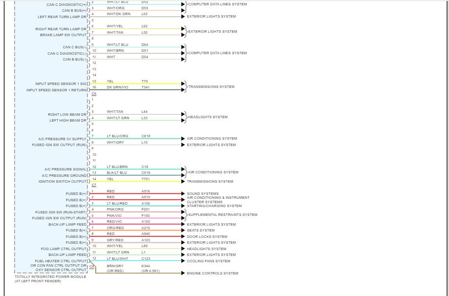

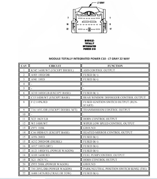

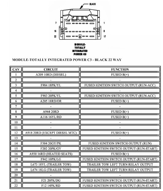

Looking for the diagram that shows the wiring diagram for the plug-in connectors on the back of the TIPM. Had a few connection issues and replaced the plugs and some of the pin connections and I think I may have 1 or 2 in the wrong spot. (I removed each wire and put them directly into the new plug one by one after cleaning or replacing the pin). But I may have put 1 or two of them in the wrong slot on the plugs as I am having new issues.
Dec 27, 2022 at 1:05 PM

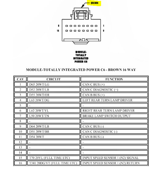

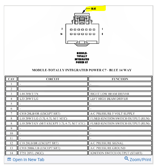

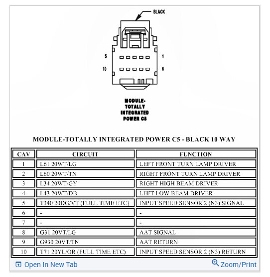

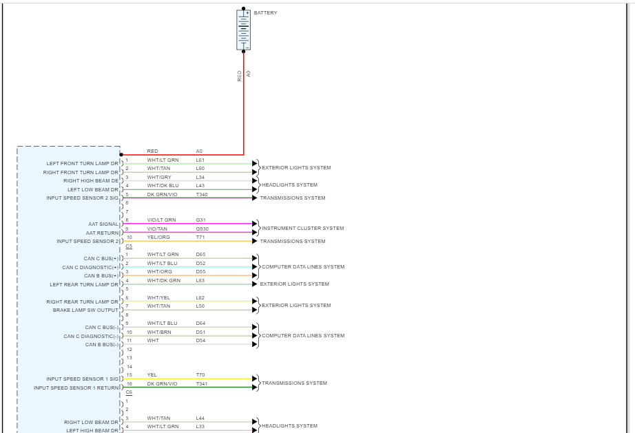

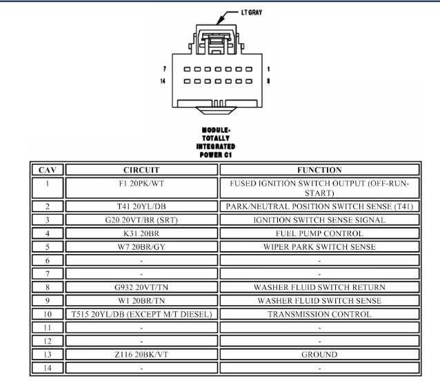

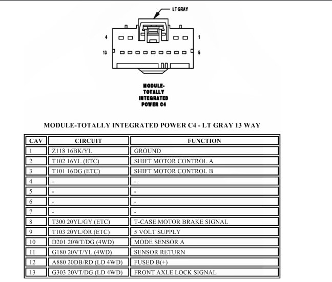

These things can be interesting to work on. I've seen so many fail.

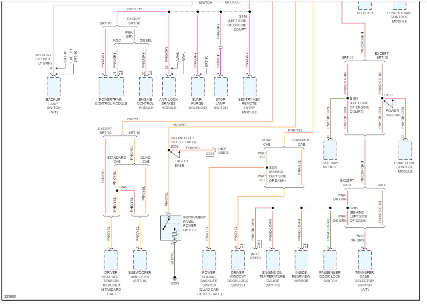

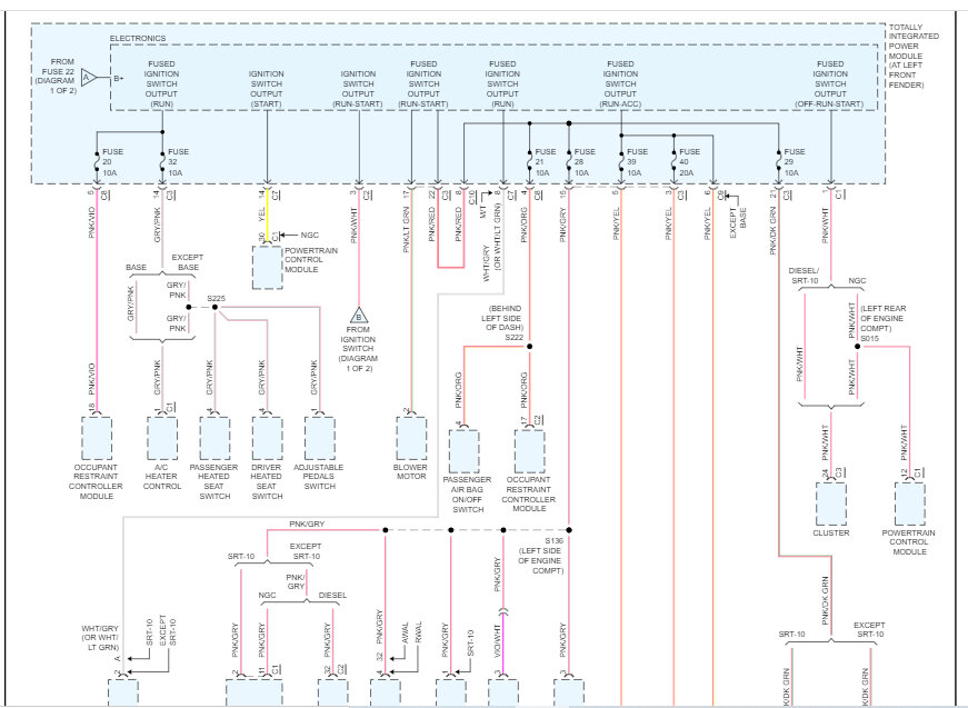

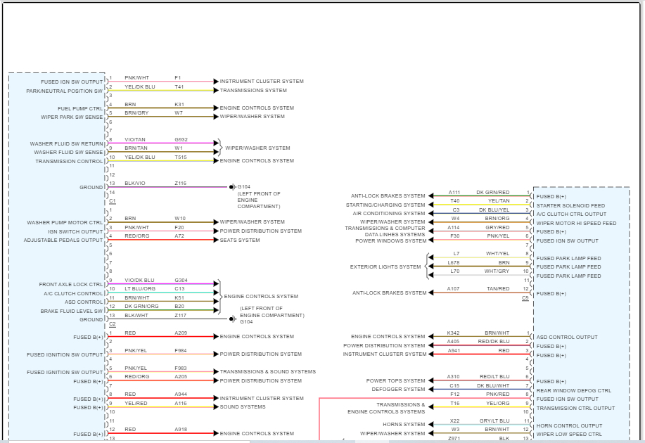

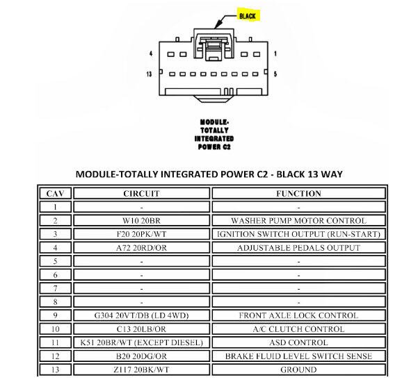

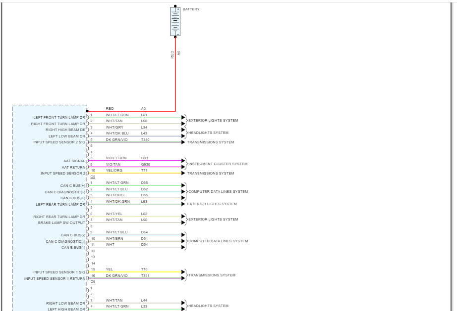

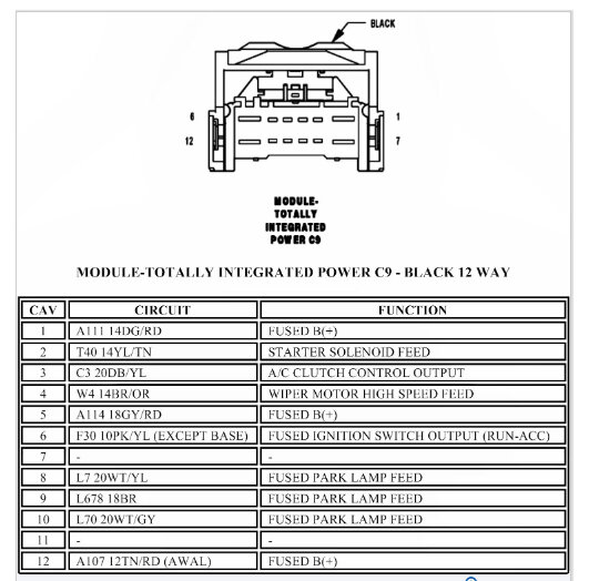

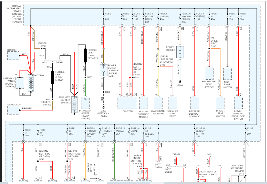

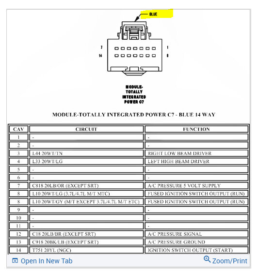

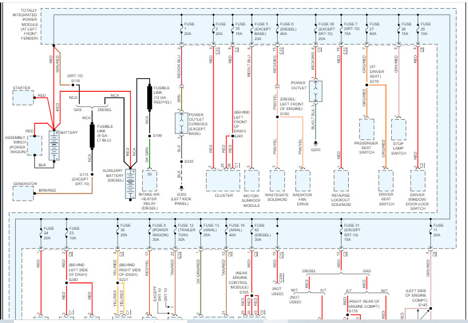

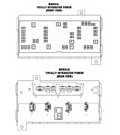

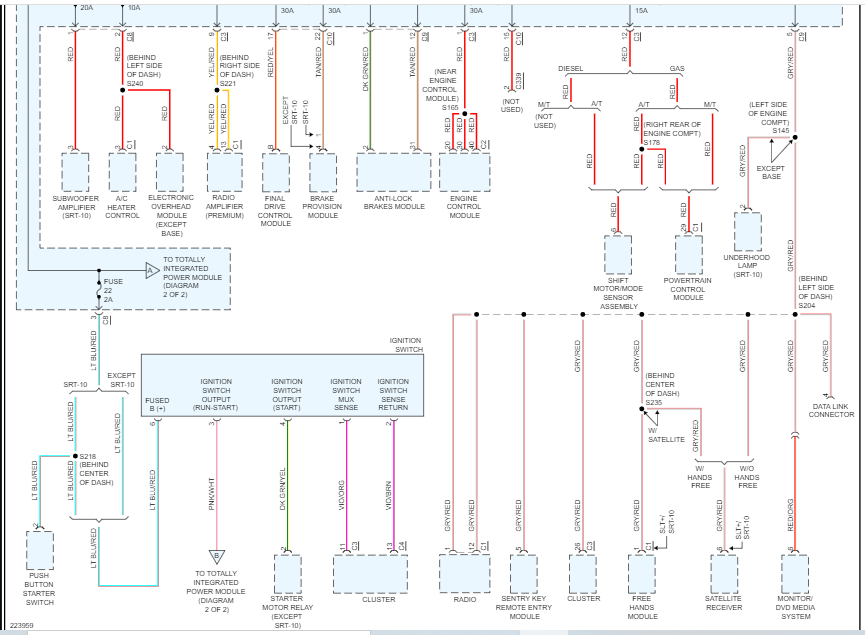

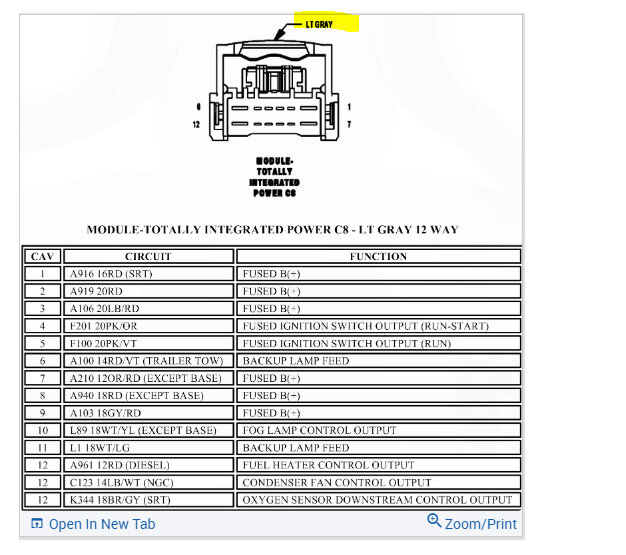

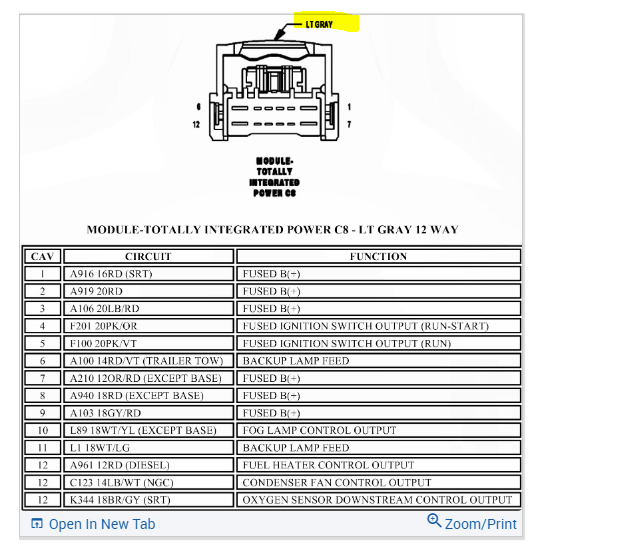

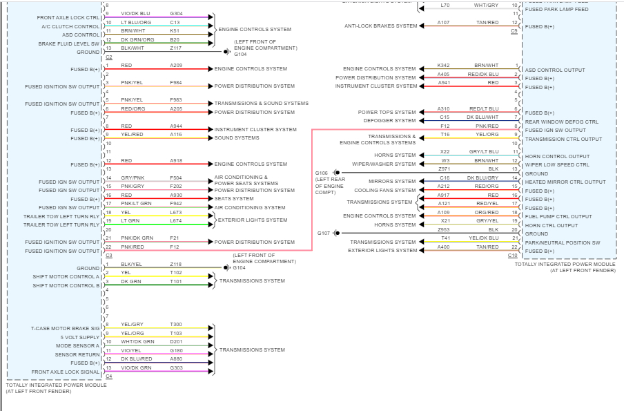

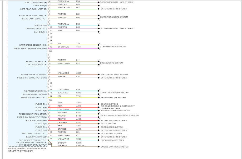

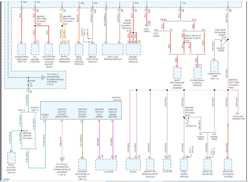

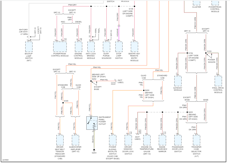

Regardless, I attached the power distribution schematics first, then the TIPM schematic and last are the pin connectors.
Take a look through the pics and let me know if that helps or if you have other questions,
See pics below. Note: The wiring schematic pages were cut in half and overlapped to make them readable.

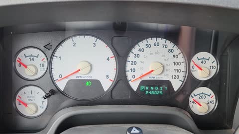

This is what is currently doing.
Dec 29, 2022 at 4:28 PM
That would certainly be enough to drive me crazy. LOL Did this just start after it sat? I do have another question. Please understand that I am watching a video, so I could be completely wrong.
I didn't like the alternator output. Before starting, it was at 12v. When it started, it hardly went up at all. I don't know if you had the electrical system loaded, but it should have been approximately 14v running.
I'm suggesting this because the tachometer is controlled by the instrument cluster circuit board based upon cluster programming and electronic messages received by the cluster from the Engine Control Module (ECM) on vehicles equipped with a diesel engine over the Controller Area Network (CAN) data bus. I ask because the electronics on these vehicles are very sensitive to low voltage. It's just a thought.
Also, since this is likely a CAN-related issue or the cluster itself is failing, you should consider having the can-bus scanned for codes.
