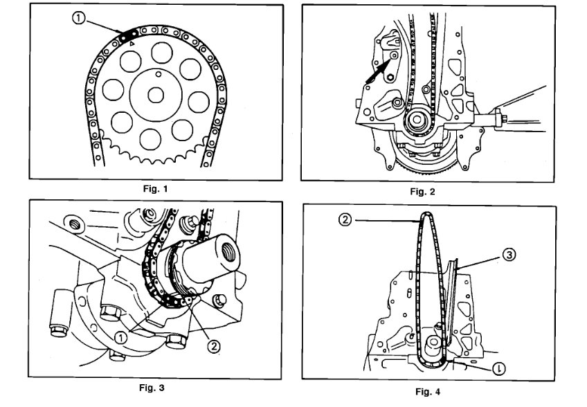

How to time this engine from the beginning to end.

I am changing both gears, slides and all. I just want to be sure the first time it will be right, never had to work on motor before. The crankshaft is out of it to polish and put back. If I had thought I would have line it all up but did not think!

Good. Do the marks line up as in the diagram I sent you?

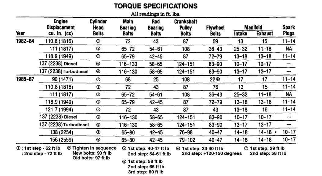

I have not put it back together yet so Ia m not sure. I will let you know when I do though. I also need the torch specs for the main bearings, rod bearings, oil pump and flywheel etc. So that I can get this back together by the weekend.
Nov 29, 2018 at 2:26 PM
Okay, attached are the torque specs.
