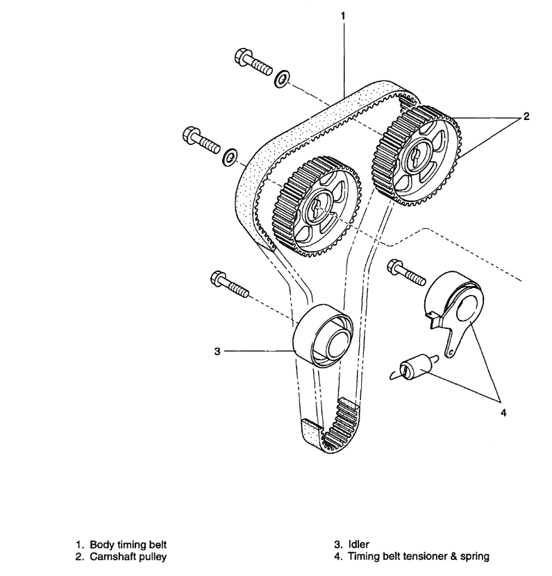

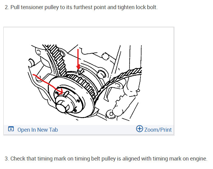

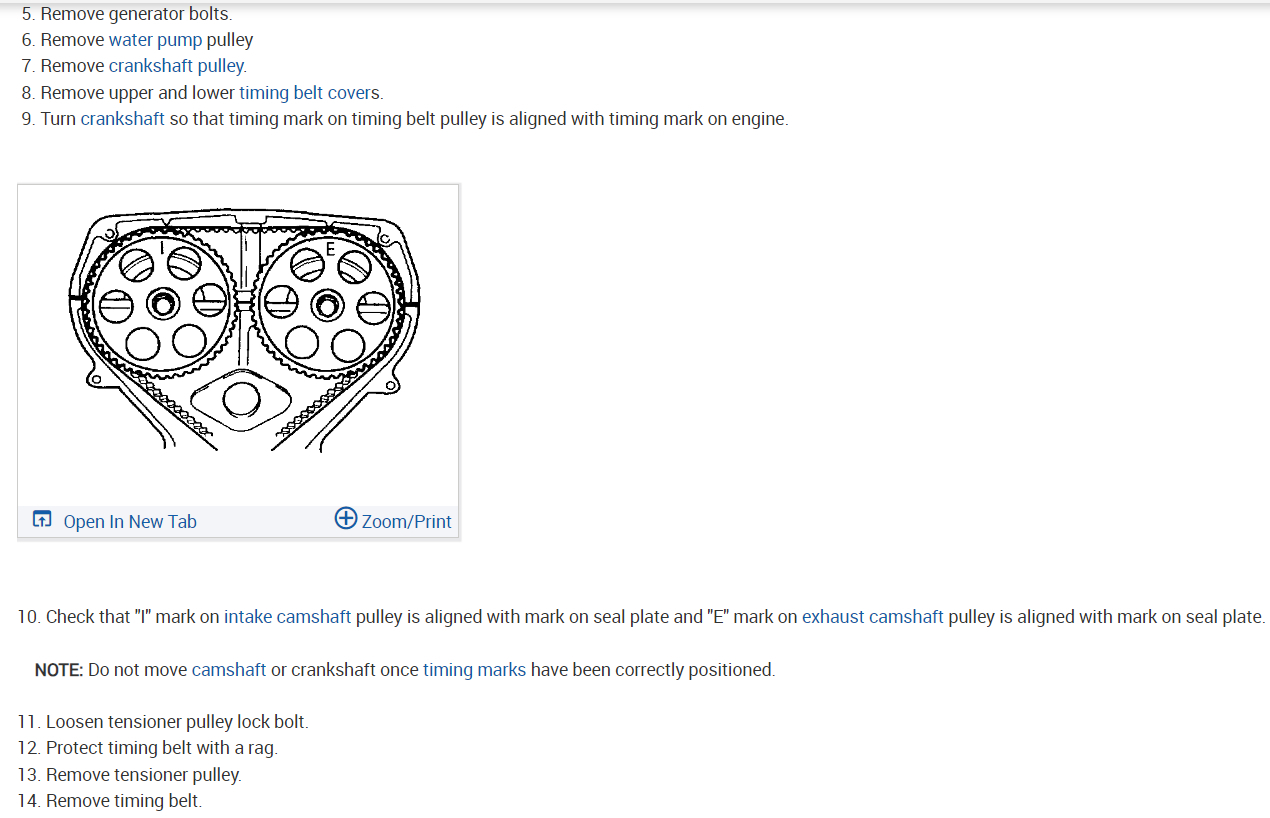

Sure, here is how to align the timing marks and how to put the crankshaft on top dead center. Check out the images (below). Let us know if you need anything else.
