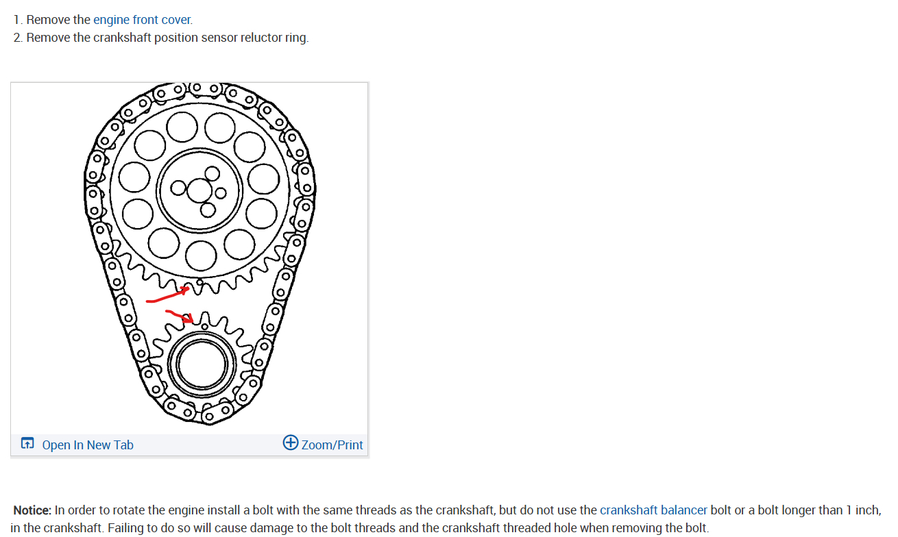

need information about changing the timing chain set.
Mar 21, 2025 at 9:34 AM

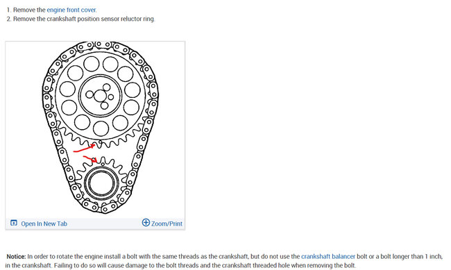

Okay, what kind of information, the timing marks? If so, I have included them in the images below. Line up the dots on the gears. Check out the images (below).

Yes, that helped a lot thank you.
