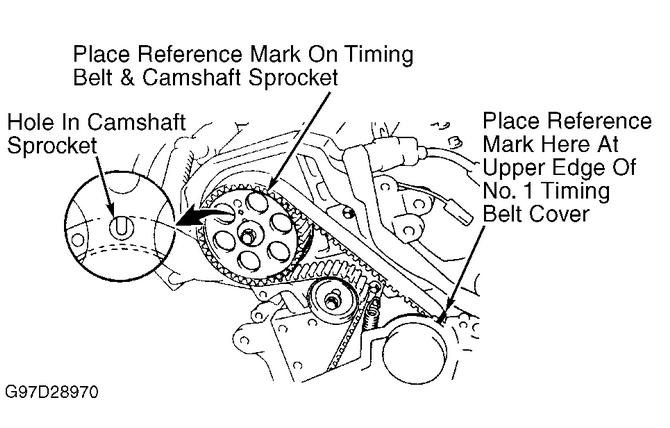

My old man has been trying to replace our timing belt. And he almost had it timed everything was turning, he went to bed got up went back to it and now the crank is hitting the rod cap bolts. how do I fix it and why did it do this when it was completely fine the first fifty times he tried?
Jun 30, 2017 at 4:22 AM
MHPAUTOS
  • 31,937 POSTS
There is a small hole in the cam gear that will align with a mark on the timing cove, this it the cam alignment mark. The crank gear has a notch and alignment mark at TDC , align both these. See picture for cam position information.
