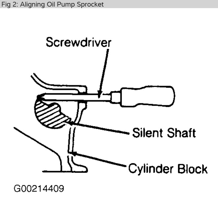

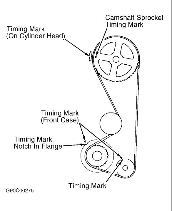

i am assuming this is a pickup this is for a 2.0 liter which is pictured. silent shaft must be aligned as well. see pictures.

That worked .What is the correct firing order on a 1988 two liter four cylinder?
