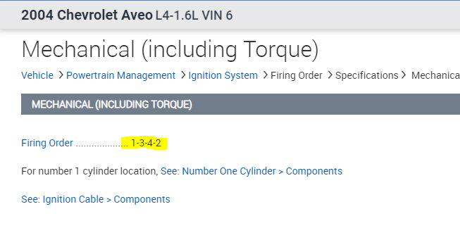

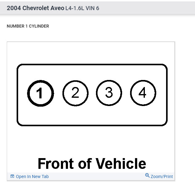

So how does the firing go high to low, is that correct 1342?
Aug 8, 2023 at 7:34 PM
Yes, that is the correct firing order. See the pics below related to the firing order and cylinder 1 location.
I need to ask something. Do you understand that the firing order isn't relevant when installing a timing belt? I don't want you to get the two things mixed up.
joe
See pics below.
