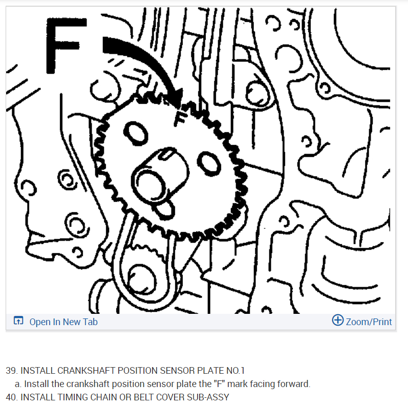

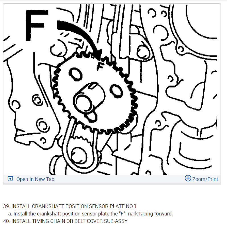

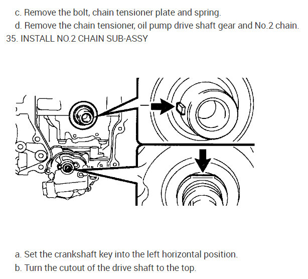

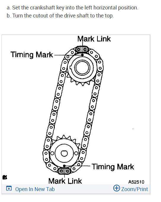

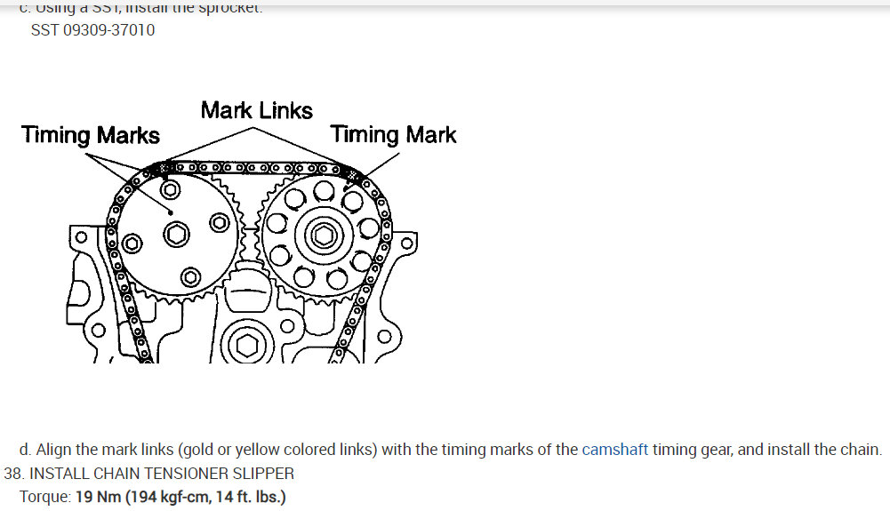

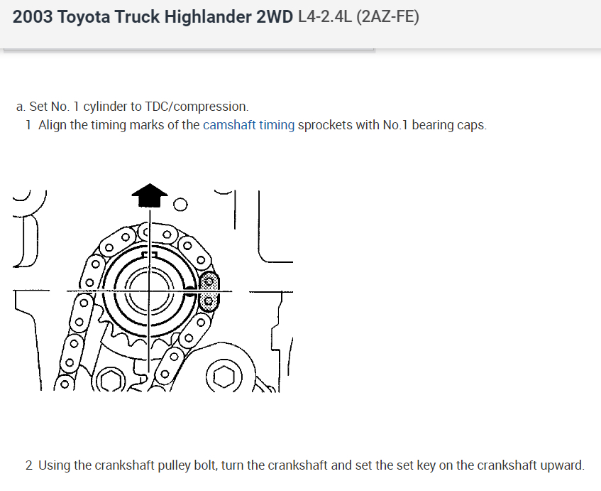

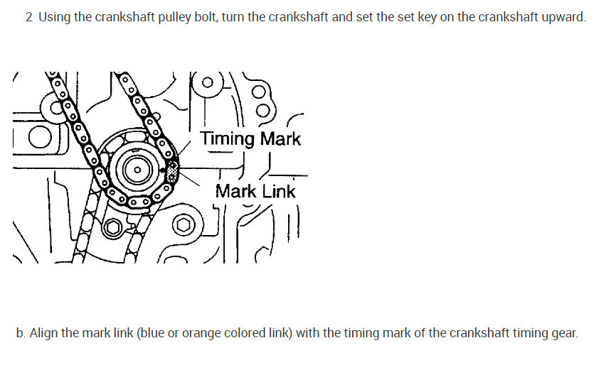

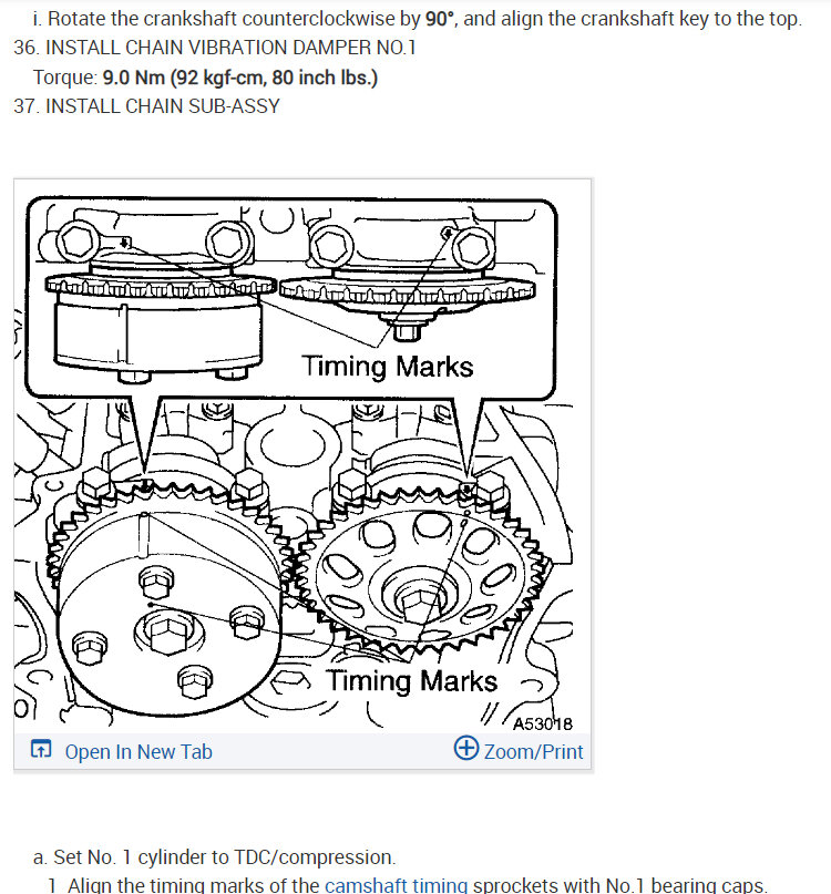

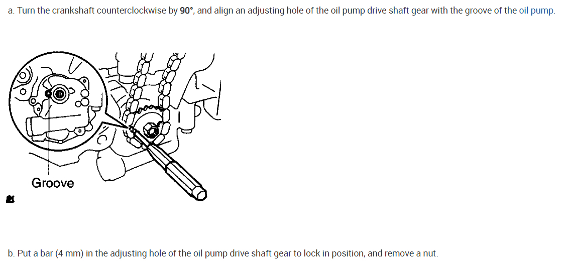

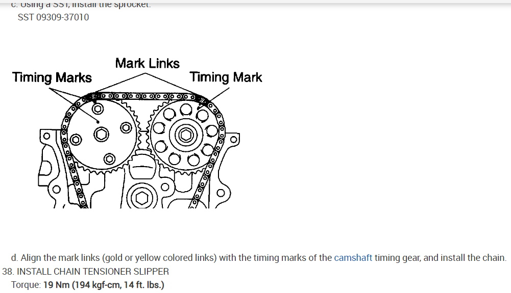

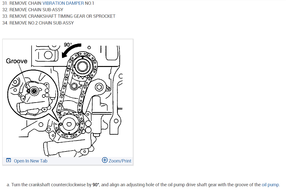

I need the timing chain mark diagram for the vehicle listed above.
Oct 15, 2024 at 10:16 AM
Here are the timing chain marks for the camshafts and oil pump. I would remove the valve cover to make sure the camshaft lobes are away from the valves showing you the engine camshafts are on TDC in the correct phase. Check out the images (below). Let us know if you need anything else.
