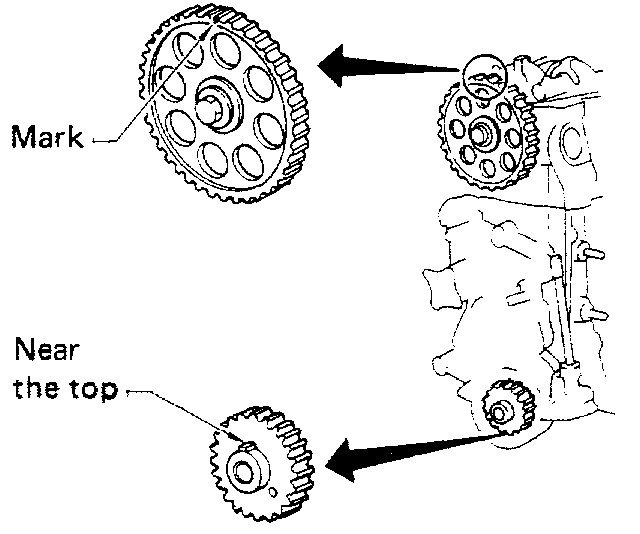

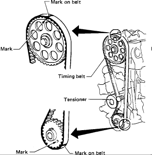

I am not sure why you would have three different marks. Here are directions specific to install for this vehicle. However, I do know there are marks on the belt which should align with both the crank and cam timing marks. I looked at all my information and here is what I found. I hope this helps. Additionally, I attached pictures for the timing process.

Confirm that No. 1 cylinder is set at T.D.C. on its compression stroke.

Cam And Crank Timing Marks
Set timing belt.
Ensure that timing belt and pulleys are clean and free from oil or water. Do not bend timing belt tightly.
Align white lines on timing belt with punch marks on camshaft sprocket and crankshaft sprocket.
Have arrow on timing belt pointing toward front belt covers.
Tighten belt tensioner and assemble spring.
To set spring, first hook one end on bolt (B) side, then hook the other end on tensioner bracket pawl. After rotating crankshaft two turns clockwise, tighten bolt (B) and then bolt (A), and belt tension will automatically be the specified value.
Specified Value: 15 - 20 Nm (1.5 - 2.0 kg-m, 11 - 14 ft-lb)
Install timing belt covers.
