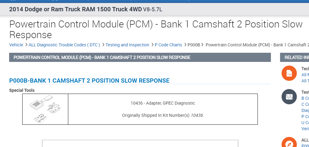

At a loss and hopeful for assistance with a quick fix.
I have replaced the Camshaft, spark plugs, lifters, pushrods, gaskets, timing chain, cam/crank gears (cam phaser), serpentine belt, Oil control valve and verified all timing components twice. Just buttoned it back up and am still getting the P000B and P00016 codes and it goes into limp mode. It is drivable but not getting nearly the power it used to.
What should I do next? I have exceeded my budget and can't afford the $200.00 diagnostic fees anymore.
Thank you for anything you can provide.
