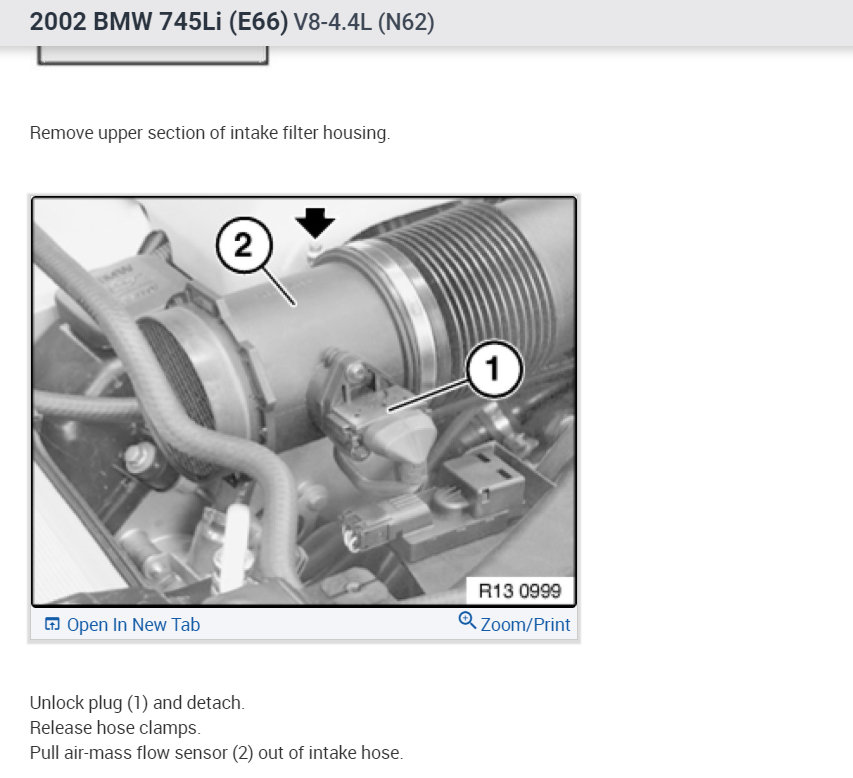

It sounds like it is lean due to a MAF sensor that needs to be replaced which is common. The hot wire becomes contaminated you can try cleaning it but I have better results with a new sensor. here is a guide to walk you through the steps and diagrams below to show you how on your car:
https://www.2carpros.com/articles/how-to-replace-a-mass-air-flow-sensor-maf
