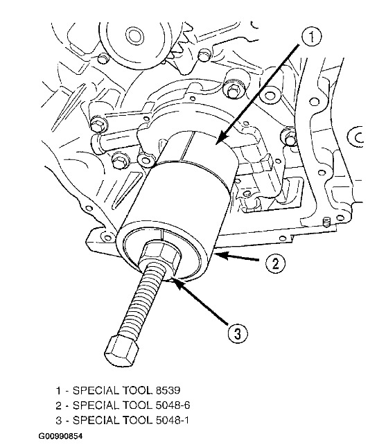

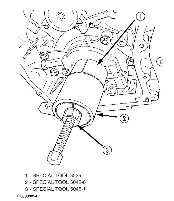

Special tools are needed for the removal and installation. For removal, it's a two-piece collar that goes over the sprocket, a pipe that holds them together, and a pulling bolt. The pulling bolt pushes against the vibration damper bolt. You may be able to borrow these tools from the dealer's service department or an engine machine shop. They're numbers 8539, 5048-1, and 5048-6.
To install the sprocket you need special tools 6780-1 and 8179. That's basically a threaded bolt and nut that pushes a piece of pipe to push the sprocket on. Verify it's pushed on all the way by measuring from the front of the sprocket to the front of the crankshaft snout. It should be 1.5374" plus or minus .020". (39.05 mm plus or minus 0.50 mm).
