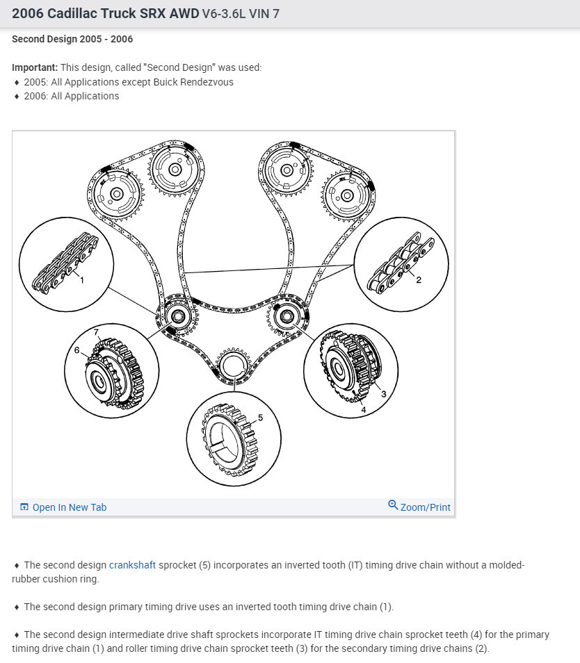

Need diagram to install chains and gears.
Aug 7, 2022 at 9:09 AM
SQM
CERTIFIED EXPERT
6,383 POSTS

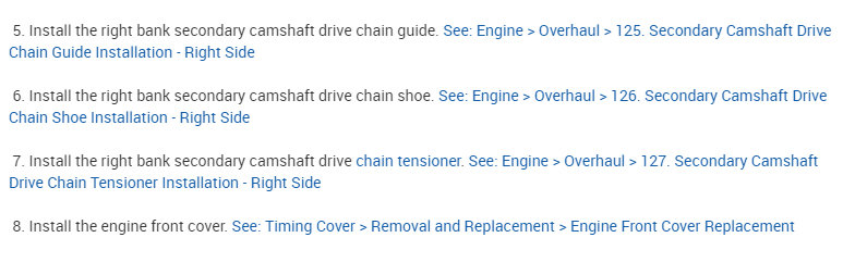

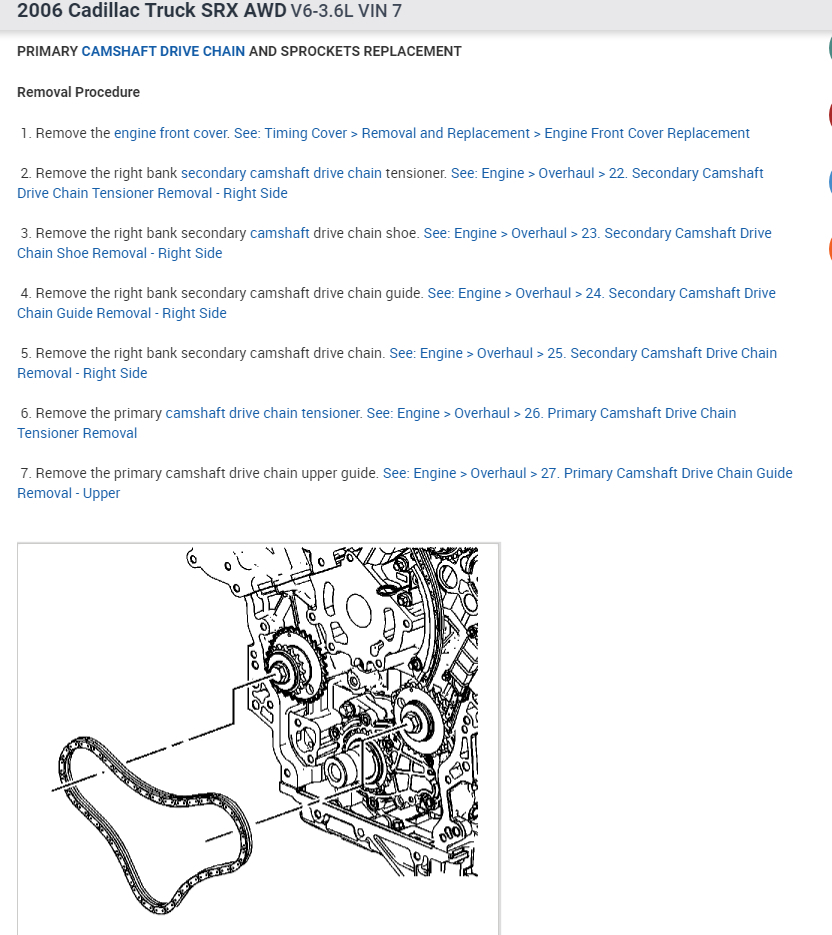

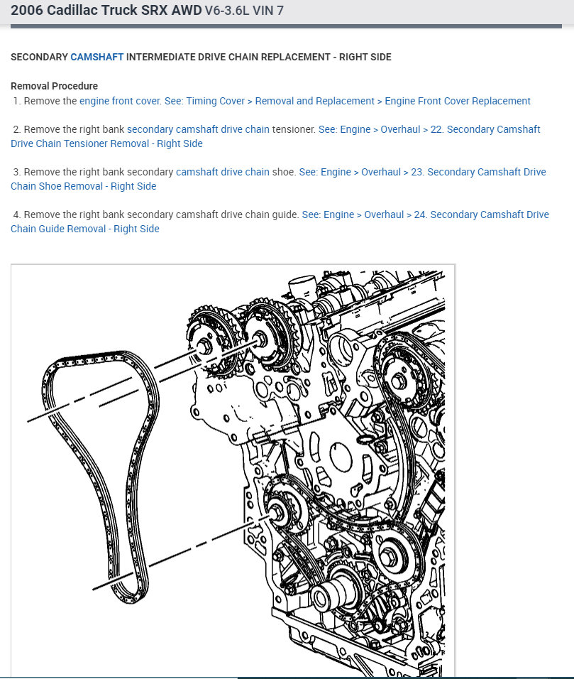

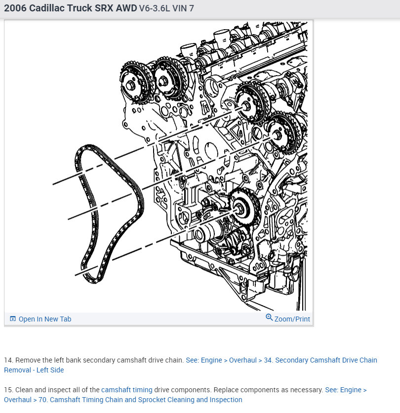

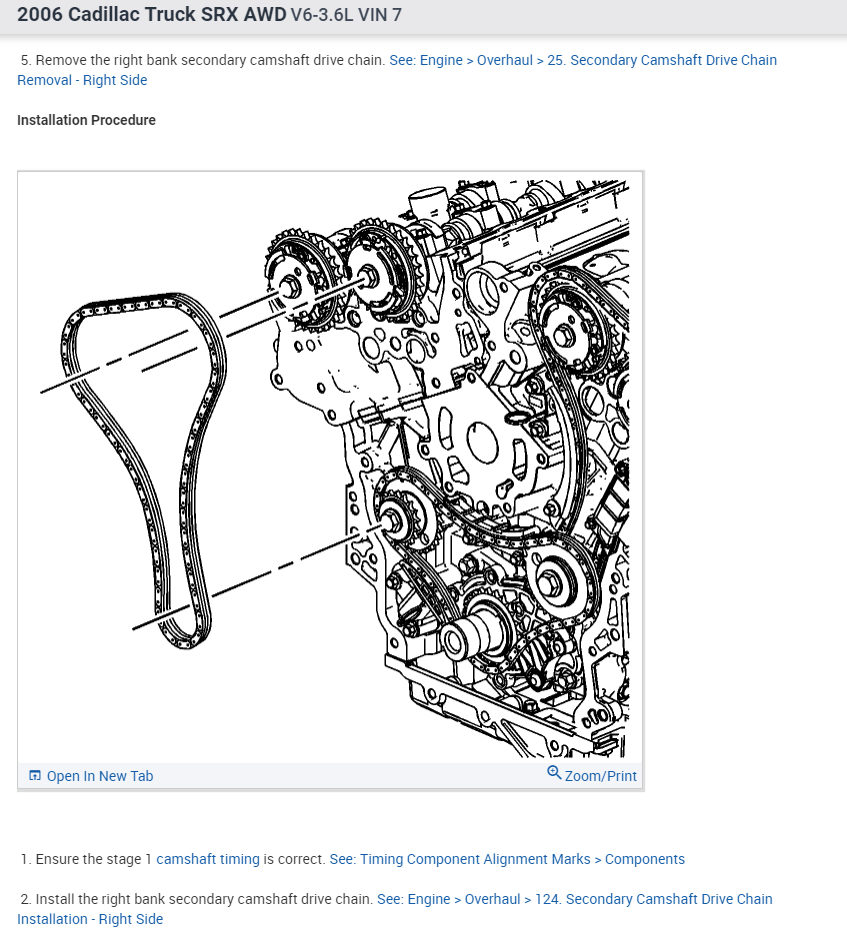

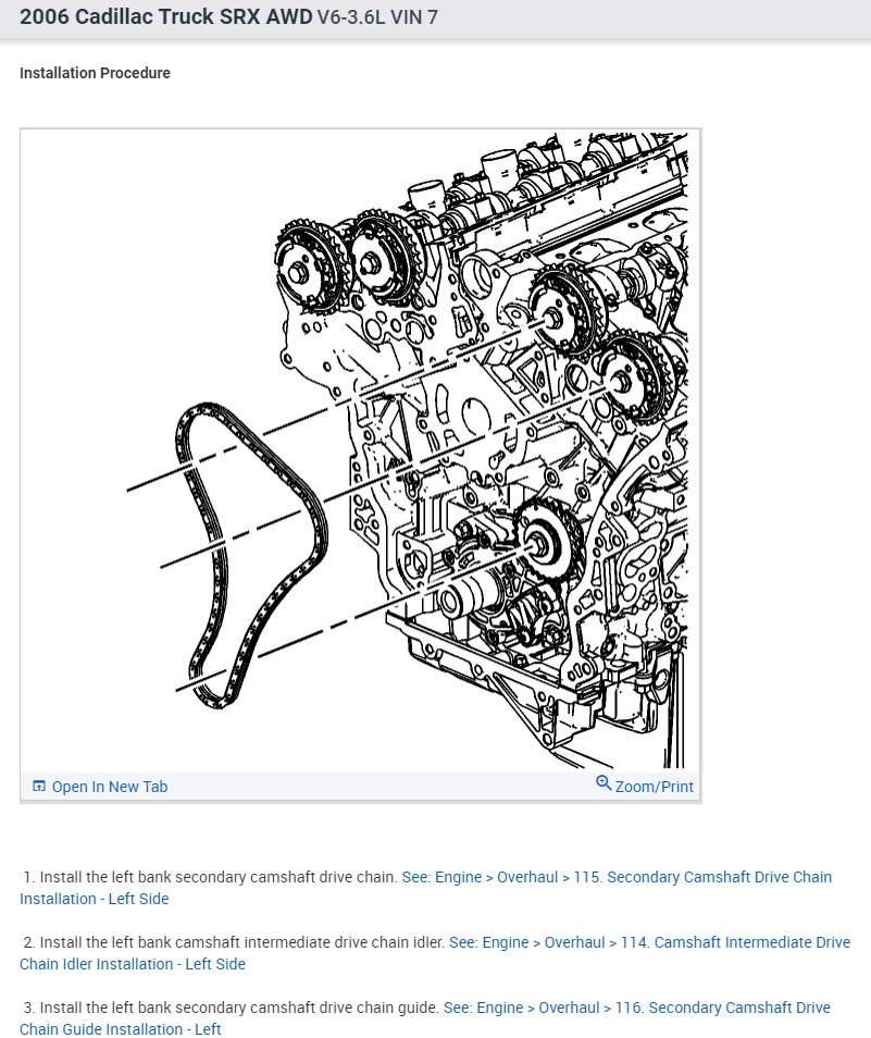

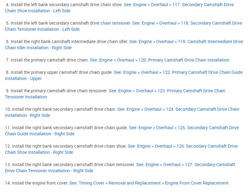

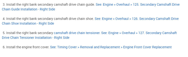

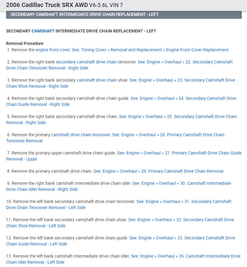

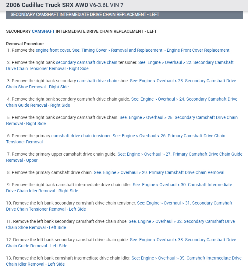

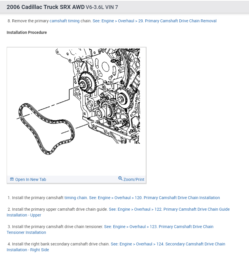

See attached for the timing chain replacement procedure.
There are several components that will need to be removed. If you need instructions to any specific component just let me know.
