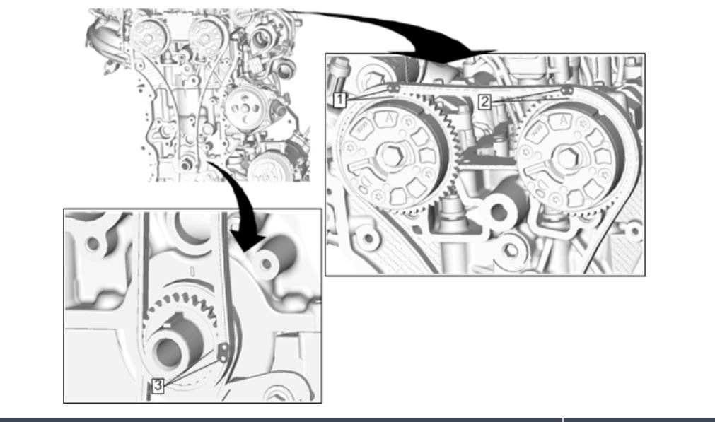

I had a burnt valves dude to overheating. I replaced valves. At first the car would start it kept flooding the engine (has) I went back in and noticed the sprockets on cams where not flush correctly . After I corrected this issue I checked all timing marks made sure all is well. I drove the vehicle turned on fine. After a few miles I parked and started the car again . It gave me timing codes p0014 and p0017 .

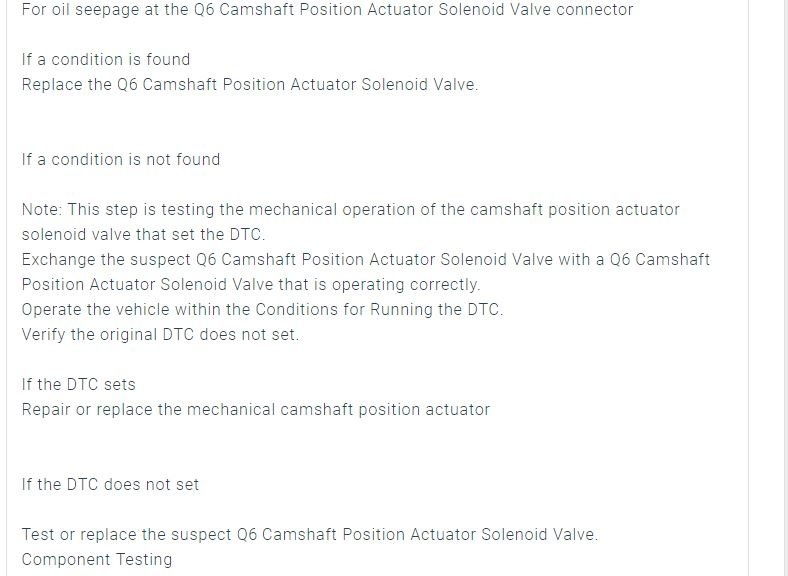

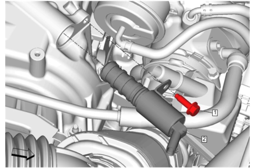

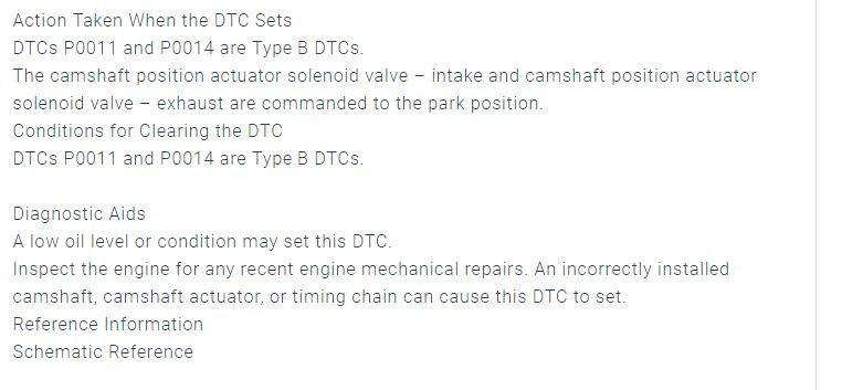

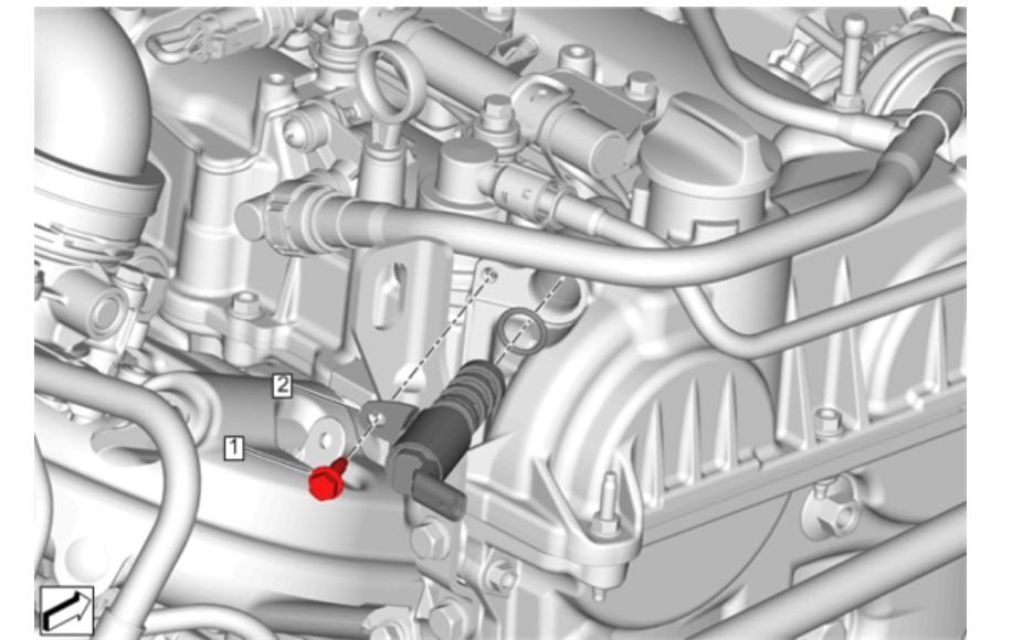

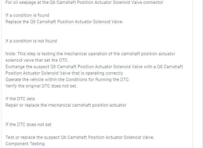

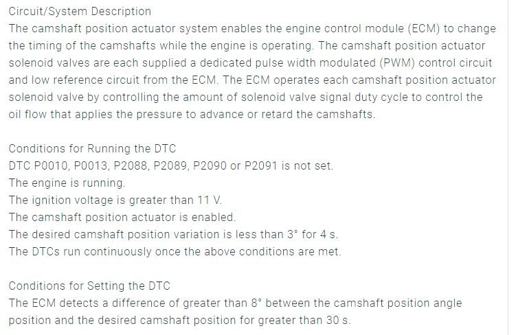

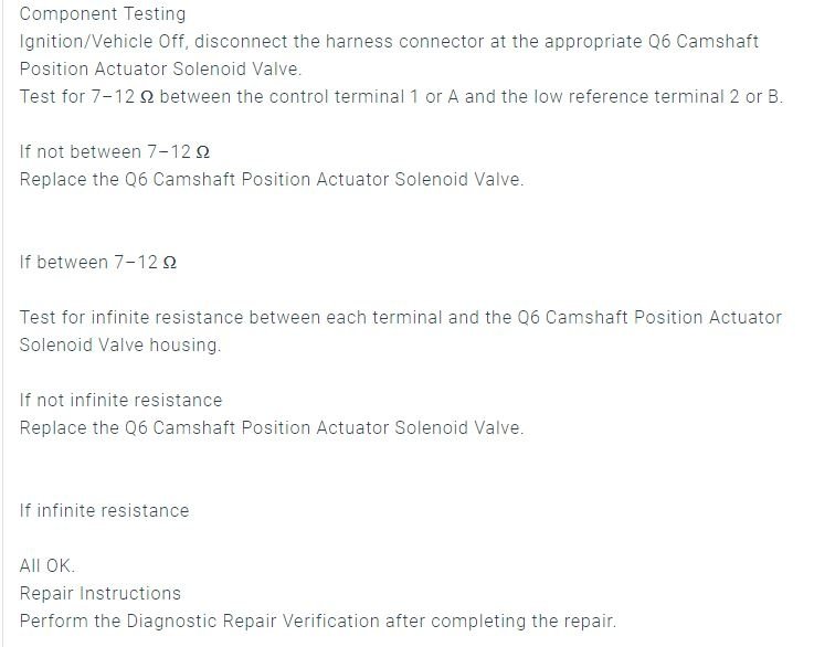

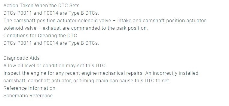

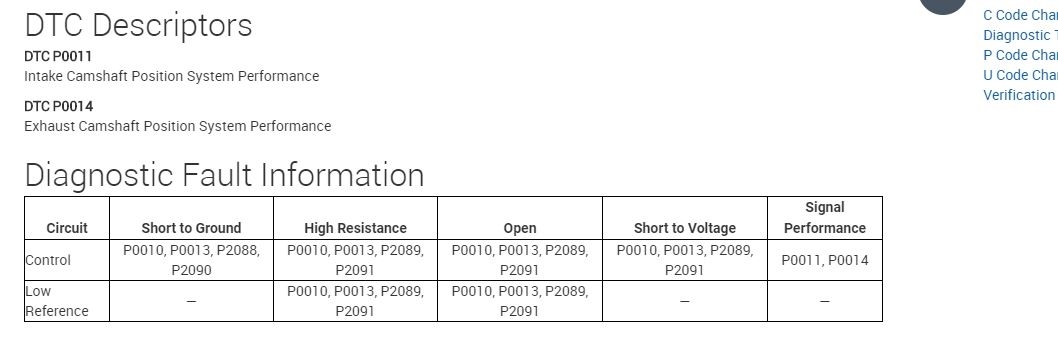

Good morning,

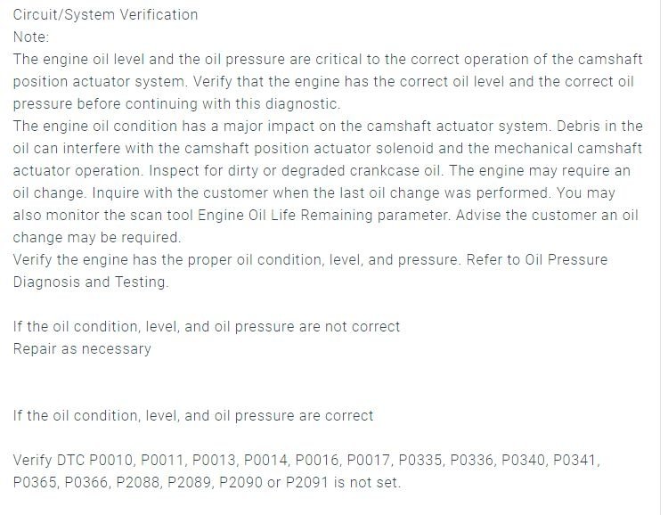

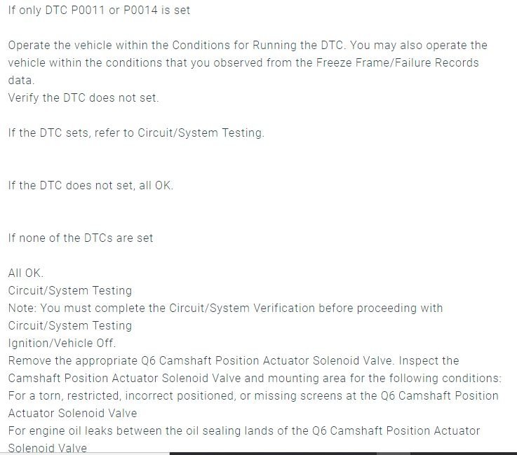

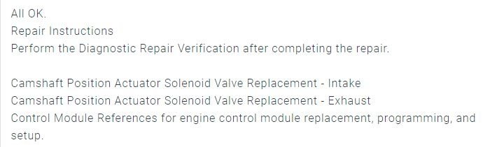

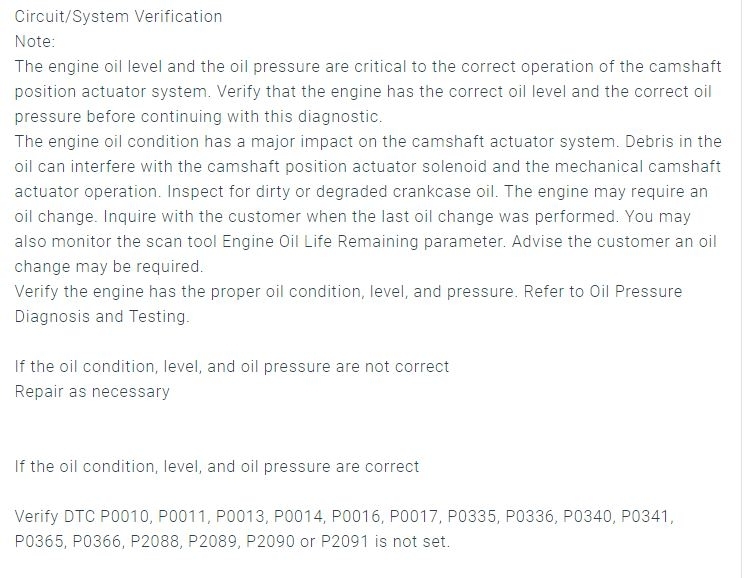

I attached the information for this.
Did you flush the oil system of all dirt and debris? This is the most common issue for these codes along with the timing marks being incorrect.
I would suspect the solenoids could be the issue but needs to be confirmed. They get sludged up internally and will not allow oil flow for the timing adjustment.
Do you have a scan tool that can activate the solenoids so you can verify the timing change? If the ECM does not see the timing change, this is the resulting codes that will be set.

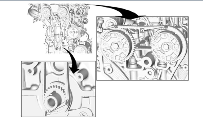

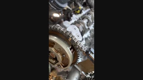

Hello . I’m back so I removed the timing cover again . Before I did anything I rotated my engine by hand . Went to find TDC and all my marks align at 12 o'clock. Now again I was recently getting codes P0014 and P0017. Could it be the actual phaser on my exhaust cam that could be getting stuck ?
Jul 10, 2020 at 7:59 AM
Yes, it can. Oil contamination is a common cause of this. Flushing the oil system with a pressurized cleaning agent is recommended before replacing the solenoid and phaser. You could contaminate the replacement parts if you do not flush the system.
