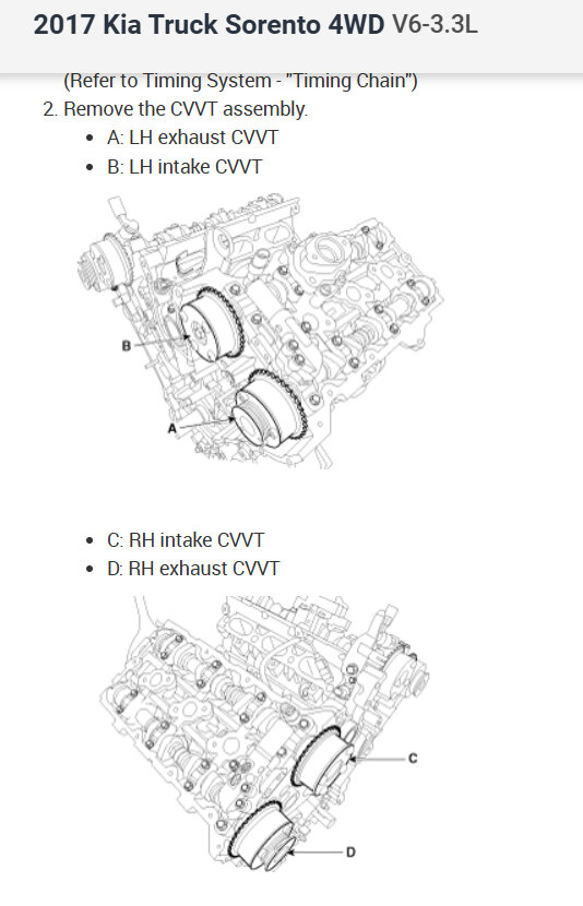

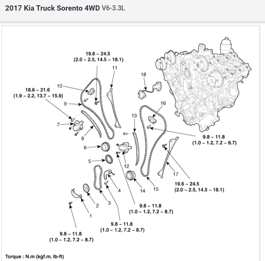

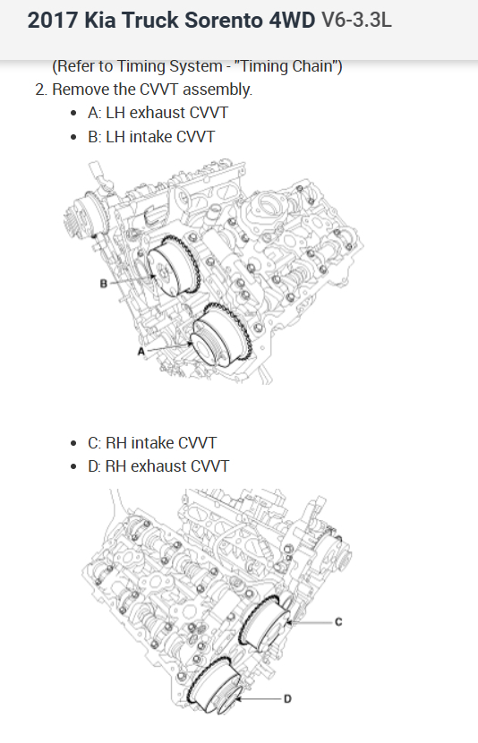

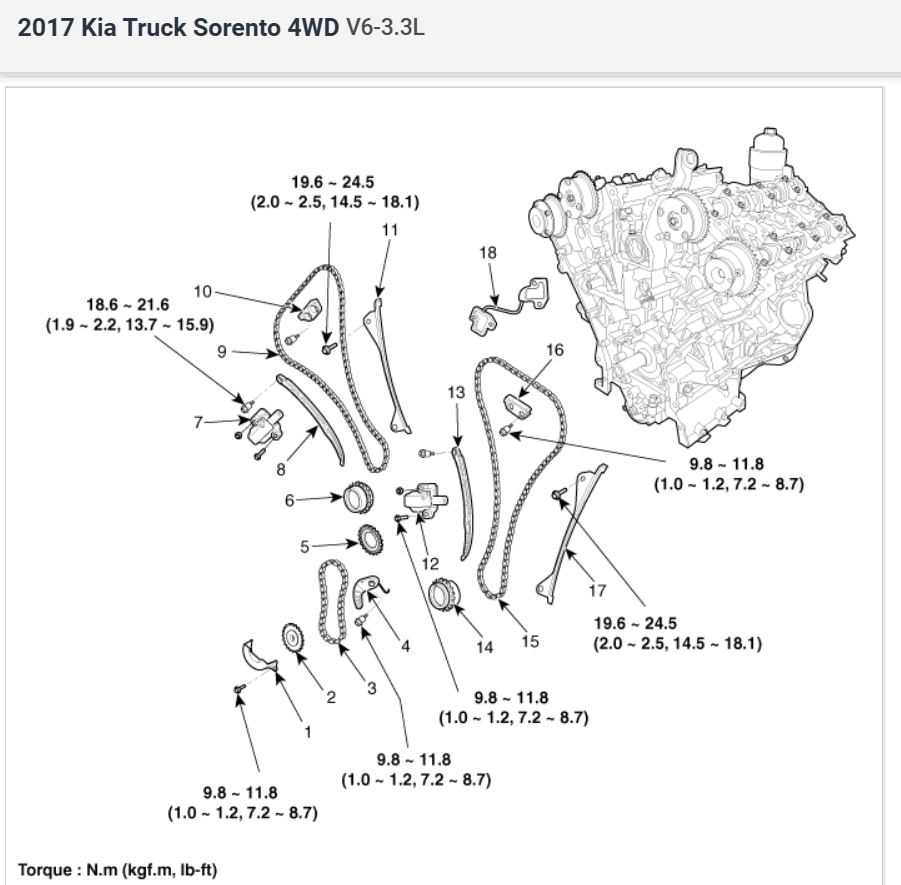

No you should not hear any noises after the repair, can I ask if they replaced the timing chain and camshaft actuators as well? Can you please upload a short video of the noise so I can hear it?
Please go over this guide for engine rattle problems:
https://www.2carpros.com/articles/rattle-noise
Can you confirm the parts that were replaced? Check out the images (below). Please upload pictures or videos in your response of any problems so we can see what to help you with.
