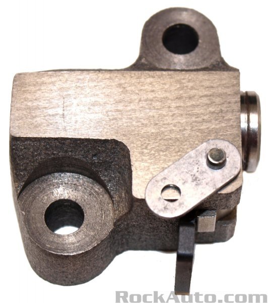

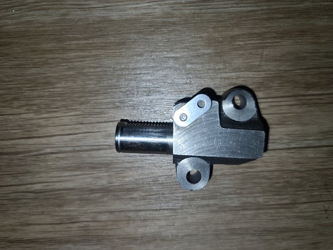

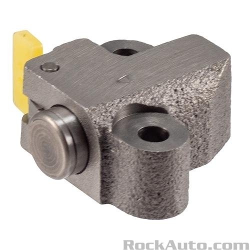

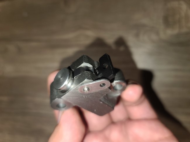

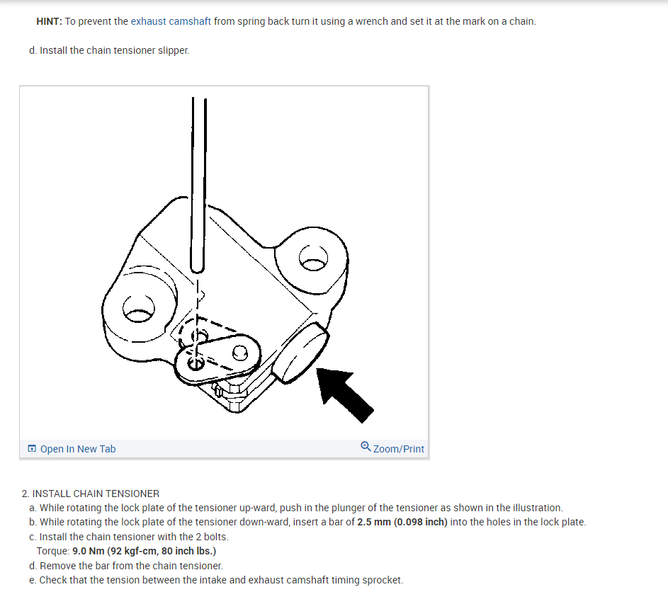

hello there gentlemen, may i please get some guidance on installing a timing belt tensioner on this car listed above?
i have done a timing tensioner replacement before but this particular vehicle has a somewhat different type of tensioner. the way i see it you just install and remove clip unlike the others where i had to turn the engine to get it to release. i see no locking mechanism on this actual tensioner. anyhow just need some extra information before i get started. Thank you in advance.
