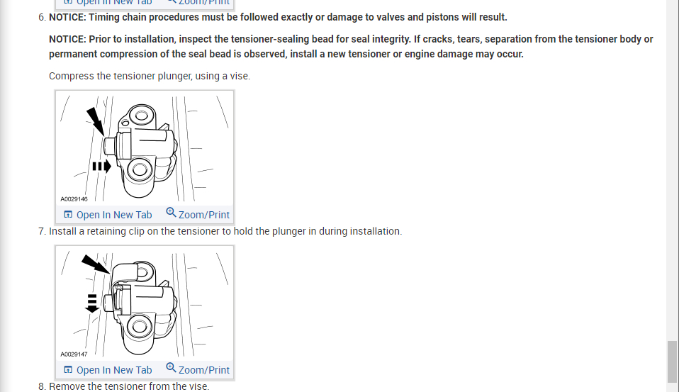

I took the valve covers and front cover off and found that the right hand (passenger) timing chain is going slack then re-tensioning again and slapping the top chain guide when turning it over by hand. You can watch the hydraulic chain tensioner loose pressure and retract when the chain goes slack. Okay, replaced the tensioner thinking bad luck and turned it over by hand again... same problem; new tensioner retracts and the chain goes slack by about two fingers width.

This is odd but we need to rule out another possible tensioner issue by removing it and compressing it with vice grips to make sure the tension is sufficient.

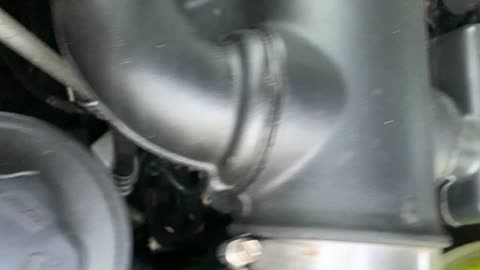

Kase, thanks for taking the time to respond. It's still apart because, well frankly i've pulled it apart three times now and i'm trying to see if this is the source of my tick. I did a video showing the symptoms of what I am seeing which I hope will help.

Video attached.

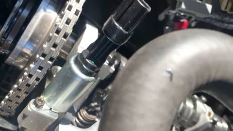

The video of it all together and running with the tick I’m trying to eliminate. During this video the OEM CAM Phaser is less than 6 months old (both banks). The tick is more pronounced on the passenger side.
After I took this video I got a new motorcraft timing chain and another motorcraft cam phaser and replaced them (same ones in the video above) with new phaser bolt.

Okay, and I don't have any chain slapping marks on the cover where its hitting. My hypothesis is that the tensioner is vacillating between being pressurized and not, and its causing the chain to go slack then taught causing a slap on the upper chain guide. Happy to be wrong, of course.

That is interesting. I know for a fact that I have spun this motor over and the chain does go slack in different positions based on valve lift. However, the fact that the tensioner is collapsing like that is a new one. I can't remember ever seeing it that dramatic.

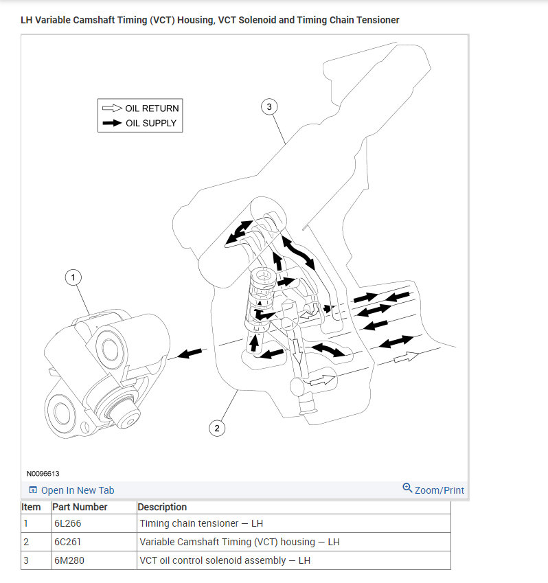

Correct me if I am wrong but that tensioner does not have a seal on the back of it correct? It should be spring pressure only. I think the Left hand is the only one on this engine that is oil pressure filled.

No, both tensioners have springs to hold the plunger in place until oil pressure builds, meaning yes they're both oil fed. One random posting on a Ford trucks forum stated that they had a similar issue and the fix was to pull the oil galley plugs at the back and front of the head and to clean any debris out of the head as perhaps there is an obstruction not allowing for full pressure to get to the tensioner. Perhaps i'll give that a try.

That is funny you mention that. This is why I was asking. I did not see that posting but I was thinking we had a possible oil contamination issue and I thought only the other side was oil feed. Please let us know what happens with this because I am not sure where else to go with this but if nothing comes of this, I have a number of contacts at different Ford dealers that I can run this by and see what they say.

Remember the chain tensioner needs oil pressure to take the slack out of the chain, then it will hold the tension on the chain. Can you upload a short video so we can see what you are talking about?
