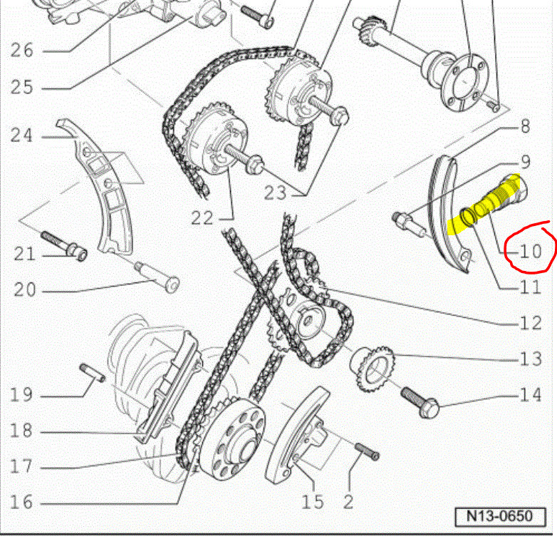

Are you referring to the camshaft chain tensioner? See pic 1. I have to be honest, if you are replacing a tensioner, I feel it needs to be taken apart. However, I believe the tensioner is exposed. My biggest concern is if VVT is changed, but as long as the chain doesn't move, it shouldn't change. You just won't be able to see it.
Here are the directions I have. I'm including everything down to the tensioner. Note the directions are for camshaft timing chain replacement. The remaining pics correlate with the directions.

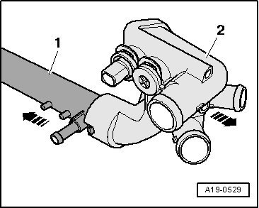

- Disconnect electrical connector to engine coolant temperature (ECT) sensor (G62).
pic 2

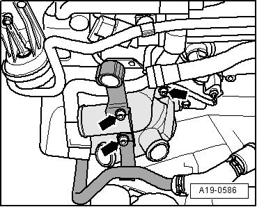

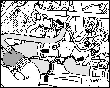

- Disconnect coolant hoses at positions indicated by - arrows -.
pic 3

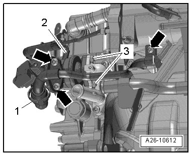

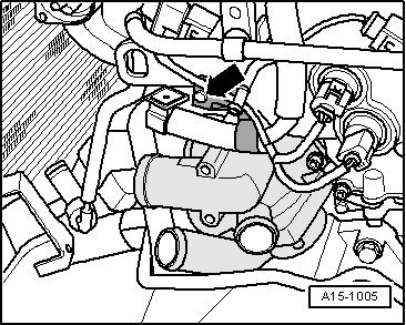

- Remove the bolts - arrows -.
pic 4
- Pull transmission oil cooler coolant pipe bracket toward left.
- Swing Secondary Air Injection (AIR) system hose bracket forward.

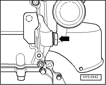

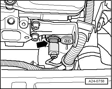

- Remove bolt - arrow - at wiring harness bracket.
pic 5
Press coolant pipe in direction of coolant pump using pry bar when removing coolant thermostat housing so that is not pulled off.
- Remove coolant thermostat housing - 2 - while pressing coolant pipe - 1 - toward coolant pump with pry bar.

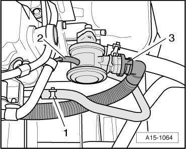

Vehicles with engine code BUB:
- Disconnect the hose - 3 - and the vacuum hose - 2 - from the Secondary Air Injection (AIR) combination valve.
pic 7
- Disconnect coolant hose - 1 -.

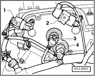

- Identify and disconnect electrical connectors:
pic 9
1. Camshaft position sensor (G40)
2. Camshaft position (CMP) sensor 2 (G163)
3. Camshaft adjustment valve 1 (N205)
4. Camshaft adjustment valve 1 (exhaust) (N318)
- Remove wiring guide from camshaft timing chain cover.

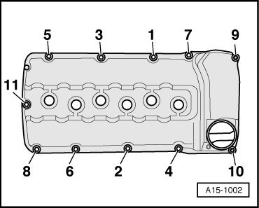

- Loosen cylinder head cover bolts in sequence - 11 to 1 -.

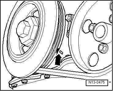

- Set crankshaft to TDC mark by turning crankshaft on vibration damper screw in direction of engine rotation - arrow -.
pic 11

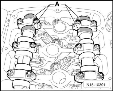

- Cams - A - of cylinder 1 must face each other.

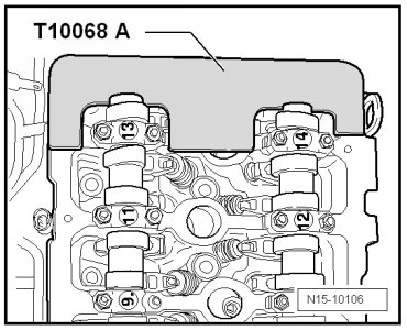

- At the same time, (T10068 A) must engage in both shaft grooves. Turn crankshaft 1 additional turn if necessary.

- Remove camshaft timing chain tensioner - arrow -.
