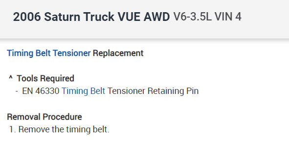

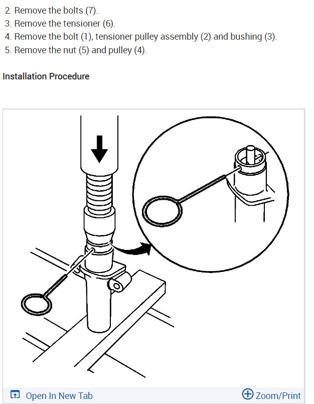

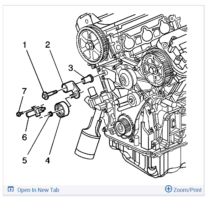

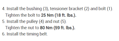

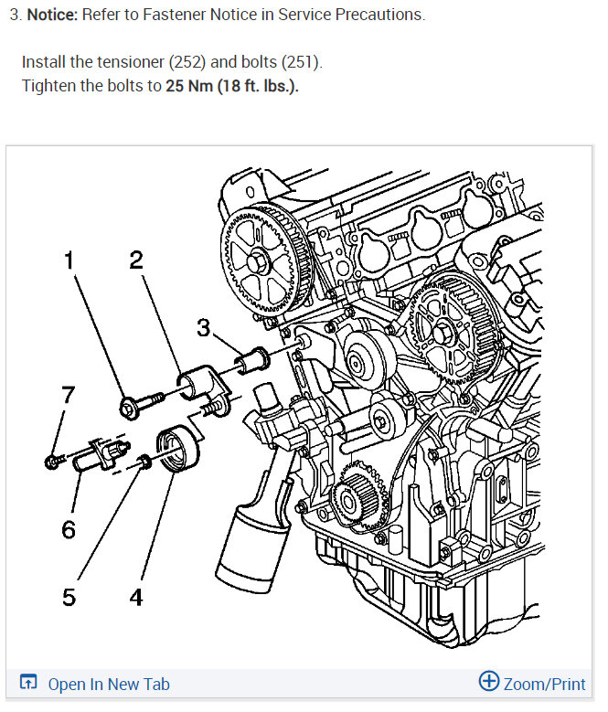

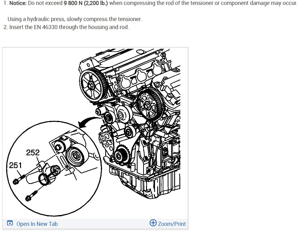

I would like the repair steps for replacing the timing chain tensioner please.
Oct 13, 2024 at 8:09 PM
CERTIFIED EXPERT
53,854 POSTS
Sure, here are the instructions on how to replace the timing belt tensioner. Check out the images (below). Let us know if you need anything else.
