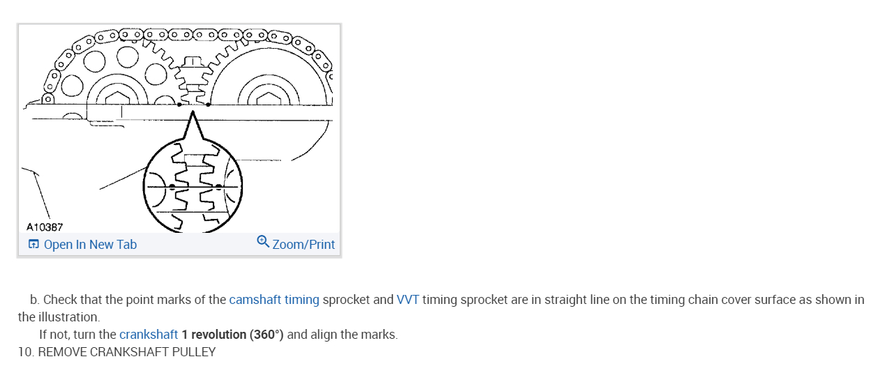

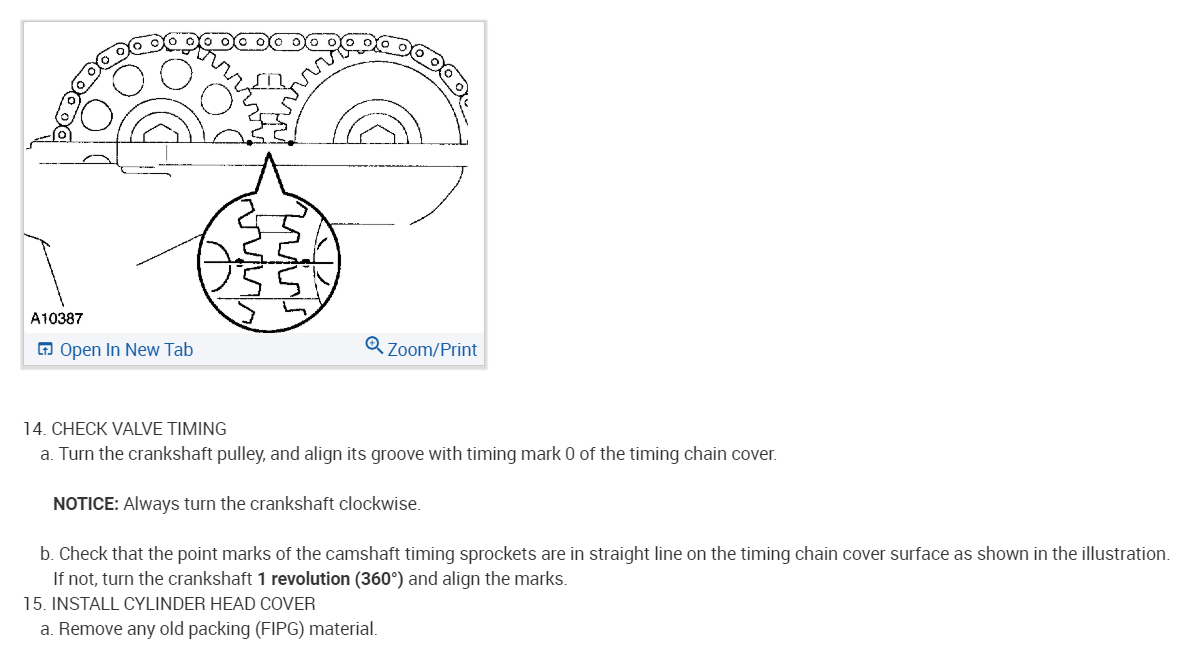

Hello again,

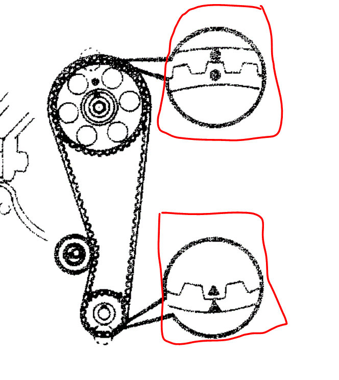

I know we discussed this before with the timing as the issue.
I attached the gear alignment for the cams and the crank.
Is this the way you set it?
The compression should be 140-160 I do not what manual you are referring to but this is reality and a lot of times, the reality is different than the book.
Dec 15, 2020 at 8:32 AM (Merged)

yes, that is the way i set it. The manual i'm using is a Haynes and it says that 218 psi is standard and 145 is minimum.
The 218 is for a new car, not a car with tons of miles.
As I stated before 140-160 is the figure.

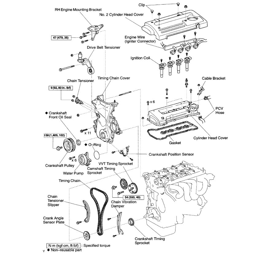

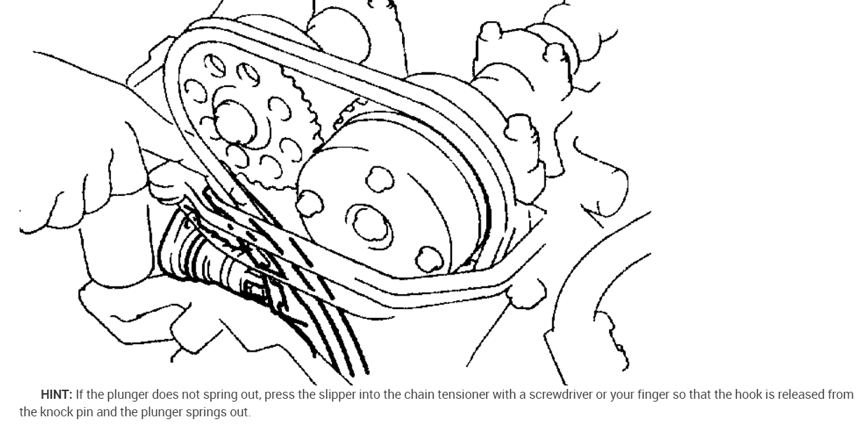

Hi I had a strong slapping noise coming from the timing chain, so I took off the tensioner and the timing cover. Chain was loose(even b4 taking off tensioner), and I can move the tensioner pretty easily. Sounds like I needs the chain and the tensioner to be safe, but could you tell me how to re-time it, as far as the marks on the cams/crank/chain. Thanx.
MATHIASO
  • 1,209 POSTS
Hello wilsaaw
What is your engine?
1NZ-FE Engines
1ZZ-FE Engines
2zz-Ge And 2zz-FE Engines
WILSAAW
It has the 1zz-fe engine.
MATHIASO
  • 1,209 POSTS

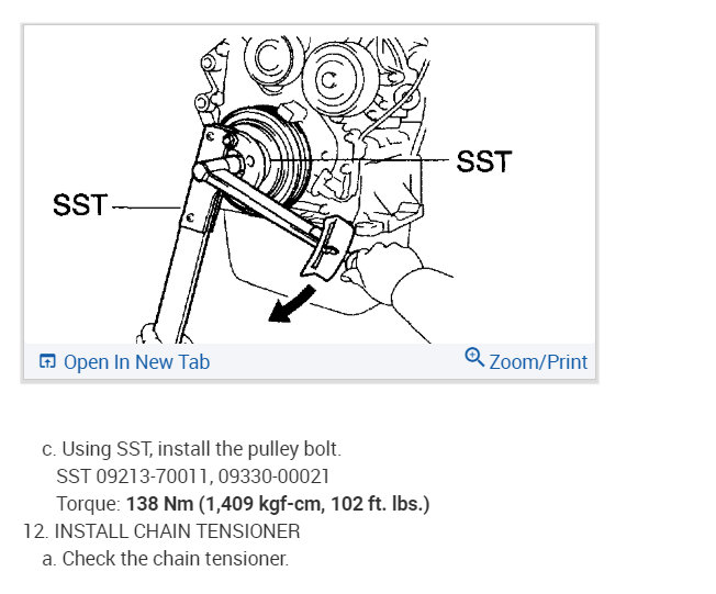

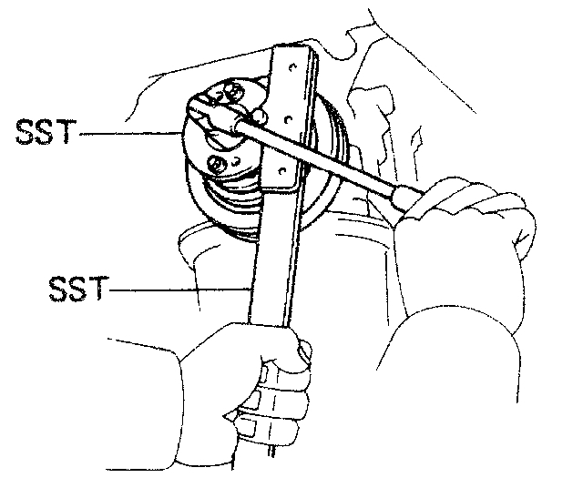

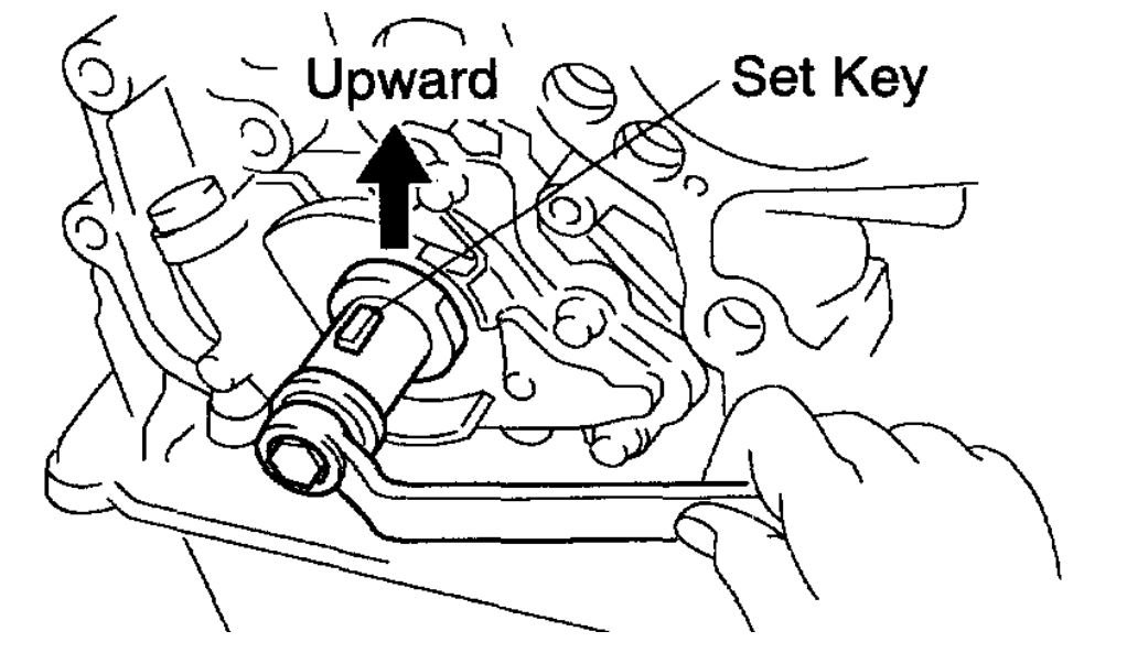

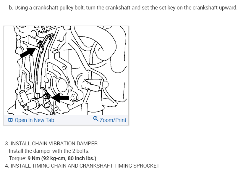

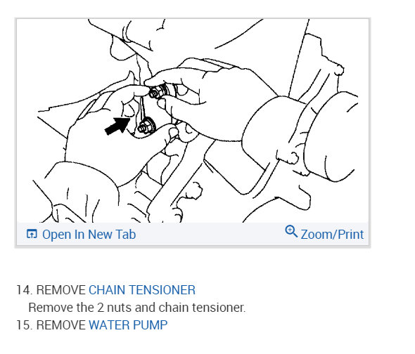

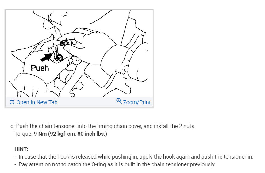

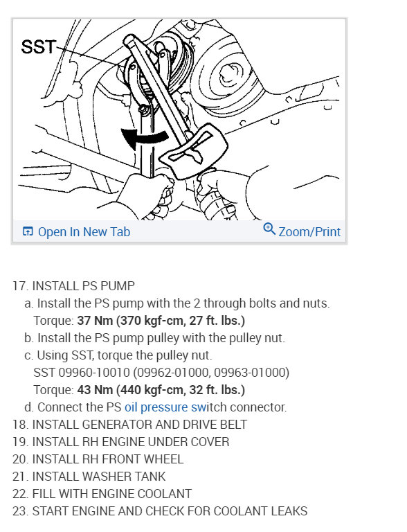

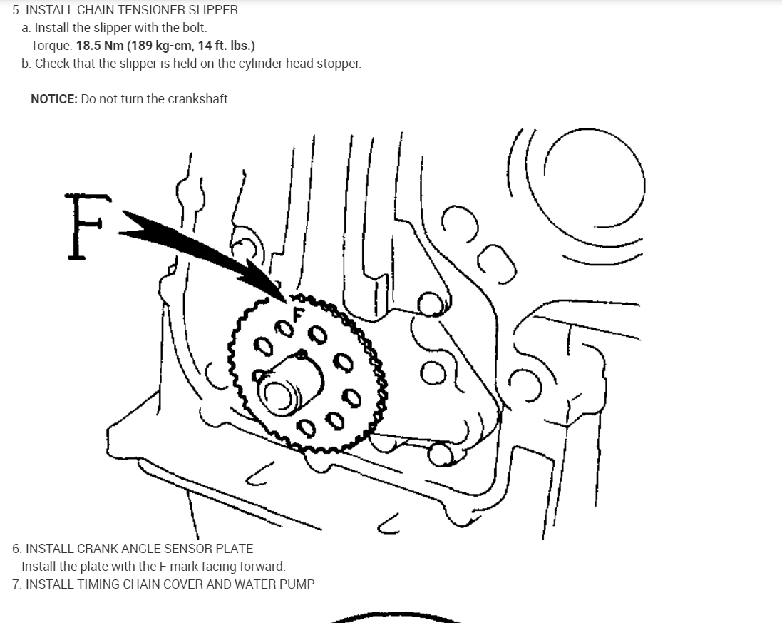

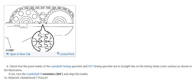

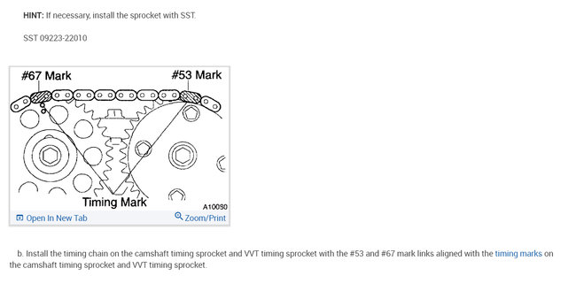

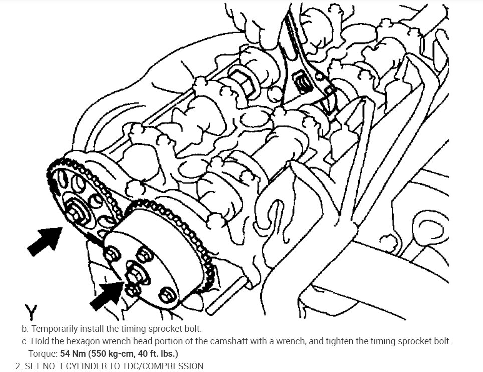

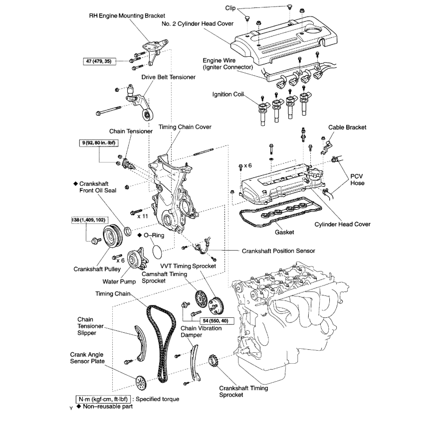

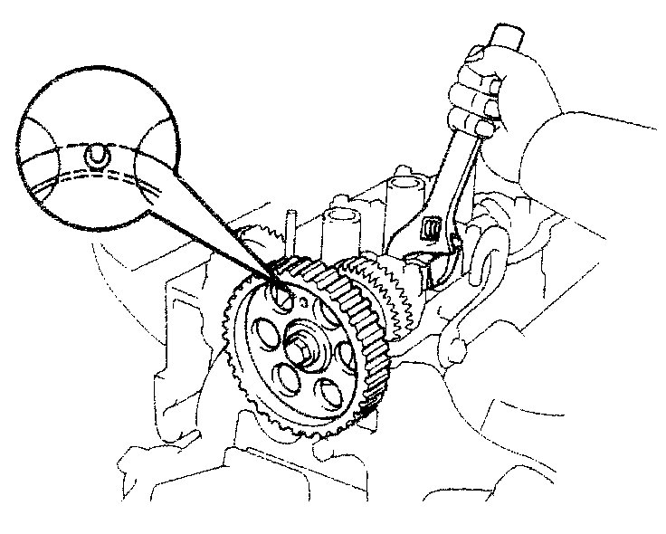

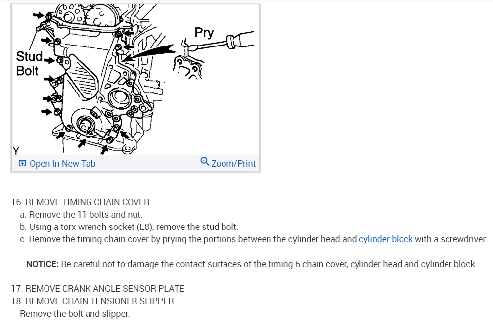

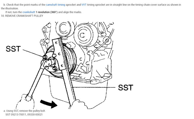

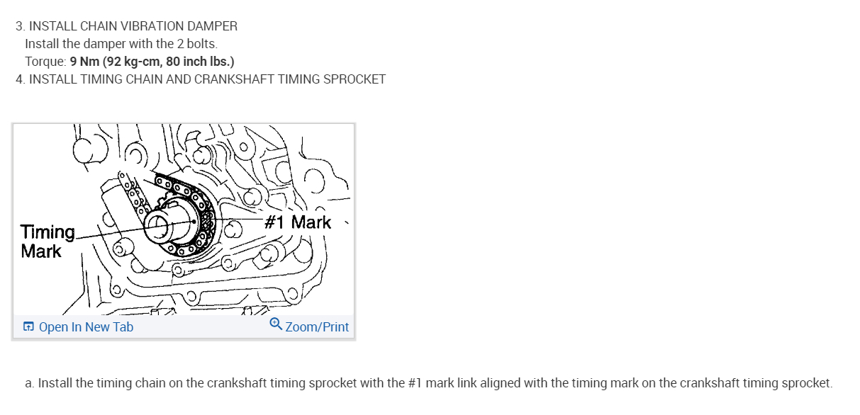

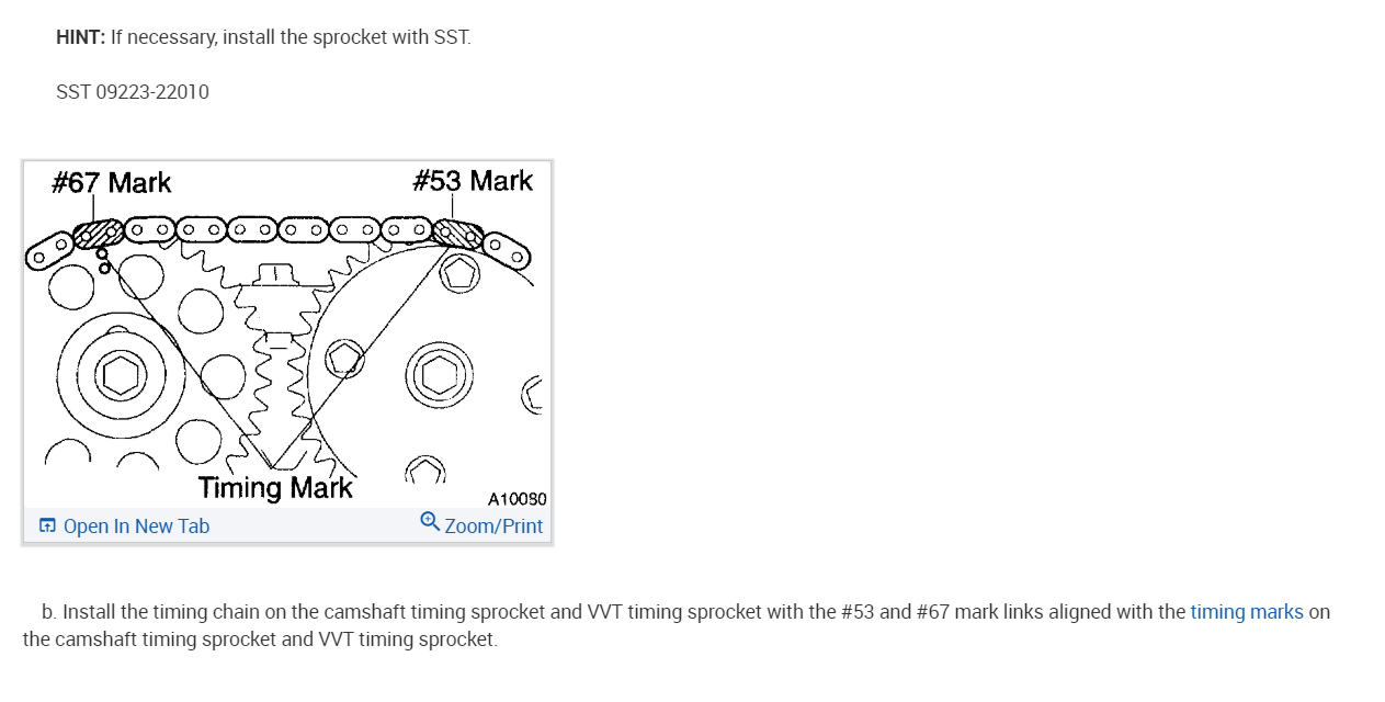

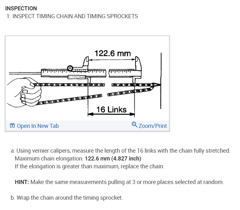

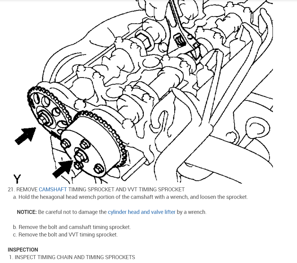

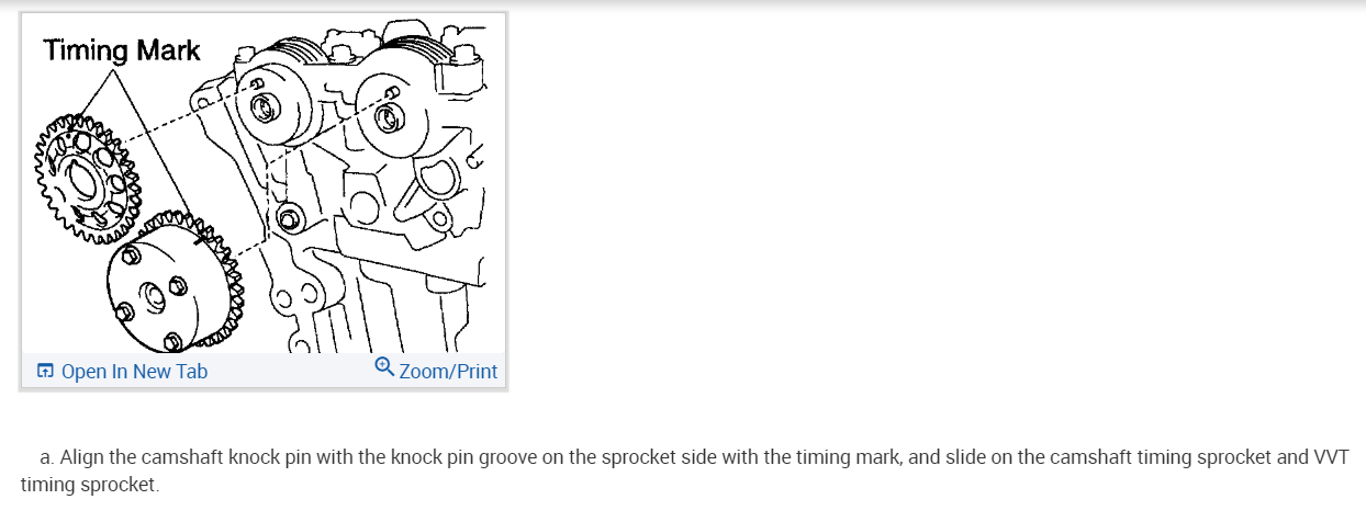

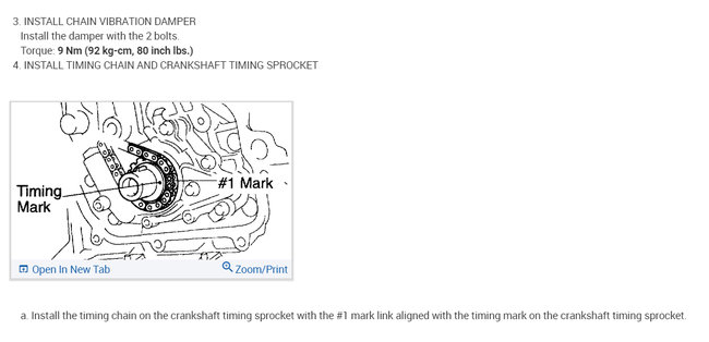

Hello wilsaaw 1ZZ-FE Engines Remove or disconnect the following: Negative battery cable Right engine cover Accessory drive belt and generator Power steering pump, without disconnecting the hoses Right engine mount Cylinder head cover Turn the crankshaft so the No. 1 piston is at TDC on the compression stroke Crankshaft pulley Crankshaft position sensor from the timing chain cover Accessory drive belt tensioner Right engine mounting bracket Chain tensioner Water pump Timing chain cover Crankshaft angle sensor plate Timing chain tensioner slipper Timing chain and crankshaft timing sprocket To install: Crankshaft sprocket with timing chain. Be sure to align the No. 1 mark link with the mark on the sprocket

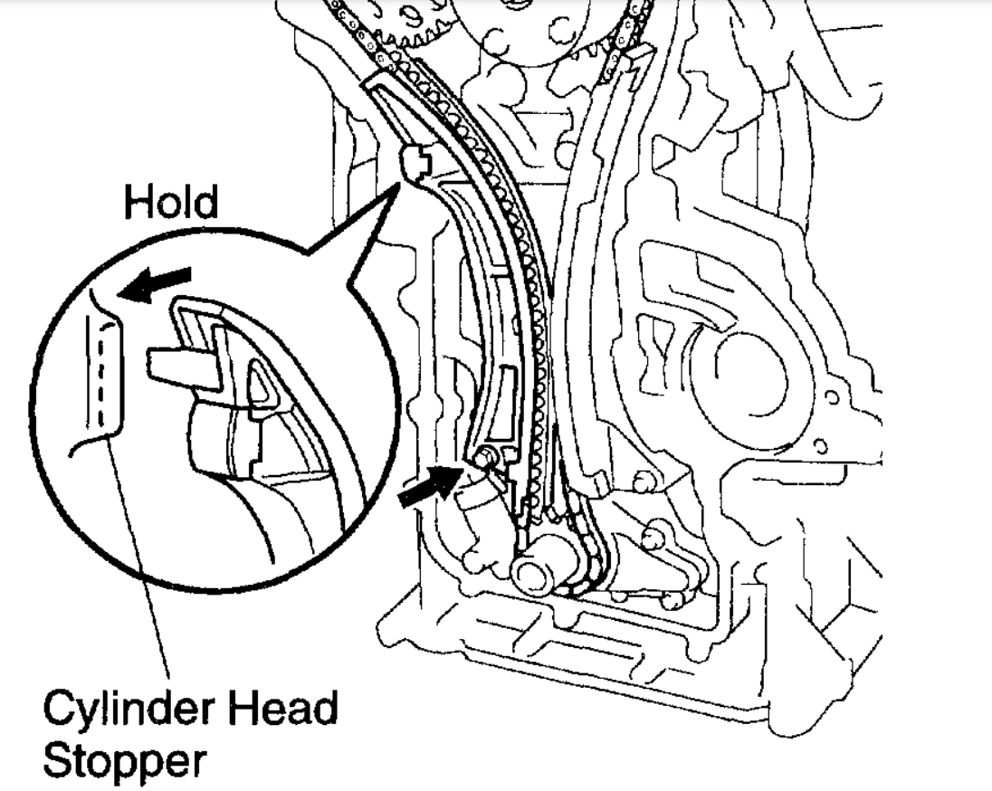

https://www.2carpros.com/forum/automotive_pictures/46384_0996b43f8022f83c_2.jpg

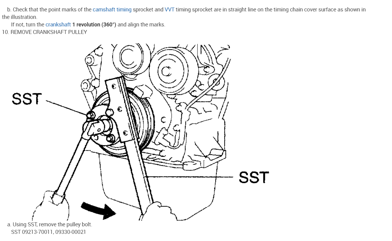

Timing chain on the camshaft sprockets. Align the Nos. 53 and 67 mark links with the marks on the camshaft sprockets
https://www.2carpros.com/forum/automotive_pictures/46384_0996b43f8022f83c_3.jpg

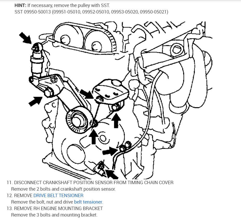

Chain tensioner slipper. Bolt: 14 ft. lbs. (18.5 Nm). Crankshaft angle sensor plate New seal in the front cover Silicone sealant to the timing chain cover as illustrated Timing chain cover Water pump. Tighten the bolts marked -C- to 80 inch lbs. (9 Nm) and tighten the remaining bolts to 14 ft. lbs. (18.5 Nm). Be sure to install the bolts in their original locations. Bolt lengths: 1. A: 1.77 in. (45mm) 2. B: 1.38 in. (35mm) 3. C: 1.18 in. (30mm) 4. D: 0.98 in. (25mm)
https://www.2carpros.com/forum/automotive_pictures/46384_0996b43f8022f83c_4.jpg
Install or connect the following: Right engine mounting bracket. Bolts, with sealant applied: 35 ft. lbs. (47 Nm). Drive belt tensioner. Bolt: 51 ft. lbs. (69 Nm). Nut: 21 ft. lbs. (29 Nm). Crankshaft position sensor. Tighten to 80 inch lbs. (9 Nm). Crankshaft pulley. Bolt: 102 ft. lbs. (138 Nm). Release the ratchet pawl and compress the chain tensioner. Place the hook on the pin to keep the tensioner compressed.
https://www.2carpros.com/forum/automotive_pictures/46384_0996b43f8022f83c_5.jpg
# Install the tensioner, using a new O-ring. Torque the bolts to 80 inch lbs. (9 Nm). # Turn the crankshaft counterclockwise and remove the hook from the pin. Turn the crankshaft clockwise and be sure the slipper is pushed by the plunger. # Check the valve timing by turning the crankshaft clockwise until the mark of the pulley is aligned with the mark on the timing chain cover. The marks on the camshaft sprockets should be facing each other as shown. # Install or connect the following: Silicone sealant to the 2 areas where the timing chain cover meets the cylinder head. Cylinder head cover. Bolts with washers in the sequence shown: 80 inch lbs. (9 Nm). Bolts without washers: 96 inch lbs. (11 Nm). Right engine mount. Bolts: Marked A : 47 ft. lbs. (64 Nm). Marked B : 19 ft. lbs. (26 Nm). Nut: 38 ft. lbs. (52 Nm). Power steering pump Alternator and drive belt Right engine undercover Negative battery cable Washer tank # Fill the cooling system to the proper level. # Start the vehicle, check for leaks and repair if necessary. hope this help.

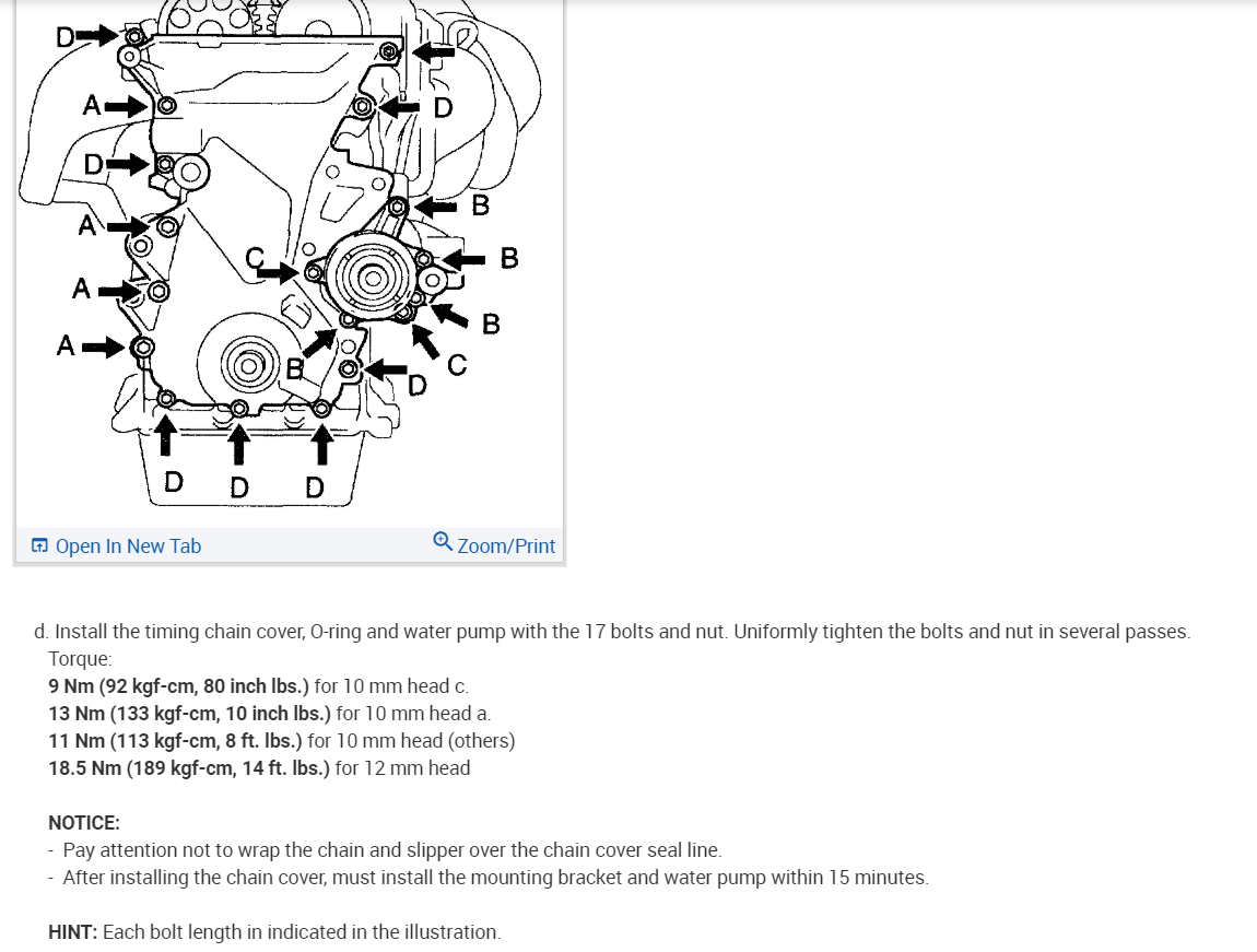

BLUELIGHTNIN6
  • 16,542 POSTS

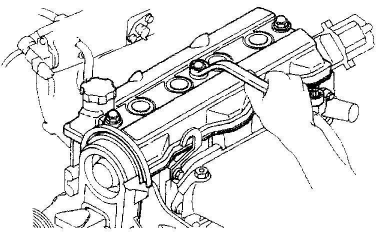

REMOVAL:
Disconnect the negative battery cable. Wait at least 90 seconds once the cable is disconnected to hinder air bad deployment.
Remove the right front wheel and engine under covers.
Slightly jack up the engine on the right side to remove the RH engine mount. Inspect the mount and replace if necessary.
Remove all drive belts.
Remove the valve cover.
While retaining the crankshaft pulley, remove the pulley bolt. Extract the crankshaft pulley using a puller.
Unbolt all three timing belt covers from the engine.
INSTALLATION:
Check that the timing belt gasket has no cracks or peeling. If the gasket is not reusable do the following:
Using a flat-bladed tool and gasket scraper, remove the old gasket material from the cover and mating area.
Thoroughly clean all components to remove all the loose material. Remove the backing paper from the new gasket and install the gasket evenly to the part of the cover shaded black in the illustration.
After installing the gasket, press down on it so it seats and the adhesive firmly sticks.
Install all three timing belt covers and tighten the bolts to 62 inch lbs. (7 Nm).
Install the new valve cover gasket and seal washers to the cylinder head cover.
Install the cylinder head cover to the cylinder head; secure with four cap nuts to 53 inch lbs. (6 Nm).
Install two PCV hoses to the valve cover; secure with hose clamps.
Attach the engine wiring harness to the valve cover, then install the engine wiring harness cover and secure to 53 inch lbs. (6 Nm).
Connect the wire and clamp to the alternator.
Install and adjust all the drive belts.
Install engine mount to body and secure but do not tighten fully. Tighten the following:
Mounting bracket-to-engine mount bolt to 47 ft. lbs. (64 Nm)
Mounting bracket-to-engine mount nuts to 38 ft. lbs. (52 Nm)
Engine mount-to-body bolt A to 19 ft. lbs. (25 Nm)
Engine mount-to-body bolts B to 19 ft. lbs. (25 Nm)
Engine mount-to-body bolt C to 19 ft. lbs. (25 Nm), if equipped with cruise control.
Install the right engine undercover.
Install the right front wheel and lower the vehicle.
Connect the negative battery cable.
Start the engine and check the ignition timing. Inspect for leaks and check vehicle operation.
Thanks for using 2CarPros.com!

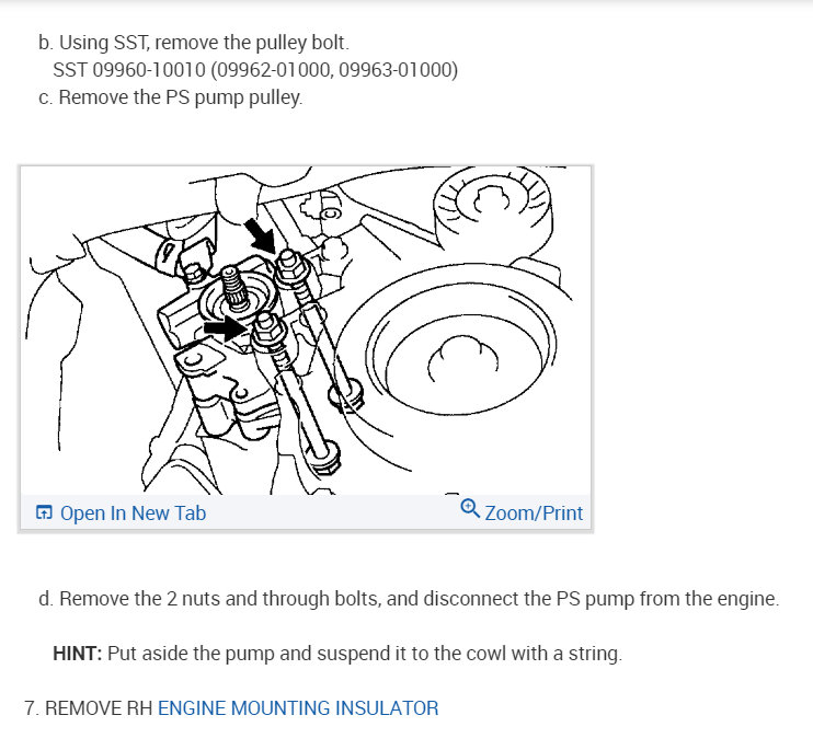

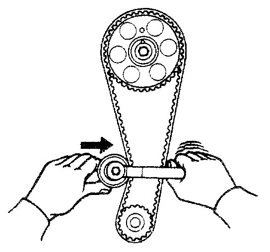

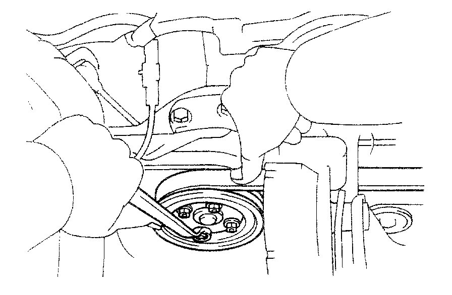

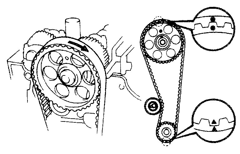

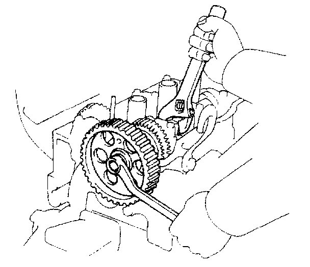

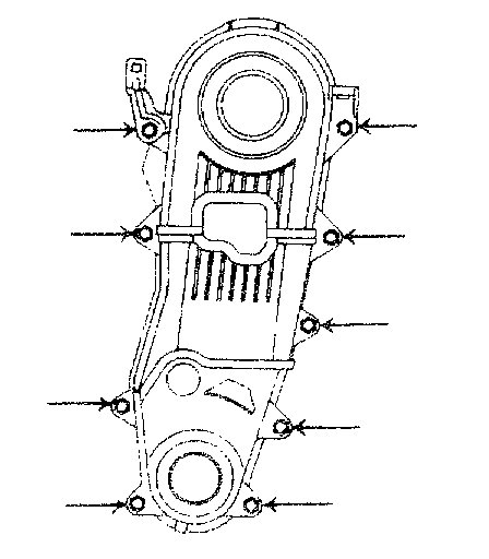

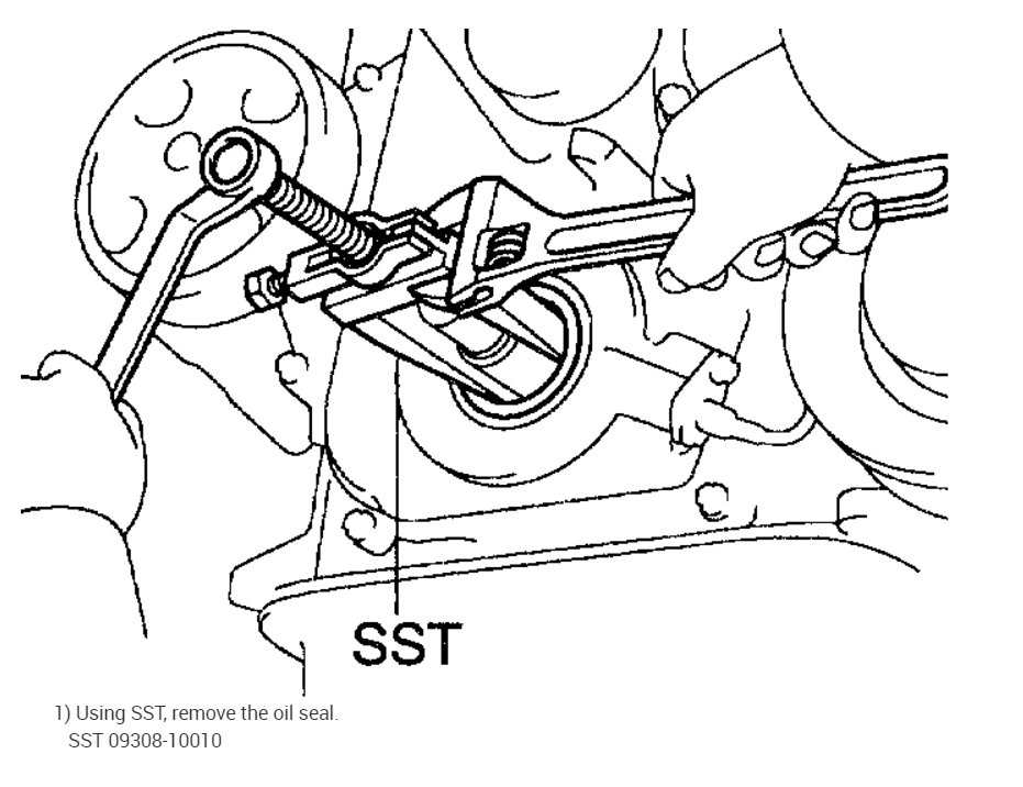

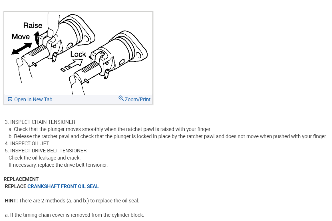

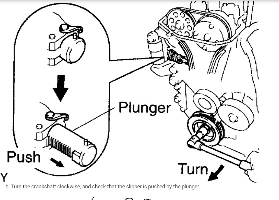

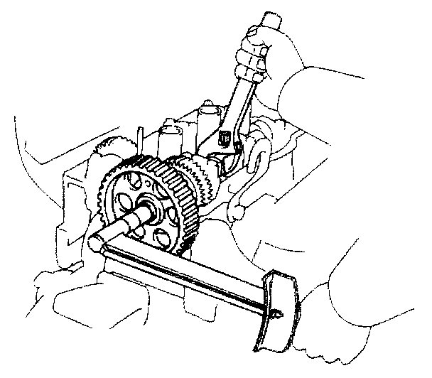

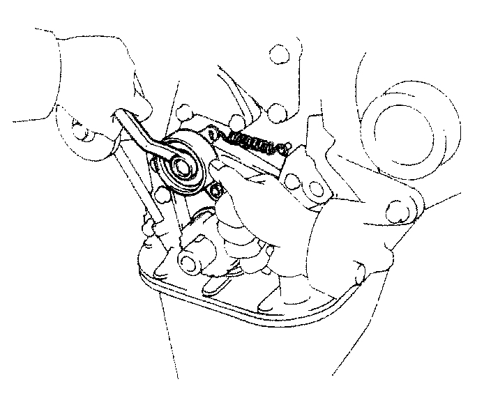

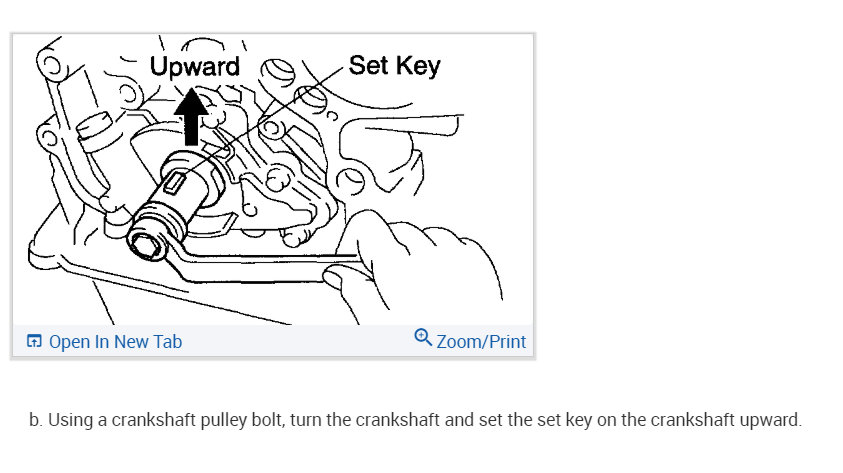

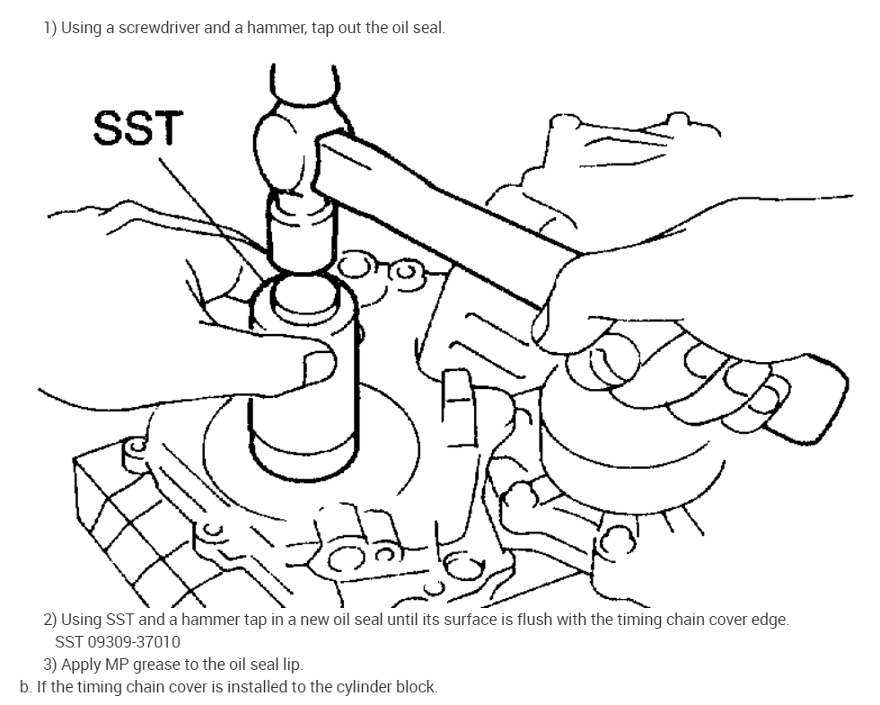

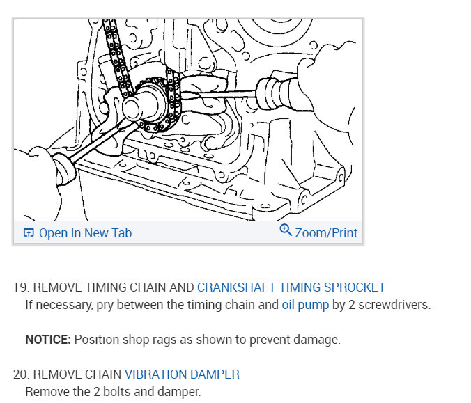

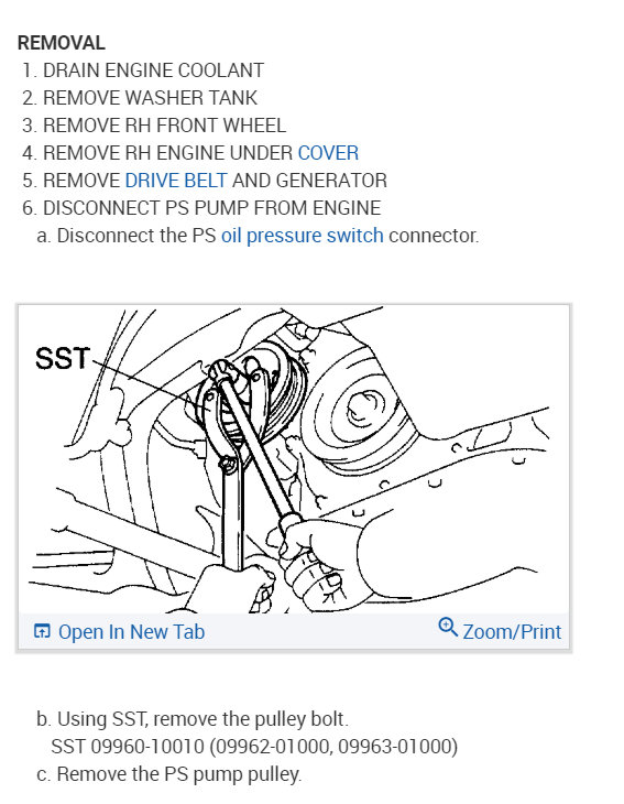

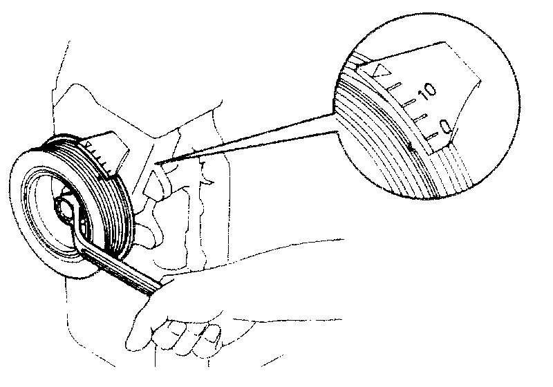

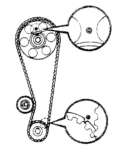

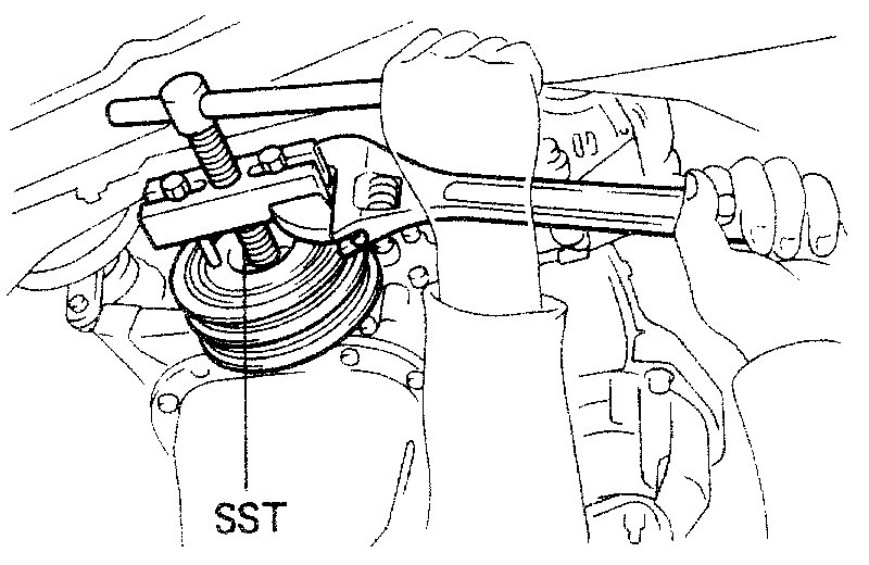

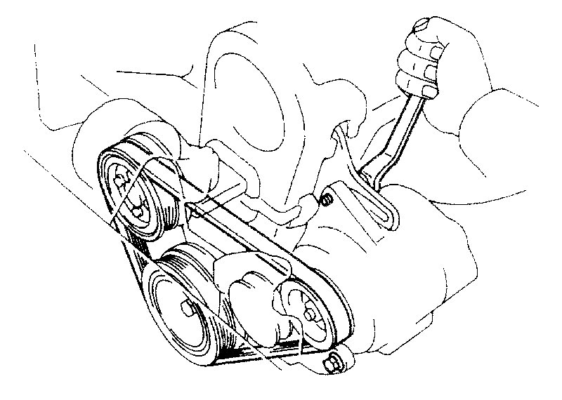

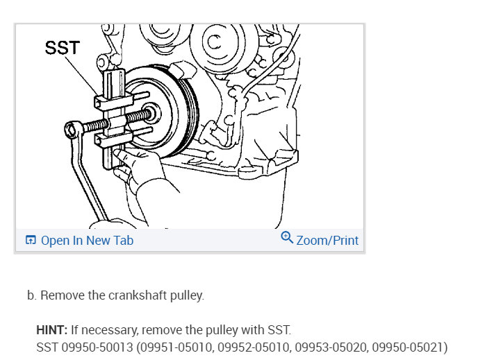

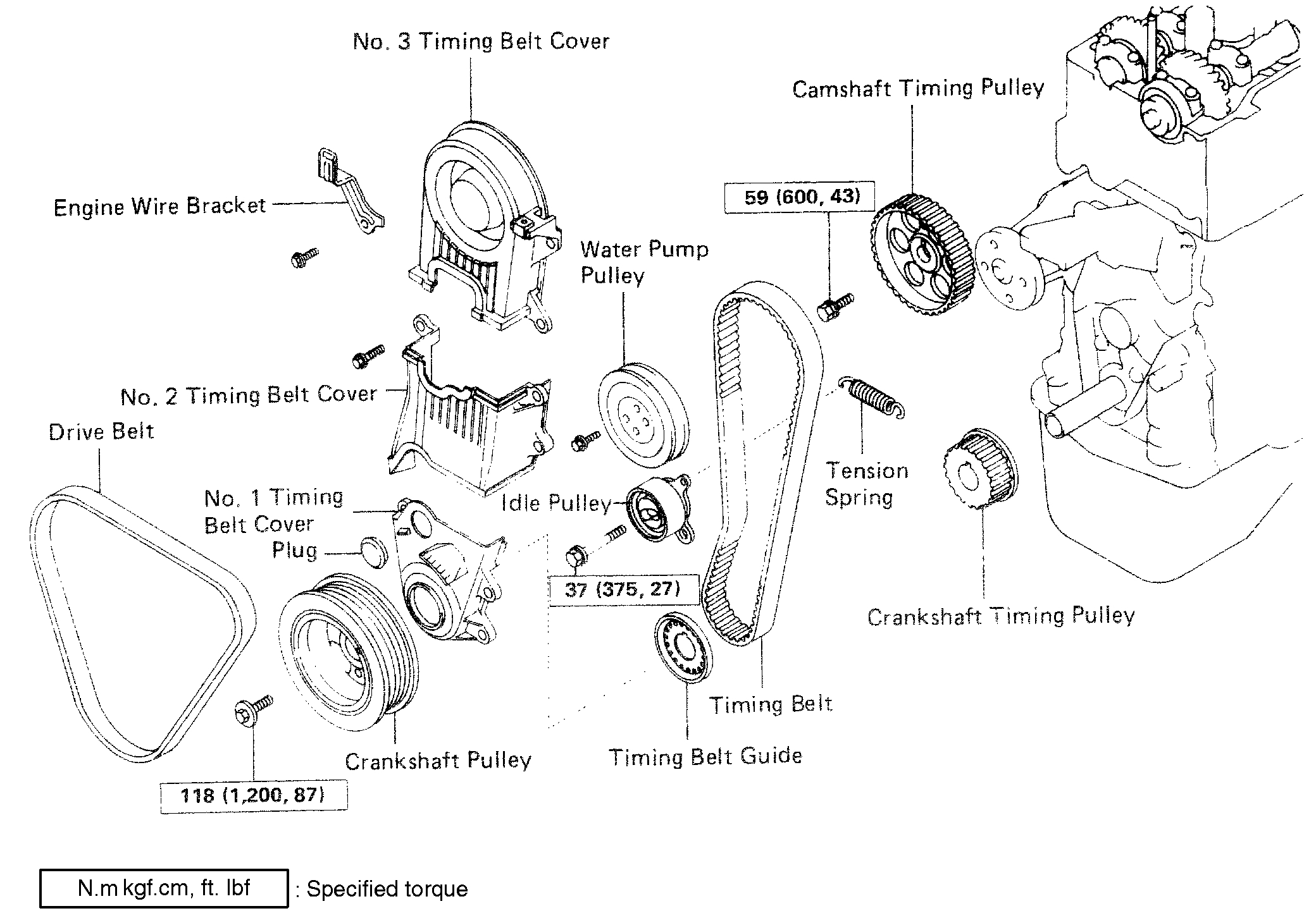

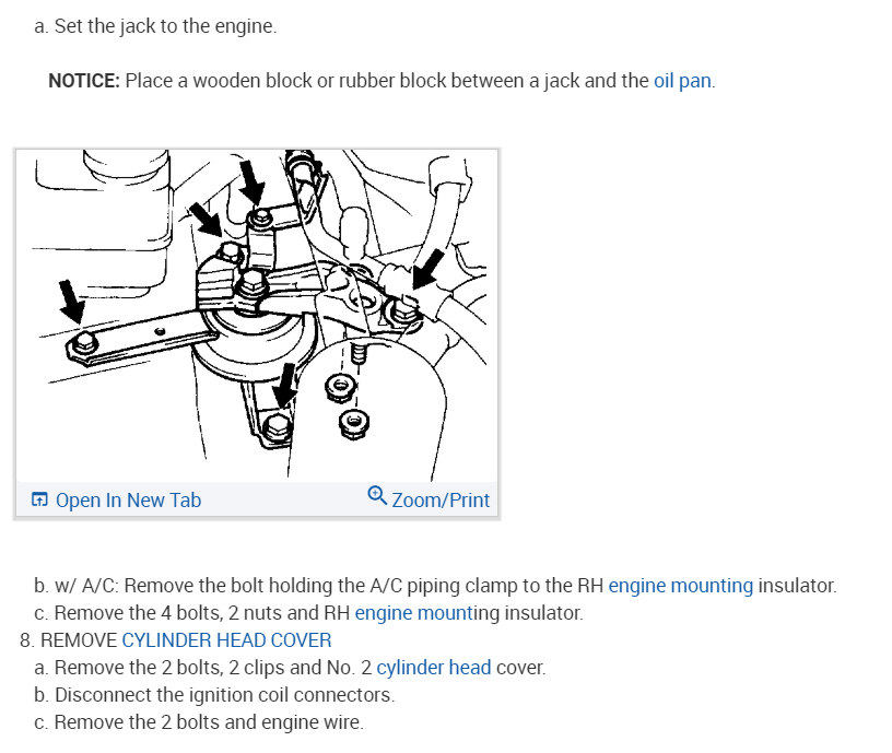

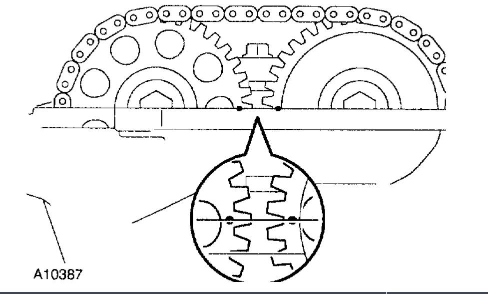

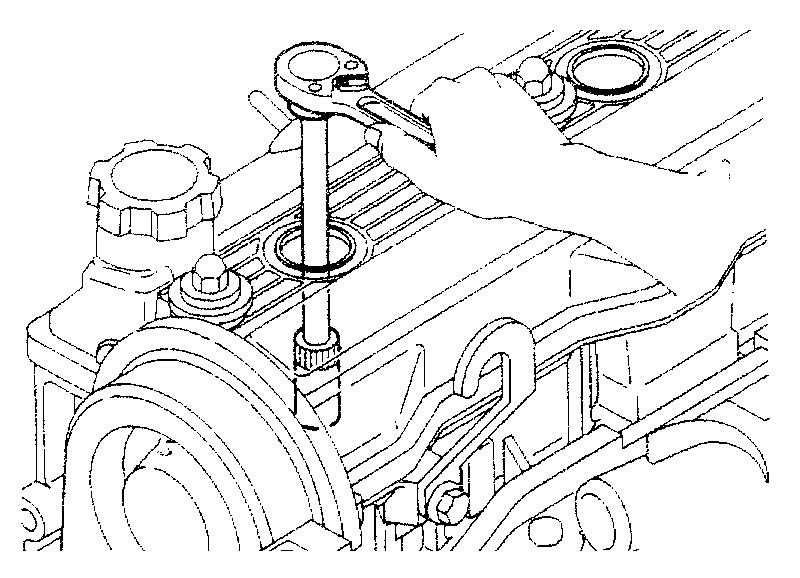

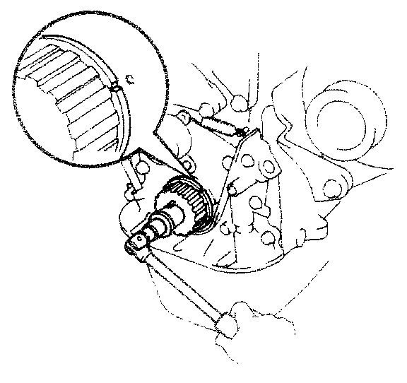

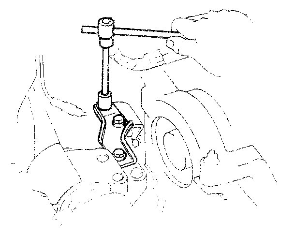

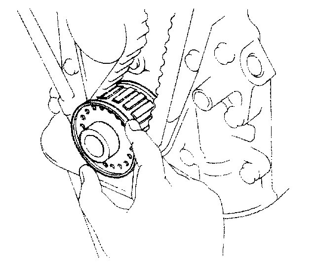

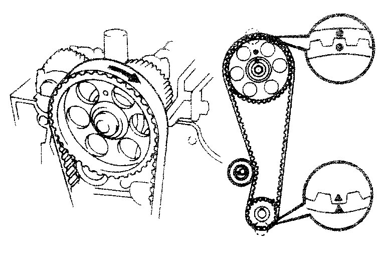

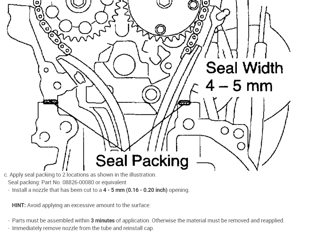

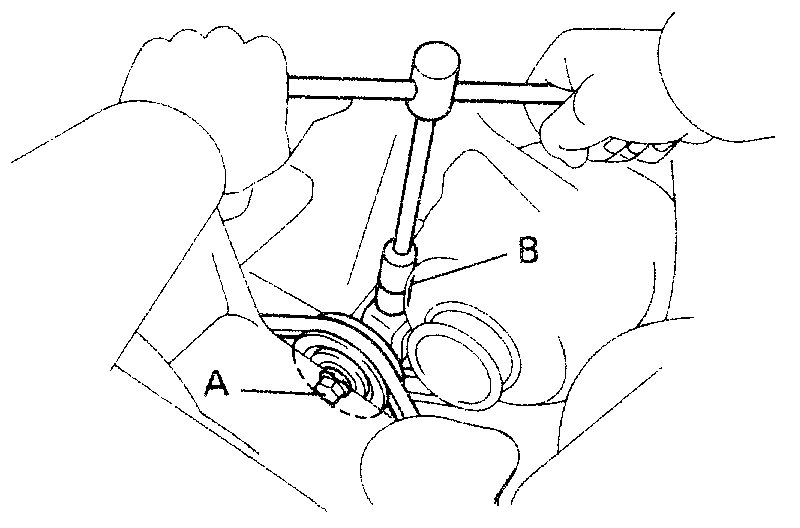

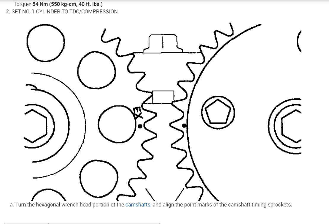

If you look at the first picture below, it shows the timing marks. If you are replacing the belt, here are the directions for removal and replacement. All pics correlate with the directions.
___________________________
1992 Toyota Corolla Sedan L4-96.8 1587cc 1.6L DOHC (4A-FE)
Timing Belt Removal
Vehicle Engine, Cooling and Exhaust Engine Timing Components Timing Belt Service and Repair Procedures Timing Belt Replace Timing Belt Removal
TIMING BELT REMOVAL

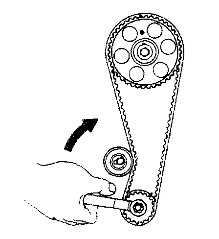

pic 2
REMOVAL OF TIMING BELT

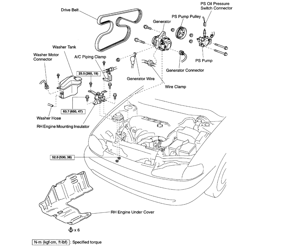

1. Remove RH front wheel.
2. Remove RH engine under cover.
3. Remove washer tank.

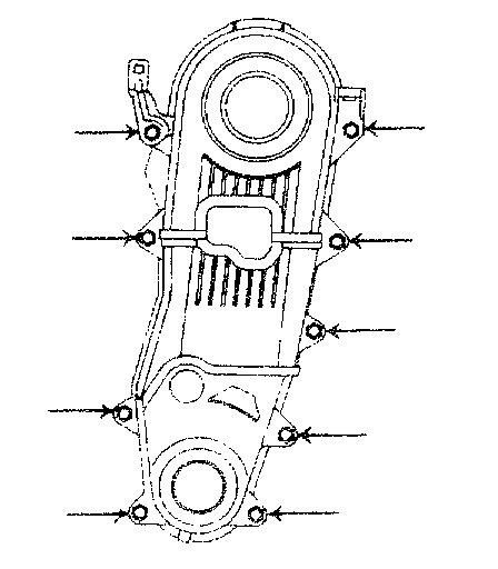

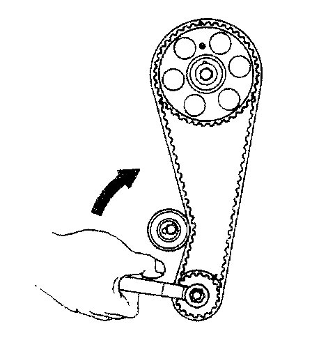

4. Loosen water pump pulley bolts and remove alternator drive belt.

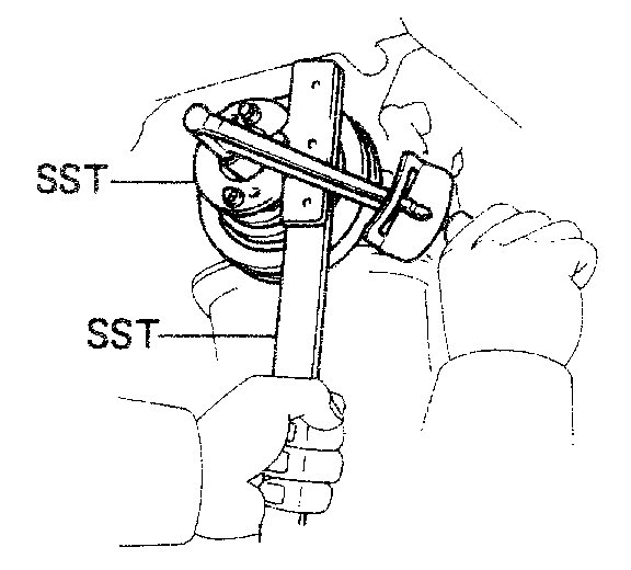

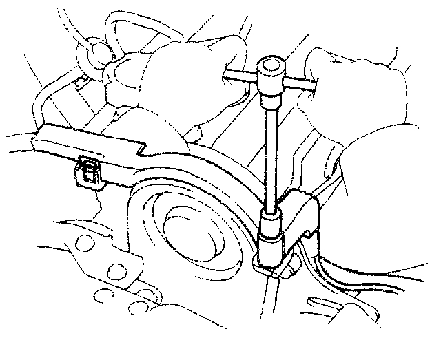

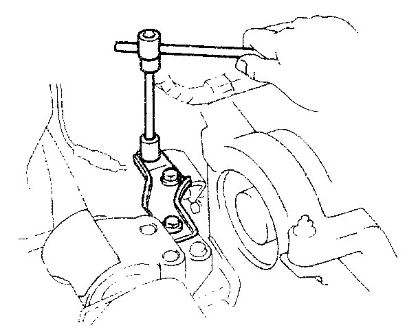

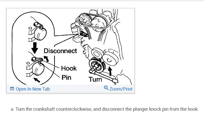

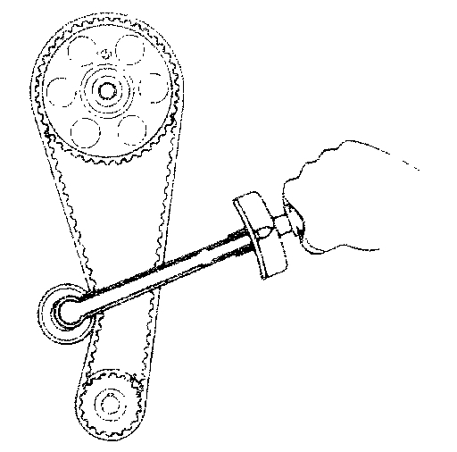

Pic 3
(a)Stretch the belt tight and loosen the water pump pulley bolts.

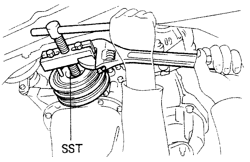

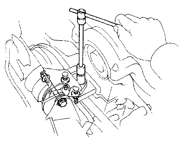

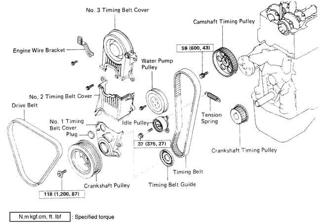

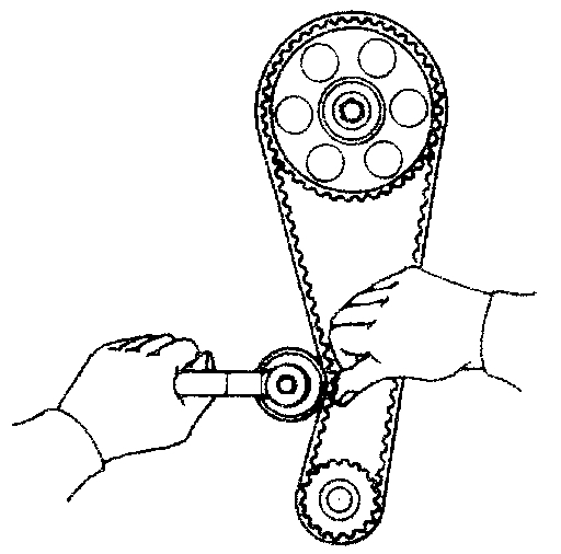

Pic 4

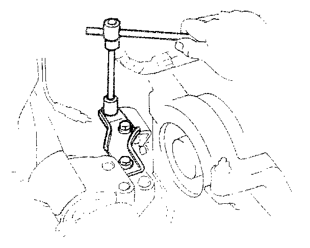

(b)Loosen the pivot nut and adjusting bolt, and remove drive belt.

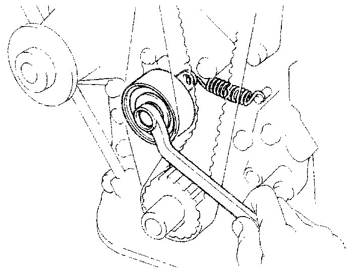

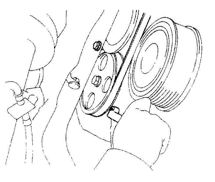

Pic 5

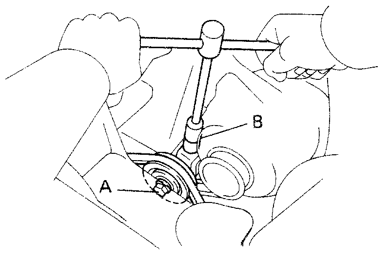

5. On vehicles with A/C, remove A/C compressor drive belt.
(a)Loosen the idler pulley mounting bolt A.
(b)Loosen the adjusting bolt B and remove the drive belt
pic 6
6. On vehicles with PS, remove PS pump drive belt.
(a)Loosen the pivot and lock bolts.
(b)Swing PS pump toward the engine and remove the drive belt.
Pic 7

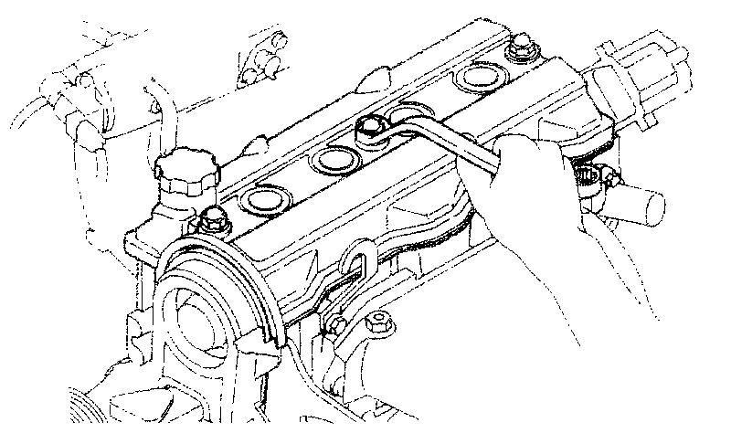

9. Remove cylinder head cover.
(a)Disconnect the PCV hoses from the cylinder head cover.
(b)Remove the three cap nuts, grommet and cylinder head cover with the gasket.

10. Set No.1 cylinder at TDC/Compression.
(a)Turn the crankshaft pulley and align its groove with the No.1 timing belt cover.
(b)Check that the valve lifters on the No.1 cylinder are loose If not, turn the crankshaft pulley one complete revolution (360 ).

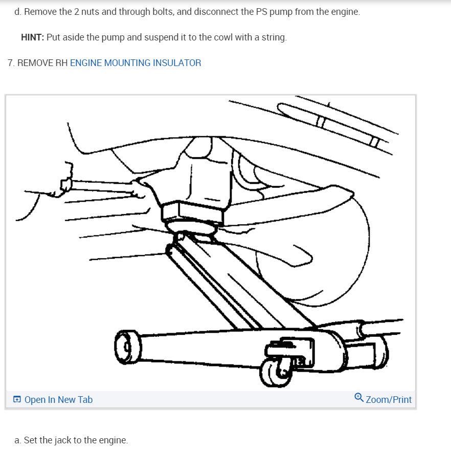

11. Remove RH engine mounting insulator.
Pic 11

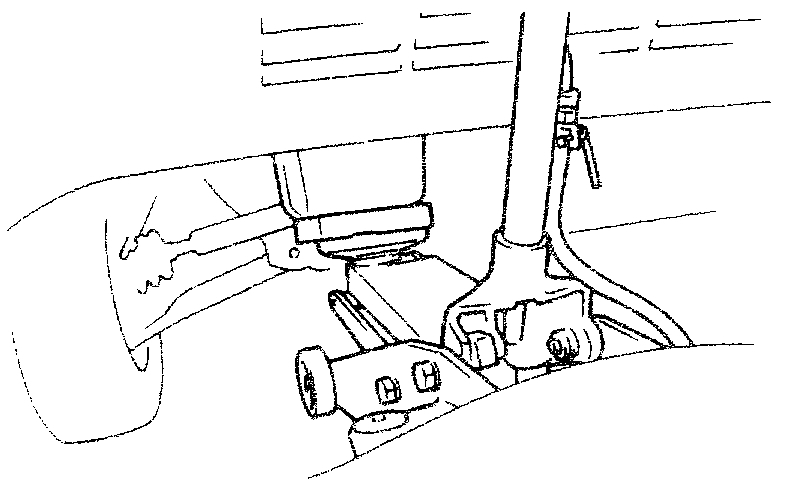

(a)Set the jack to the engine.
HINT: Place a wooden block between the jack and engine.
Pic 12
(b)Remove the three bolts and mounting stay.
Pic 13
(c)Remove the bolt, two nuts, through bolt and RH mounting.
12. Remove water pump pulley.
13. Remove crankshaft pulley.
Pic 14
(a)Using SST 09213-14010 and 09330-00021 to hold the crankshaft pulley, remove the pulley bolt.
Pic 15
(b)Using SST 09213-31021, remove the pulley.
Pic 16
14. Remove timing belt covers.
Remove the nine bolts engine wire bracket and timing belt covers.
15. Remove timing belt guide.
16. Remove timing belt and idler pulley.
Pic 17
HINT: If reusing the timing belt, draw a direction arrow on the belt (in direction of engine revolution), and place matchmarks on the pulleys and belt as shown in the Illustration.
Pic 18
(a)Remove the bolt, idler pulley and tension spring.
(b)Remove the timing belt.
17. Remove crankshaft timing pulley.
Pic 19
18. Remove camshaft timing pulley.
Hold the hexagonal head wrench portion of the camshaft with a wrench, and remove the bolt and timing pulley.
NOTICE: Be careful not to damage the cylinder head with the wrench.

INSTALLATION OF TIMING BELT
1. Install camshaft timing pulley.
(a)Align the camshaft knock pin with the knock pin groove of the pulley, and slide on the pulley.
(b)Temporarily install the timing pulley bolt.
Pic 21
(c)Hold the hexagonal wrench head portion of the camshaft with a wrench, and tighten the timing pulley bolt.
Torque: 59 N.M (600 kgf. Cm, 43 ft. Lbf)
pic 22
(d)Turn the hexagonal wrench head portion of the camshaft, and align the hole of the camshaft timing pulley with the timing mark of the bearing cap.
Pic 23
2. Install crankshaft timing pulley.
(a)Align the pulley set key with the key groove of the pulley.
(b)Slide on the timing pulley, facing the flange side inward.
(c)Using the crankshaft pulley bolt, turn the crankshaft and align the timing marks of the crankshaft timing pulley and oil pump body.
Pic 24
3. Temporarily install idler pulley and tension spring.
(a)Install the idler pulley with the bolt. Do not tighten the bolt yet.
(b)Install the tension spring.
(c)Push the pulley toward the left as far as it will go and tighten the bolt.
4. Install timing belt.
NOTICE: The engine should be cold.
Pic 25
HINT: If reusing the timing belt, align the points marked during removal, and install the belt with the arrow pointing in the direction of engine revolution.
5. Check valve timing and timing belt tension.
Pic 26
(a)Loosen the timing belt idler pulley mounting bolt.
Pic 27
(b)Temporarily install the crank pulley bolt and turn the crankshaft two revolutions from TDC to TDC.
HINT: Always turn the crankshaft clockwise.
Pic 28
(c)Check the valve timing.
Check that each pulley aligns with the marks as shown in the illustration.
Pic 29
(d)Tighten the timing belt idler pulley mounting bolt.
Torque: 37 N.M (375 kgf. Cm 27 ft. Lbf)
(e)Remove the temporarily installed crank pulley bolt.

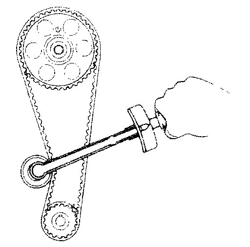

Pic 30

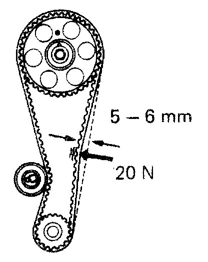

(f)(Reference) Measure the timing belt deflection as shown in the illustration.
Timing belt deflection: 5 - 6 mm (0.20-0.24 in.) At 20 N (2 kgf, 4.4 lbf)
pic 31
(g)If the measured value is not within standard, readjust with the idler pulley.

7. Install the timing belt covers.
(a)Install the timing belt cover with the three bolts.
(b)Install the No.2, No.3 timing belt covers and engine wire bracket with the six bolts.
Torque: 7.4 N.M (75 kgf. Cm, 65 in. Lbf)

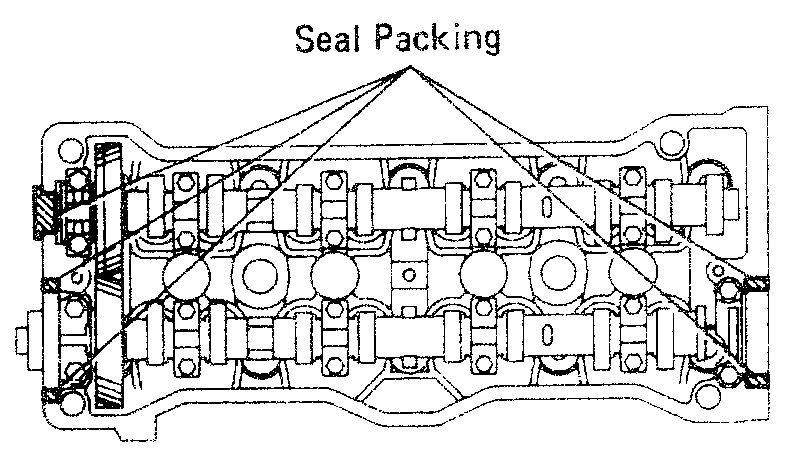

11. Install cylinder head cover.
Pic 37
(a)Apply seal packing as shown in the illustration.
Seal packing: Part No. 08826-00080 or equivalent
HINT: Clean the indicated portions by removing the original sealant before recoating.
