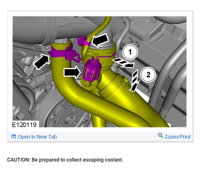

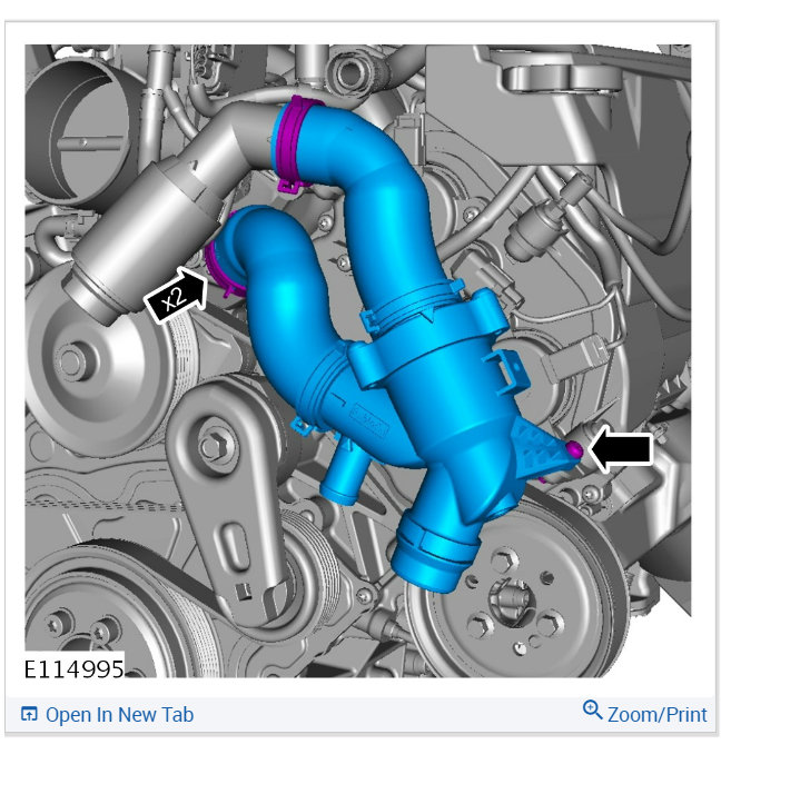

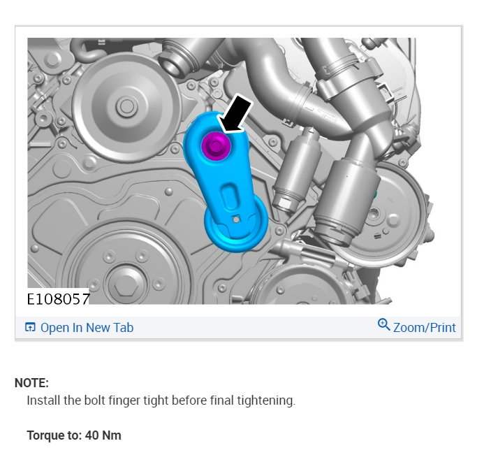

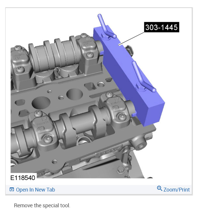

BORIS K
CERTIFIED EXPERT
836 POSTS

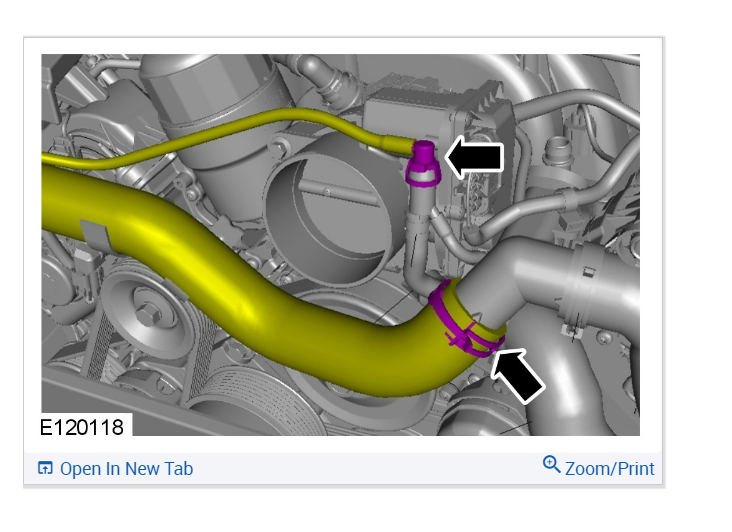

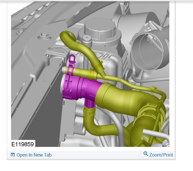

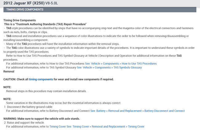

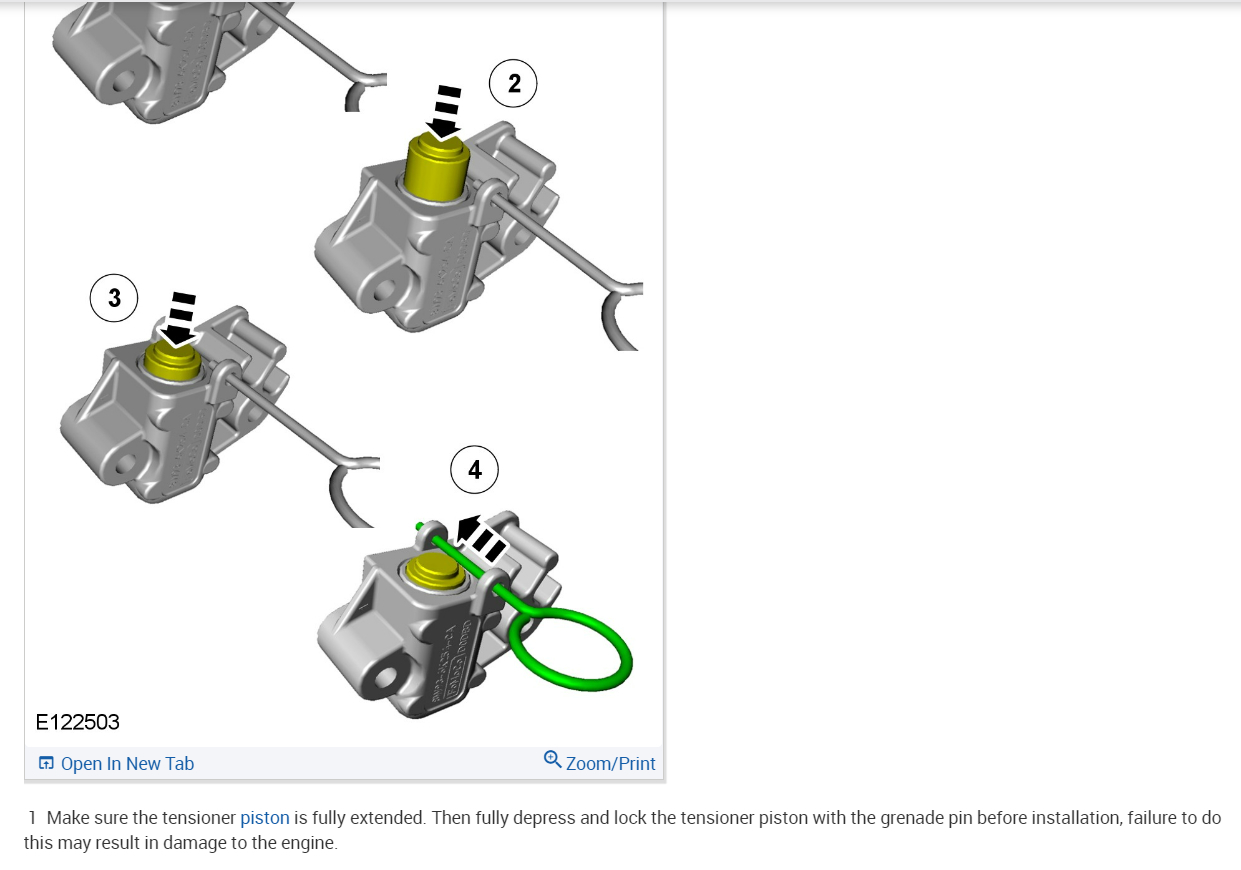

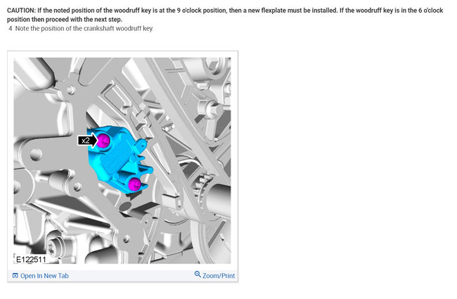

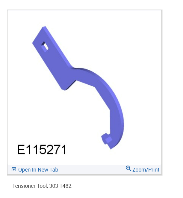

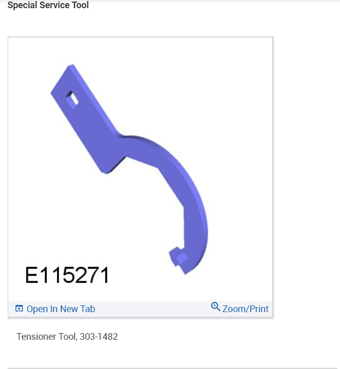

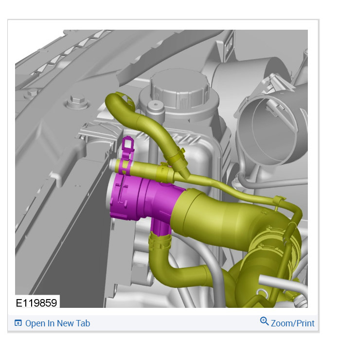

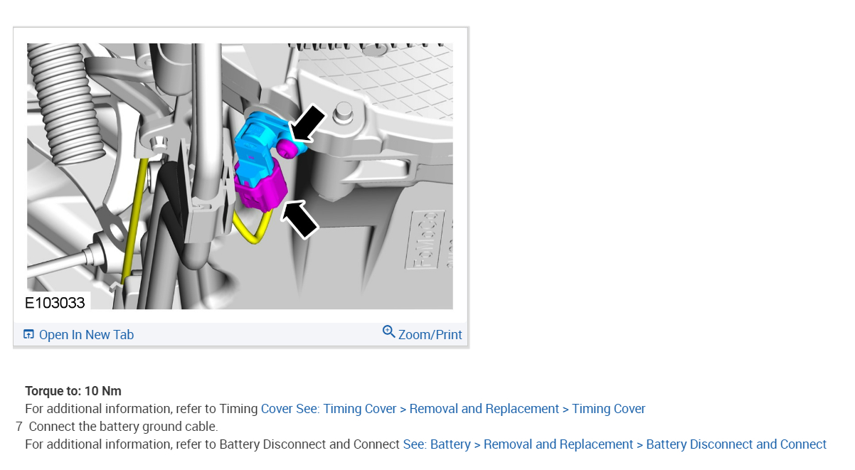

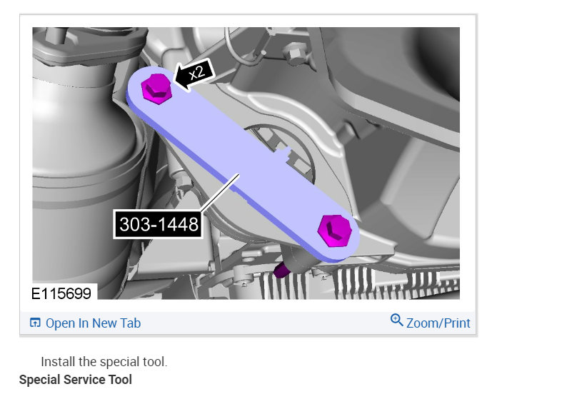

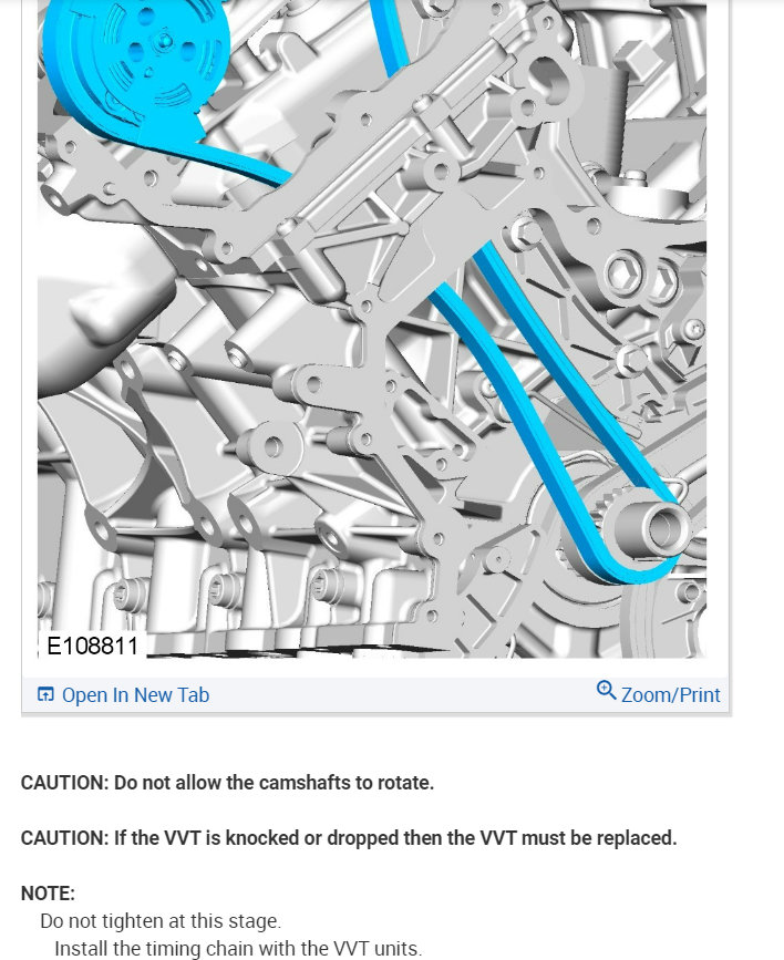

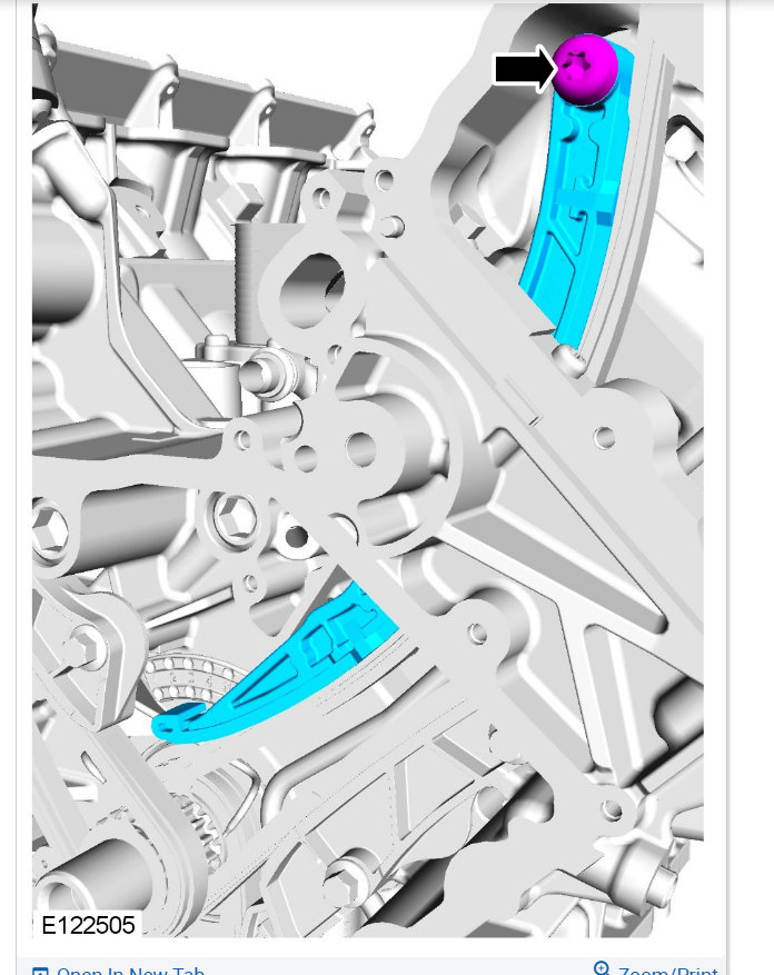

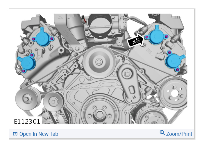

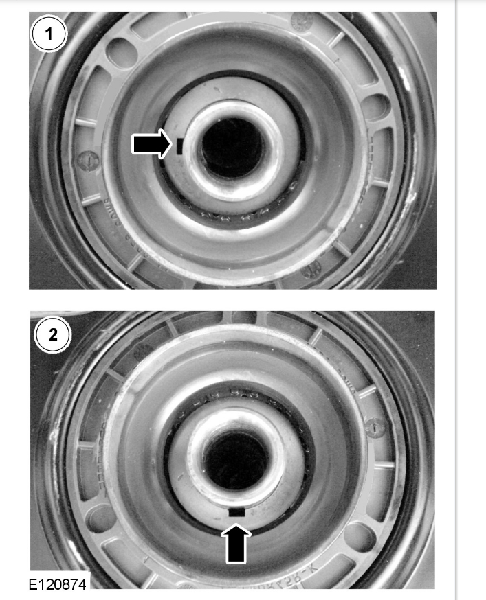

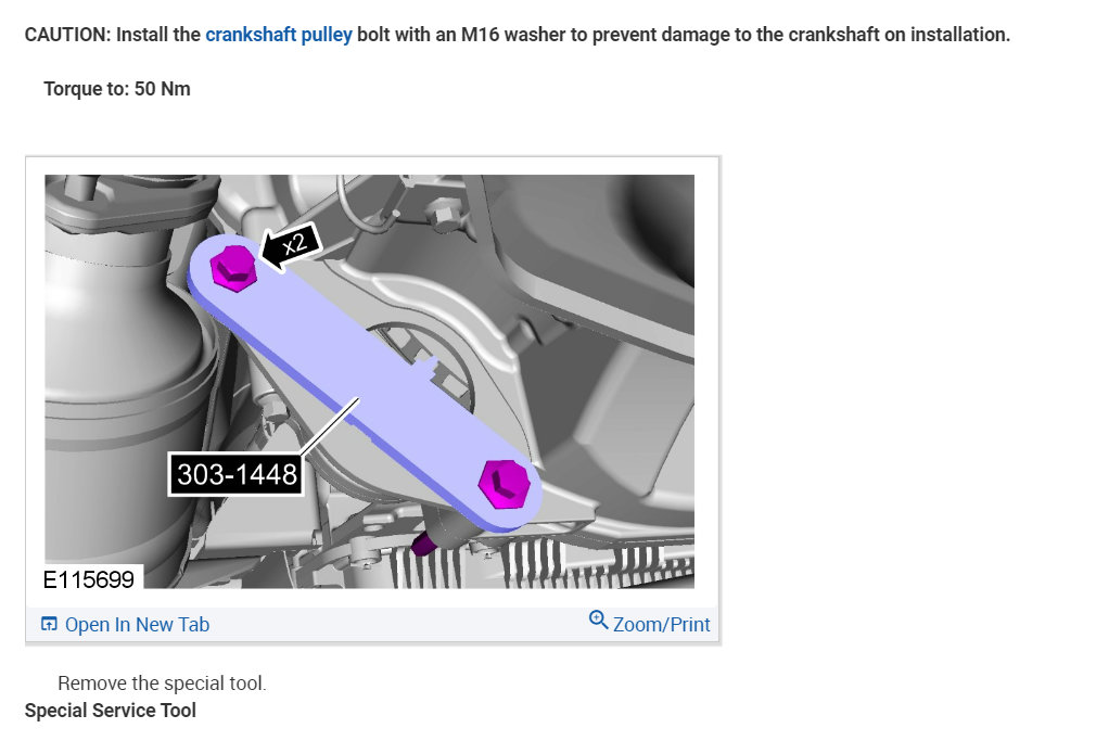

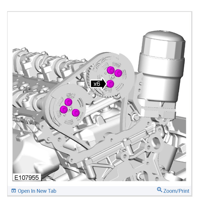

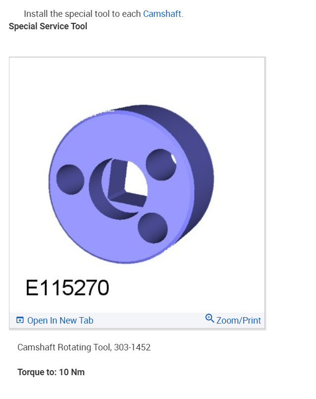

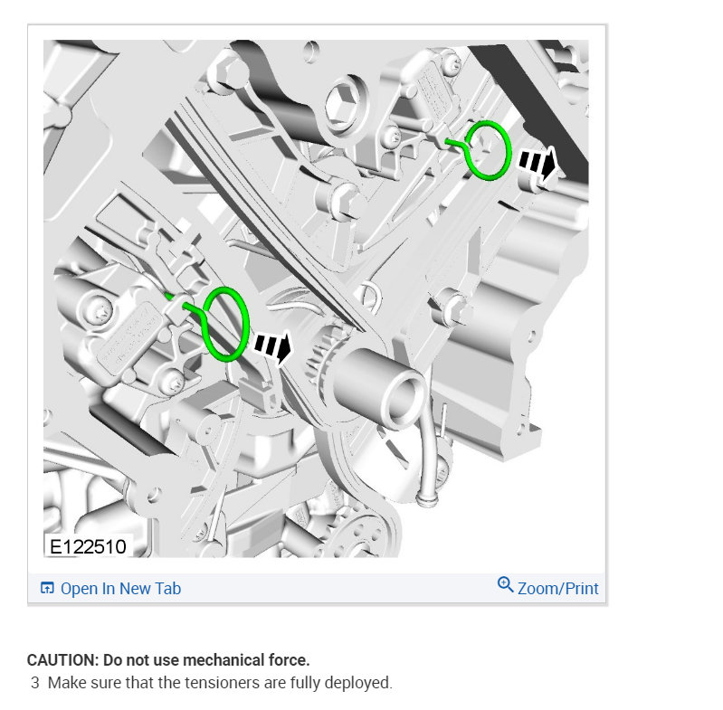

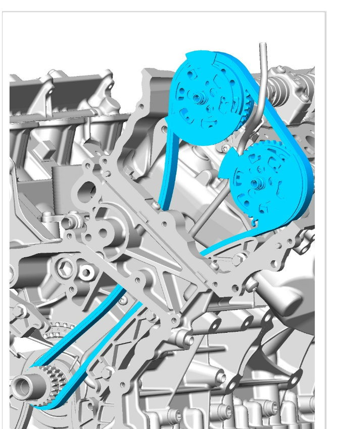

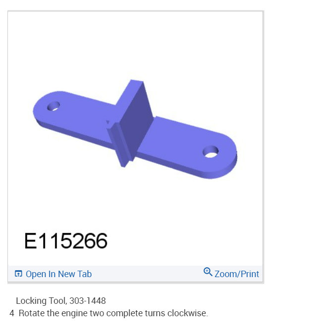

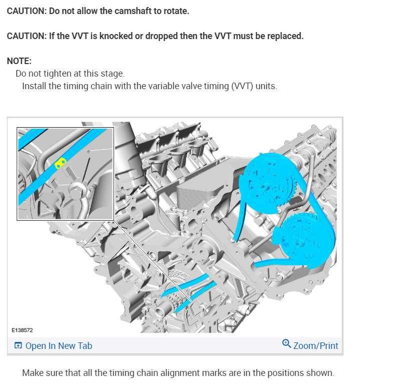

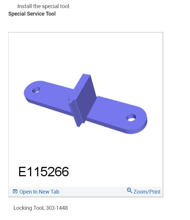

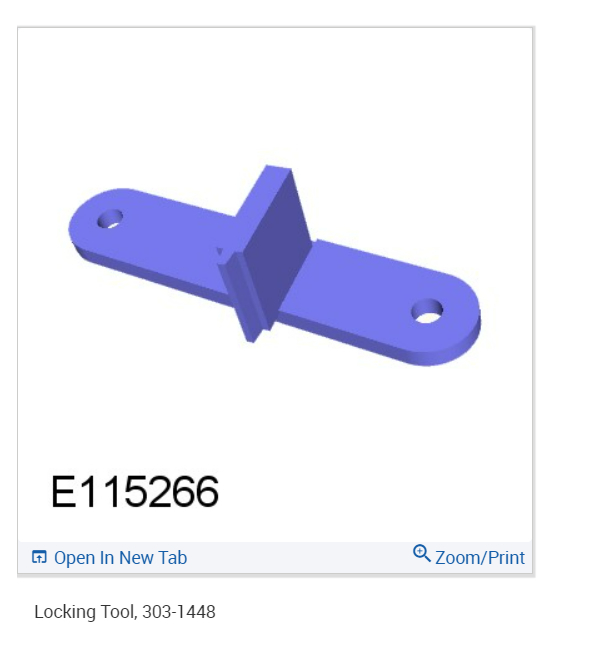

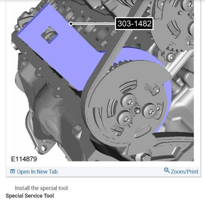

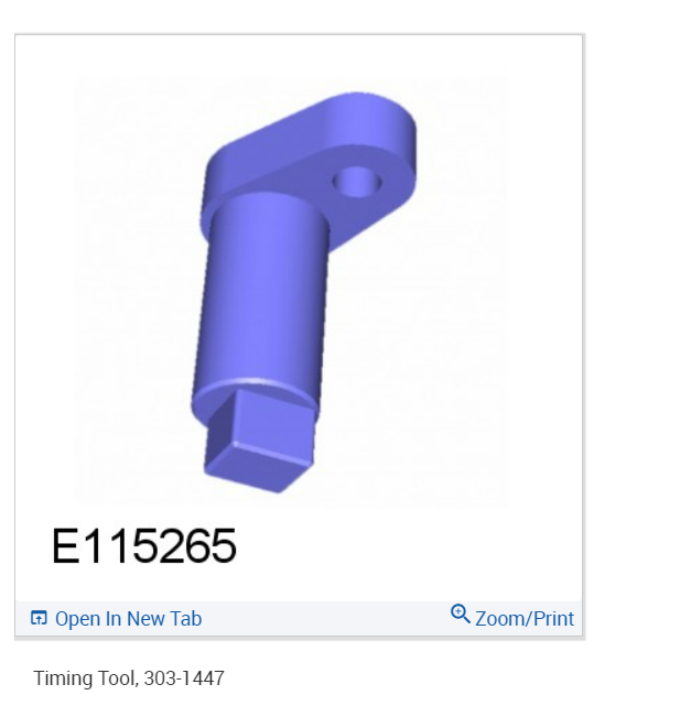

Can you please be more specific as to which information you require?

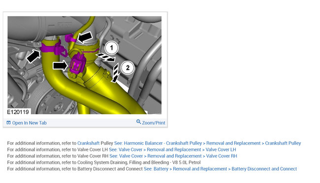

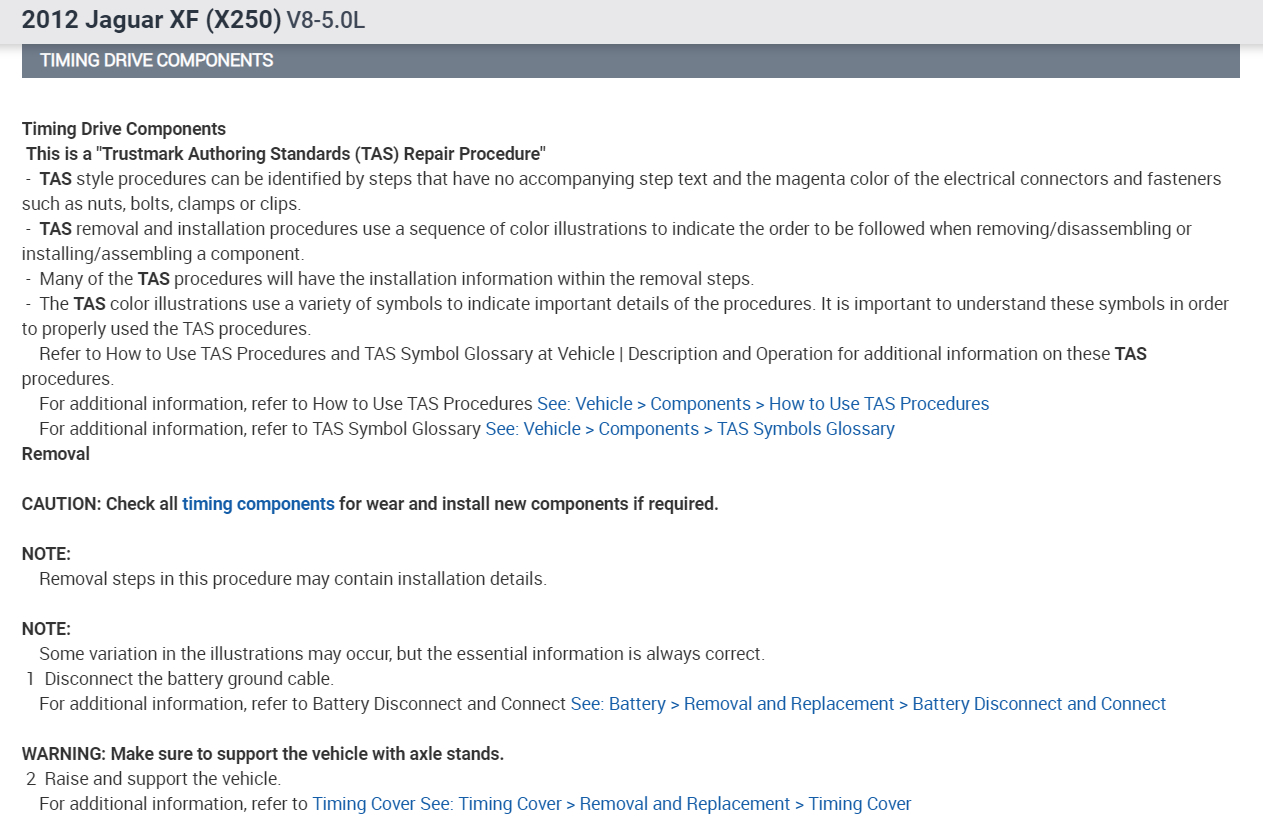

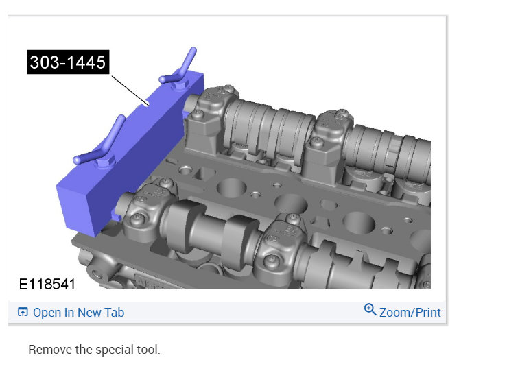

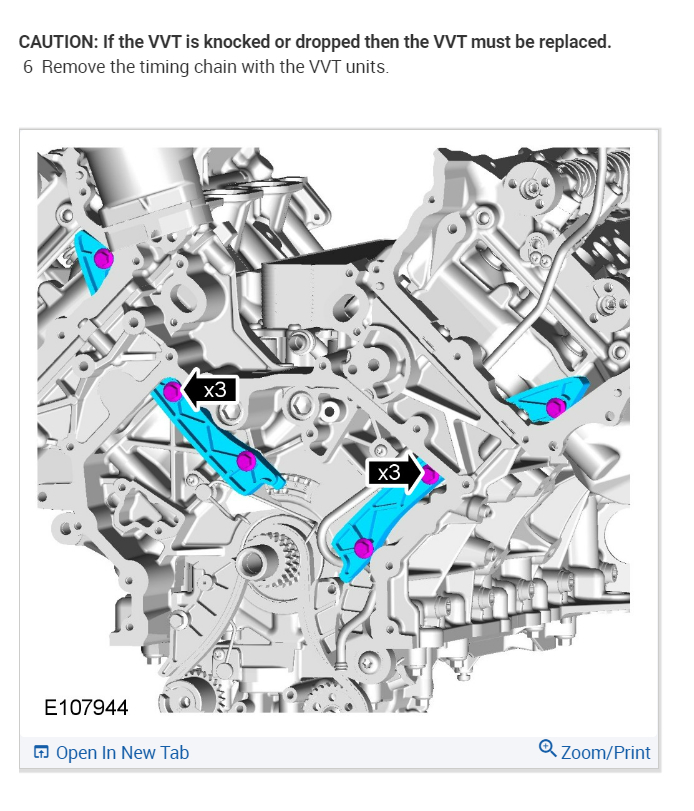

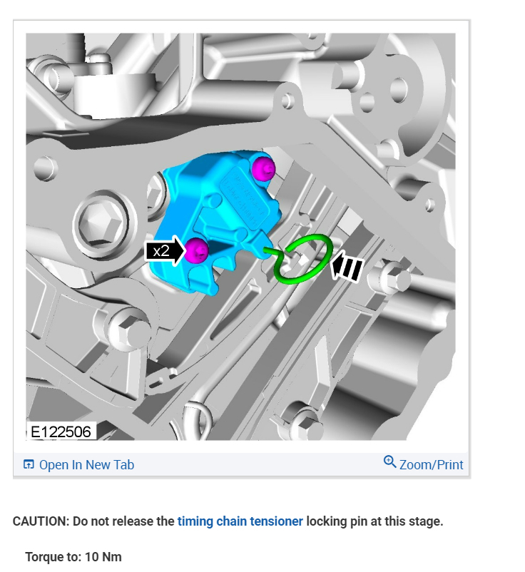

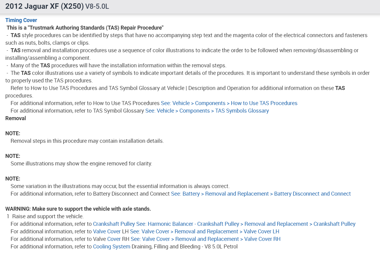

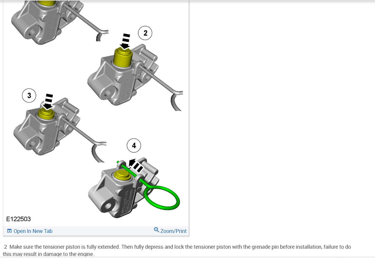

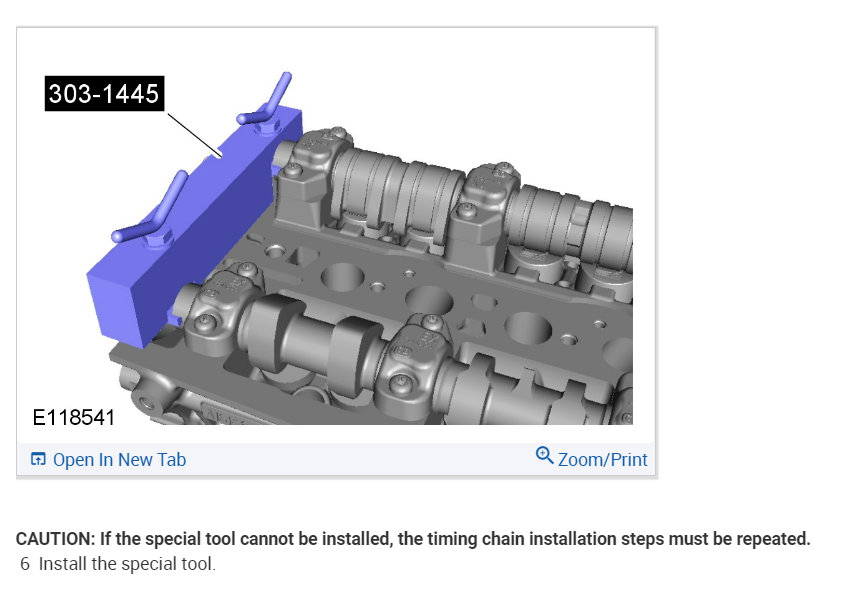

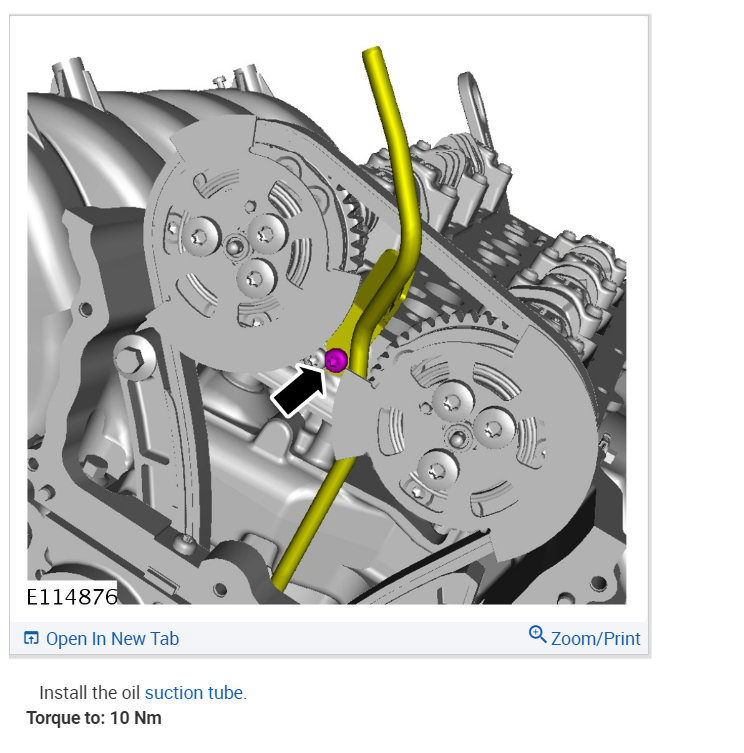

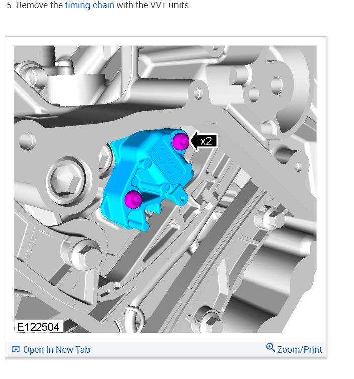

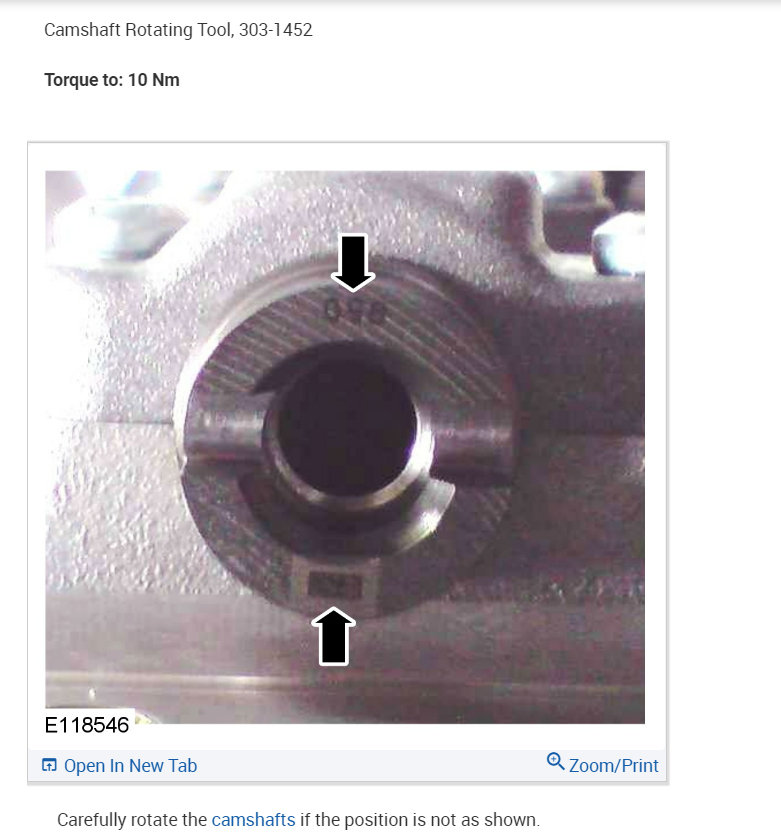

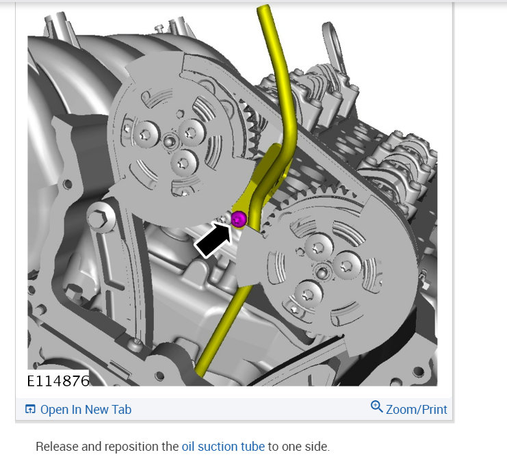

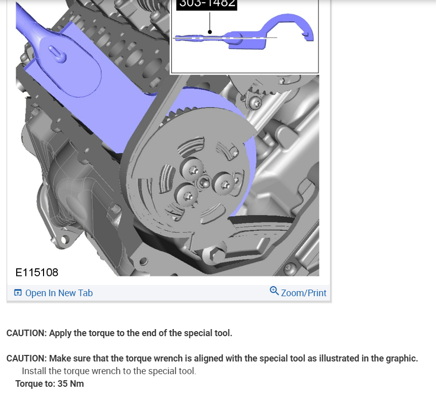

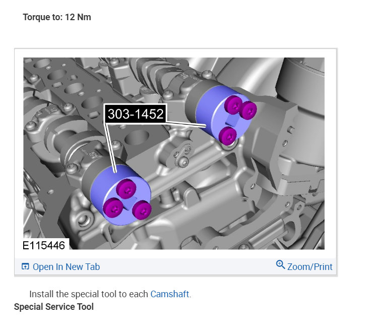

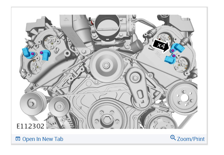

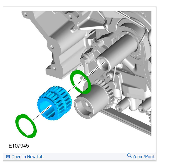

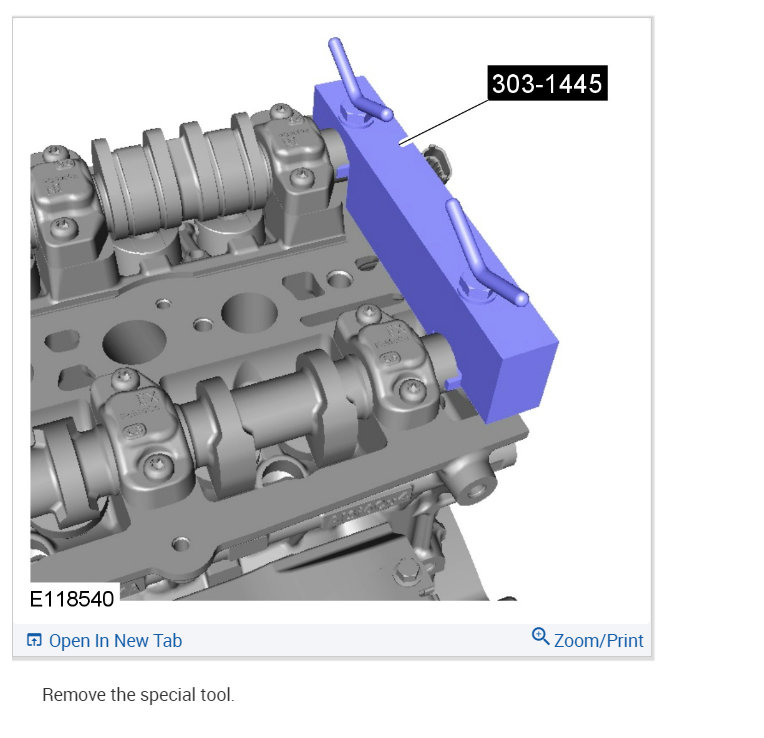

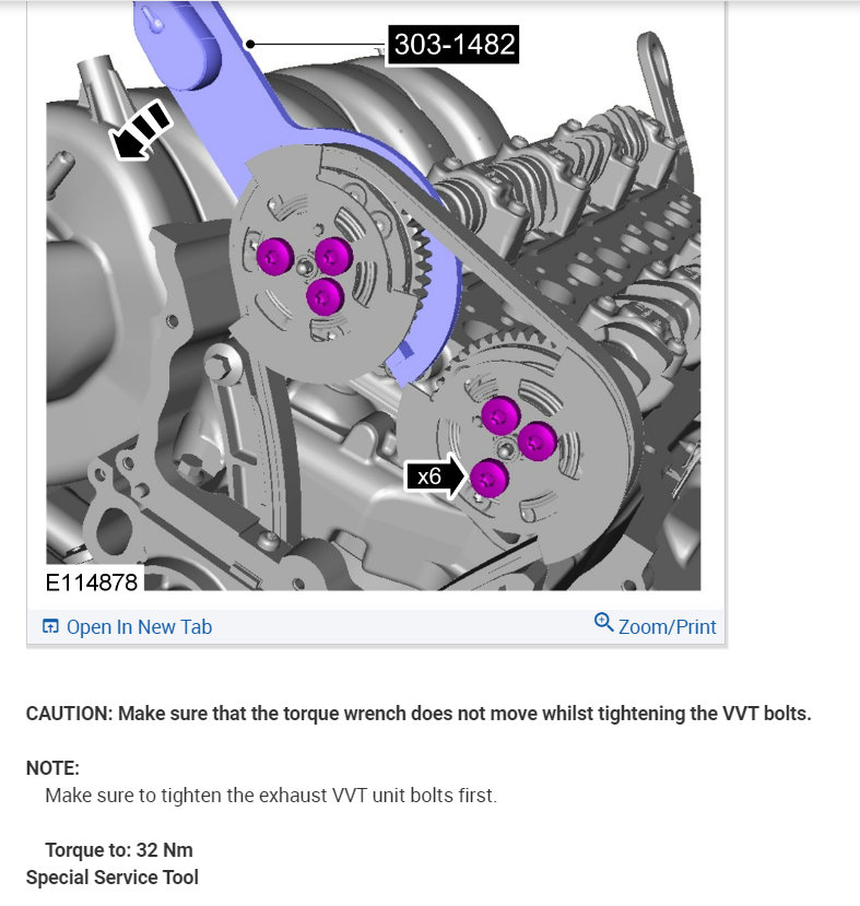

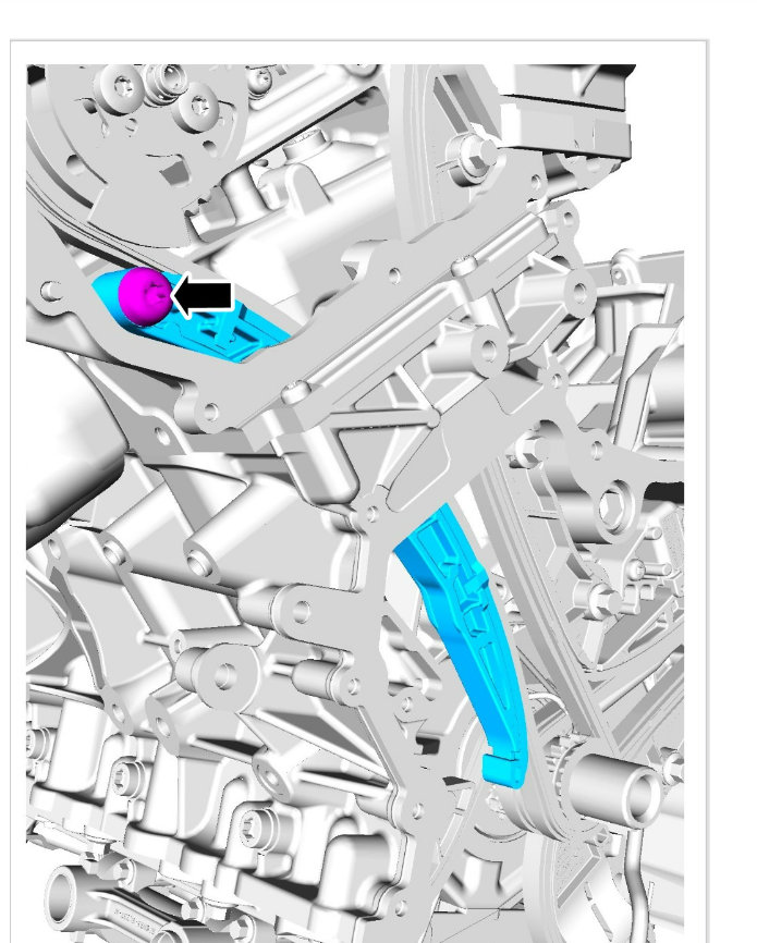

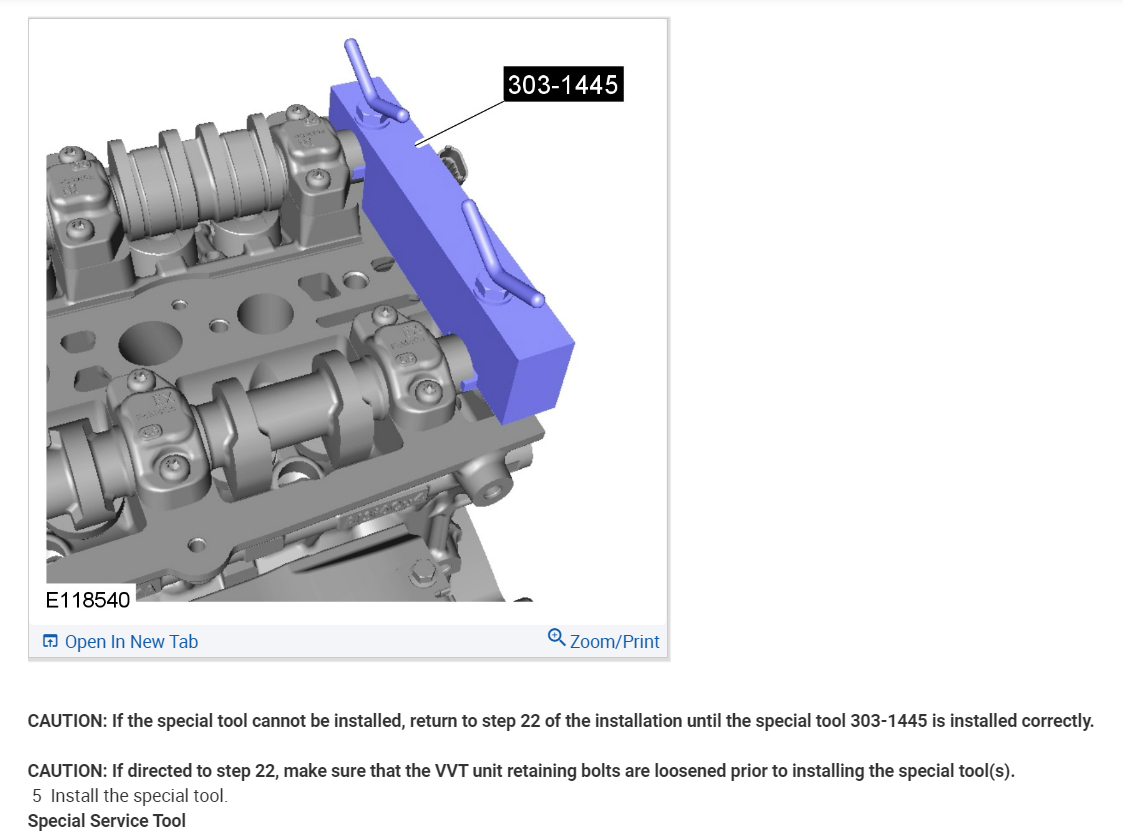

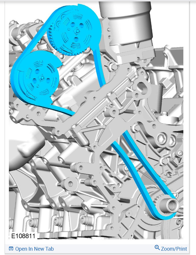

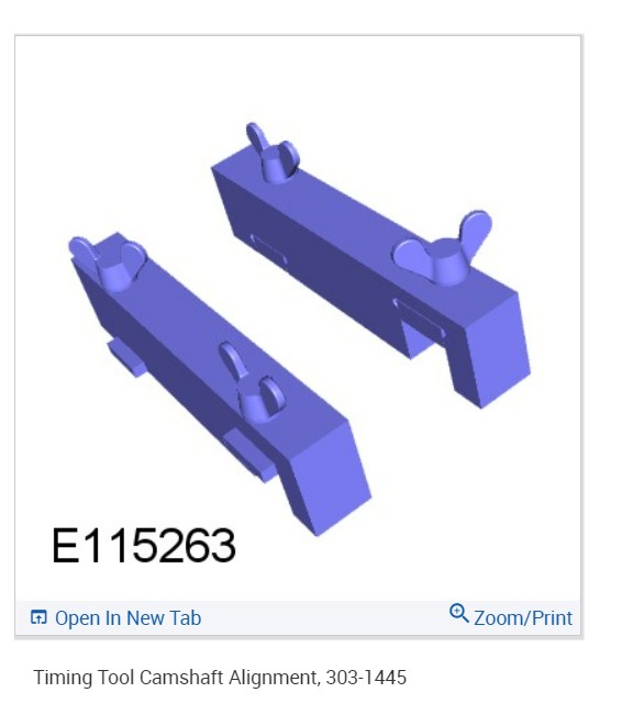

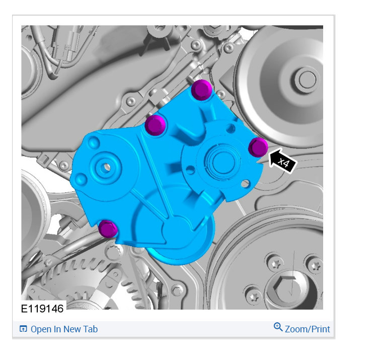

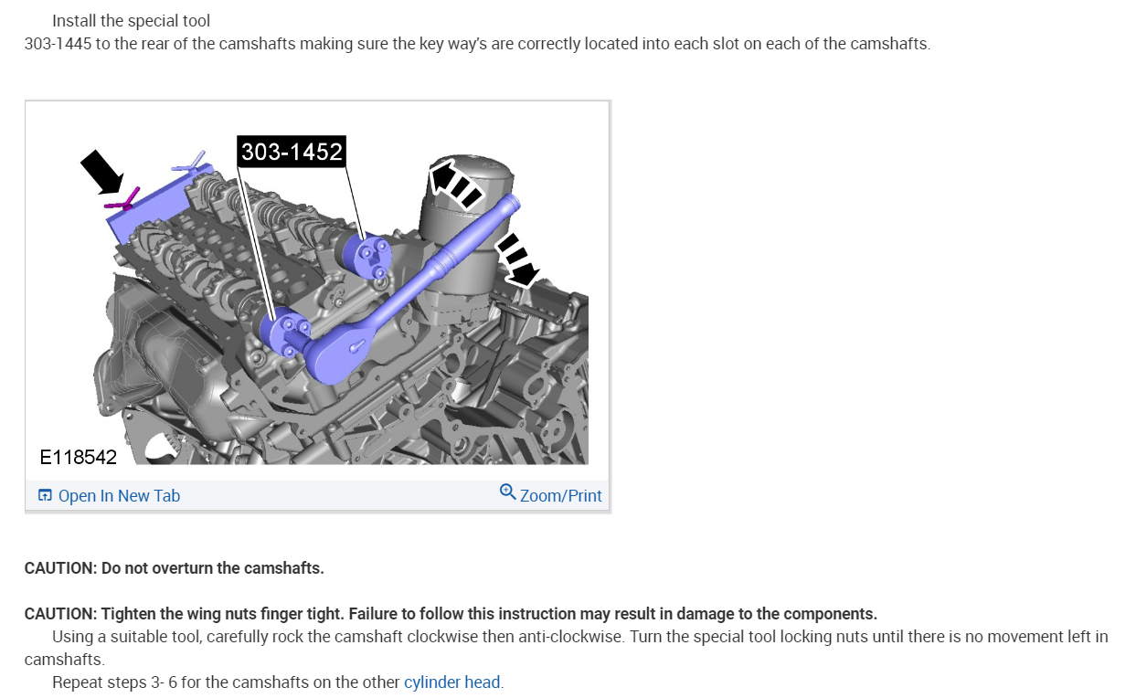

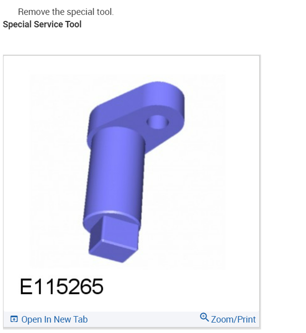

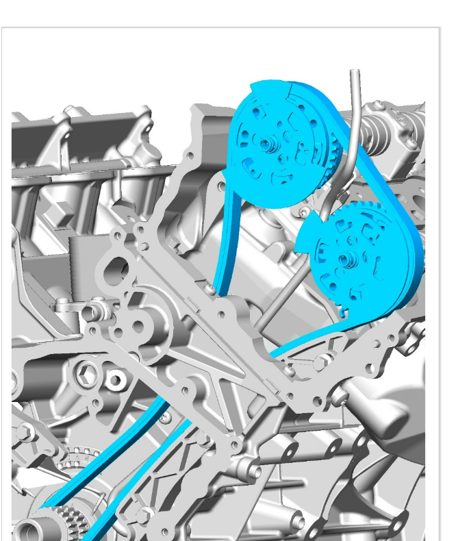

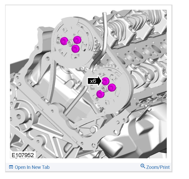

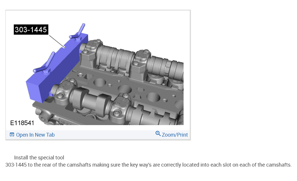

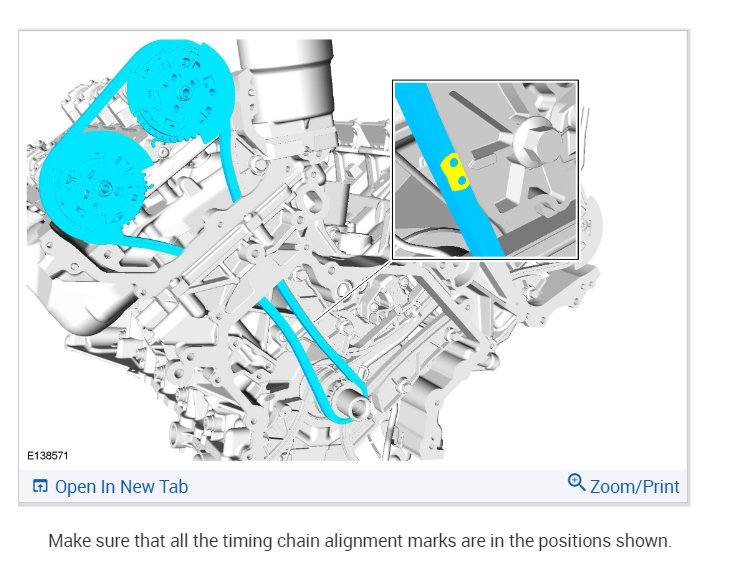

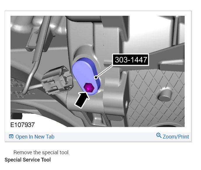

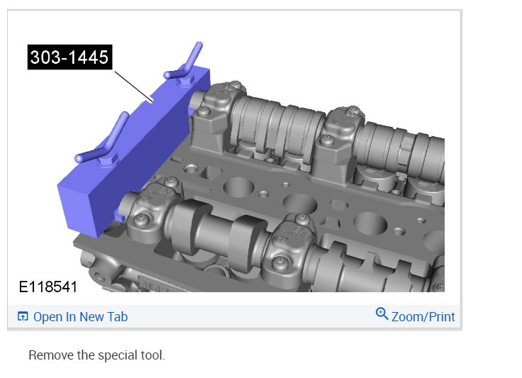

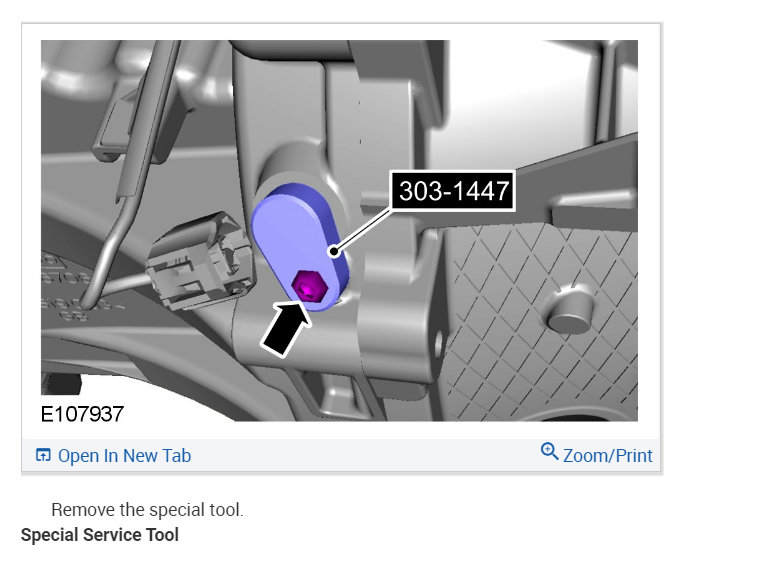

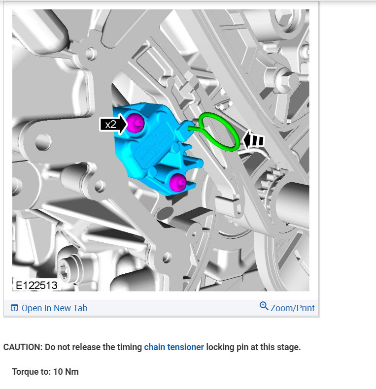

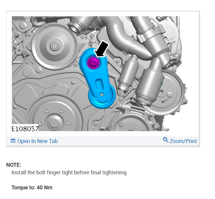

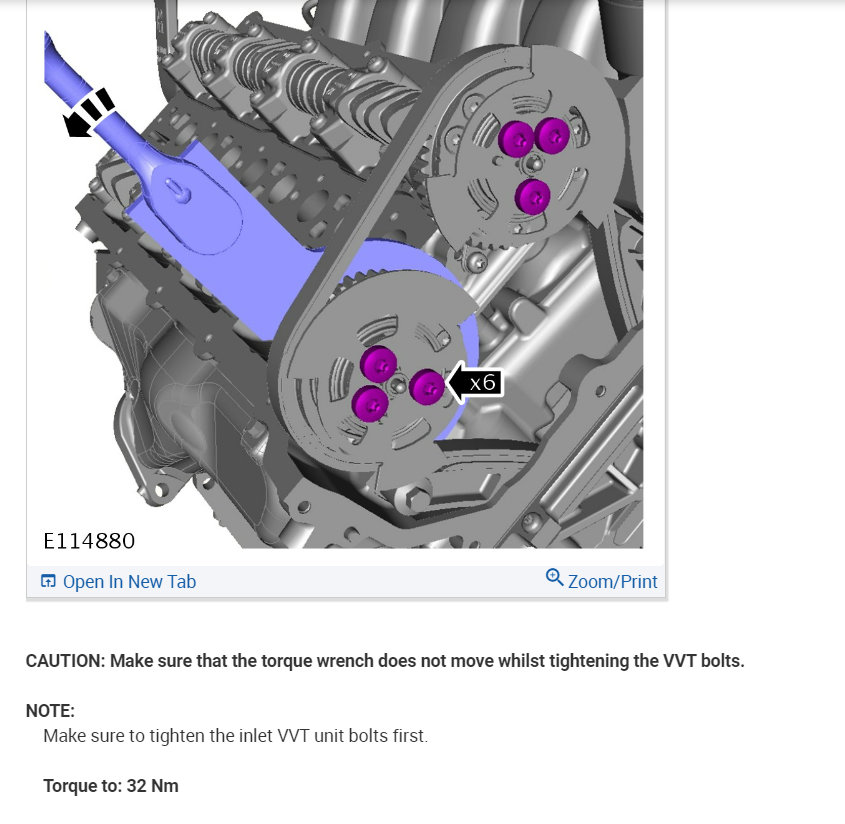

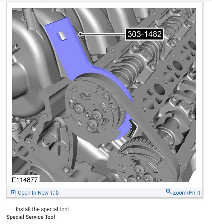

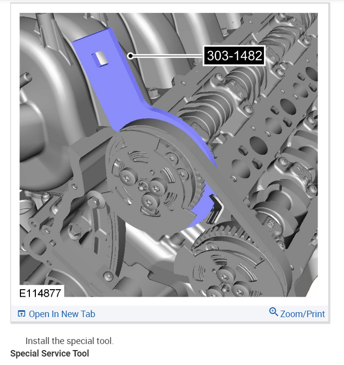

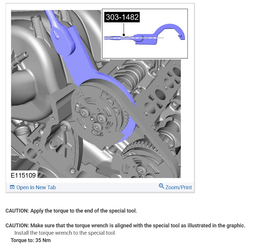

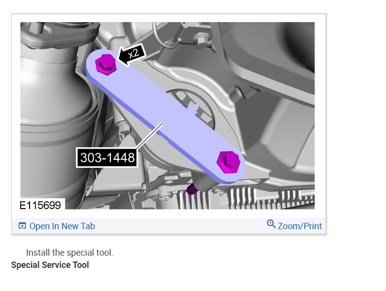

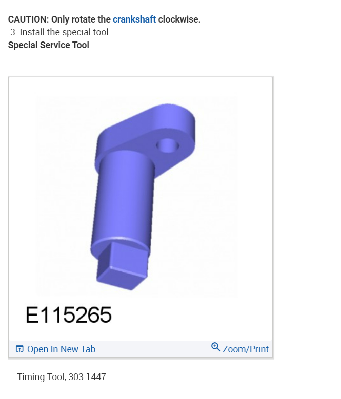

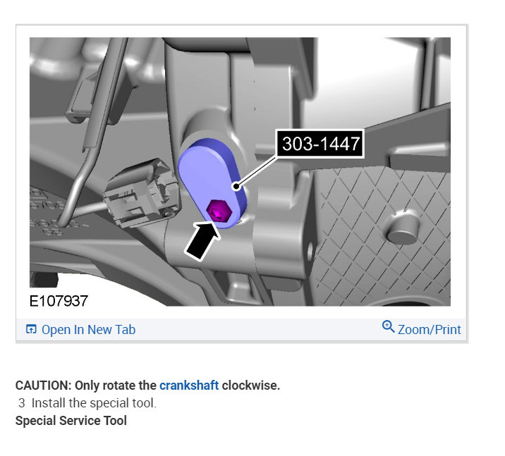

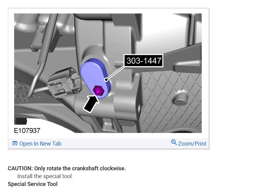

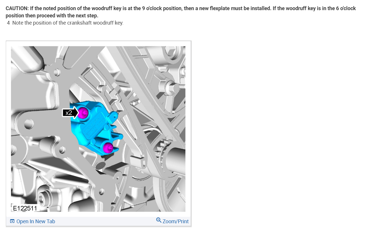

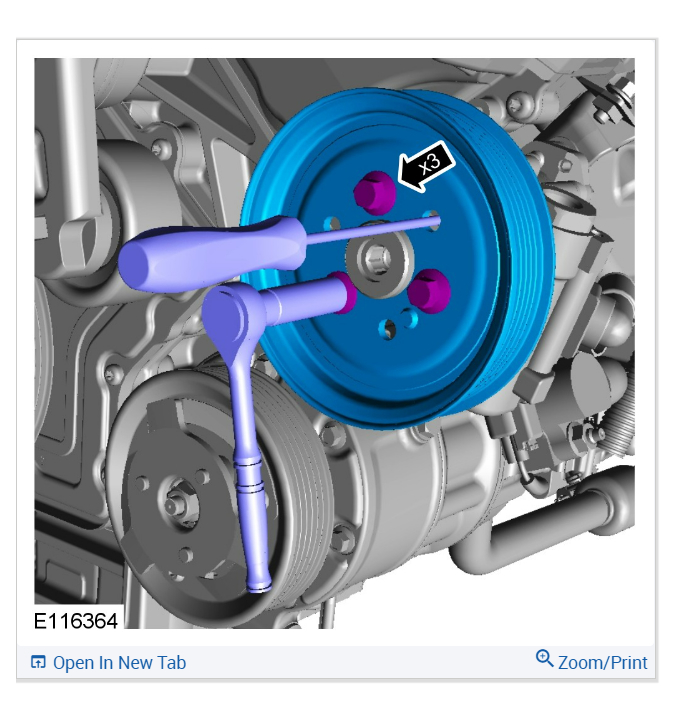

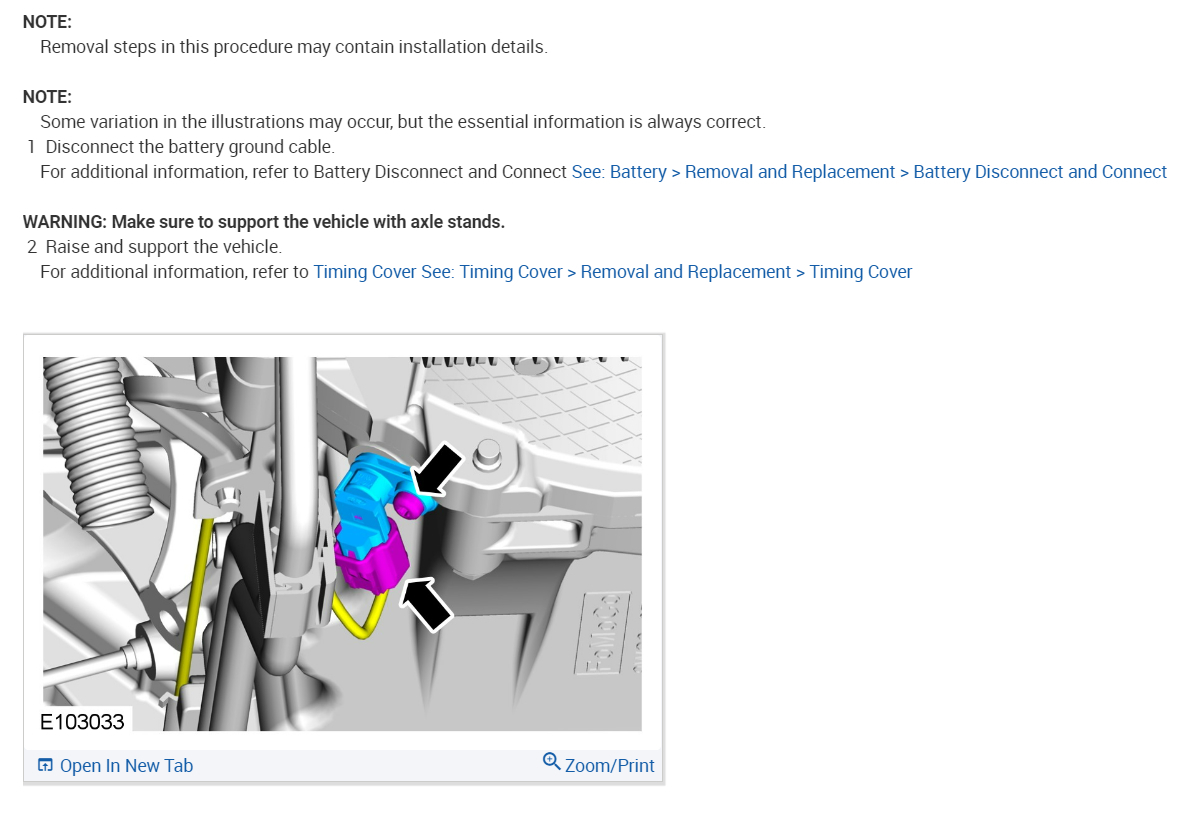

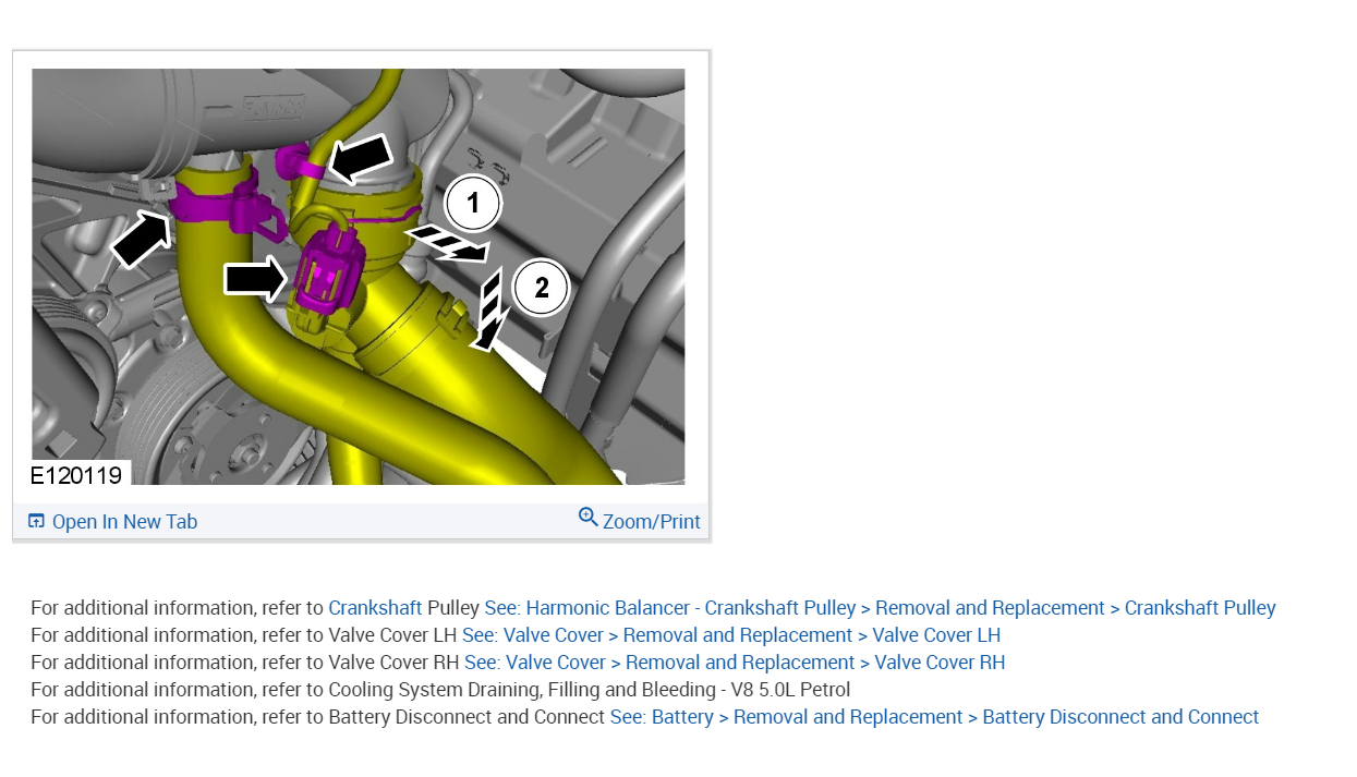

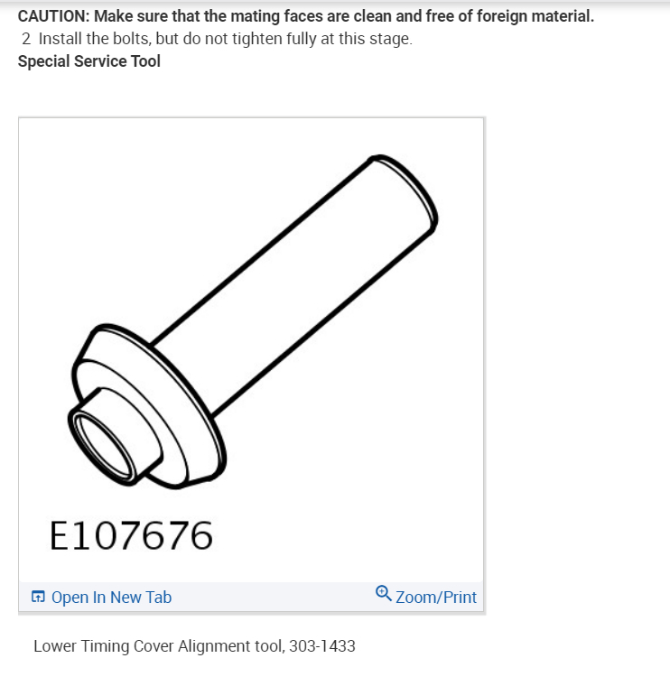

Here are the timing chain replacement instructions and special tools needed to do the job in the diagrams below. Check out the diagrams (below). Please let us know if you need anything else to get the problem fixed.
Jul 22, 2022 at 5:34 PM

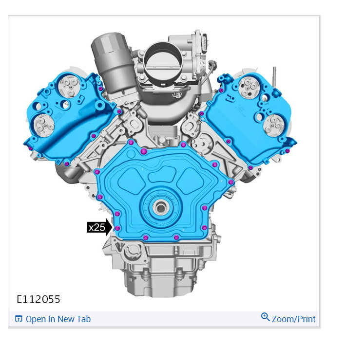

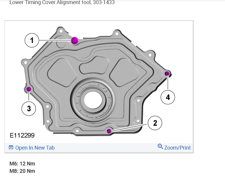

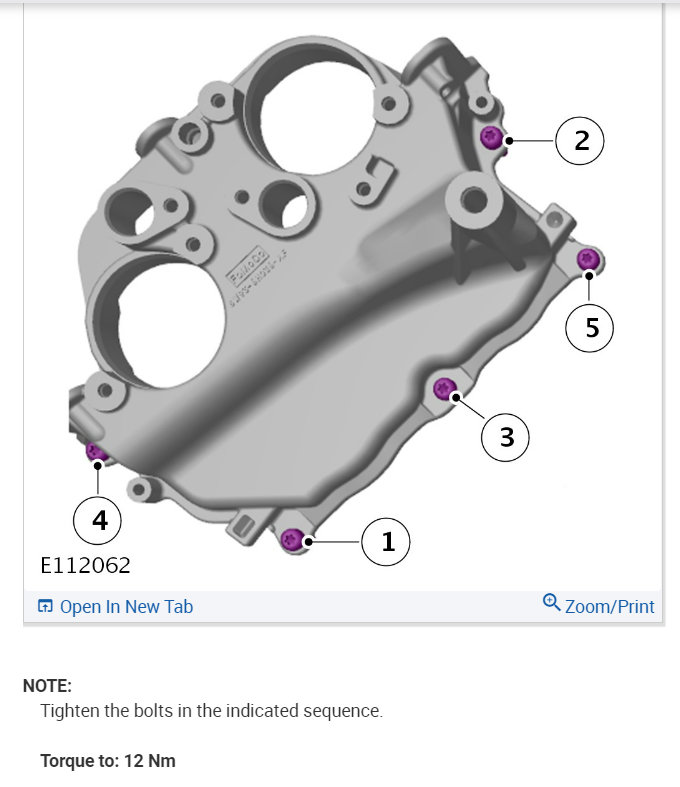

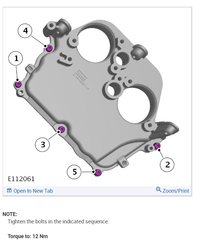

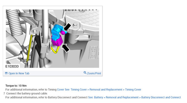

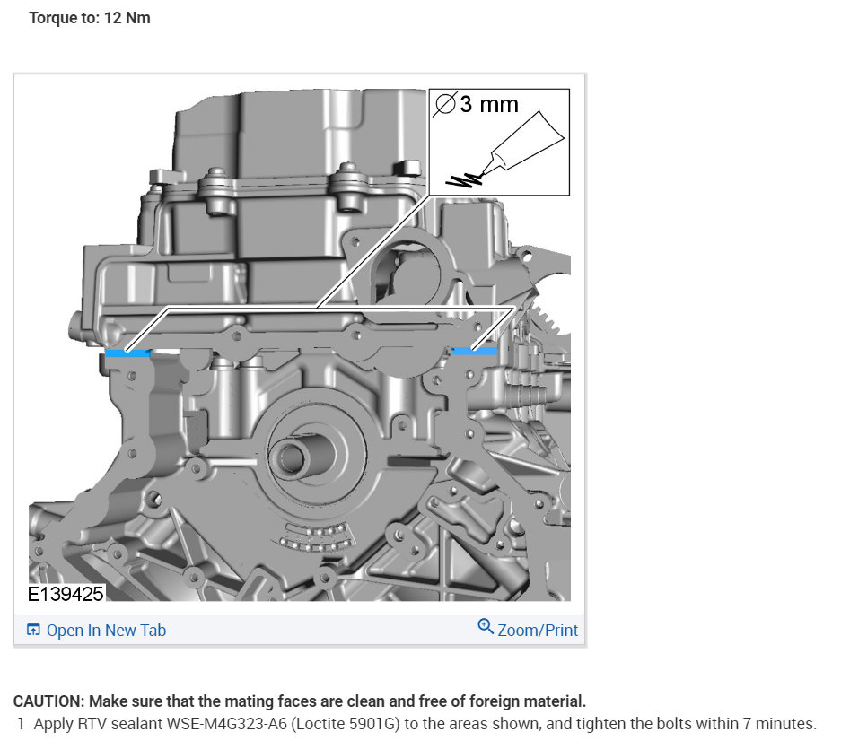

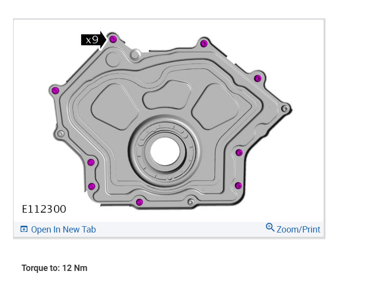

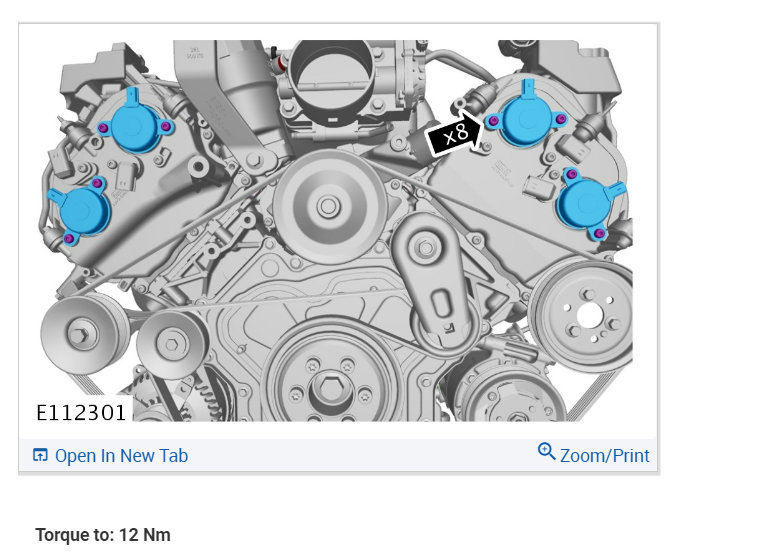

Good morning and thanks for that info. but the question I have was in search of the torque specs for the bolts on the Jaguar 5.0L engine front timing chain cover, I that valve is between 9 and 10 (N 'm) in pattern.
Jul 23, 2022 at 8:14 AM
TRANS@AMWS697
MEMBER
6 POSTS
(I have the torque specs for the valve covers), just can't seem to find anything on the front timing chain cover as far as bolt torque.
Jul 23, 2022 at 8:16 AM

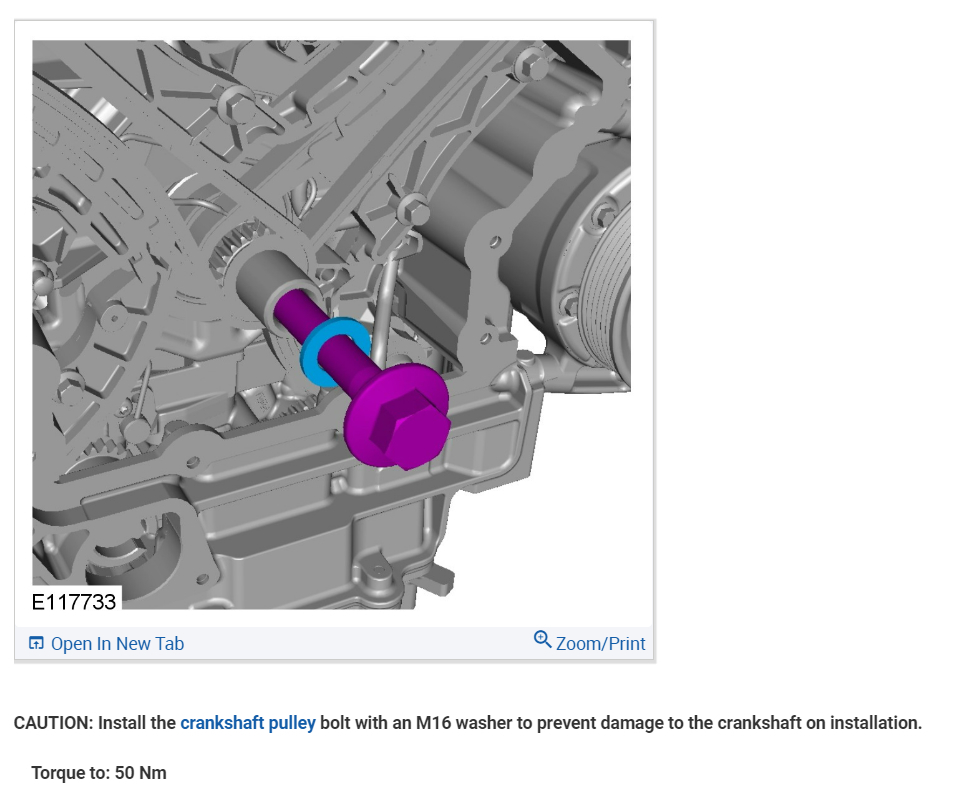

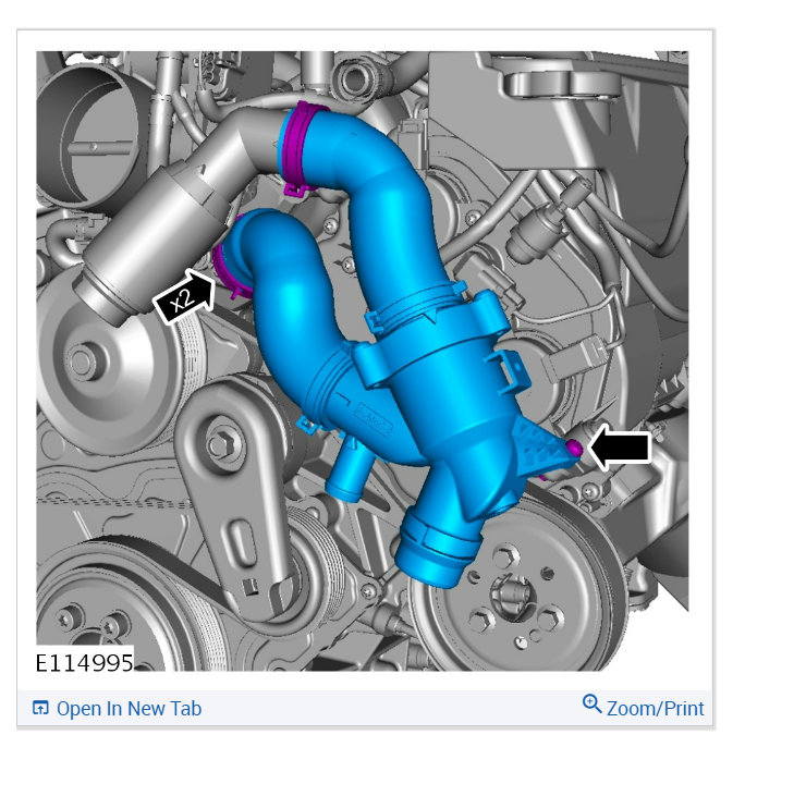

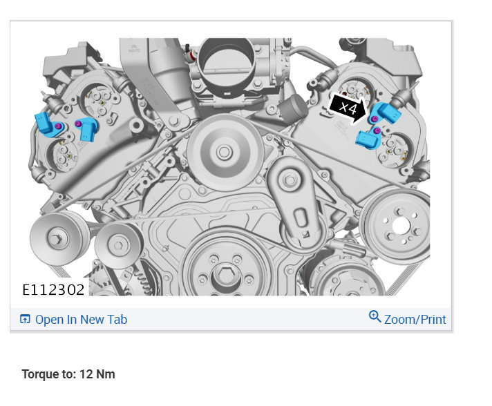

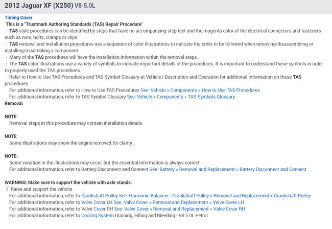

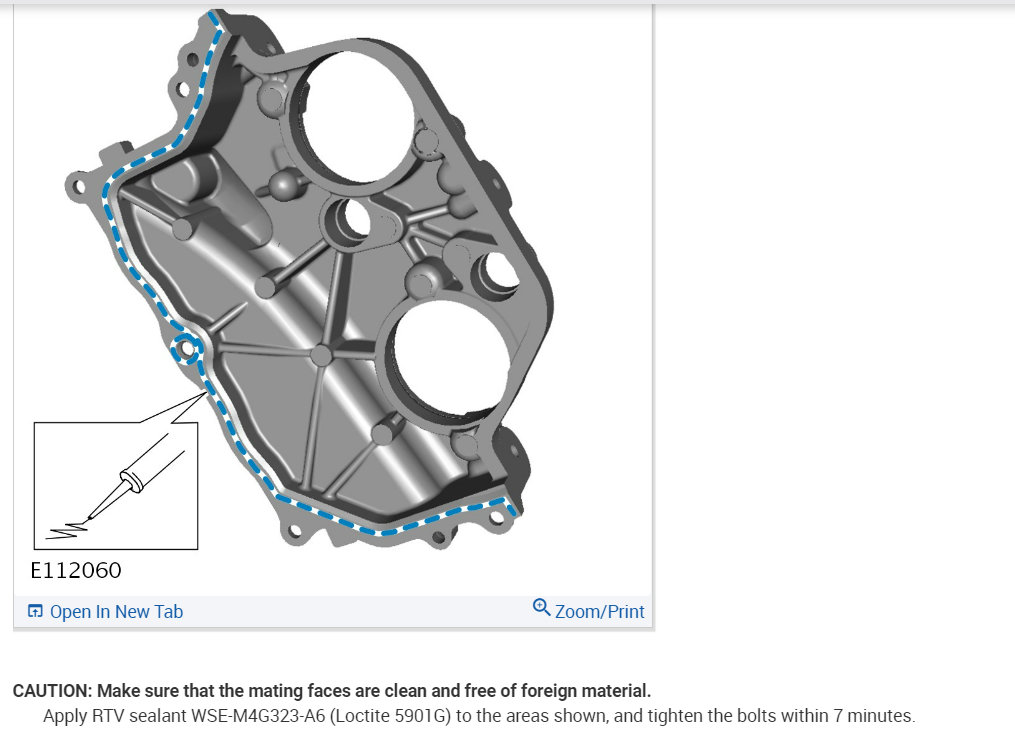

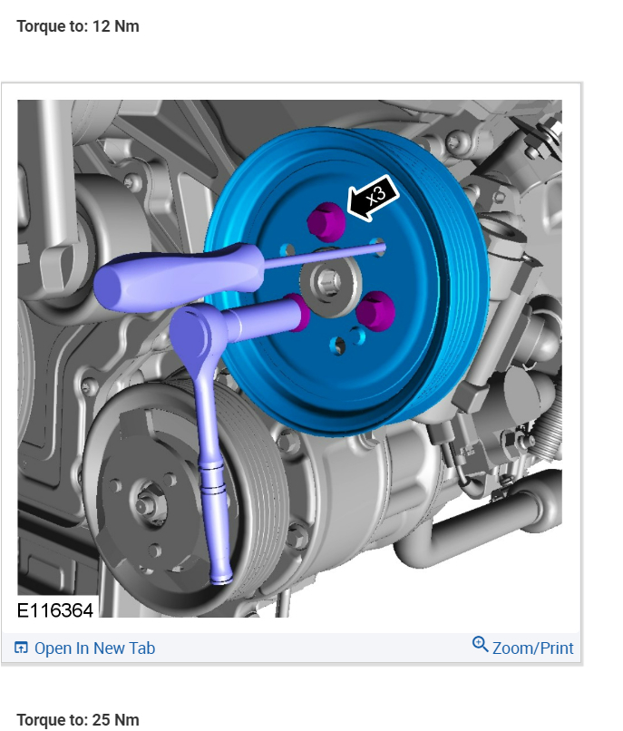

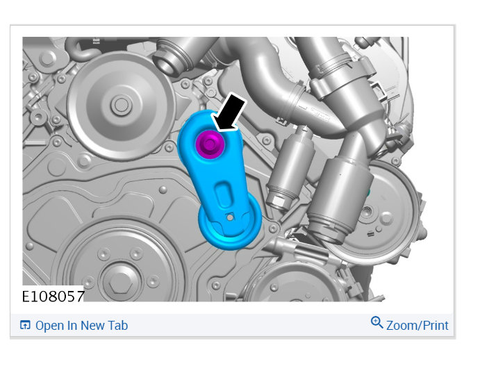

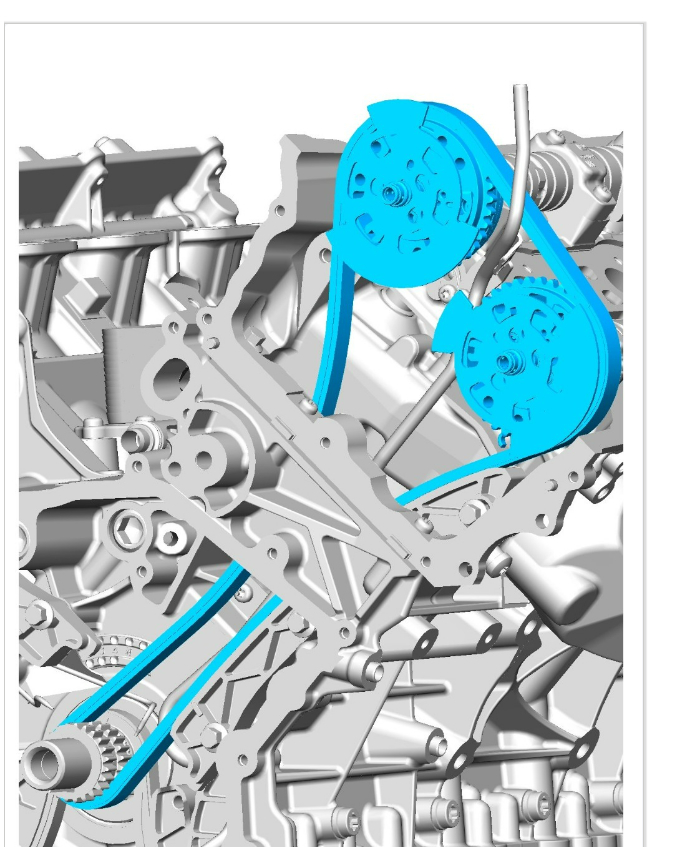

CERTIFIED EXPERT
53,854 POSTS

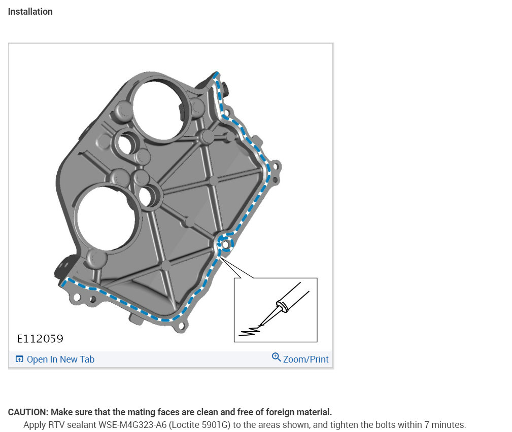

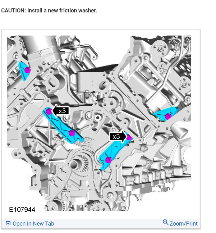

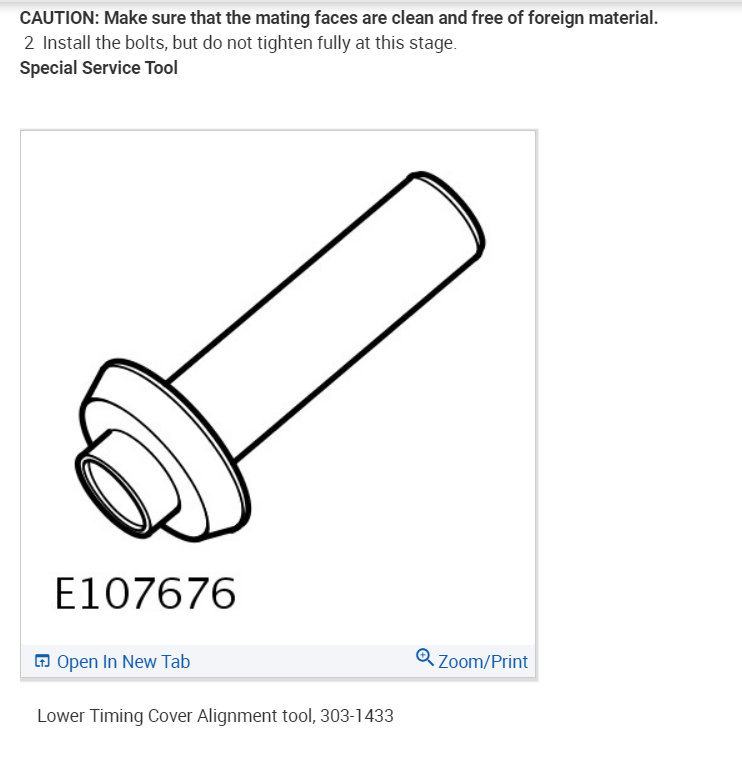

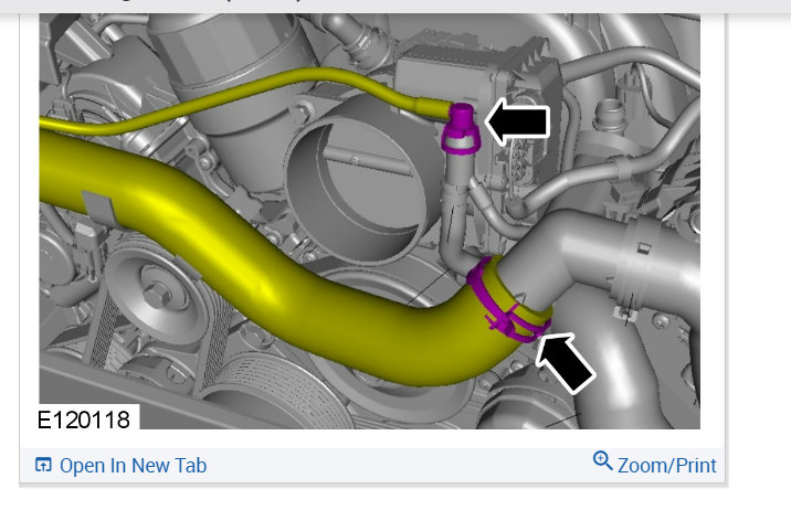

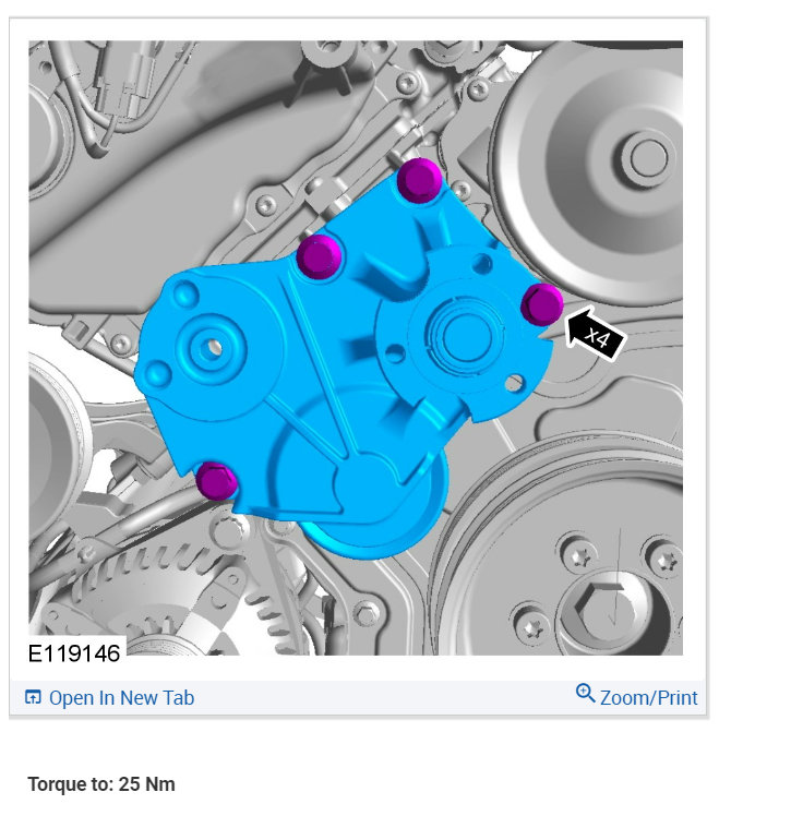

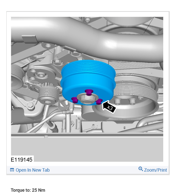

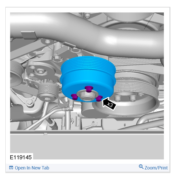

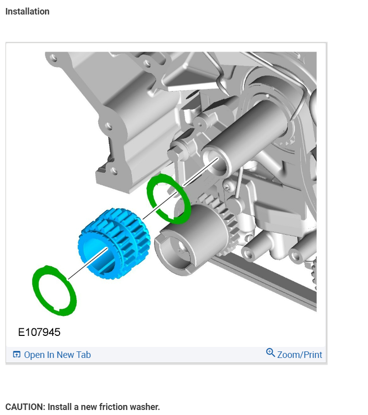

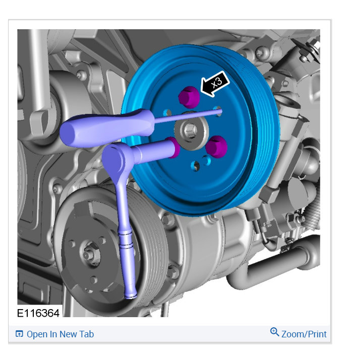

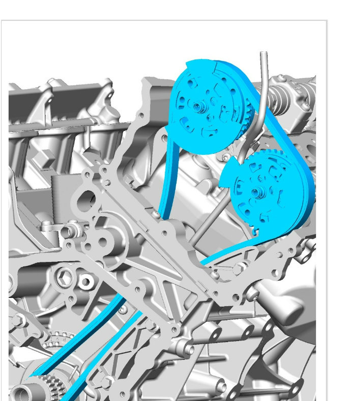

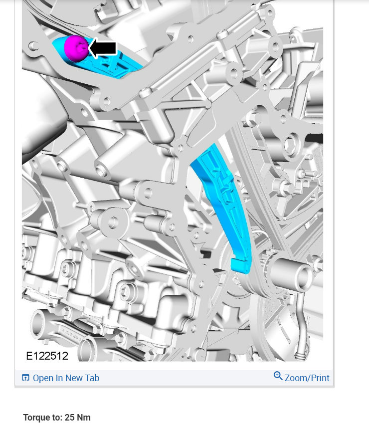

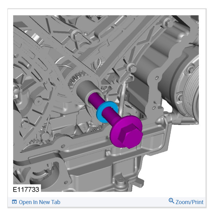

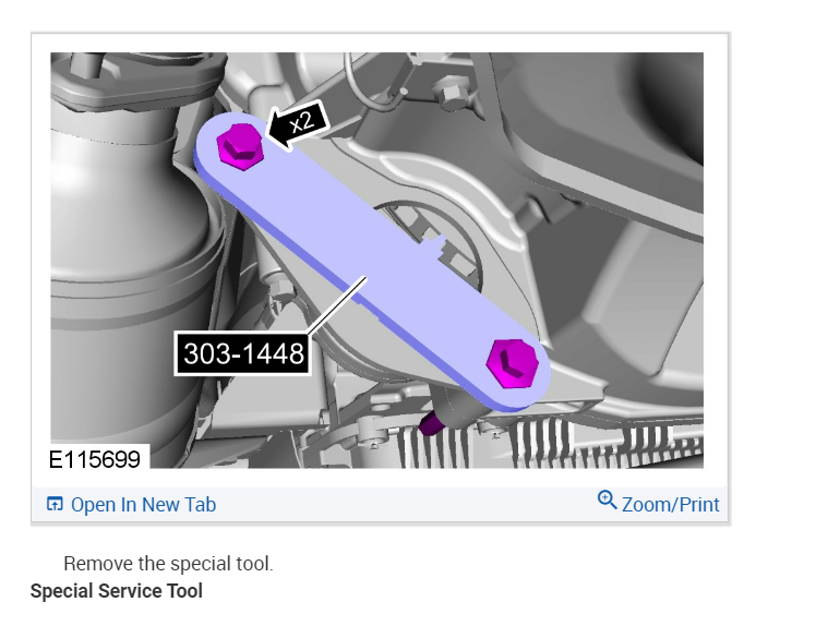

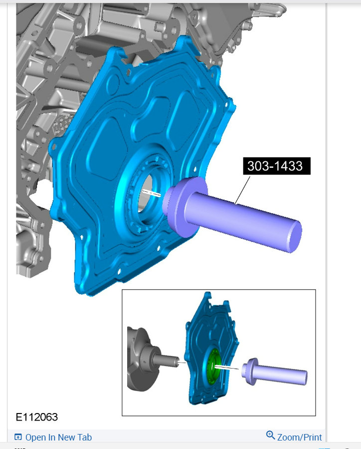

Here is the instructions and torque specs on how to replace the front cover and front main seal in the diagrams below. Please let us know if you need anything else to get the problem fixed.
Jul 24, 2022 at 11:35 AM
TRANS@AMWS697
MEMBER
6 POSTS
Good morning and thank you so very much, this is what I was looking for to start my timing chain replacement job!
