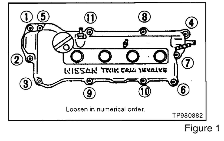

3. Remove the rocker cover (see figure 1). 4.Remove the coolant reservoir tank with bracket and reposition it for clearance.

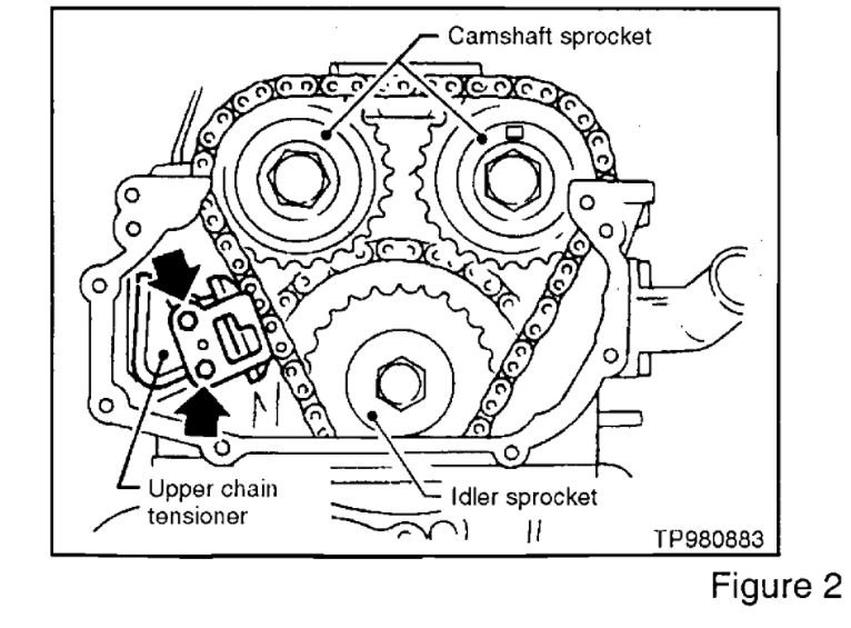

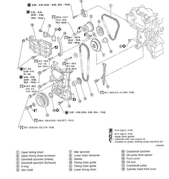

9. Remove the upper chain tensioner (see figure 2).

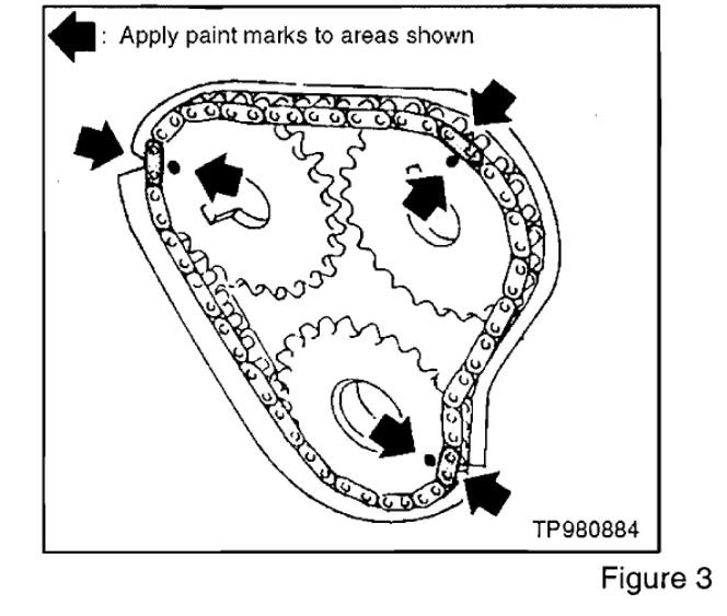

10. Wipe off the links of the upper timing chain next to the timing marks on the sprockets. Put paint marks on the timing chain, matching them with the timing marks on the cam sprockets and idler sprocket (see image 3)

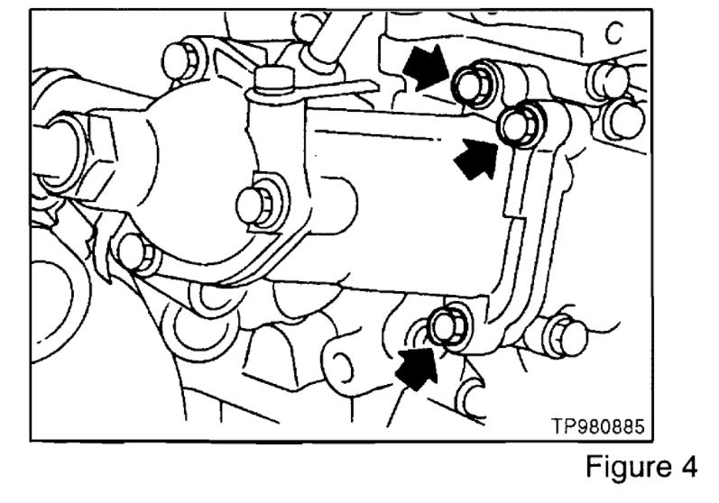

19. Remove the thermostat housing (See figure 4).

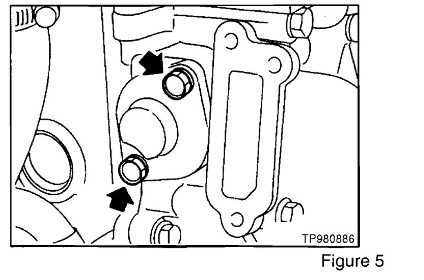

20. Remove the lower chain tensioner (see figure 5).

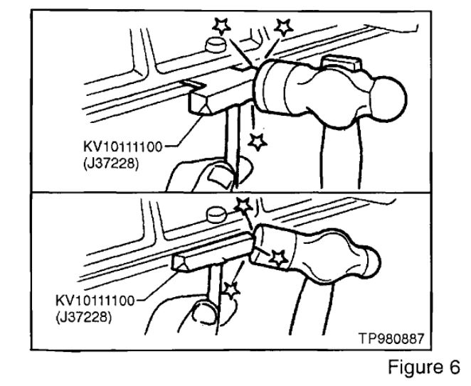

23. Remove the oil pan (see figure 6).
a. Insert the tool between the cylinder block and oil pan.
CAUTION:
Be careful not to damage the aluminum mating face. Do not insert a screwdriver, or the oil pan flange will become damaged.
b. Slide the tool by tapping it on the side of the tool with a hammer.

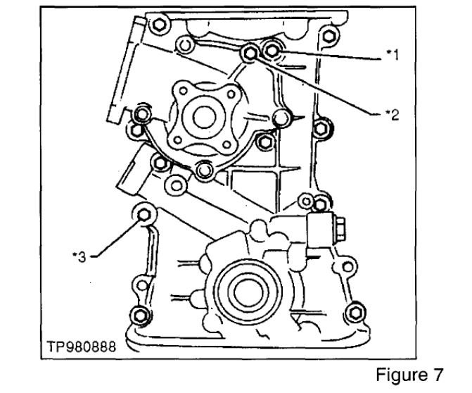

27. Remove the front cover bolts and front cover.
CAUTION:
One bolt is located on the water pump (see figure 7).
1: Located on engine front mounting bracket.
2: Located on the water pump.
3: Located on the power steering oil pump adjusting bar.

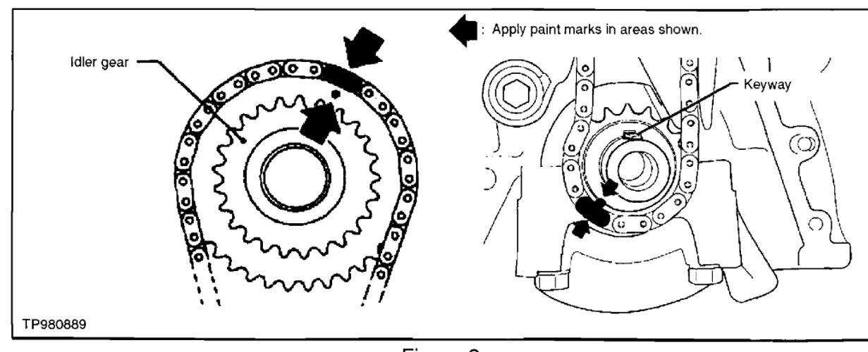

29. Wipe off the links of the lower timing chain next to the timing marks on the sprockets. Put paint marks on the timing chain, matching them with the timing marks on the idler sprocket and crankshaft sprocket (see image 8).
