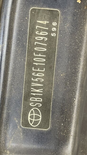

ANDRIN ATEM
  • 393 POSTS
Here is the VIn, maybe something more can come. Because I noticed similar engines with different timing mark positions.
Jan 26, 2026 at 11:44 AM
