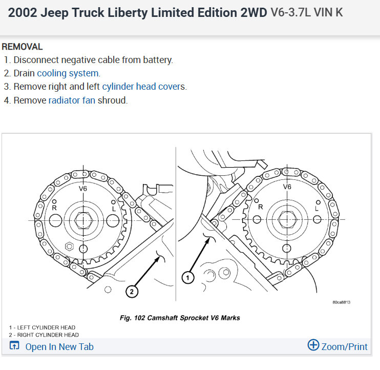

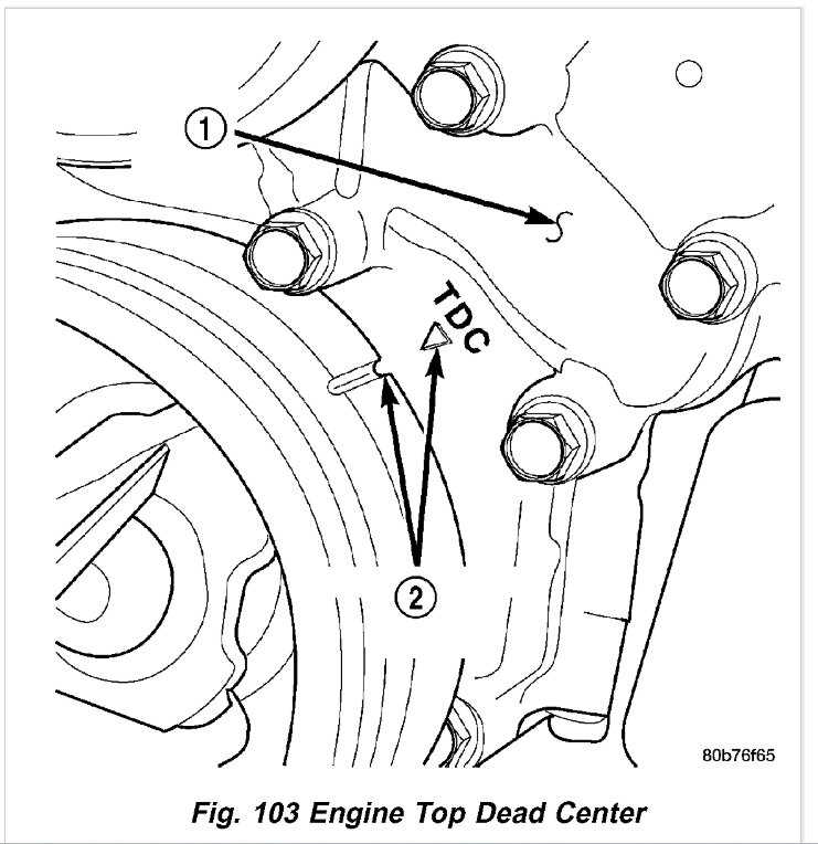

I need the timing chain marks diagram for the vehicle listed above 3.7 L, please.
Jun 25, 2025 at 7:45 AM
Sure, here are the correct timing chain marks, also it shows the crankshaft position as well TDC. Check out the images (below). Let us know if you need anything else.
