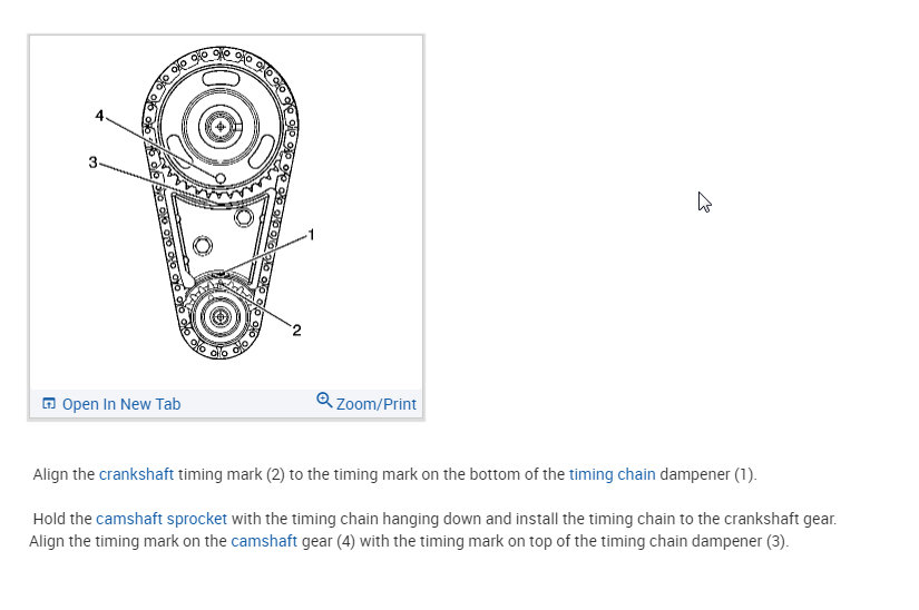

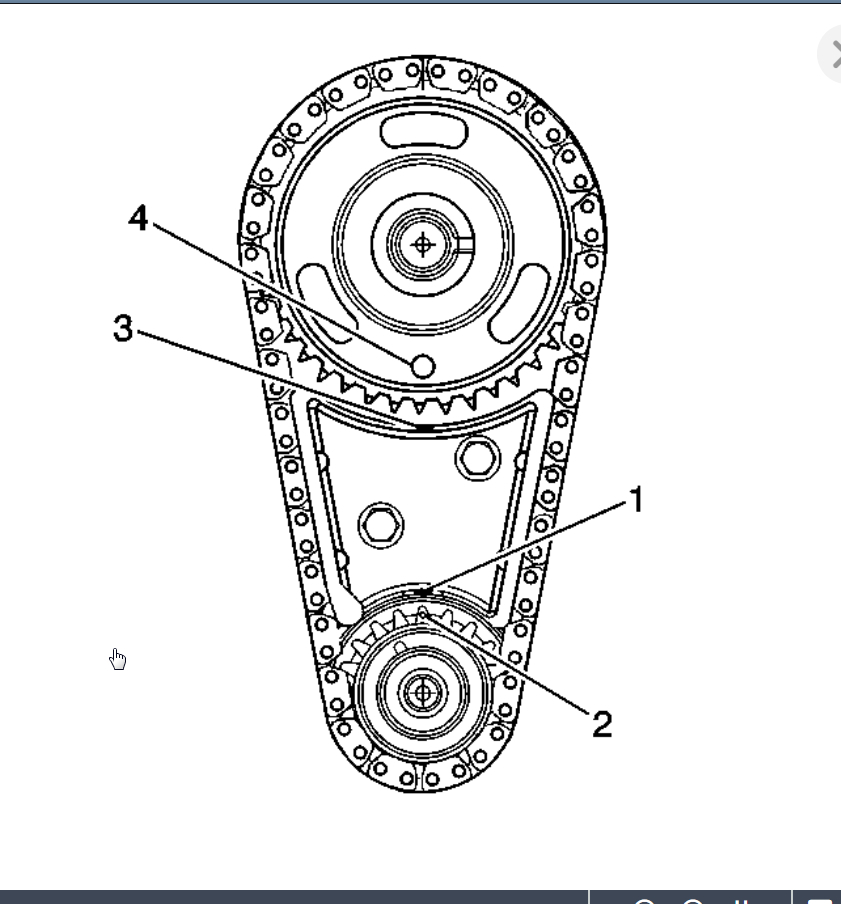

I am look for the timing marks in relation to the cam and crank on a 3.4. does anyone have them?
May 9, 2020 at 2:40 PM
Here are the timing marks for the cam and crank. Check out the diagrams (Below). Please let us know if you need anything else to get the problem fixed. Let me know if you need more info.
