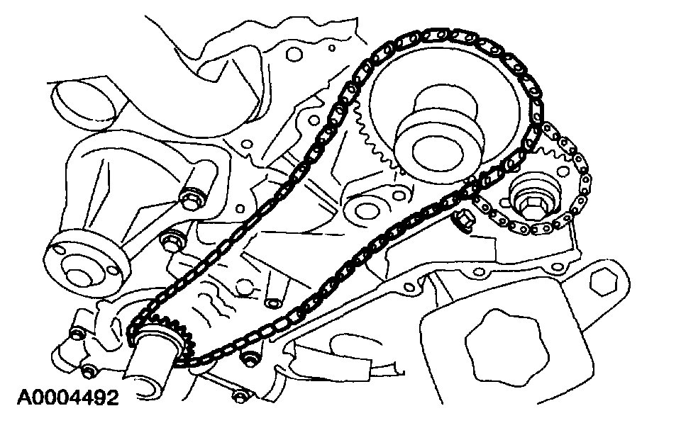

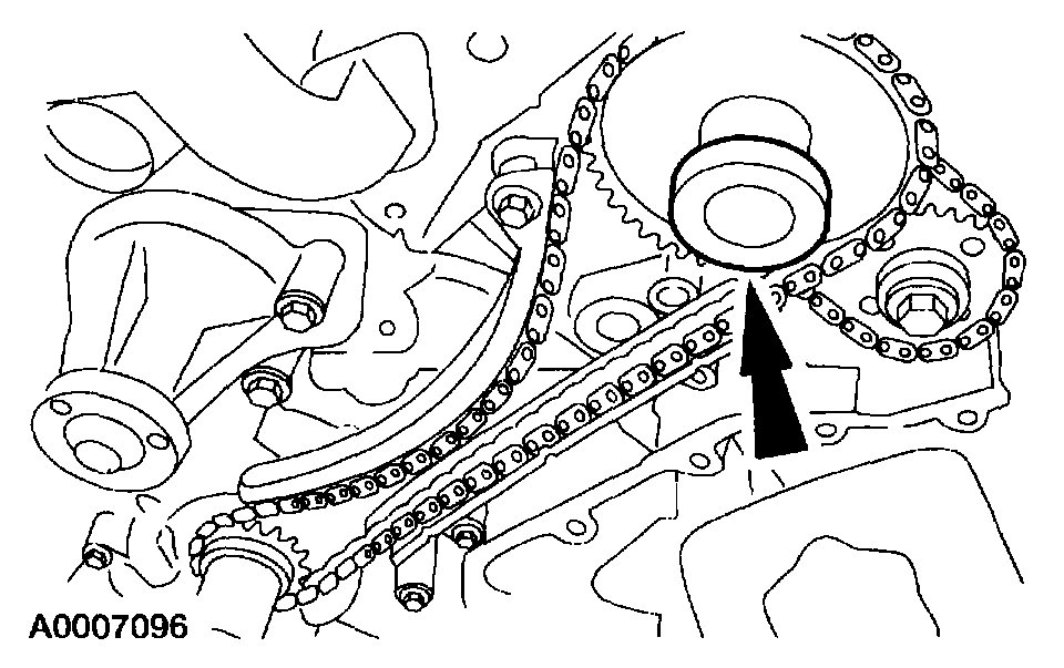

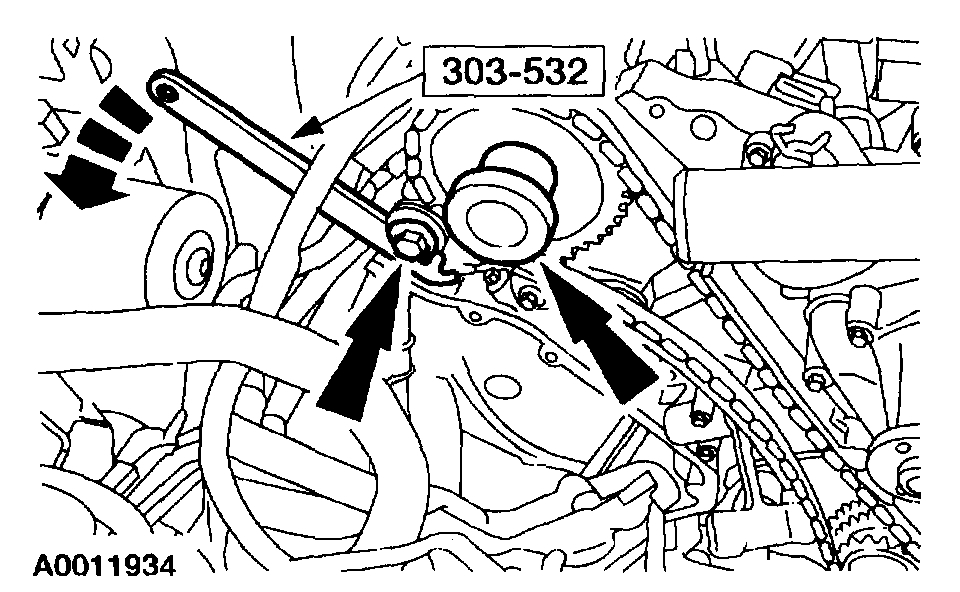

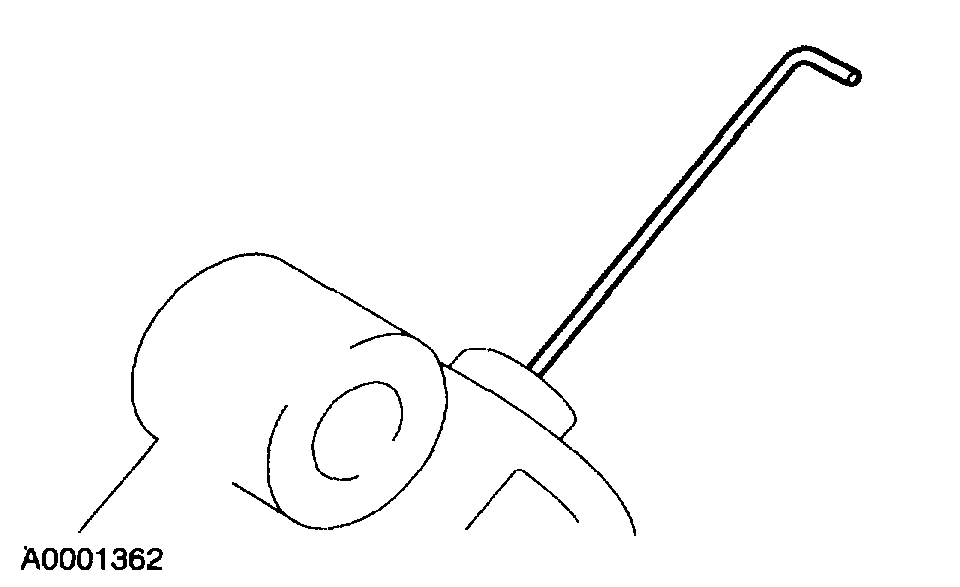

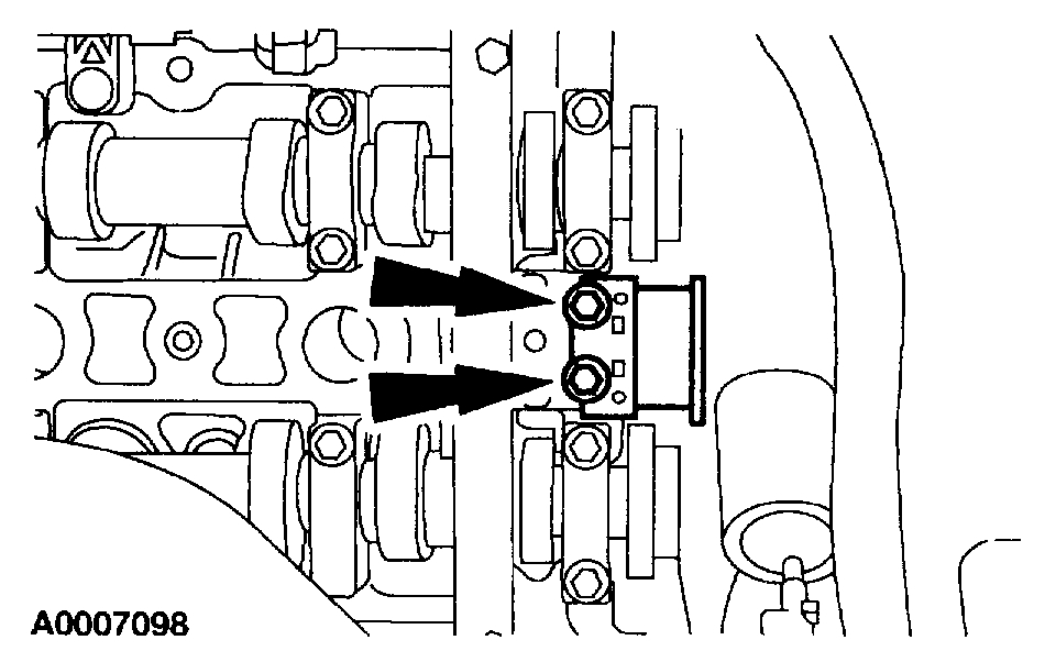

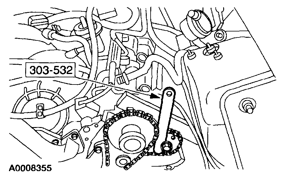

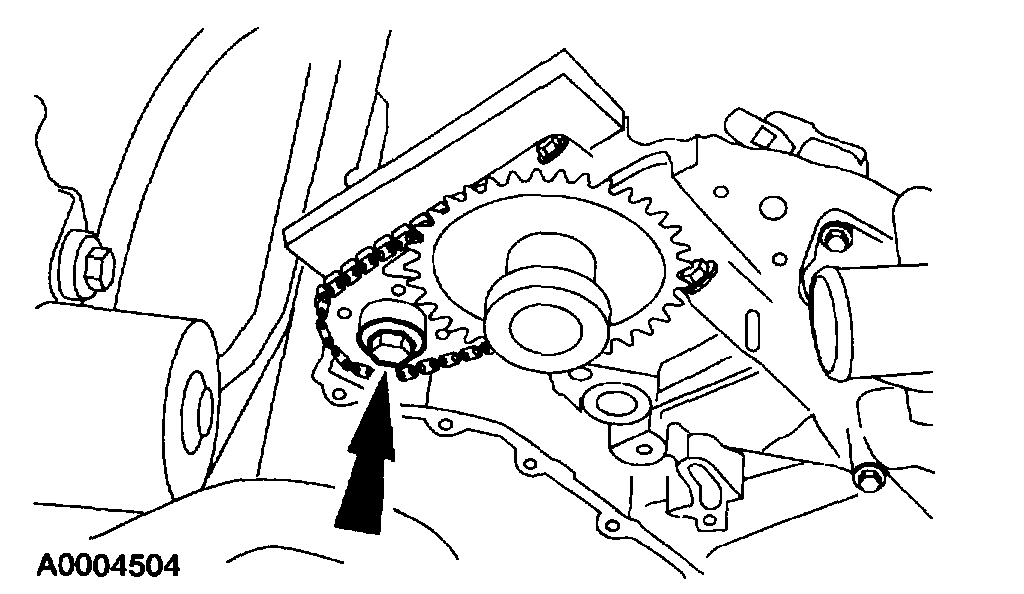

Here are the directions for replacing both the primary and secondary timing chains. All of the attached pics correlate with the directions.
________________________________________________________________________________________
2001 Lincoln LS V8-3.9L VIN A
Primary
Vehicle Engine, Cooling and Exhaust Engine Timing Components Service and Repair Procedures Primary
PRIMARY
Timing Drive Components-Primary

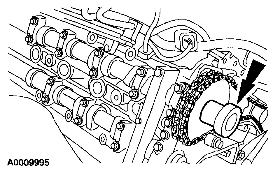

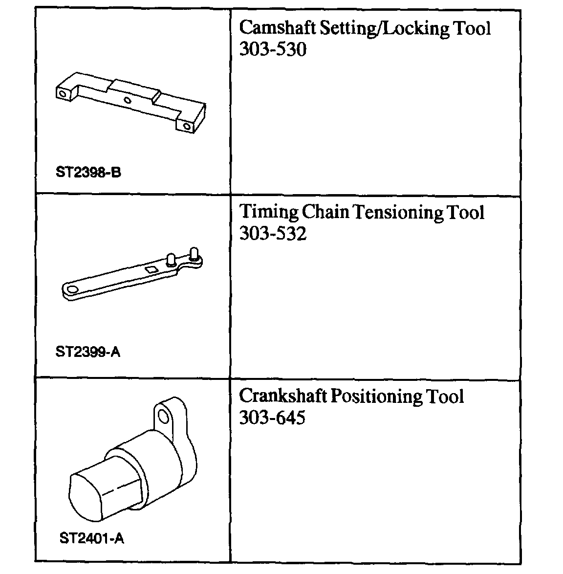

Special Tools

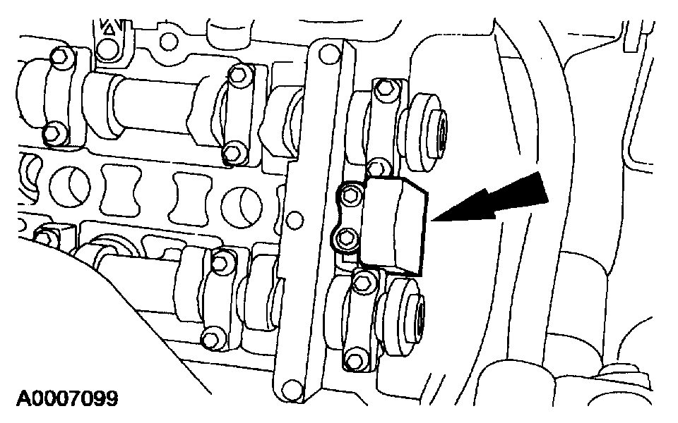

pic 1
Special Tool(s)

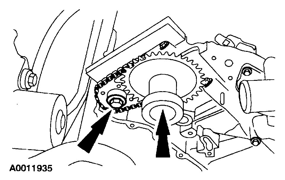

Removal
1. Remove the engine front cover.
2. Raise the vehicle.

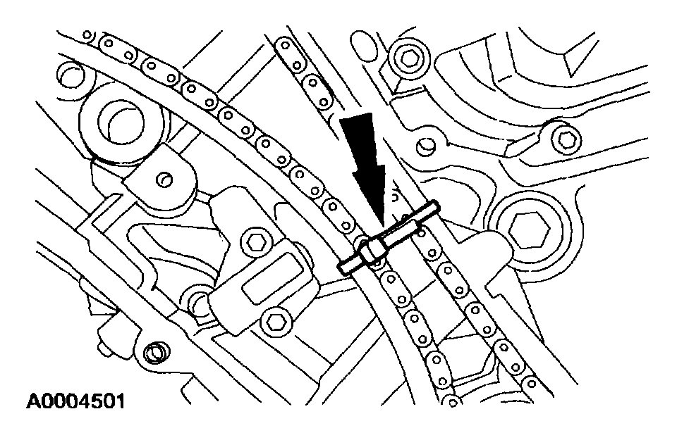

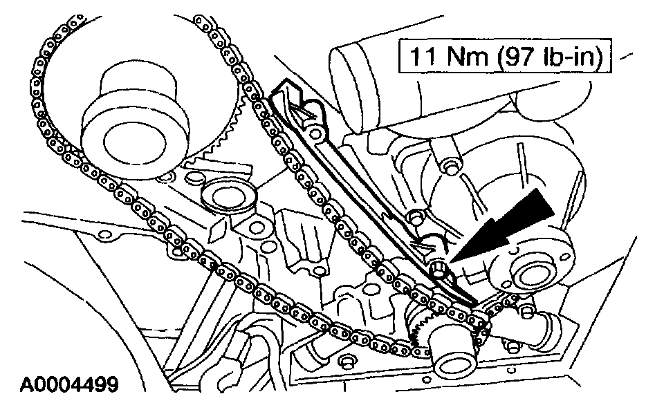

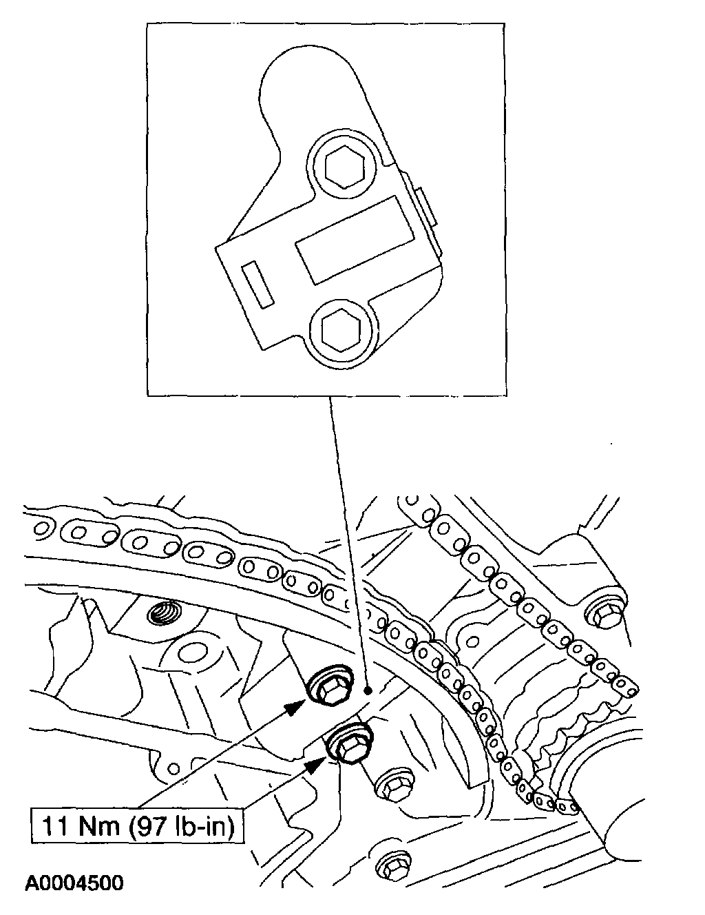

pic 2

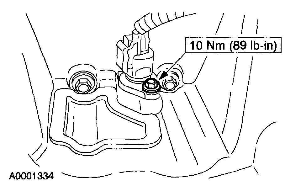

3. Remove the crankshaft position (CKP) sensor and the torque converter cover.

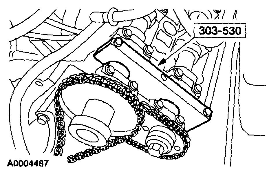

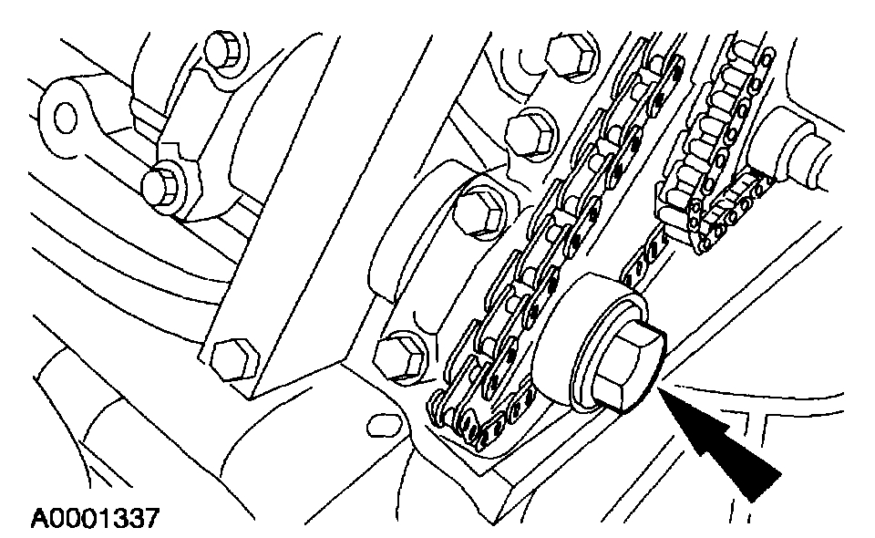

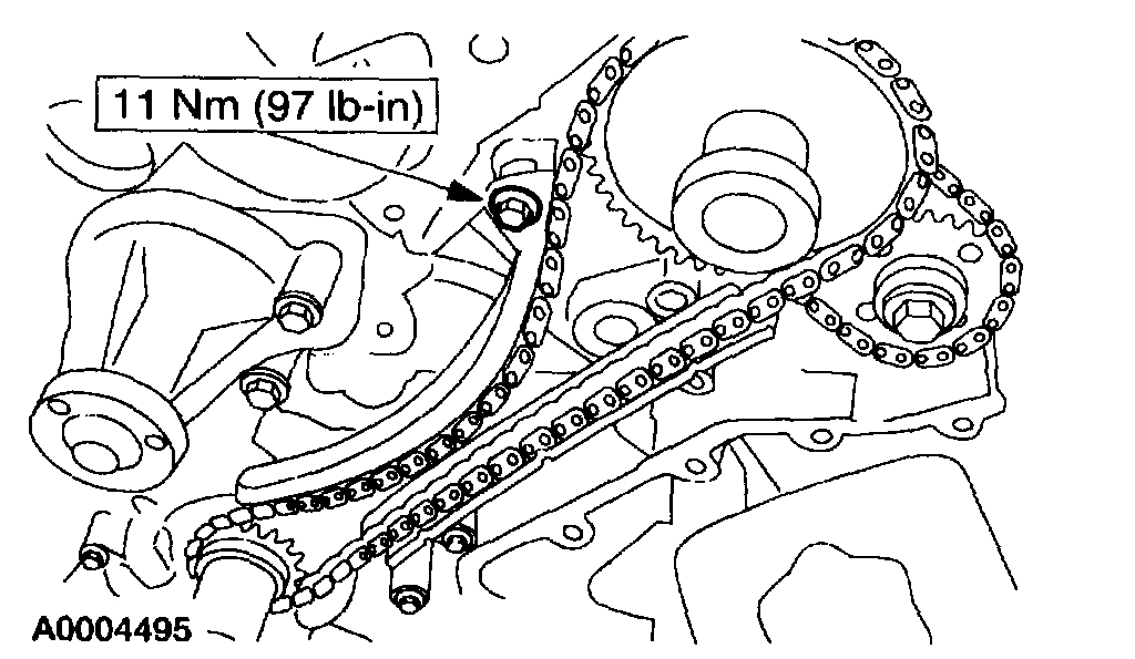

pic 3

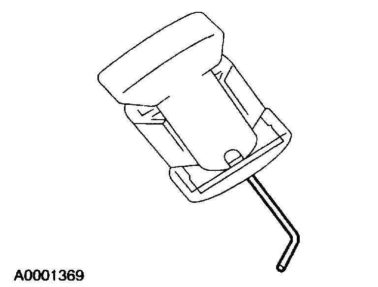

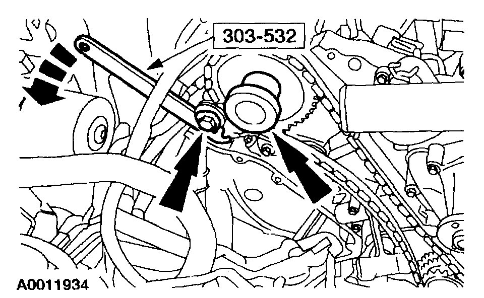

4. NOTE: There is one window on the ignition pulse wheel that is unique to accept the special tool.
Install the special tool.
- Turn the crankshaft to 45 degrees ATDC. The crankshaft keyway will be in the 6 o'clock position.
- Install the special tool.
5. Lower the vehicle.

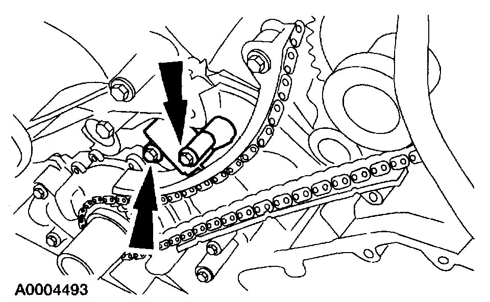

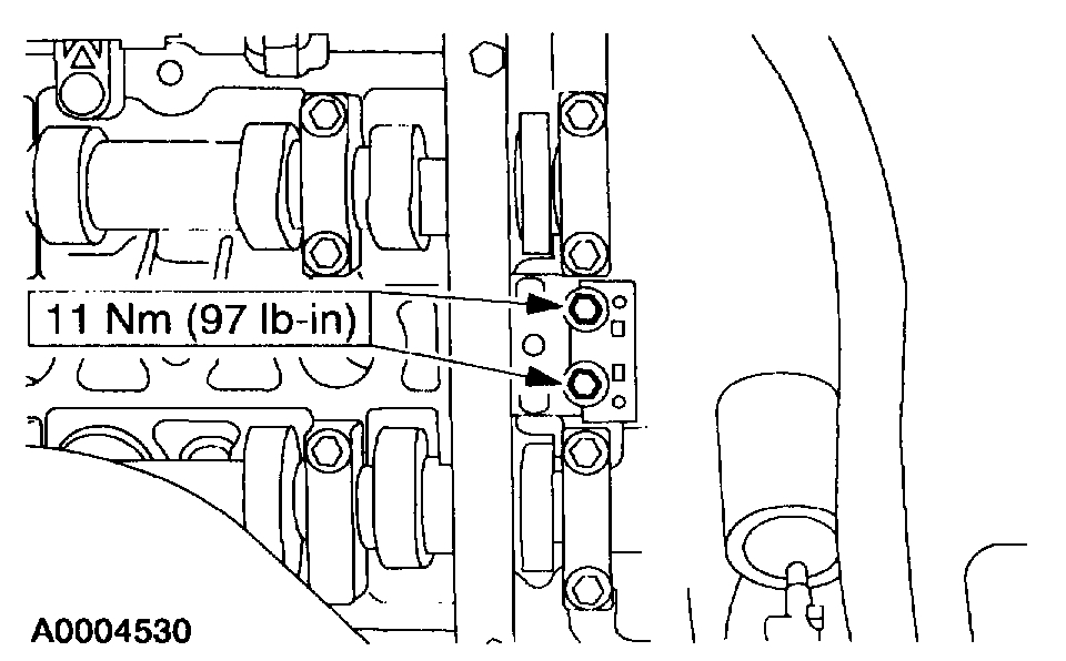

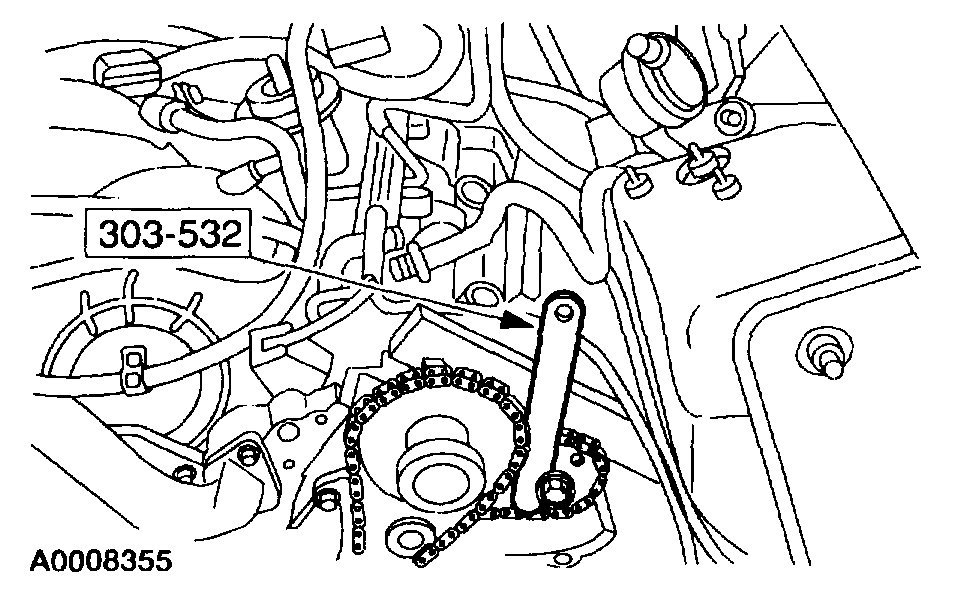

pic 4

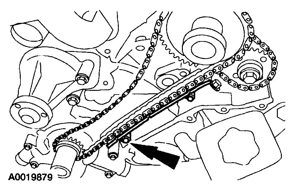

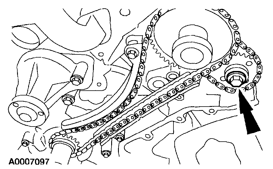

6. Make sure the lobes of the camshaft are facing upwards. If not, repeat Step 4.

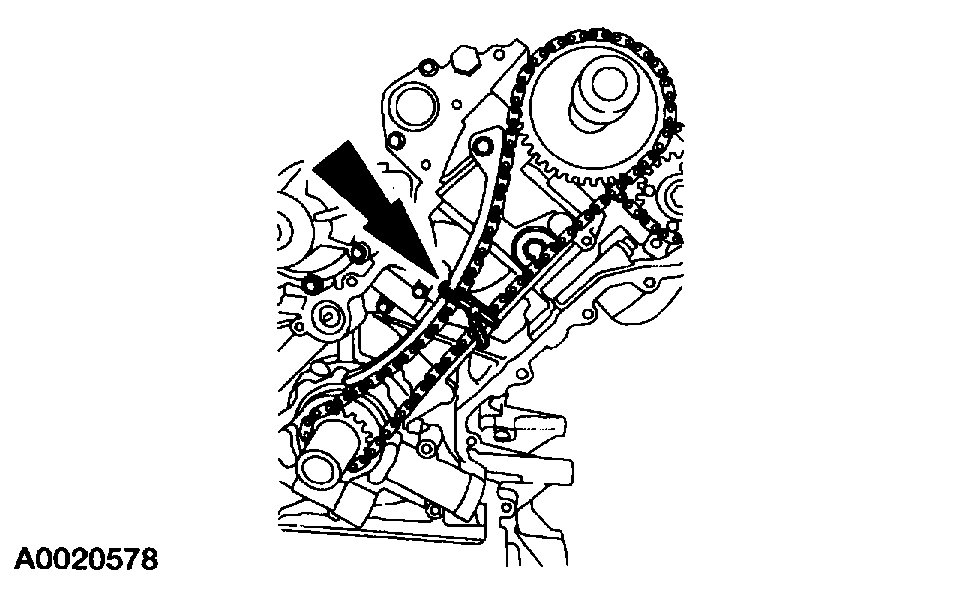

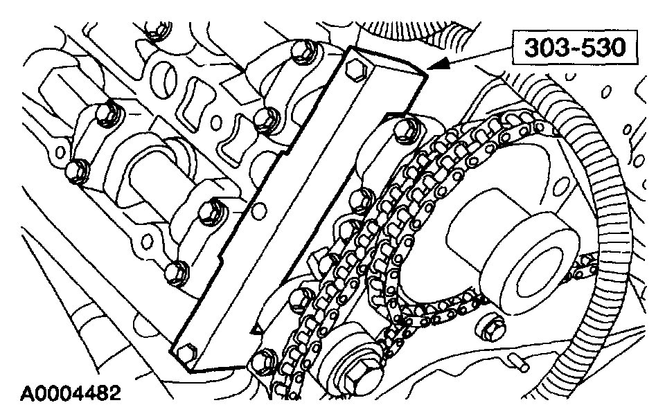

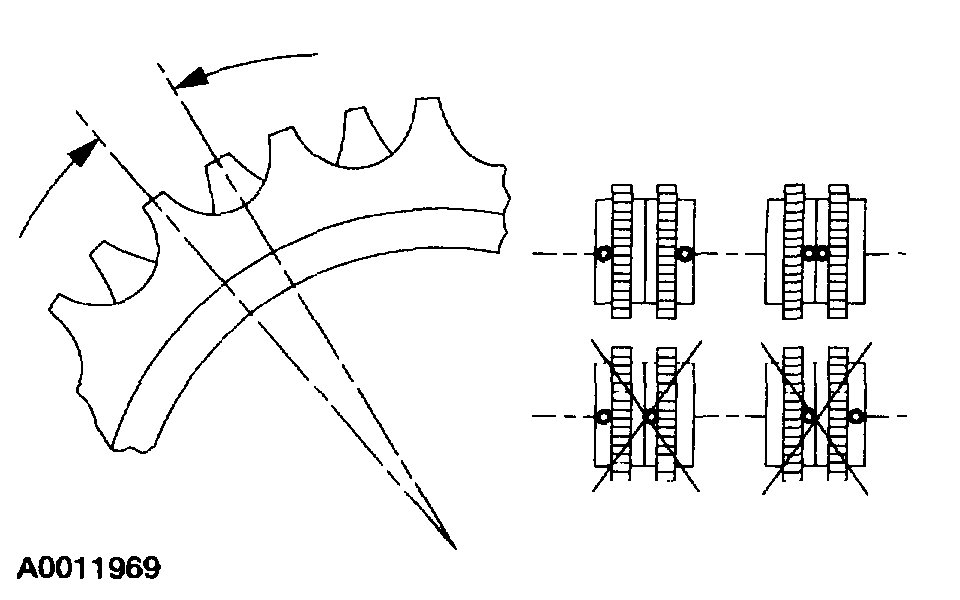

pic 5

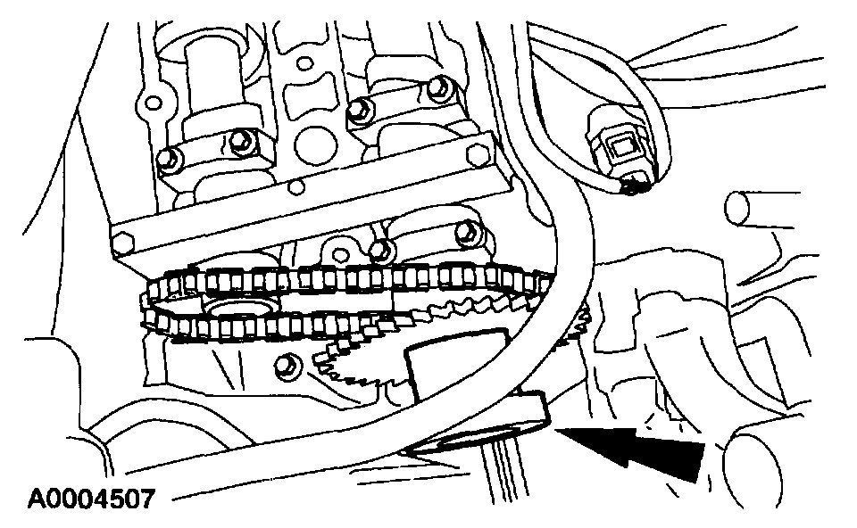

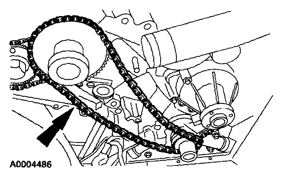

7. Install the special tool on the RH cylinder head.

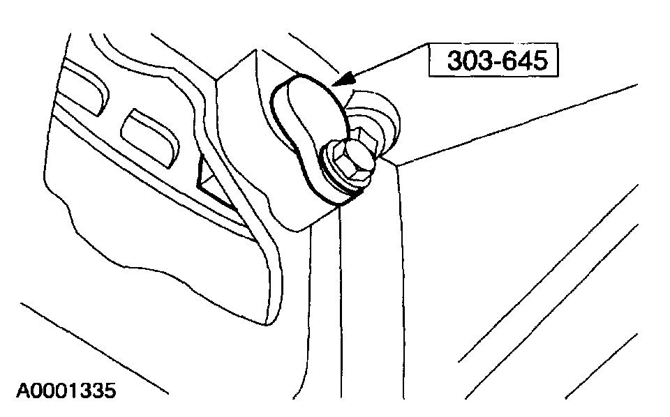

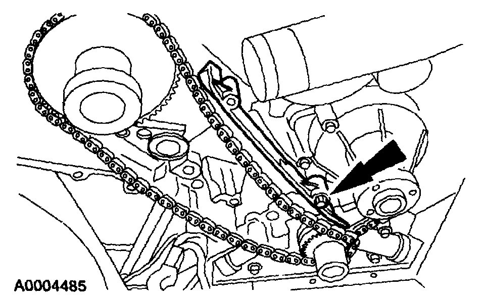

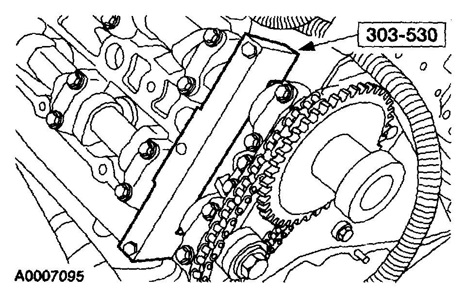

pic 6
8. Loosen the exhaust camshaft sprocket bolt.

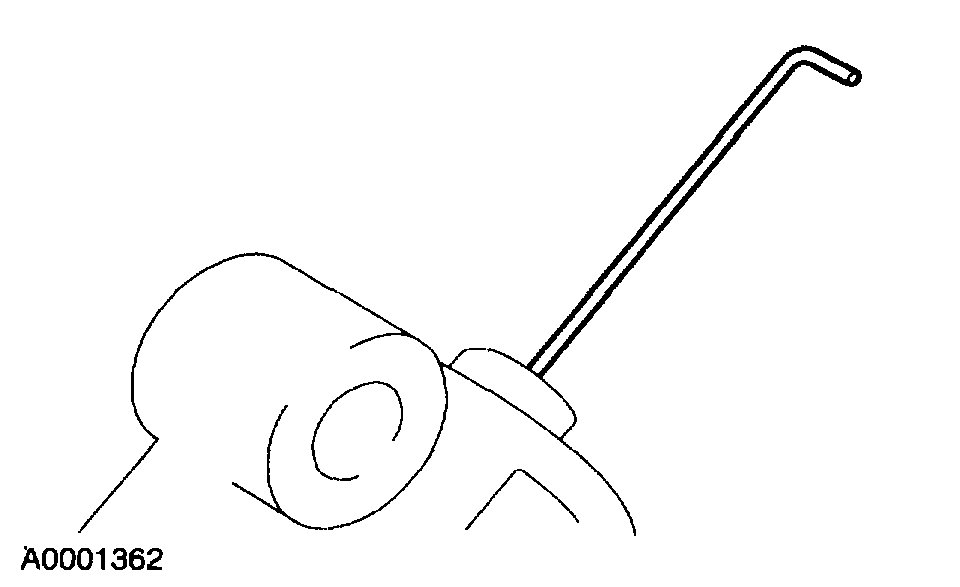

1. Reset the timing chain tensioners.
- Insert a fine wire and dislodge the check ball.
- Using finger pressure, compress the tensioner.
- Remove the wire.

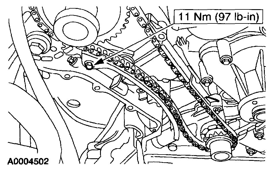

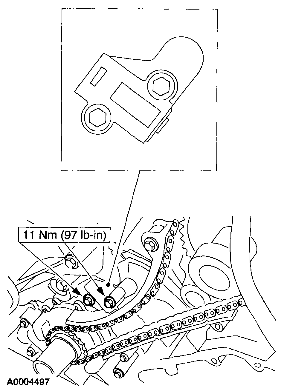

3. Install the LH timing chain guide.
pic 23
4. Install the LH timing chain tensioner arm.
pic 24
5. CAUTION: The orientation of the blanking plate must be as shown or the oil galley will not seal, resulting in low oil pressure and possible engine damage.
Install the LH timing chain tensioner.
- Position the blanking plate.
- Install the LH timing chain tensioner and blanking plate.

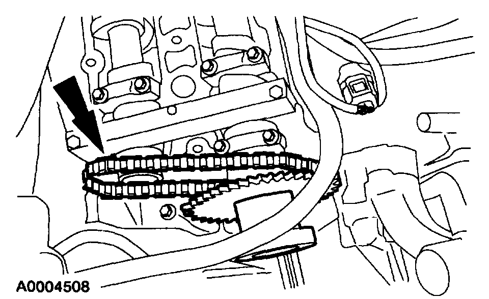

1. Remove the primary timing chains.
pic 39

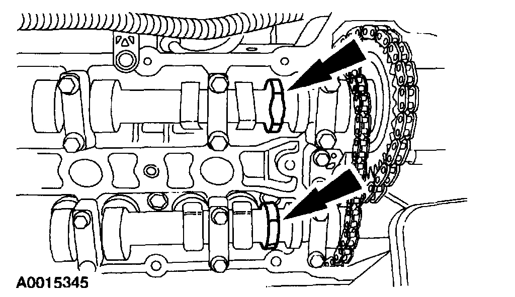

2. Remove the exhaust sprocket bolt.
pic 40
3. Remove the intake sprocket bolt and remove the camshaft damper.
pic 41
4. Remove the sprockets, damper, and chain as an assembly.

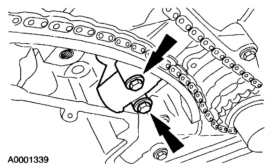

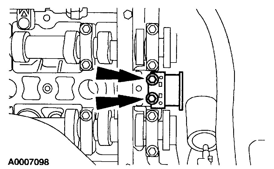

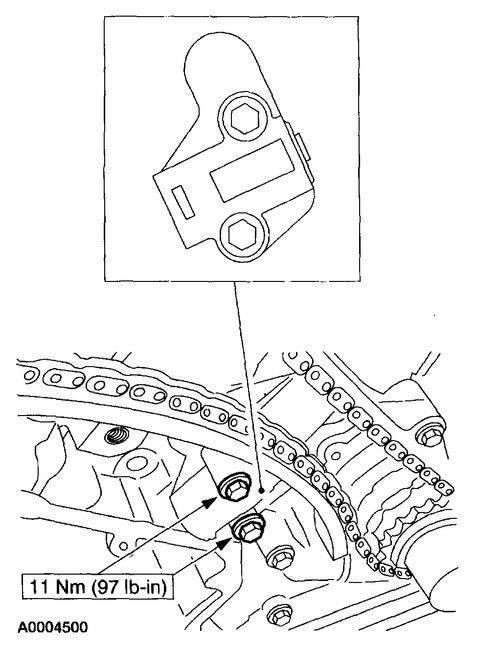

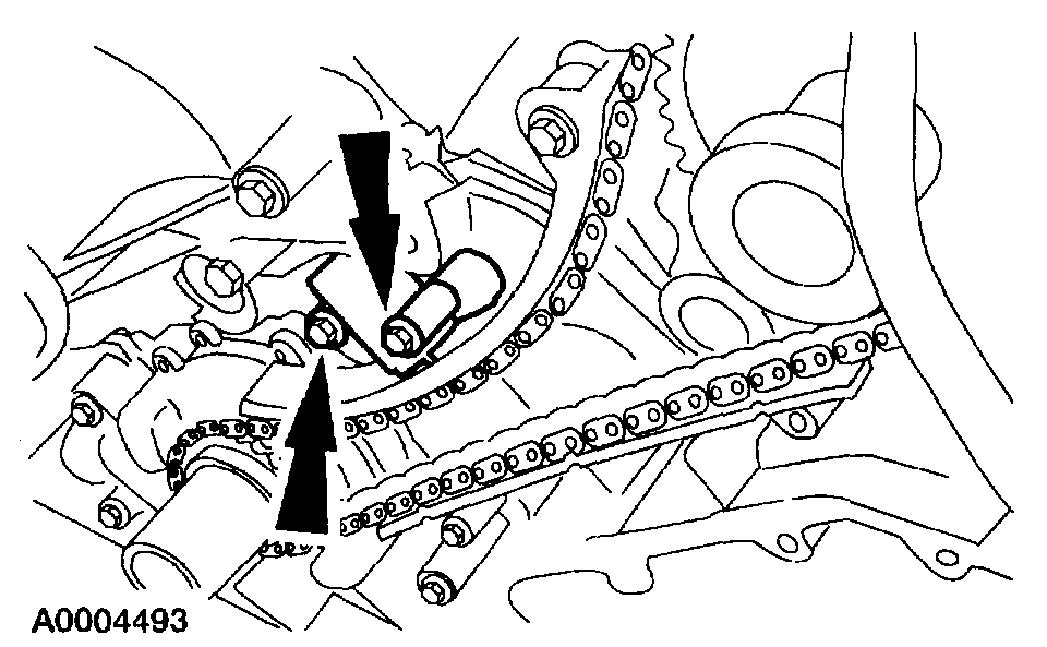

5. Remove the secondary timing chain tensioner bolts.
pic 43
6. Remove the tensioner.
Installation
pic 44
1. Collapse the tensioners.
- Insert a thin wire into the check valve.
- Apply hand pressure until the tensioner is fully collapsed.
- Remove the wire.
