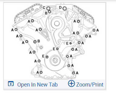

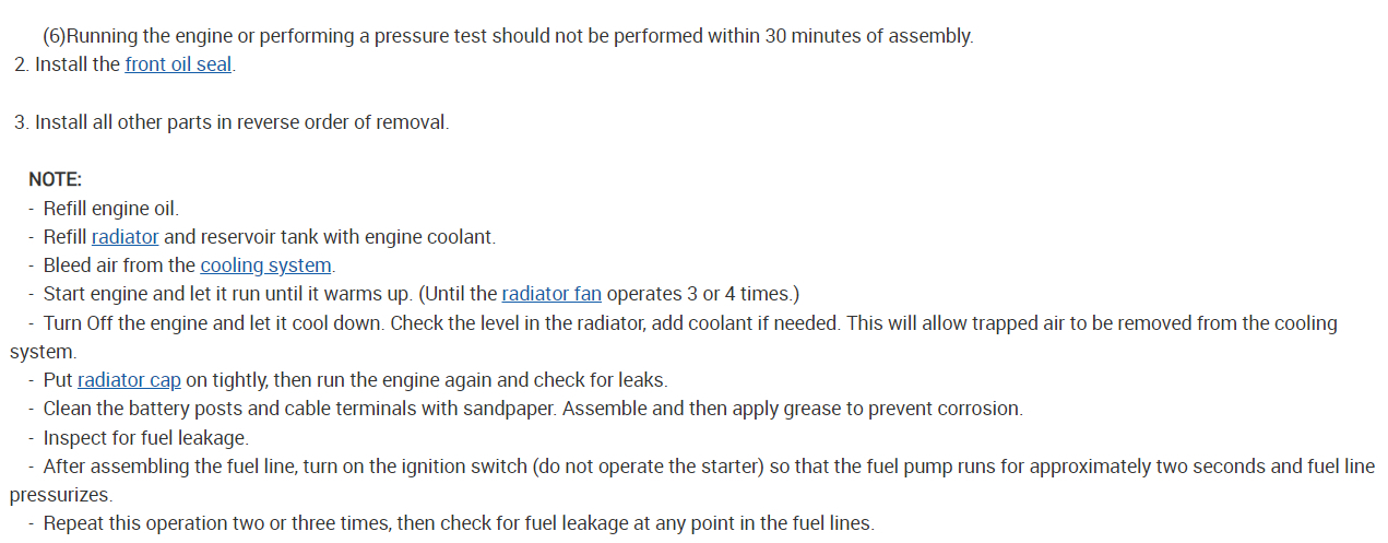

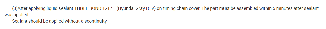

can I get instructions on how to do the job?
Dec 30, 2023 at 1:46 PM

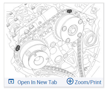

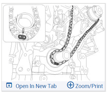

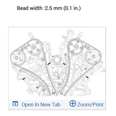

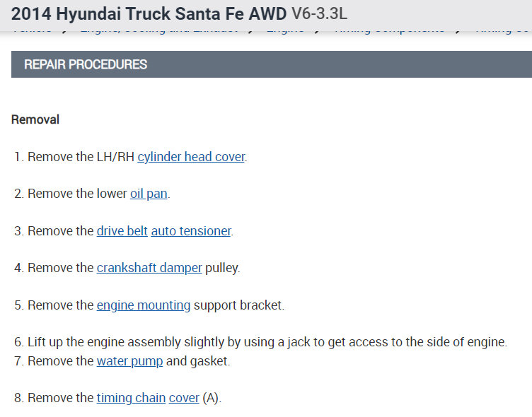

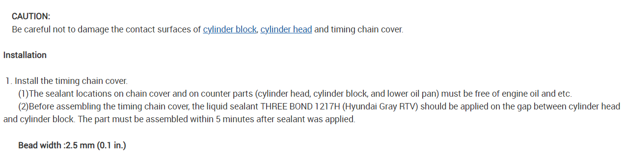

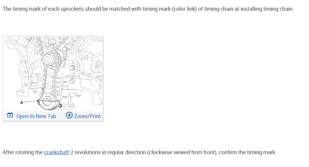

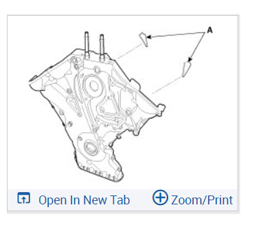

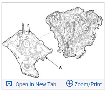

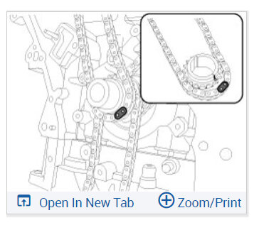

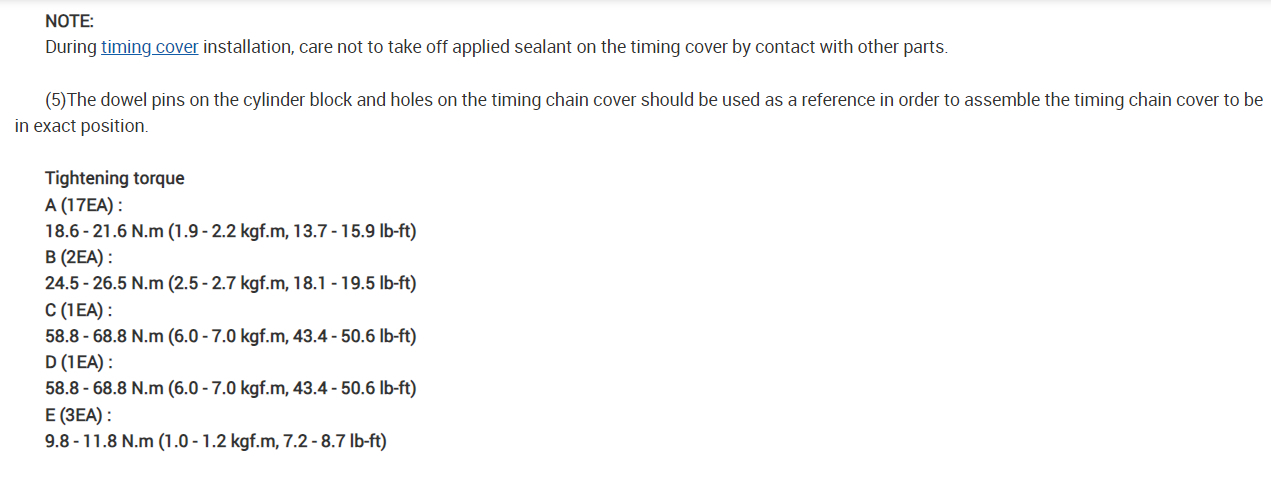

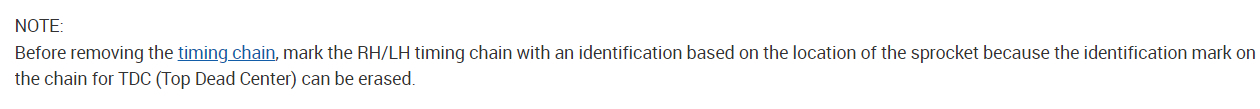

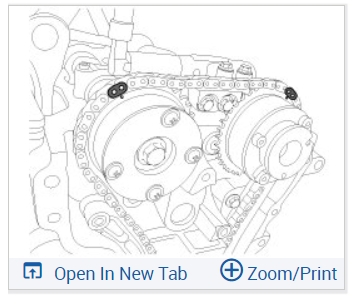

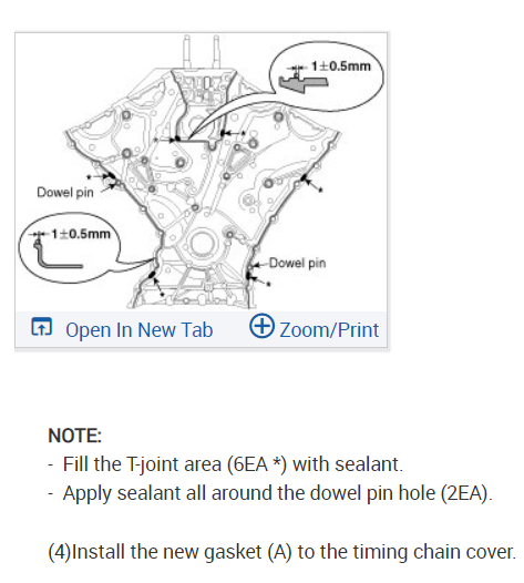

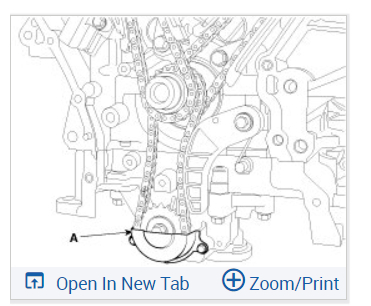

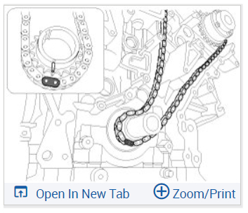

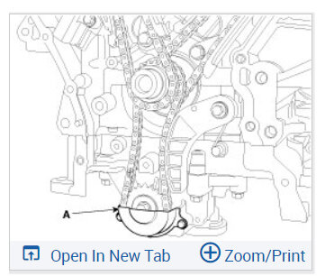

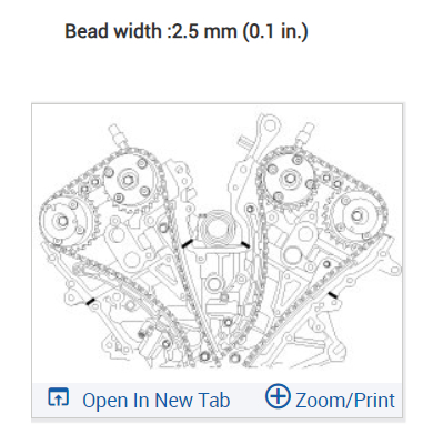

Here is how to change out the timing chain and guides with the timing chain alignment marks. Check out the images (below). Let us know if you need anything else.
