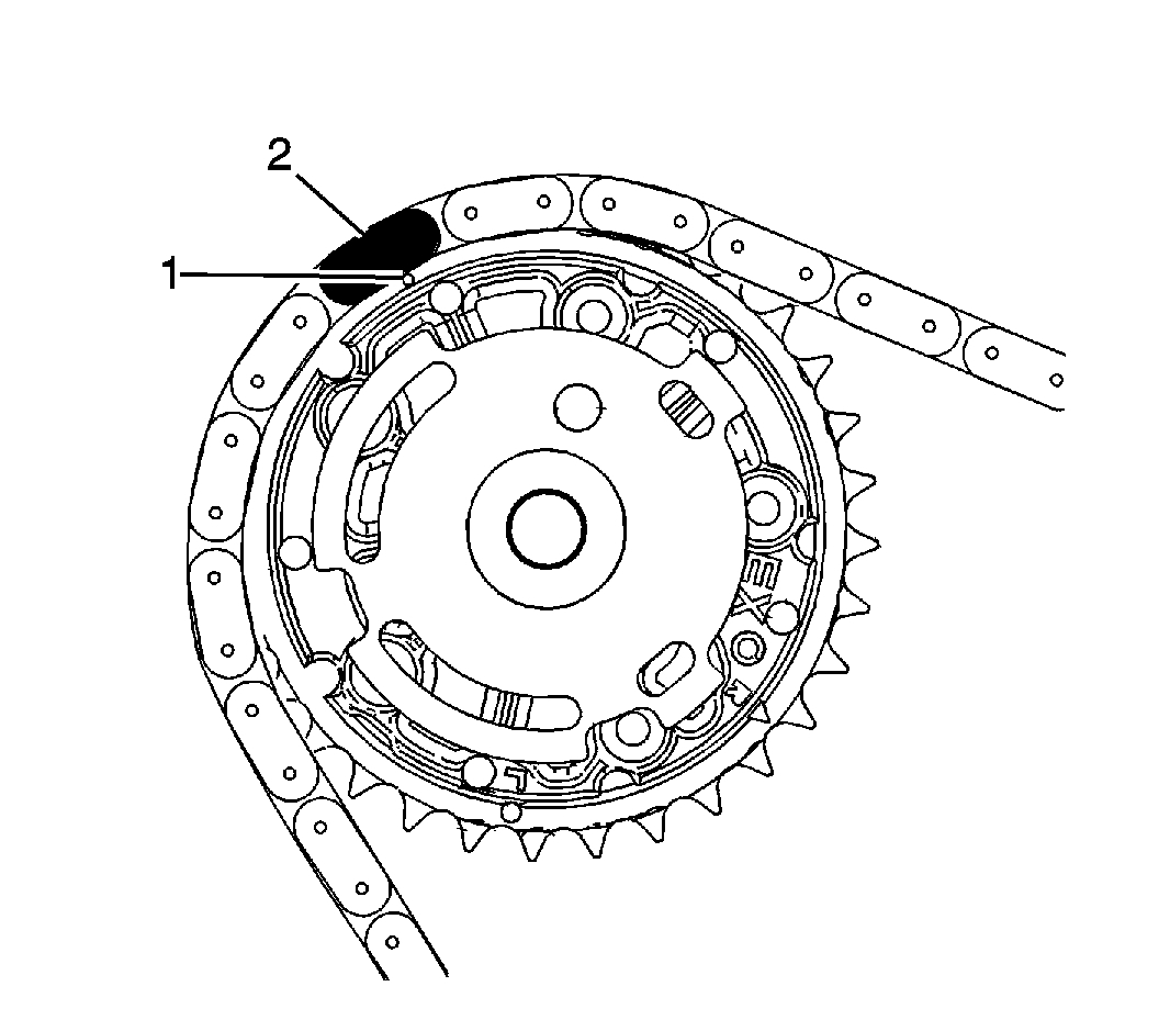

SECONDARY CAMSHAFT INTERMEDIATE DRIVE CHAIN REPLACEMENT - LEFT
Removal Procedure
1. Remove the engine front cover. See: Timing Cover > Procedures > Engine Front Cover Replacement
2. Remove the right bank secondary camshaft drive chain tensioner. See: Engine > Overhaul > 23. Secondary Timing Chain Tensioner Removal - Right
3. Remove the right bank secondary camshaft drive chain shoe. See: Engine > Overhaul > 24. Secondary Camshaft Drive Chain Shoe Removal - Right
4. Remove the right bank secondary camshaft drive chain guide. See: Engine > Overhaul > 25. Secondary Timing Chain Guide Removal - Right
5. Remove the right bank secondary camshaft drive chain. See: Engine > Overhaul > 26. Secondary Camshaft Intermediate Drive Chain Removal - Right
6. Remove the primary camshaft drive chain tensioner. See: Engine > Overhaul > 27. Primary Camshaft Intermediate Drive Chain Tensioner Removal
7. Remove the primary upper camshaft drive chain guide. See: Engine > Overhaul > 28. Primary Timing Chain Guide Removal - Upper
8. Remove the primary camshaft drive chain. See: Engine > Overhaul > 30. Primary Camshaft Intermediate Drive Chain Removal
9. Remove the right bank camshaft intermediate drive chain idler. See: Engine > Overhaul > 31. Timing Chain Idler Sprocket Removal - Right
10. Remove the left bank secondary camshaft drive chain tensioner. See: Engine > Overhaul > 32. Secondary Timing Chain Tensioner Removal - Left
11. Remove the left bank secondary camshaft drive chain shoe. See: Engine > Overhaul > 33. Secondary Camshaft Drive Chain Shoe Removal - Left
12. Remove the left bank secondary camshaft drive chain guide. See: Engine > Overhaul > 34. Secondary Timing Chain Guide Removal - Left
13. Remove the left bank camshaft intermediate drive chain idler. See: Engine > Overhaul > 36. Timing Chain Idler Sprocket Removal - Left

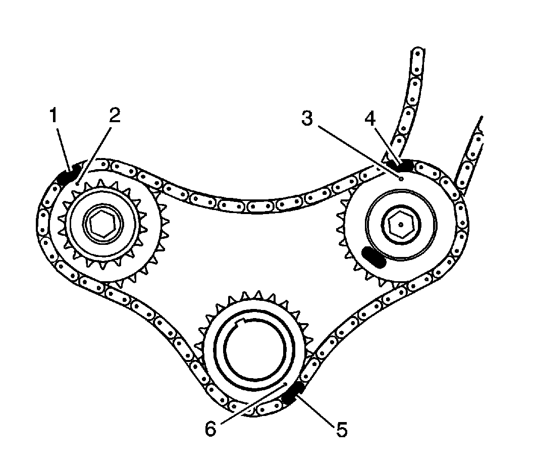

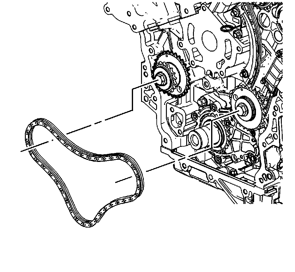

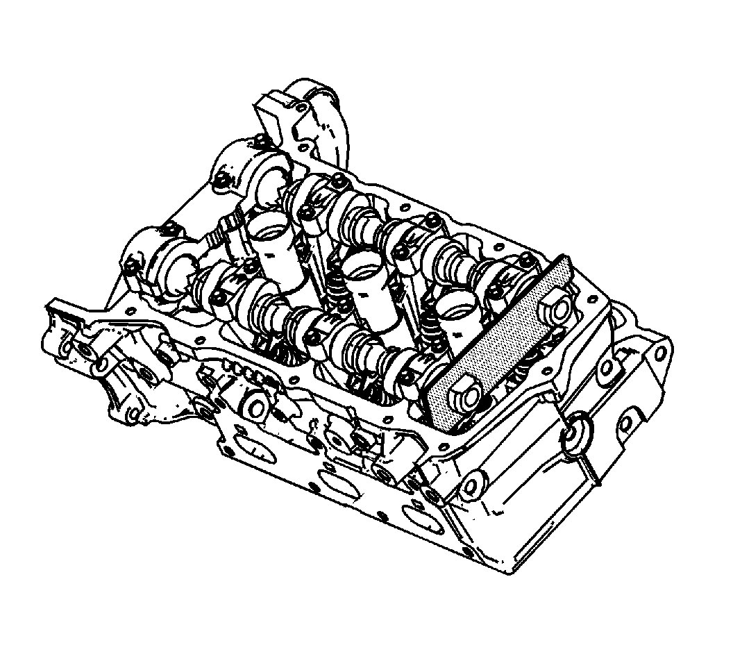

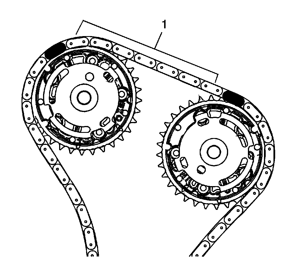

See Picture 1
14. Remove the left bank secondary camshaft drive chain. See: Engine > Overhaul > 35. Secondary Camshaft Intermediate Drive Chain Removal - Left
15. Clean and inspect all of the camshaft timing drive components. Replace components as necessary. See: Engine > Overhaul > 71. Camshaft Timing Drive Components Clean and Inspect
Installation Procedure
See Picture 1
1. Install the left bank secondary camshaft drive chain. See: Engine > Overhaul > 116. Secondary Camshaft Intermediate Drive Chain Installation - Left
2. Install the left bank camshaft intermediate drive chain idler. See: Engine > Overhaul > 115. Timing Chain Idler Sprocket Installation - Left
3. Install the left bank secondary camshaft drive chain guide. See: Engine > Overhaul > 117. Secondary Timing Chain Guide Installation - Left
4. Install the left bank secondary camshaft drive chain shoe. See: Engine > Overhaul > 118. Secondary Camshaft Drive Chain Shoe Installation - Left
5. Install the left bank secondary camshaft drive chain tensioner. See: Engine > Overhaul > 119. Secondary Timing Chain Tensioner Installation - Left
6. Install the right bank camshaft intermediate drive chain idler. See: Engine > Overhaul > 120. Timing Chain Idler Sprocket Installation - Right
7. Install the primary camshaft drive chain. See: Engine > Overhaul > 121. Primary Camshaft Intermediate Drive Chain Installation
8. Install the primary upper camshaft drive chain guide. See: Engine > Overhaul > 123. Primary Timing Chain Guide Installation - Upper
9. Install the primary camshaft drive chain tensioner. See: Engine > Overhaul > 124. Primary Camshaft Intermediate Drive Chain Tensioner Installation
10. Install the right bank secondary camshaft drive chain. See: Engine > Overhaul > 125. Secondary Camshaft Intermediate Drive Chain Installation - Right
11. Install the right bank secondary camshaft drive chain guide. See: Engine > Overhaul > 126. Secondary Timing Chain Guide Installation - Right
12. Install the right bank secondary camshaft drive chain shoe. See: Engine > Overhaul > 127. Secondary Camshaft Drive Chain Shoe Installation - Right
13. Install the right bank secondary camshaft drive chain tensioner. See: Engine > Overhaul > 128. Secondary Timing Chain Tensioner Installation - Right
14. Install the engine front cover. See: Timing Cover > Procedures > Engine Front Cover Replacement

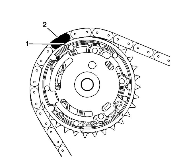

SECONDARY CAMSHAFT INTERMEDIATE DRIVE CHAIN REPLACEMENT - RIGHT
Removal Procedure

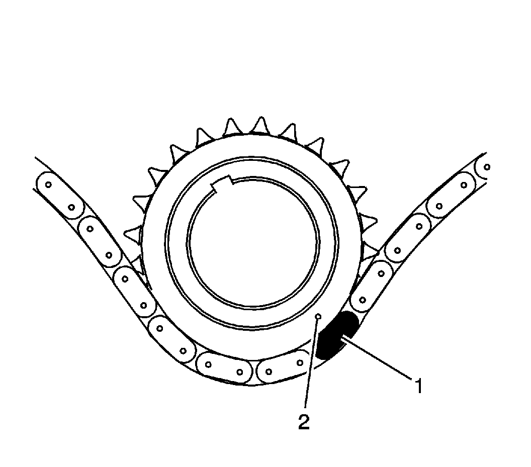

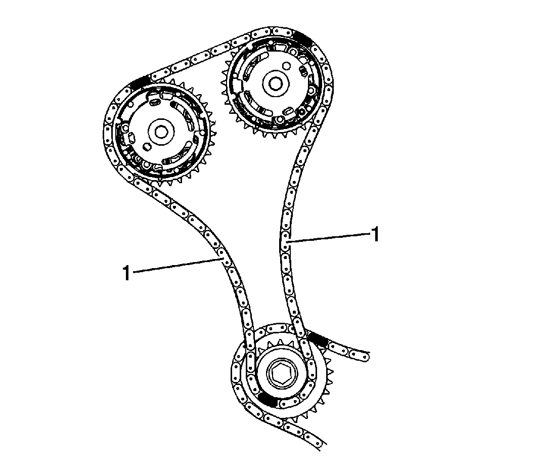

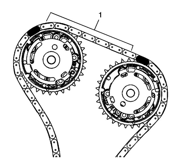

Picture 2
Picture 2
1. Install the right bank secondary camshaft drive chain. See: Engine > Overhaul > 125. Secondary Camshaft Intermediate Drive Chain Installation - Right
2. Install the right bank secondary camshaft drive chain guide. See: Engine > Overhaul > 126. Secondary Timing Chain Guide Installation - Right
3. Install the right bank secondary camshaft drive chain shoe. See: Engine > Overhaul > 127. Secondary Camshaft Drive Chain Shoe Installation - Right
4. Install the right bank secondary camshaft drive chain tensioner. See: Engine > Overhaul > 128. Secondary Timing Chain Tensioner Installation - Right
5. Install the engine front cover. See: Timing Cover > Procedures > Engine Front Cover Replacement

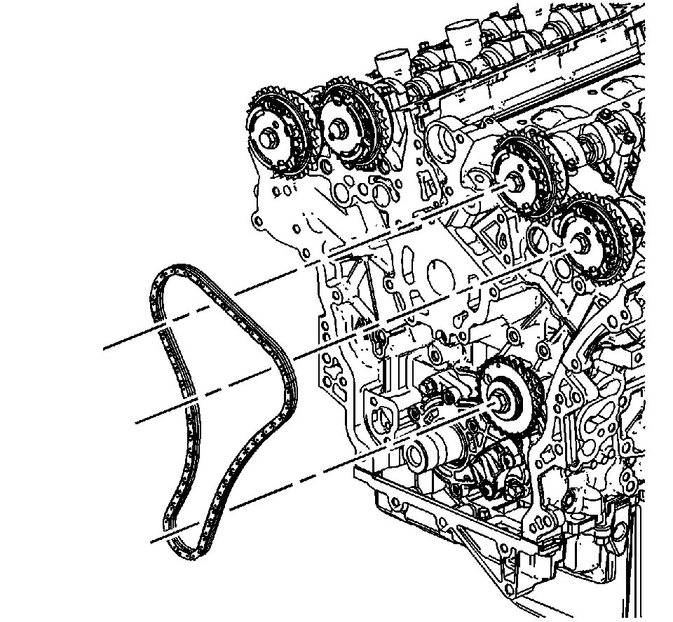

PRIMARY CAMSHAFT DRIVE CHAIN AND SPROCKETS REPLACEMENT
Removal Procedure
7. Remove the primary camshaft drive chain upper guide. See: Engine > Overhaul > 28. Primary Timing Chain Guide Removal - Upper

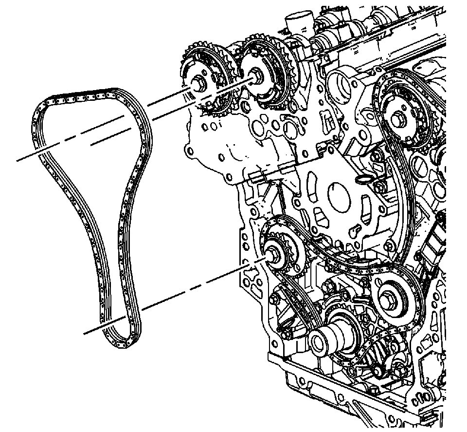

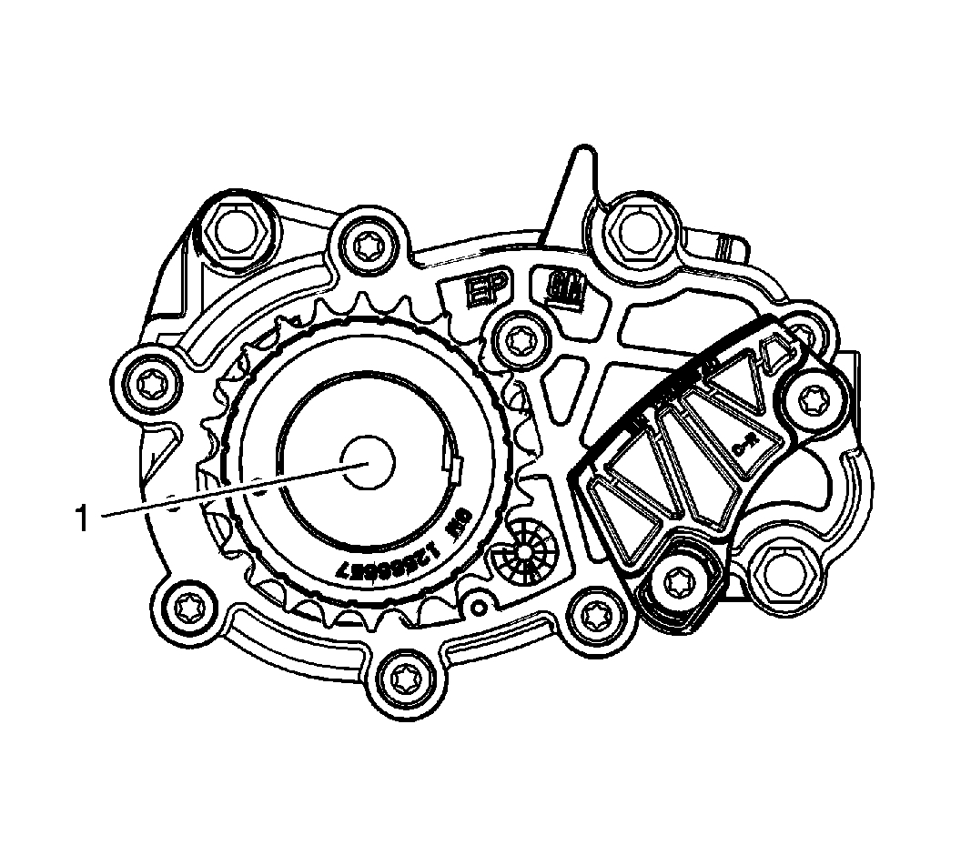

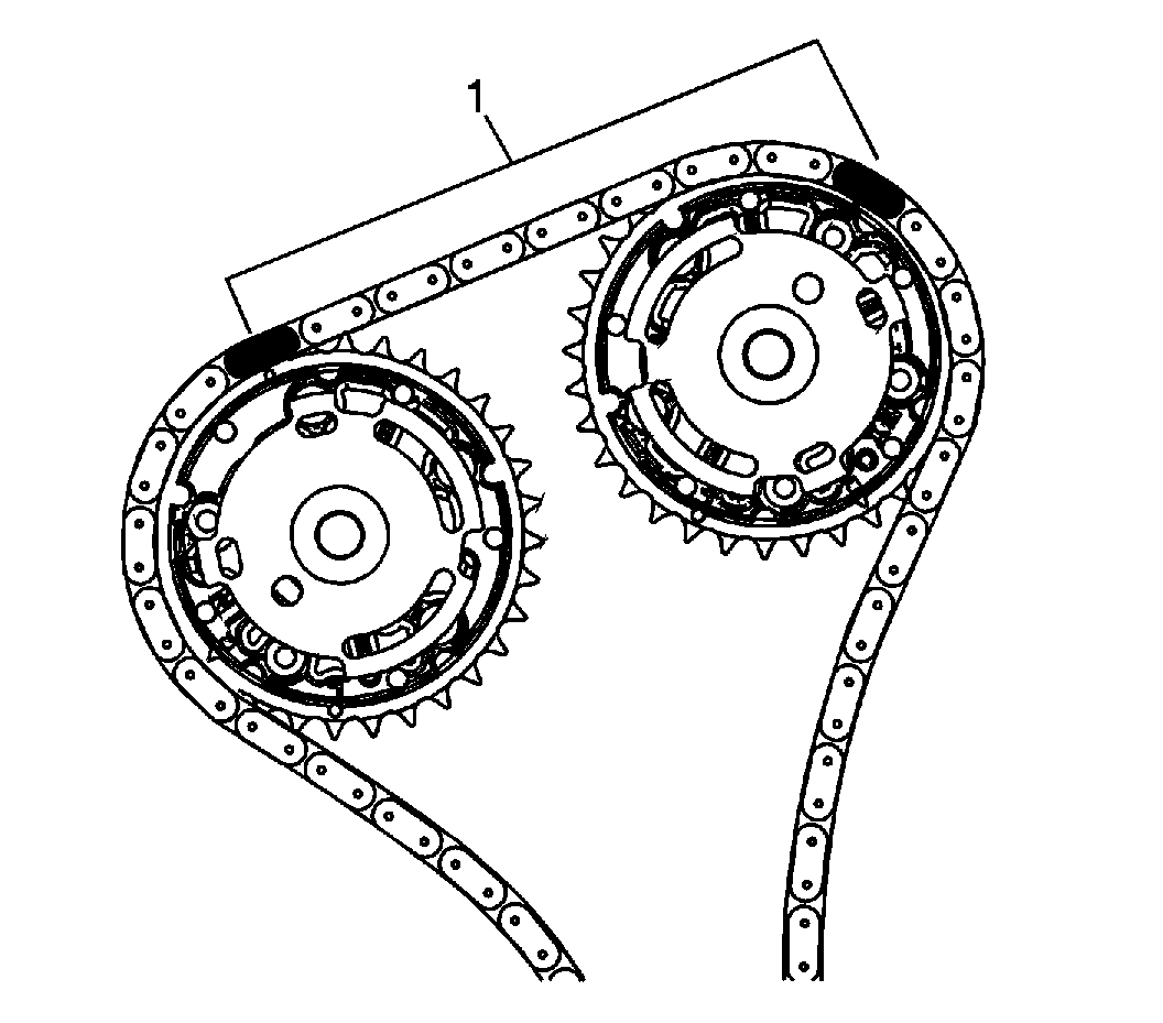

Picture 3
8. Remove the primary camshaft timing chain. See: Engine > Overhaul > 30. Primary Camshaft Intermediate Drive Chain Removal
Picture 3
1. Install the primary camshaft timing chain. See: Engine > Overhaul > 121. Primary Camshaft Intermediate Drive Chain Installation
2. Install the primary upper camshaft drive chain guide. See: Engine > Overhaul > 123. Primary Timing Chain Guide Installation - Upper
3. Install the primary camshaft drive chain tensioner. See: Engine > Overhaul > 124. Primary Camshaft Intermediate Drive Chain Tensioner Installation
4. Install the right bank secondary camshaft drive chain. See: Engine > Overhaul > 125. Secondary Camshaft Intermediate Drive Chain Installation - Right
5. Install the right bank secondary camshaft drive chain guide. See: Engine > Overhaul > 126. Secondary Timing Chain Guide Installation - Right
6. Install the right bank secondary camshaft drive chain shoe. See: Engine > Overhaul > 127. Secondary Camshaft Drive Chain Shoe Installation - Right
7. Install the right bank secondary camshaft drive chain tensioner. See: Engine > Overhaul > 128. Secondary Timing Chain Tensioner Installation - Right
8. Install the engine front cover. See: Timing Cover > Procedures > Engine Front Cover Replacement

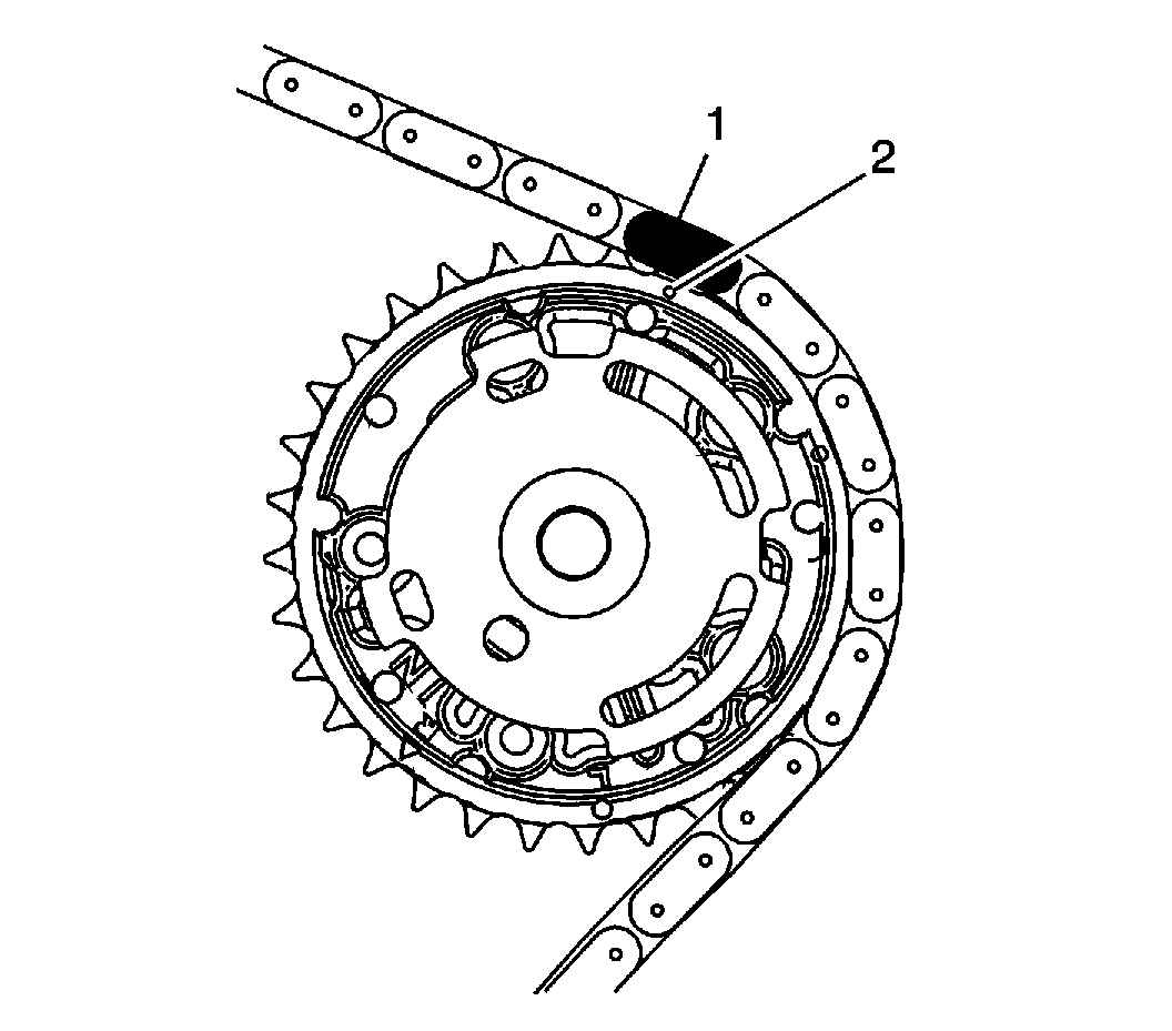

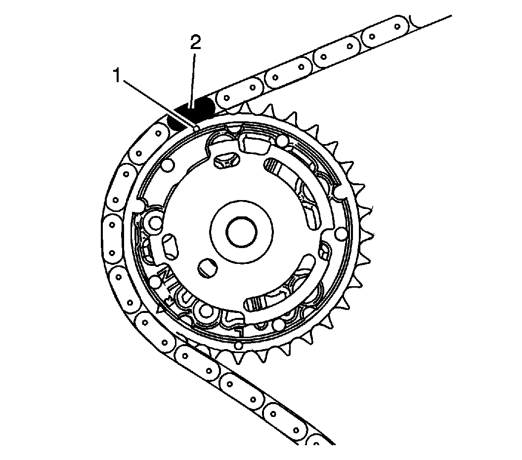

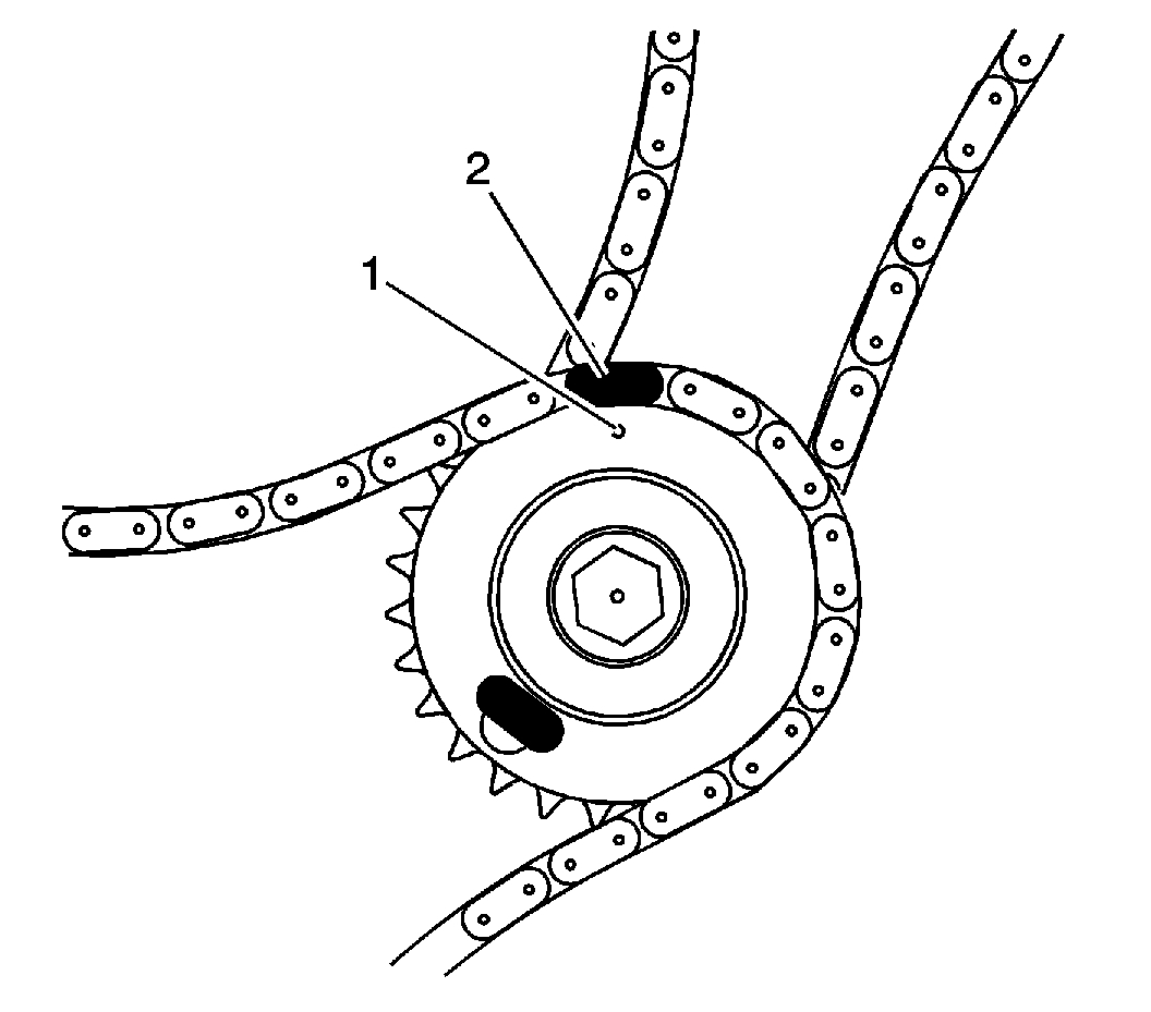

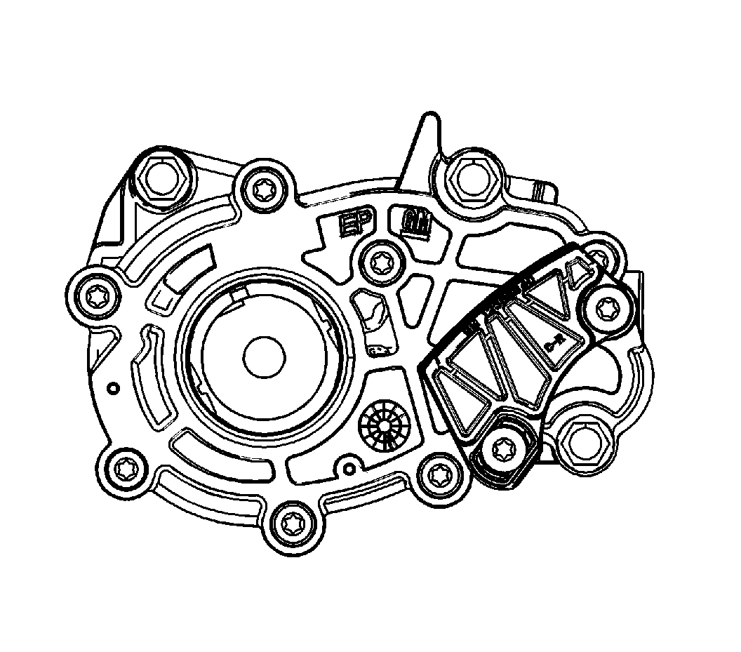

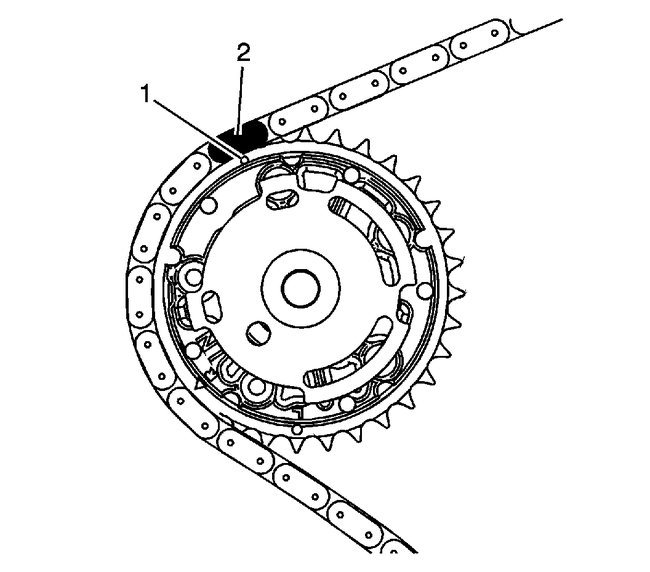

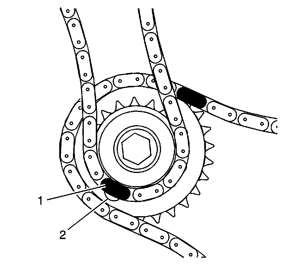

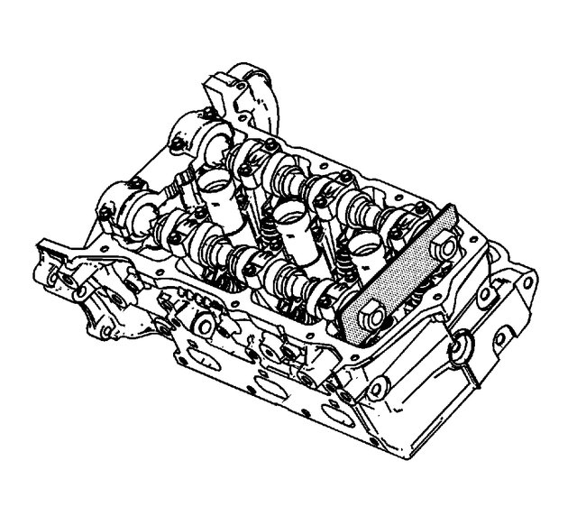

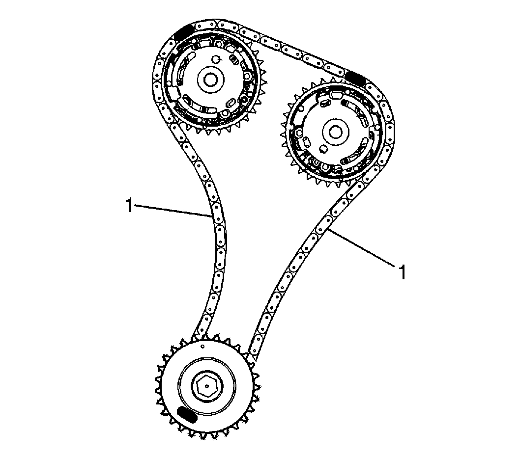

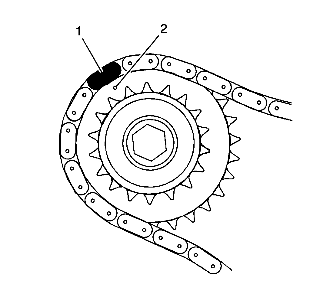

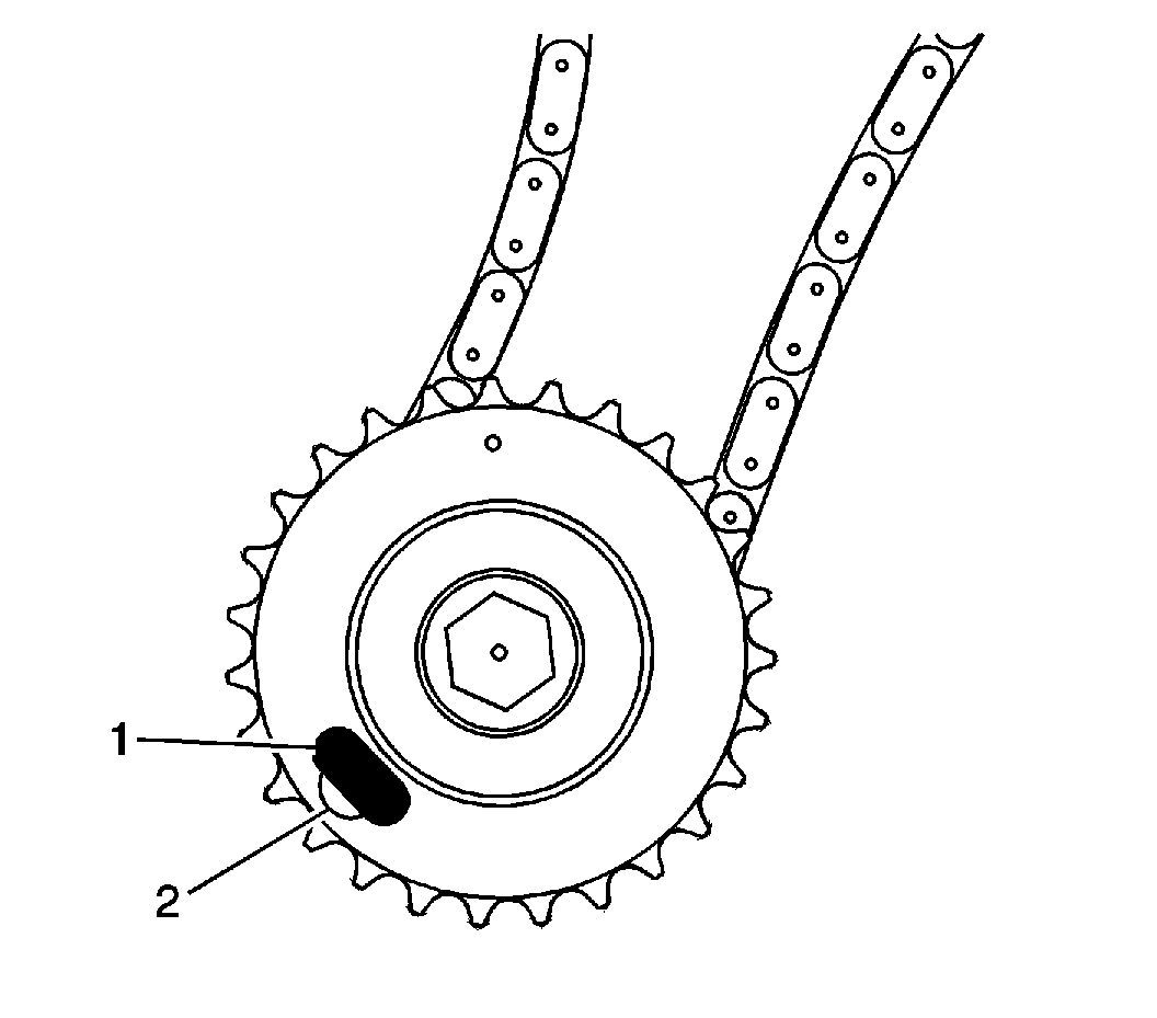

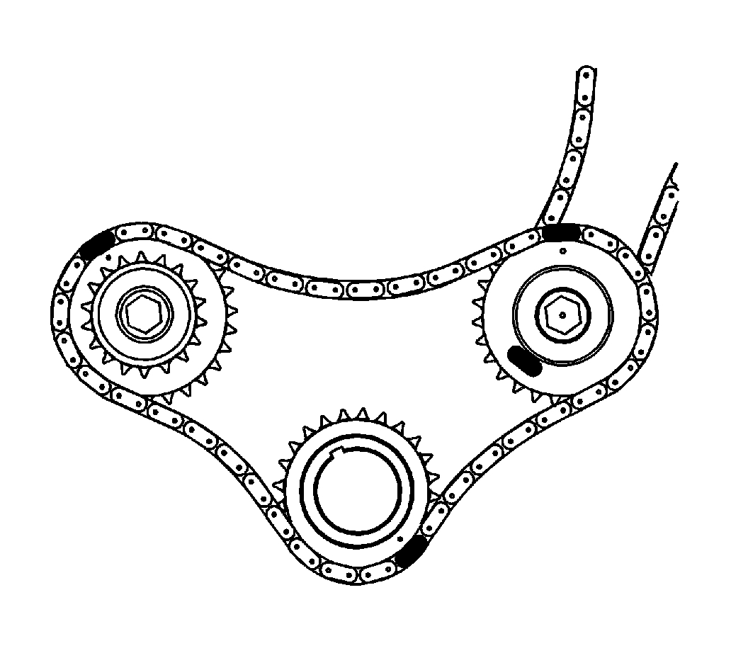

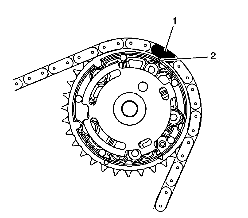

Pictures 4-7 show timing marks as a guide

7. Ensure there are 7 links (1) between the timing camshaft drive chain links for the camshaft position actuator sprockets.

8. Align the left exhaust camshaft position actuator sprocket alignment circle mark (2) with the timing camshaft drive chain link (1).

9. Align the left intake camshaft position actuator sprocket alignment circle mark (1) with the timing camshaft drive chain link (2).

10. There will be 18 links (1) between the left camshaft intermediate drive chain idler timing secondary camshaft drive chain link and each left camshaft position actuator sprocket timing secondary camshaft drive chain link.

3. The left camshaft intermediate drive chain idler timing mark (1) will align with a timing camshaft drive chain link (2).
