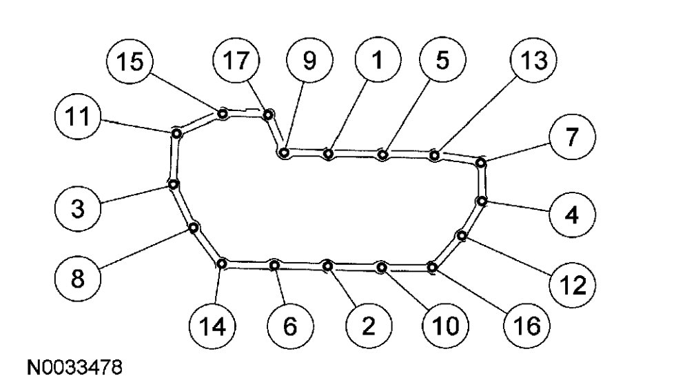

It could be a bearing. In order to check, you would need to drop the pan and loosen all the mains and rods to see if it has a failed bearing. Tough job to do in the car.
Removal
CAUTION: During engine repair procedures, cleanliness is extremely important. Any foreign material, including any material created while cleaning gasket surfaces, that enters the oil passages, coolant passages or the oil pan can cause engine failure.
1. With the vehicle in NEUTRAL, position it on a hoist. For additional information, refer to Maintenance/Service and Repair.
2. Disconnect the battery ground cable. For additional information, refer to Battery.
3. Drain the engine oil.
4. Remove the 17 bolts and the oil pan.
^ Discard the gasket.
Installation
1. CAUTION: Do not use metal scrapers, wire brushes, power abrasive discs or other abrasive means to clean the sealing surfaces. These tools cause scratches and gouges, which make leaks paths. Use a plastic scraping tool to remove all traces of sealant.
Clean the gasket sealing surfaces.
2. NOTE: Make sure all gasket sealing surfaces are clean and dry.
imageZoom/Print
Install a new oil pan gasket, oil pan and 17 bolts.
^ Tighten the bolts in the sequence shown in two stages.
- Stage 1: Tighten to 5 Nm (44 inch lbs.).
- Stage 2: Tighten to 12 Nm (9 ft. lbs.).
3. Fill the engine with clean engine oil.
4. Connect the battery ground cable. For additional information, refer to battery.
Jun 3, 2018 at 9:20 AM
