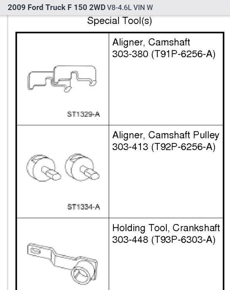

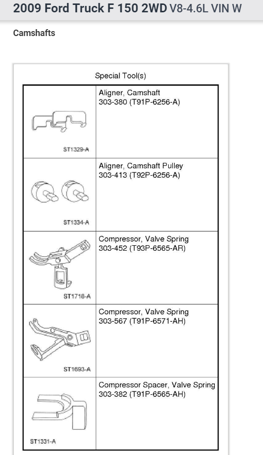

Special Tool(s)
Fig. 274: Identifying Special Tools

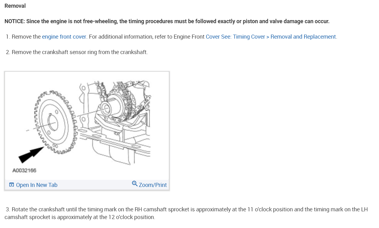

CAUTION:Since the engine is not free-wheeling, the timing procedures must be followed exactly or piston and valve damage can occur.
Remove the engine front cover. Refer to ENGINE FRONT COVER .
Remove the crankshaft sensor ring from the crankshaft.

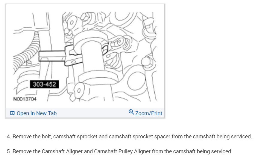

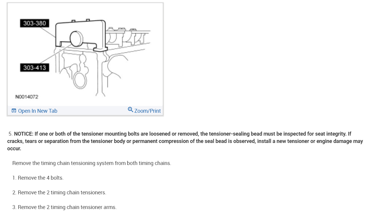

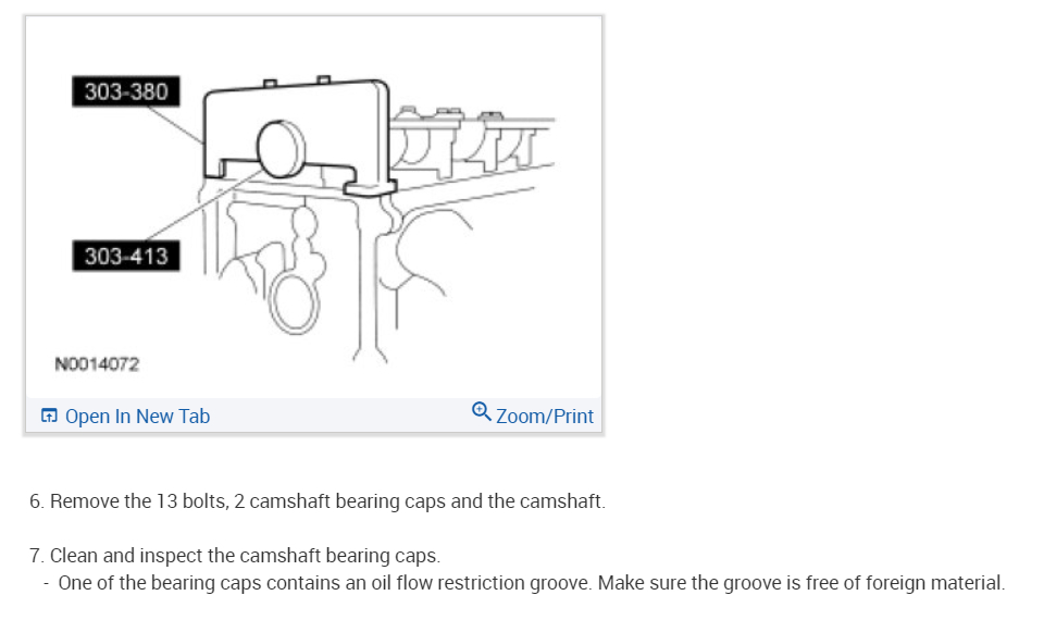

Install and fully tighten the special tools on both camshafts.
Fig. 278: Installing Fully Tighten Special Tools On Both Camshafts
Courtesy of FORD MOTOR CO.

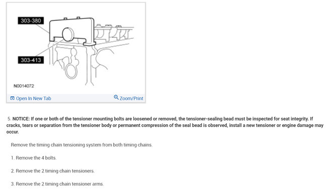

Remove the timing chain tensioning system from both timing chains.
Remove the bolts.
Remove the timing chain tensioners.
Remove the timing chain tensioner arms.

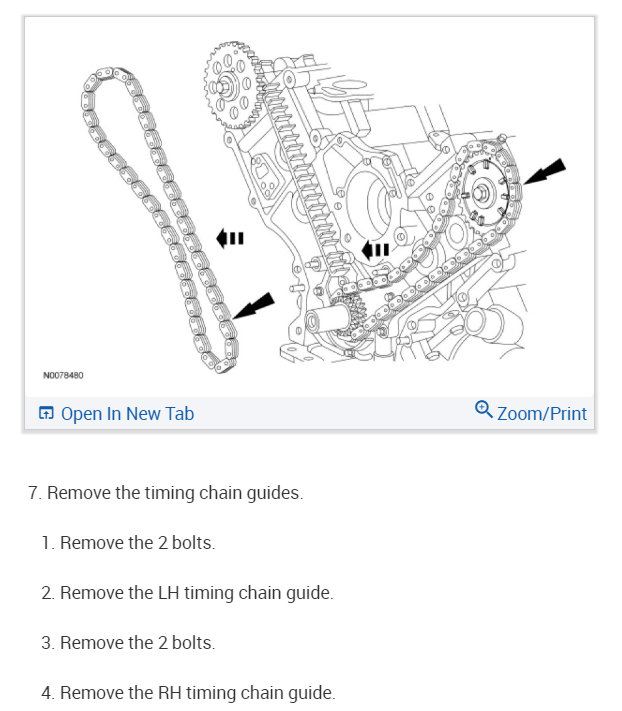

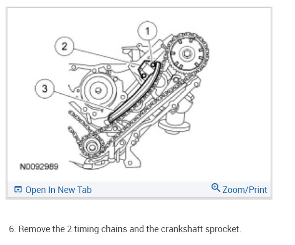

Fig. 280: Removing RH And LH Timing Chains And Crankshaft Sprocket
CAUTION:Unless otherwise instructed, at no time when the timing chains are removed and the cylinders heads are installed is the crankshaft or camshaft to be rotated. Severe piston and valve damage will occur.
Remove the RH and LH timing chains and the crankshaft sprocket.
Remove the RH timing chain from the camshaft sprocket.
Remove the RH timing chain and from the crankshaft sprocket.
Remove the LH timing chain from the camshaft sprocket.
Remove the LH timing chain and crankshaft sprocket.
Remove both timing chain guides.
Remove the bolts.
Fig. 281: Removing Timing Chain Guides

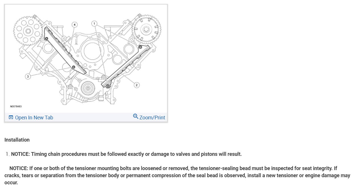

Installation
CAUTION:Timing chain procedures must be followed exactly or damage to valves and pistons will result.

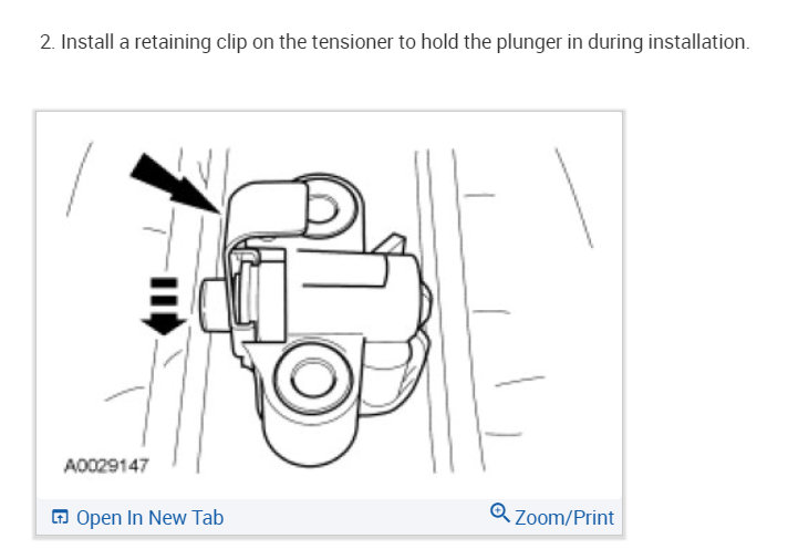

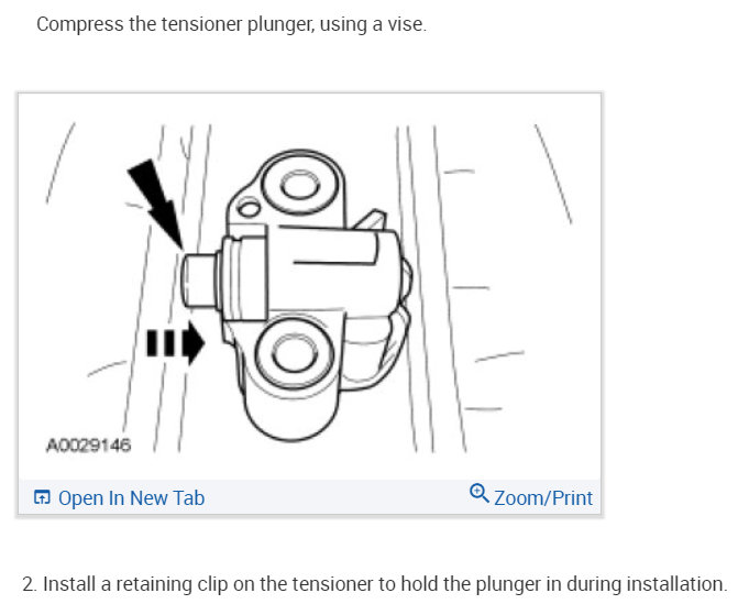

Compress the tensioner plunger, using a vise.
Install a retaining clip on the tensioner to hold the plunger in during installation.
Fig. 283: Installing Retaining Clip On Tensioner To Hold Plunger In During Installation
Remove the tensioner from the vise.

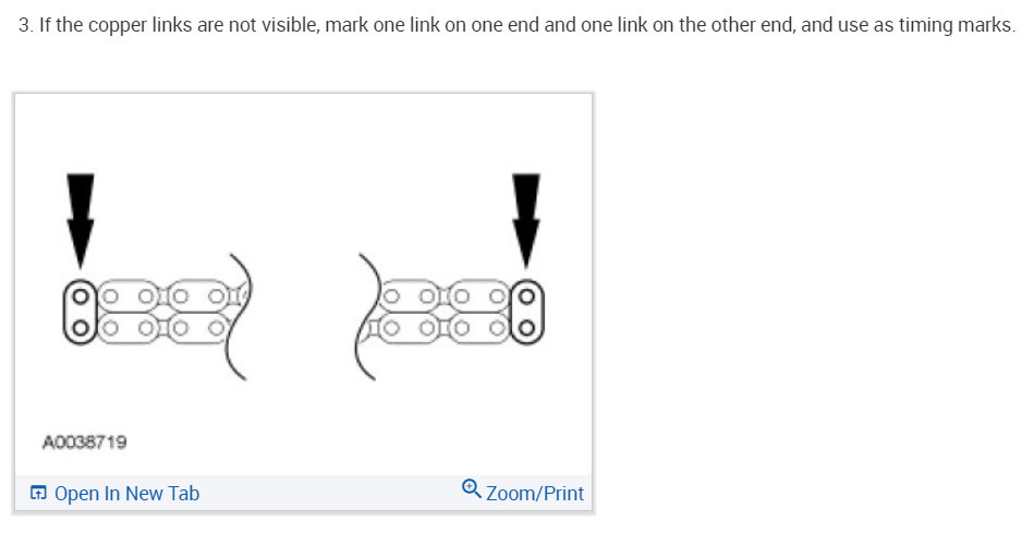

If the copper links are not visible, mark two links on one end and one link on the other end, and use as timing marks.
Fig. 284: Identifying Timing Marks On Timing Chain

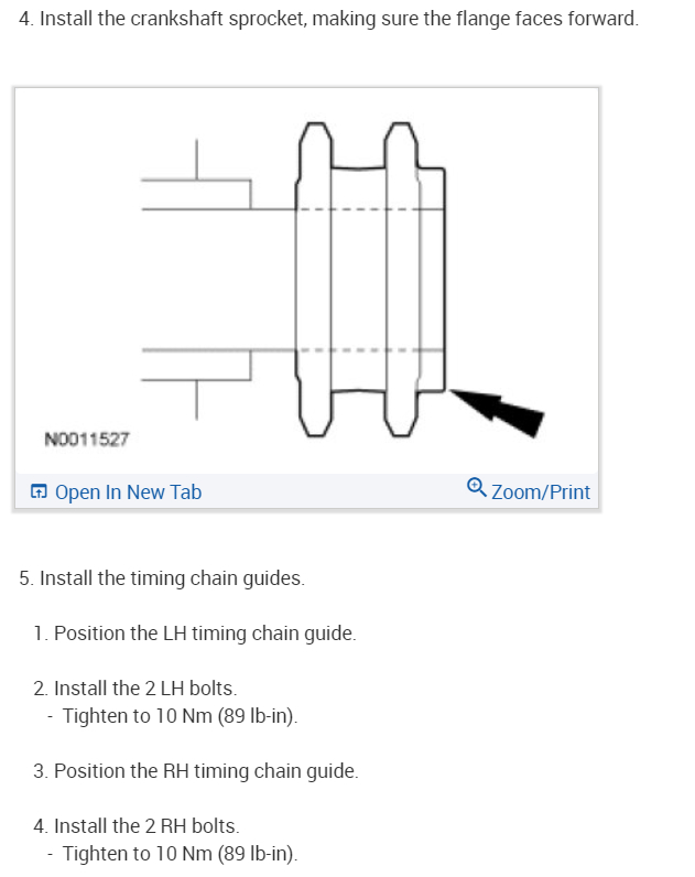

Fig. 285: Installing Timing Chain Guides
Install the timing chain guides.

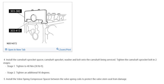

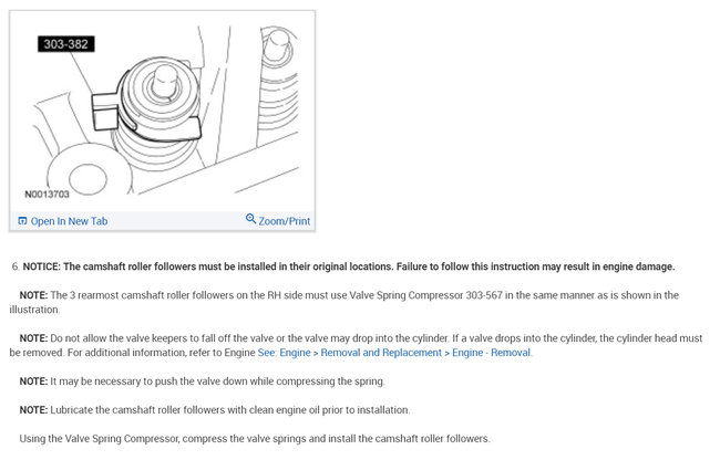

Install the Camshaft Positioning Tool.
NOTE:Slightly loosen the camshaft holding tools to allow slight camshaft movement.
Pre-position the camshafts.

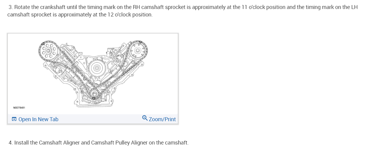

Rotate the LH camshaft with the Camshaft Positioning Tool until the timing mark is approximately at 12 o'clock.
Rotate the RH camshaft with the Camshaft Positioning Tool until the timing mark is approximately at 11 o'clock.
Tighten the Camshaft Holding Tools to maintain camshaft pre-positioning.

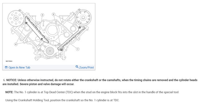

CAUTION:Unless otherwise instructed, at no time when the timing chains are removed and the cylinder heads are installed is the crankshaft or camshaft to be rotated. Severe piston and valve damage will occur.

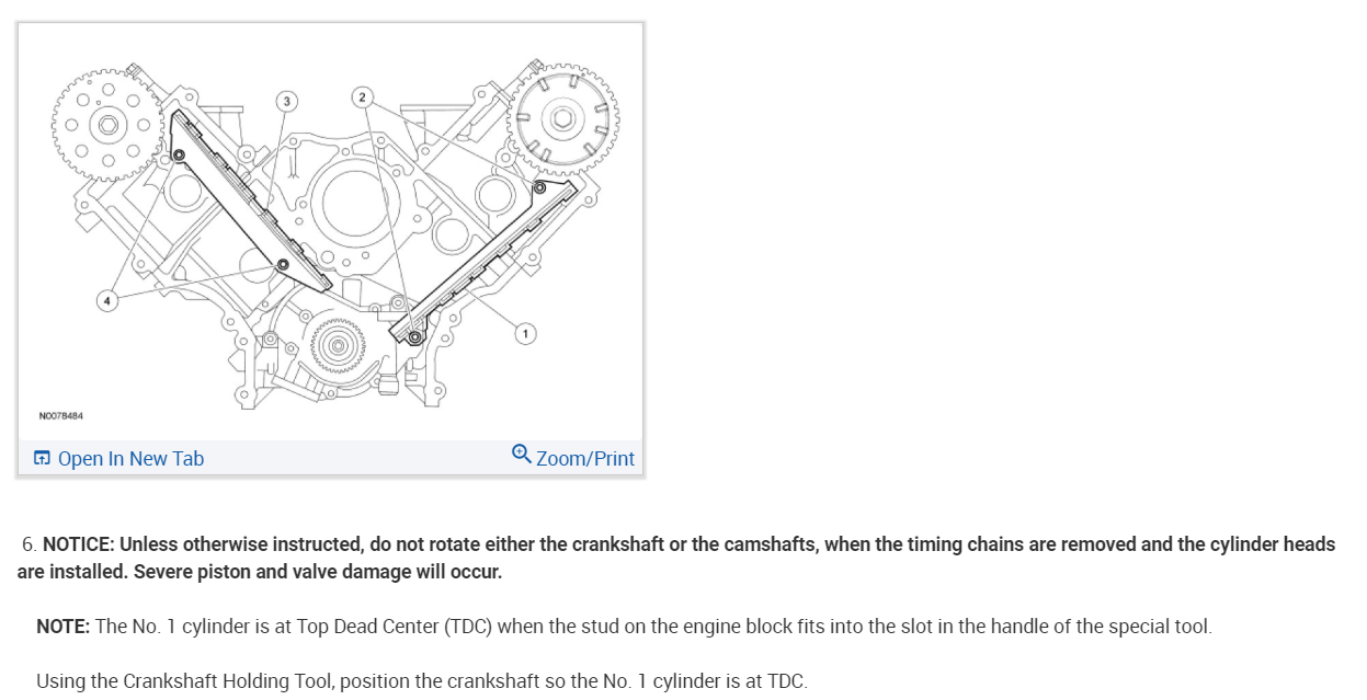

CAUTION:Rotate the crankshaft counterclockwise only. Do not rotate past position shown or severe piston and valve damage can occur.

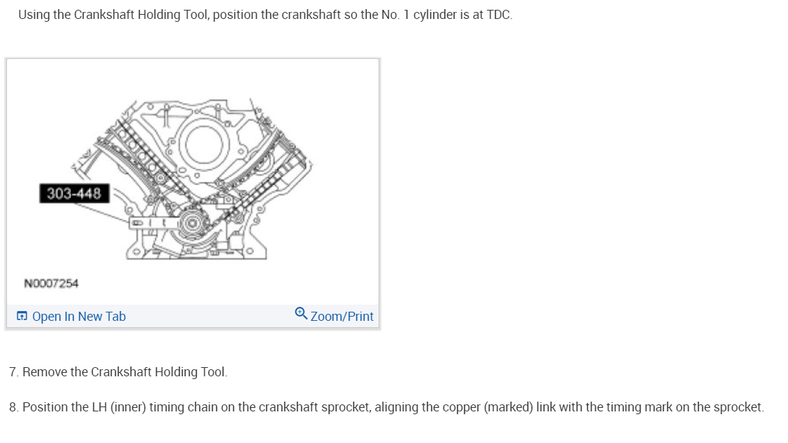

NOTE:The number one cylinder is at top dead center (TDC) when the stud on the engine block fits into the slot in the handle of the special tool.
Fig. 288: Rotating Crankshaft Counterclockwise
Position the crankshaft so the number one cylinder is at TDC with the special tool.
Remove the Crankshaft Holding Tool.
Install the crankshaft sprocket, make sure the flange faces forward.
Fig. 289: Identifying Direction Of Flange For Installing Crankshaft Sprocket

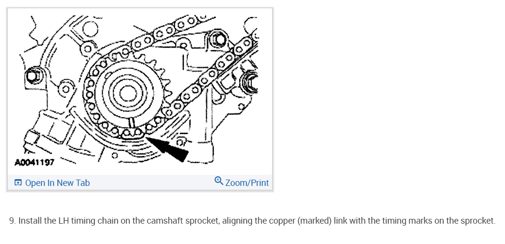

Position the lower end of the LH (inner) timing chain on the crankshaft sprocket, aligning the timing mark on the outer flange of the crankshaft sprocket with the single copper (marked) link on the chain.
Fig. 290: Aligning Timing Mark On Outer Flange Of Crankshaft Sprocket With Single Copper (Marked) Link On Chain

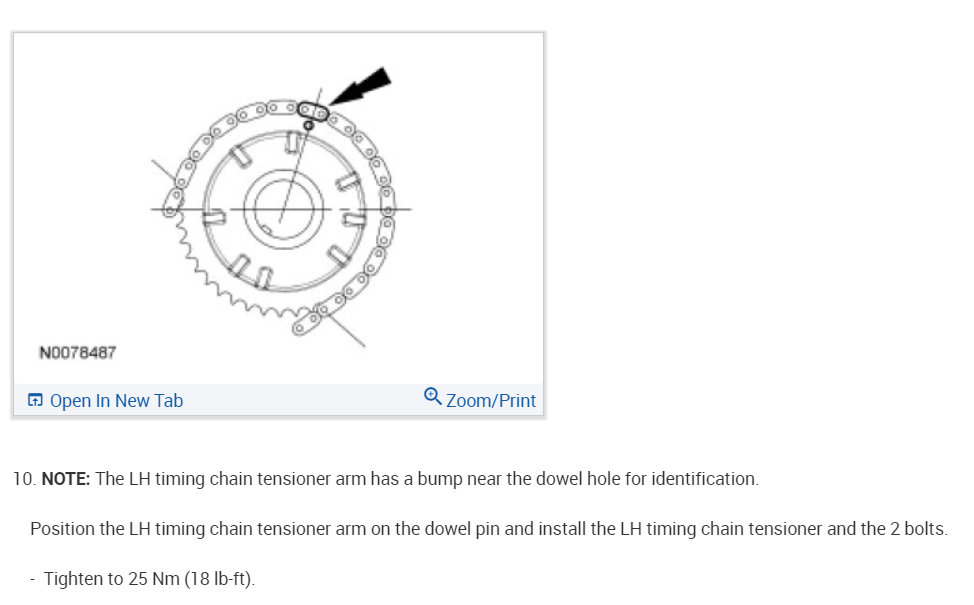

NOTE:The LH timing chain tensioner arm has a bump near the dowel hole, for identification.
Fig. 292: Identifying Tightening Torque Of LH Timing Chain Tensioner Bolts

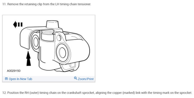

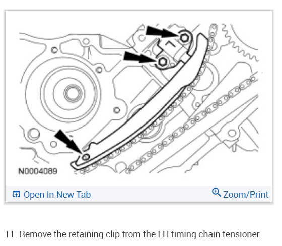

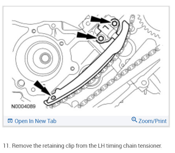

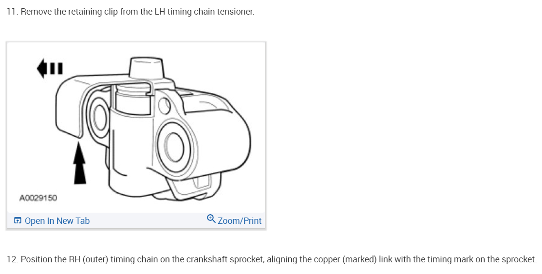

Position the LH timing chain tensioner arm on the dowel pin and install the LH timing chain tensioner.
Remove the retaining clip from the LH timing chain tensioner.
Fig. 293: Removing Retaining Clip From LH Timing Chain Tensioner

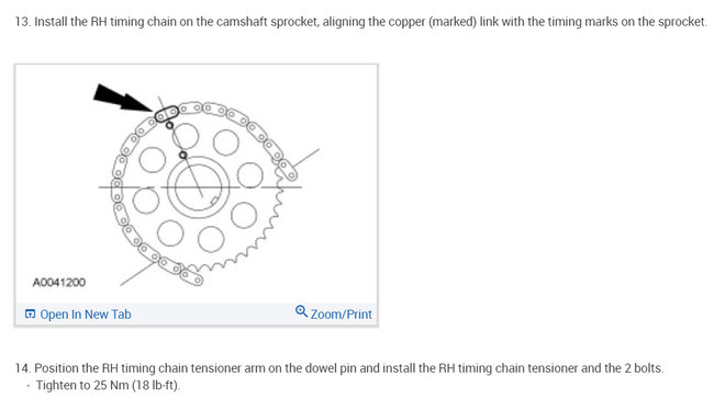

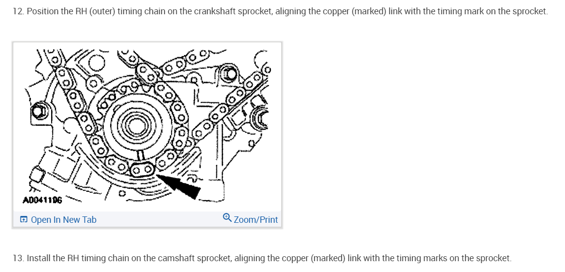

Position the lower end of the RH (outer) timing chain on the crankshaft sprocket, aligning the timing mark on the sprocket with the single copper (marked) link on the timing chain.
NOTE:If necessary, use the Camshaft Positioning Tool to adjust the camshaft sprocket slightly to obtain timing mark alignment.
Fig. 295: Identifying Position Of Camshaft Sprocket Timing Mark
Position the RH timing chain on the camshaft sprocket. Make sure the camshaft sprocket timing mark is positioned between the two copper (marked) chain links.

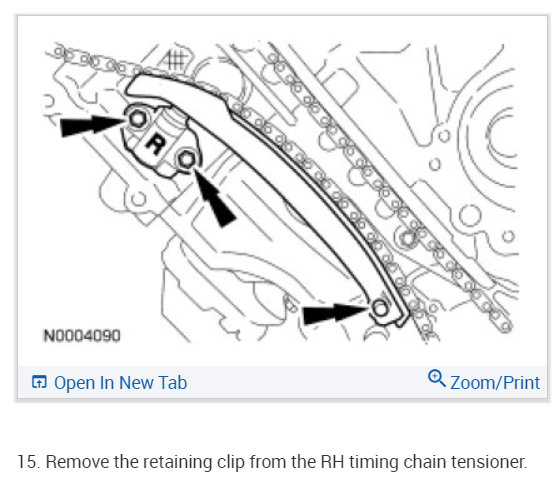

Position the RH timing chain tensioner arm on the dowel pin and install the RH timing chain tensioner.
Fig. 296: Identifying Tightening Torque Of RH Timing Chain Tensioner Bolts
Remove the retaining clip from the RH timing chain tensioner.
Fig. 297: Removing Retaining Clip From RH Timing Chain Tensioner

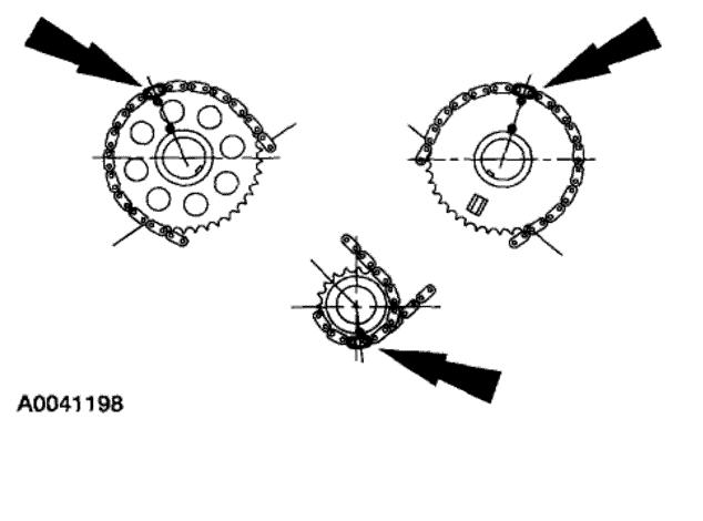

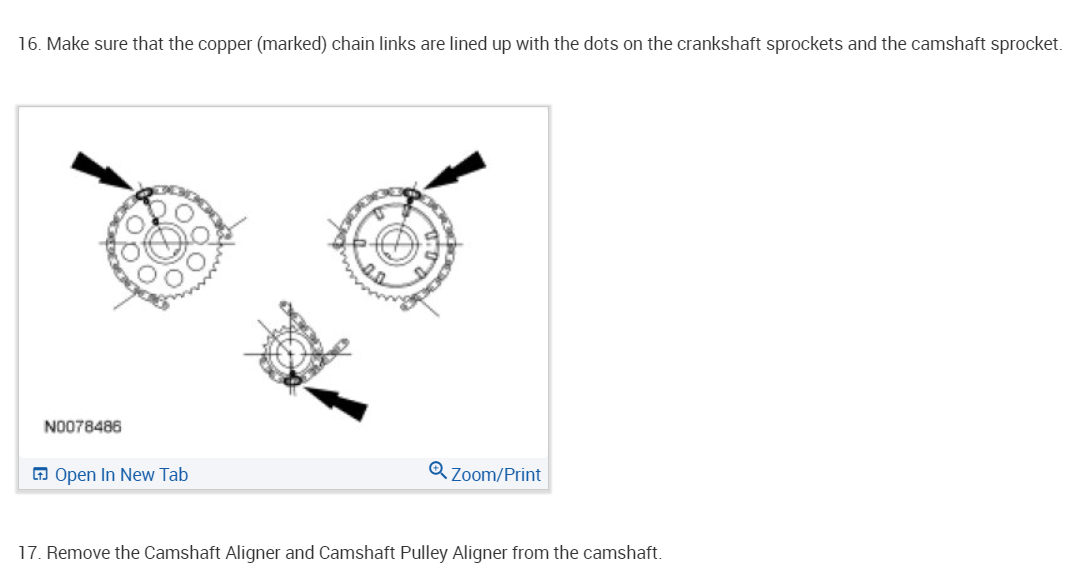

As a post-check, verify correct alignment of all timing marks.
Fig. 298: Verifying Correct Alignment Of Timing Marks

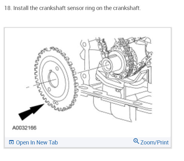

Position the crankshaft sensor ring on the crankshaft.
Fig. 300: Positioning Crankshaft Sensor Ring On Crankshaft
