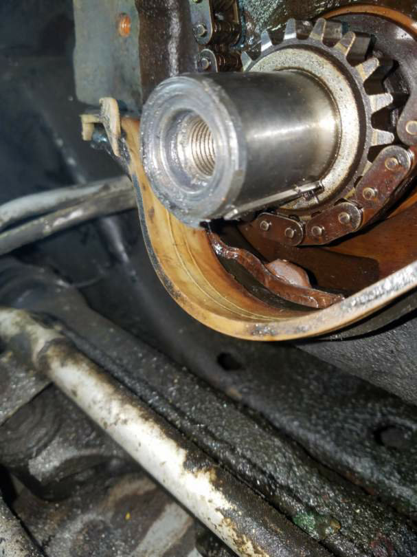

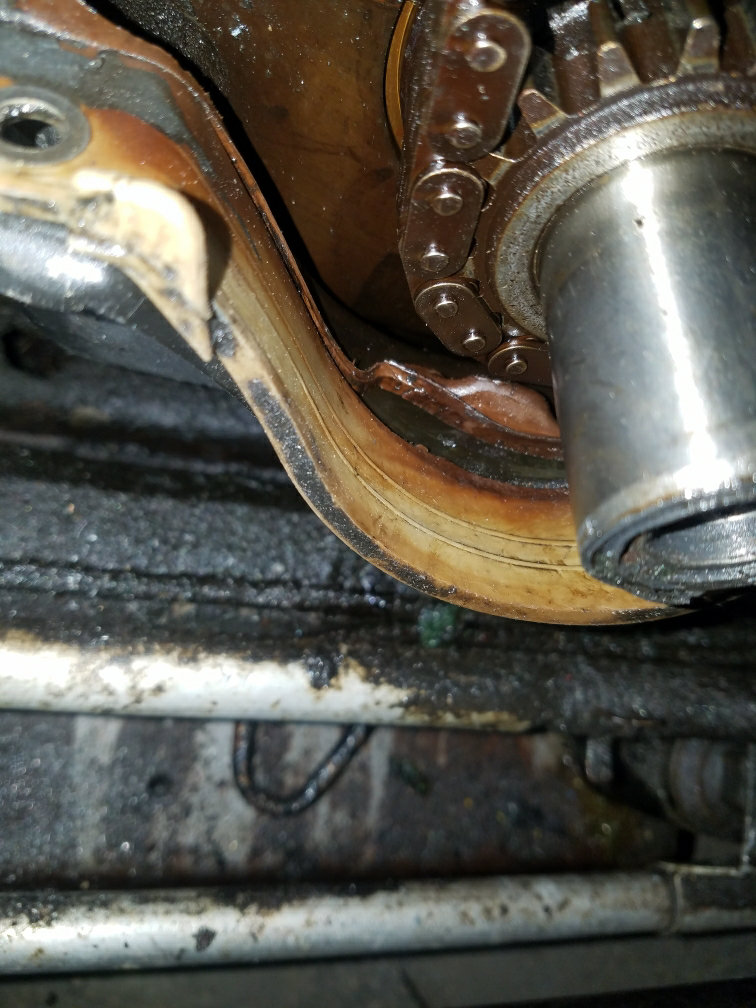

For most of these applications, the manufacturers are using only sealants out of a tube now, with no cardboard or cork gaskets. Some of us still like the old cardboard gaskets, but when I use them, I still put a light coating of sealant on both sides. That insures a good seal if there are scratches in the sealing surfaces that got overlooked, and it makes removing them a lot easier next time.
Regardless of what you use, the first thing to watch out for is a little old gasket material left that doesn't get cleaned off. That can prevent the parts from sitting squarely against each other. This is where the sealants do a good job where the paper gaskets won't seal well.
