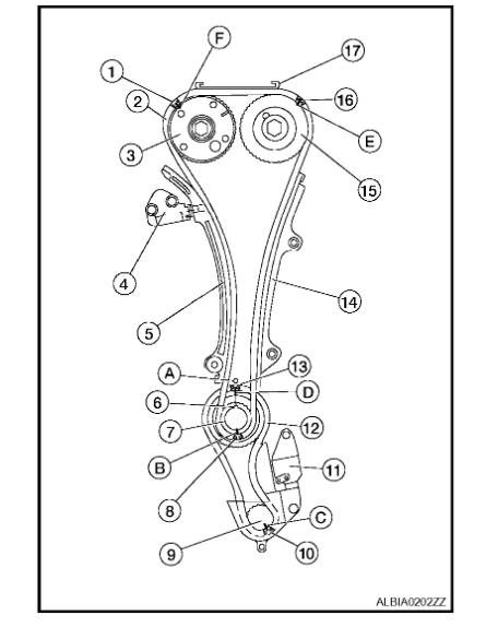

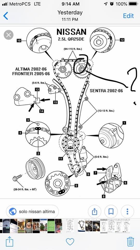

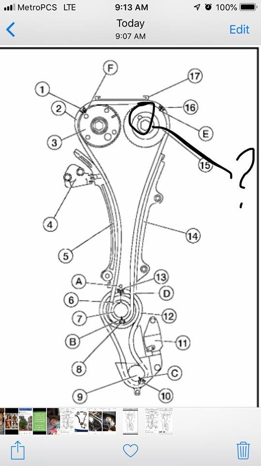

I attached the timing chain alignment marks for the new chain. The new chain must have the colored links for aligning it correctly.
https://www.2carpros.com/articles/serpentine-belt-timing-belt-timing-chain-diagrams
The reason it will not start is the crank/cam correlation is not correct.

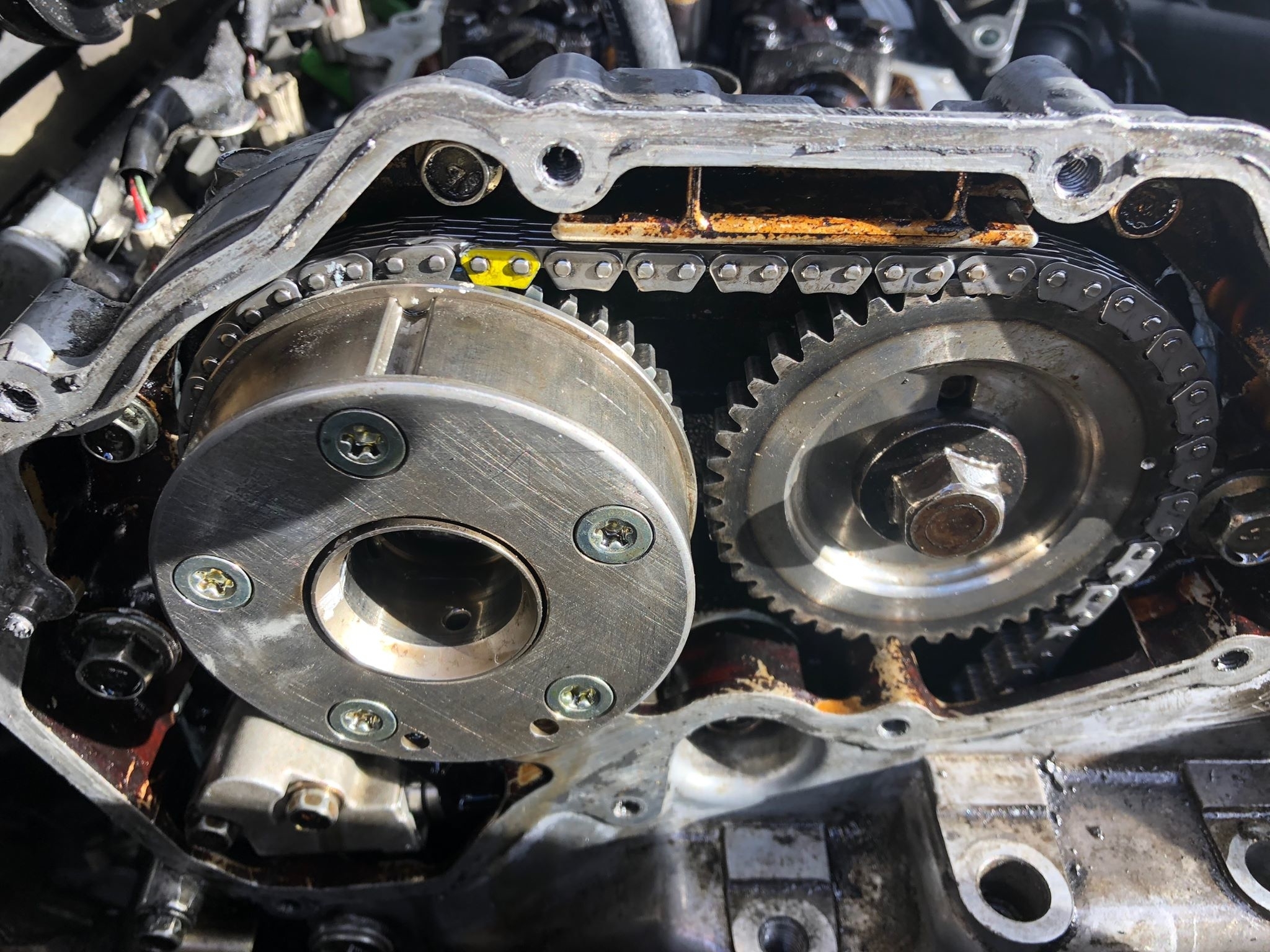

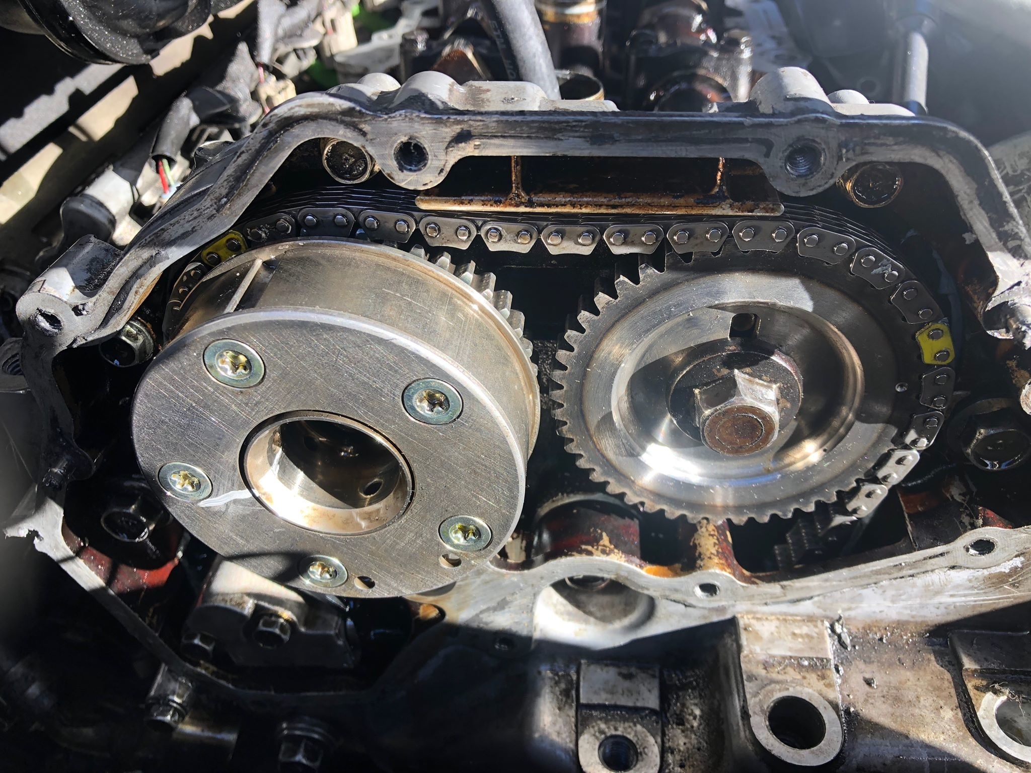

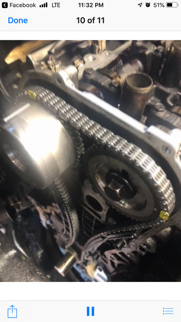

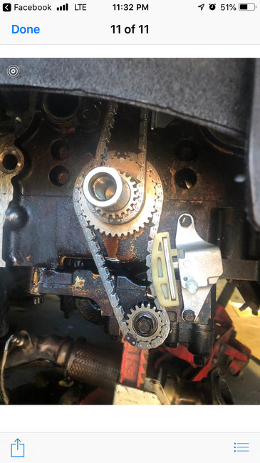

Looking at the diagram you sent me, do you think the marks (points) will be exactly like that? Look at my pictures i think the bottom mark won't be in place.

The bottom picture is at an angle and I cannot tell if the marks are correct. can you get a different picture?

Just wondering if the mark of the oil pump is one teeth out of timing will the car start. I think i do have the oil pump chain on wrong.
Dec 14, 2018 at 8:40 AM
EDELMIRO CASTILLO
  • 11 POSTS
because the chain has 17 chain on one side and 18 on the other.
Dec 14, 2018 at 8:44 AM
the oil pump chain will not effect starting at all. it is just for running the oil pump. it also acts as a balance for the chains as well.

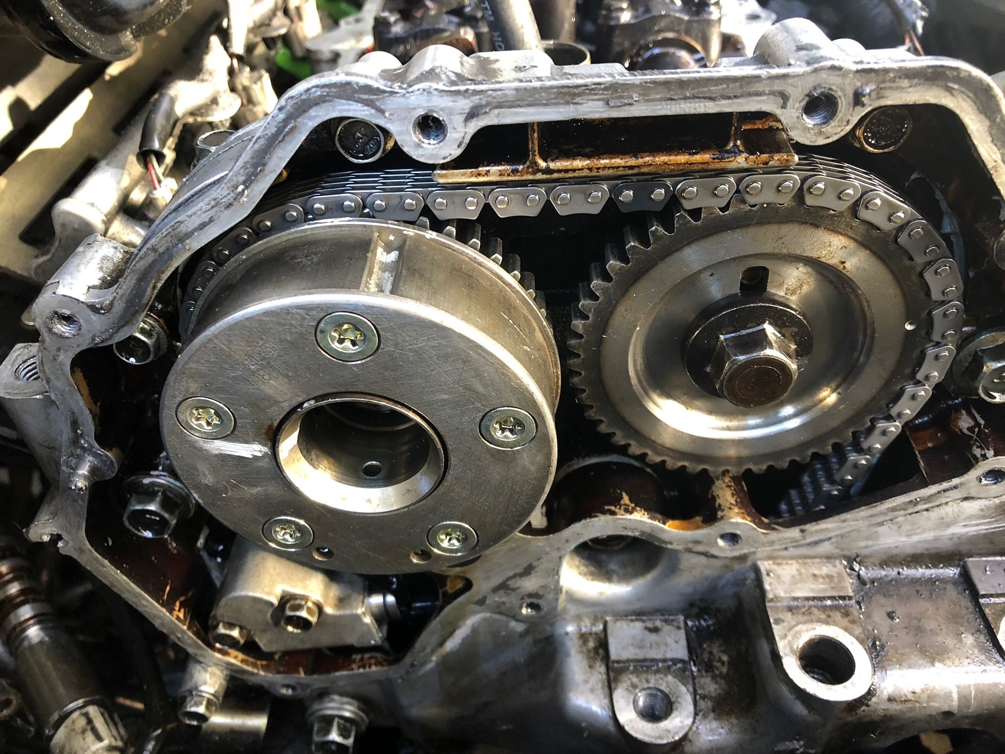

The first picture is the diagram you sent me, second is the one i was following to put it on timing. Can you notice the cut is different from one to the other. Sorry for so many questions. Just really cannot find anything on the internet/YouTube for a 2007 Nissan Altima. Seems that everything cuts off at 2006.
Dec 14, 2018 at 9:28 AM
the right side cam, the key way look to be straight up but make sure the chain link is in the correct location.

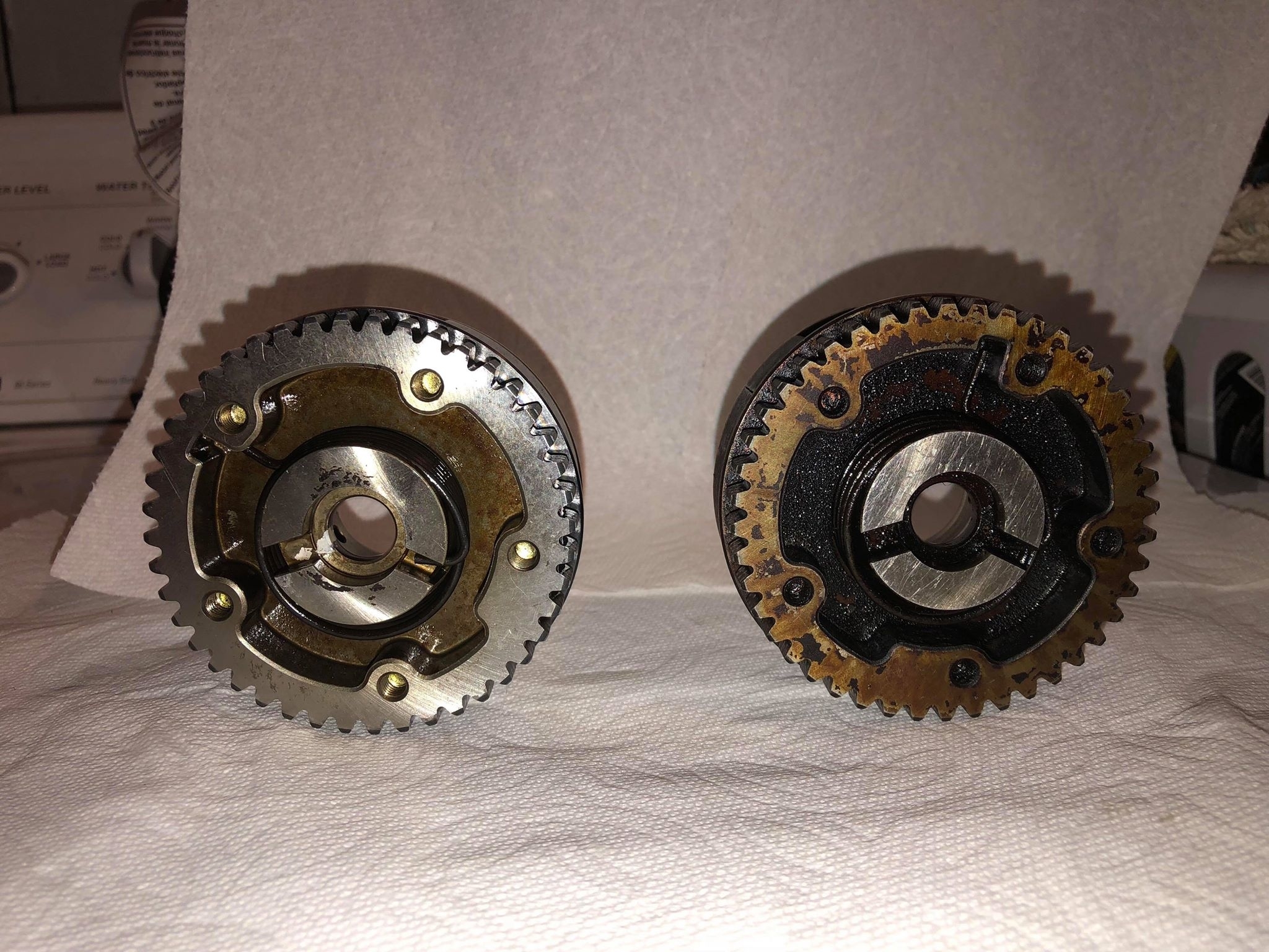

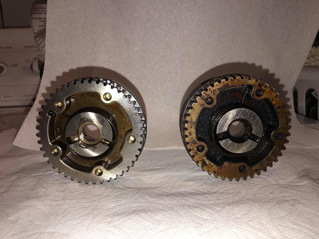

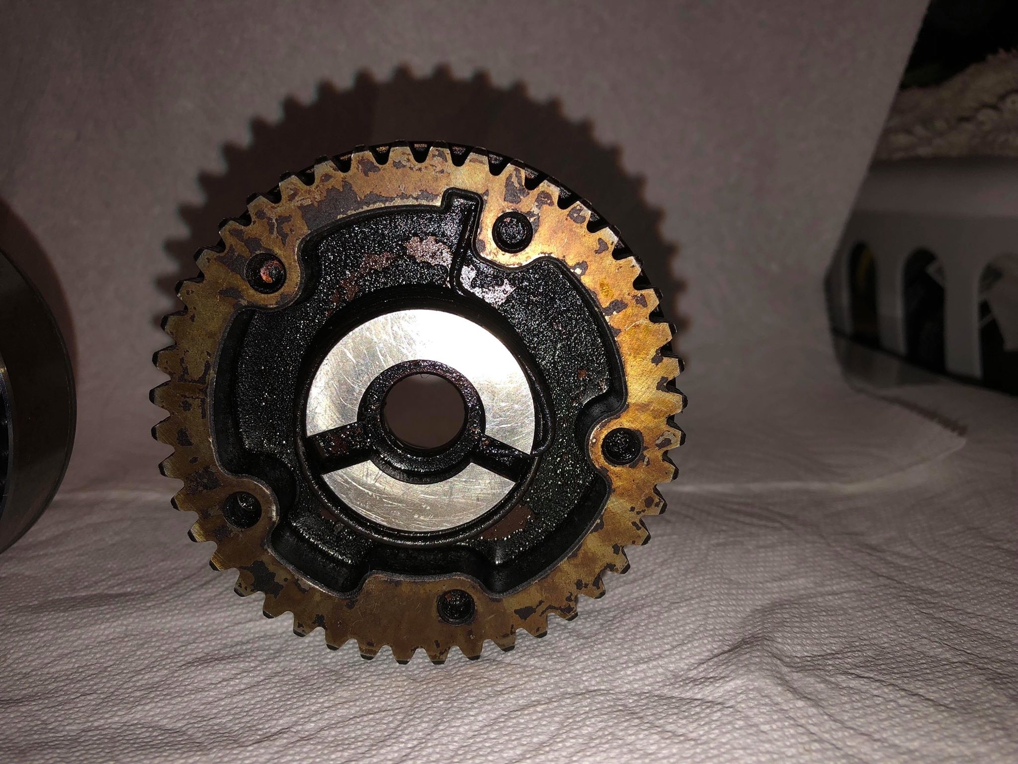

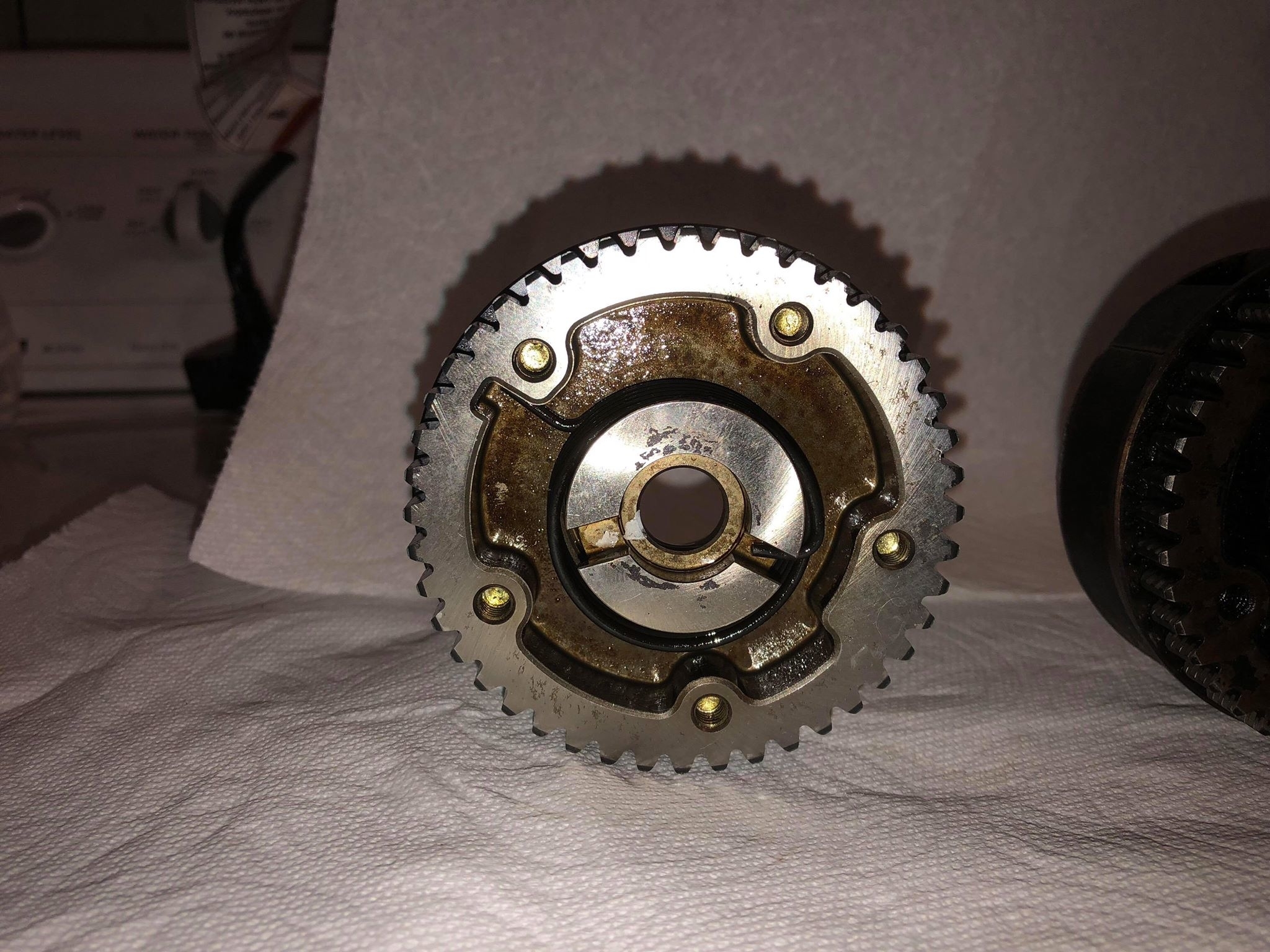

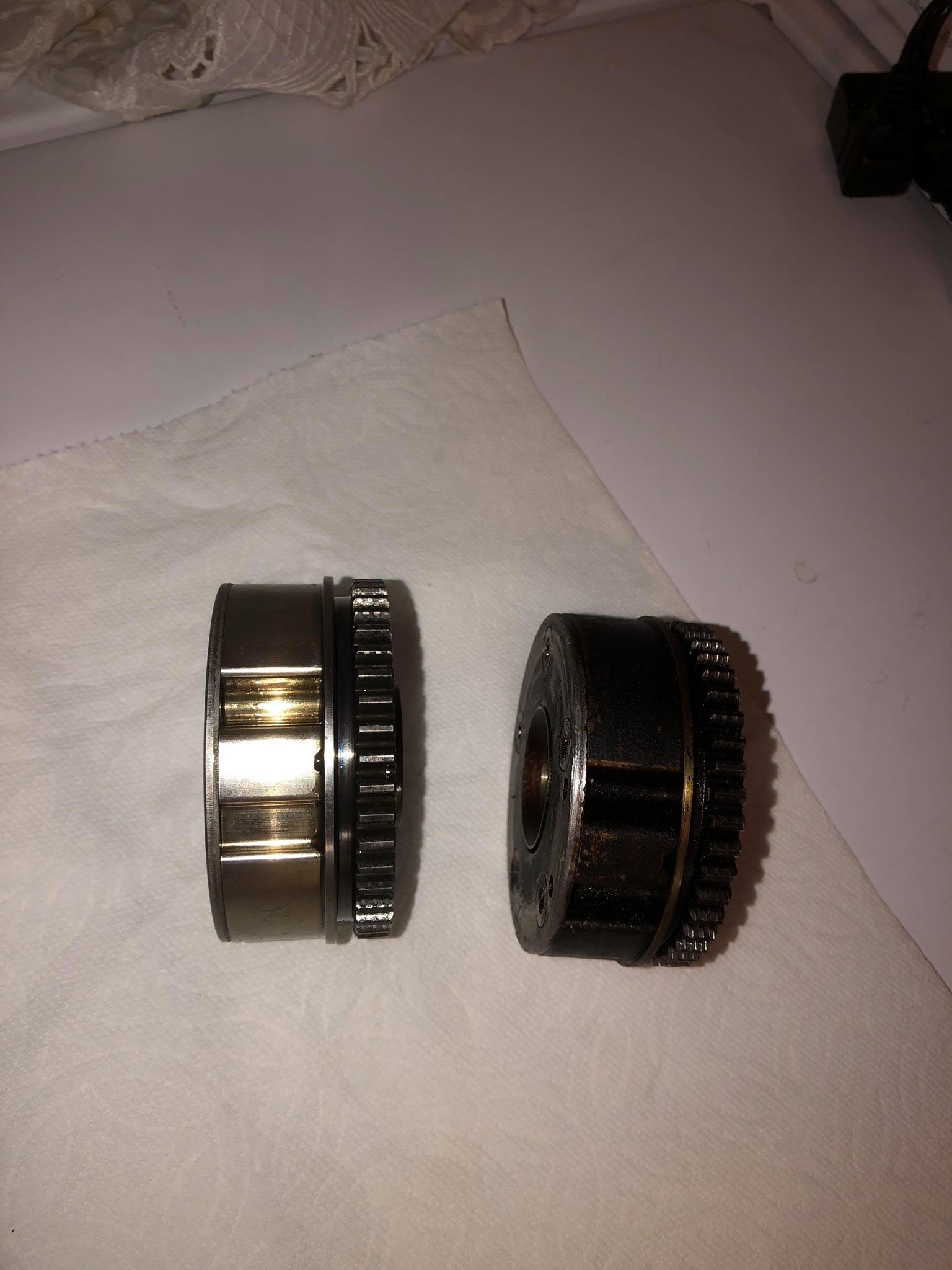

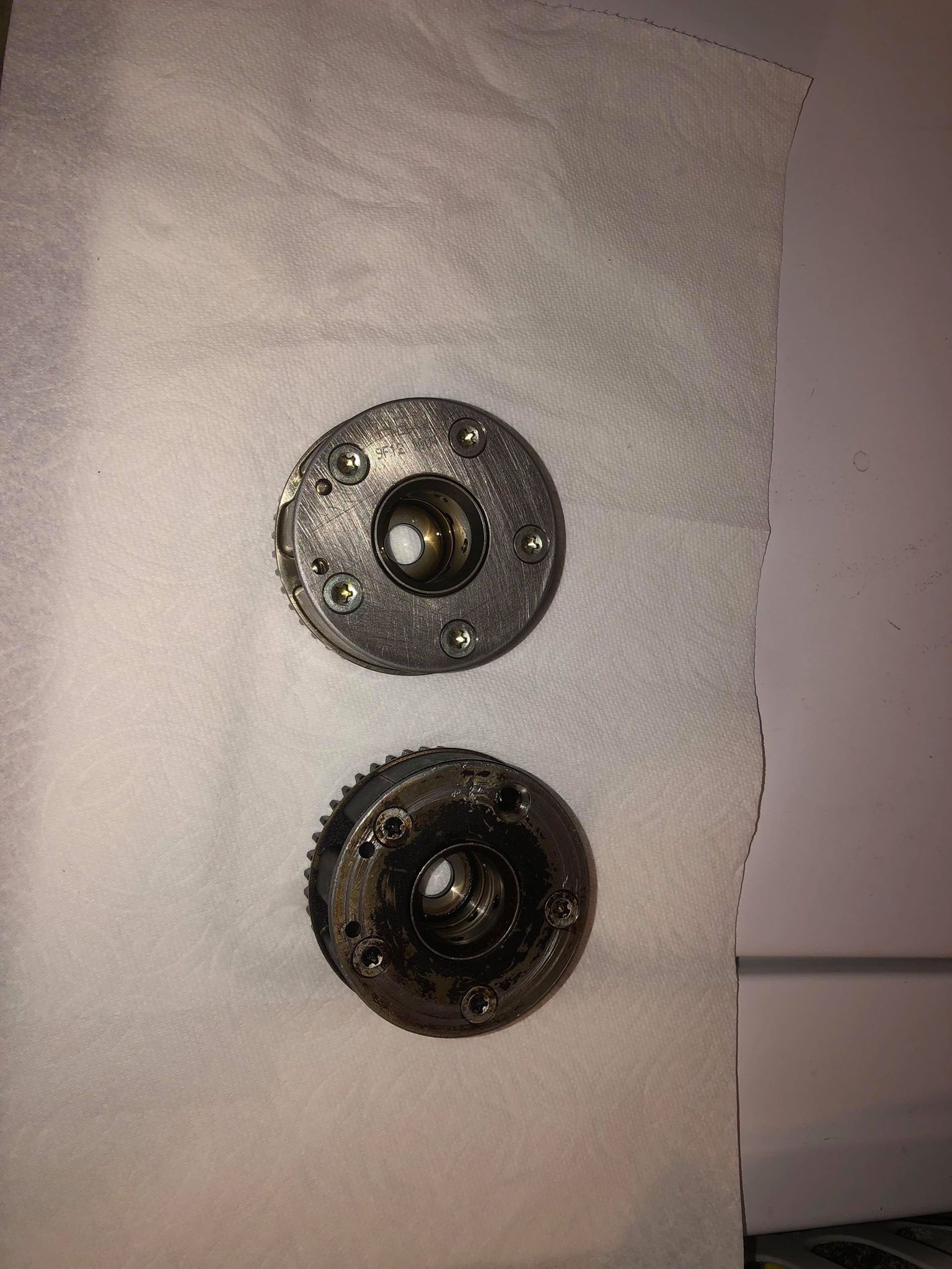

Do you think because i change the VV-T thats why the car isn't starting. The original one is the dirty one and missing screw. Thanks for your help

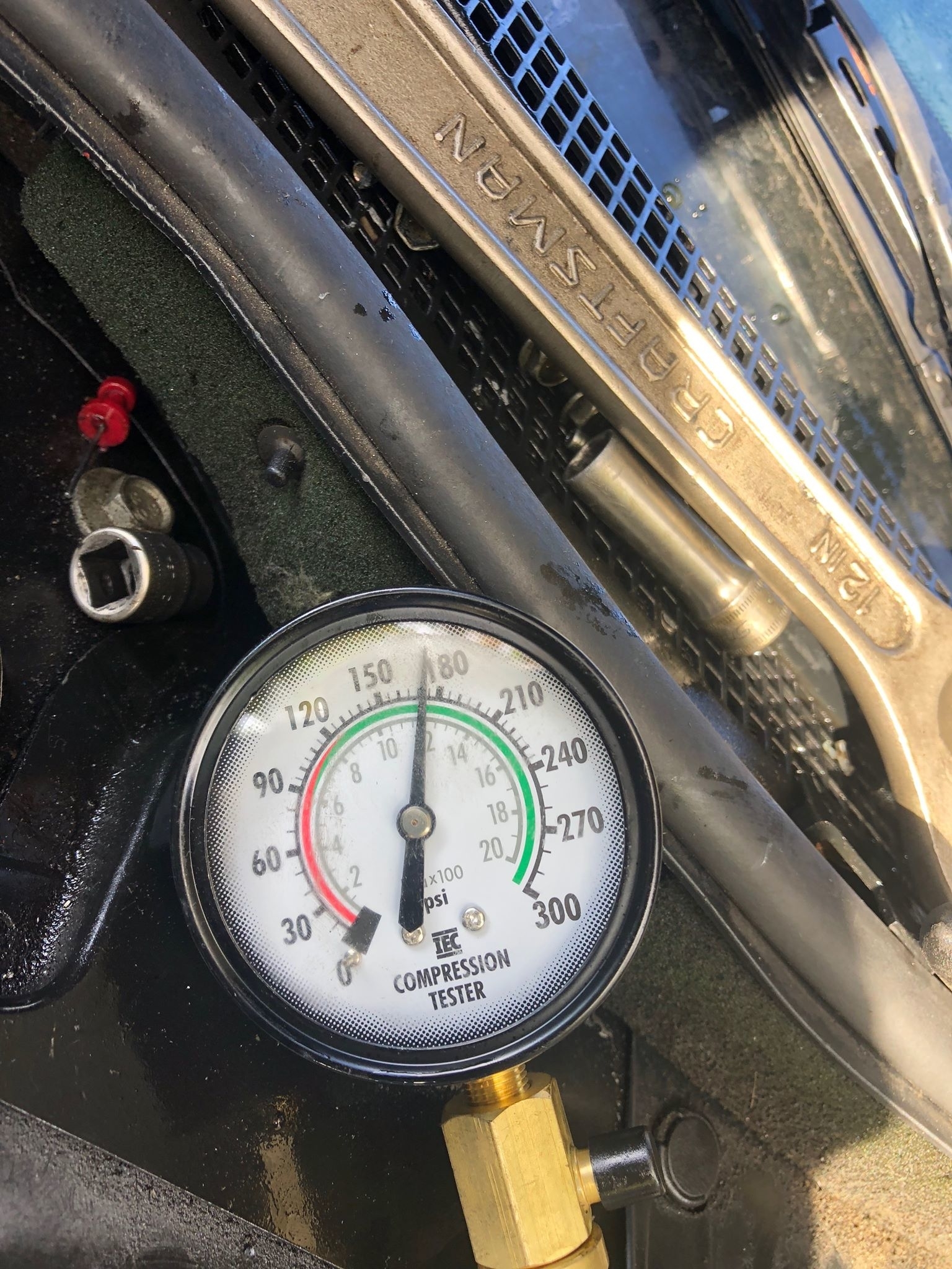

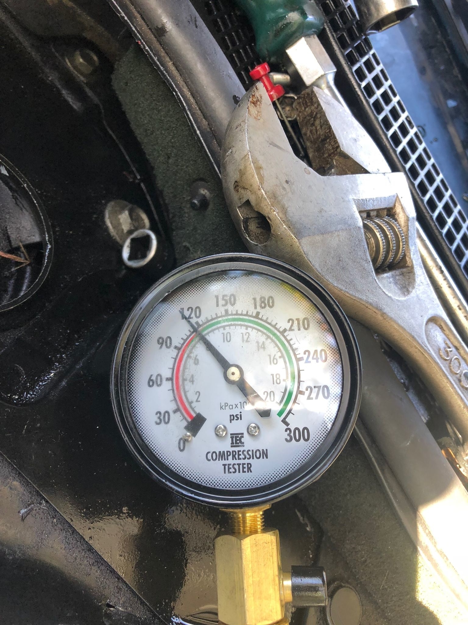

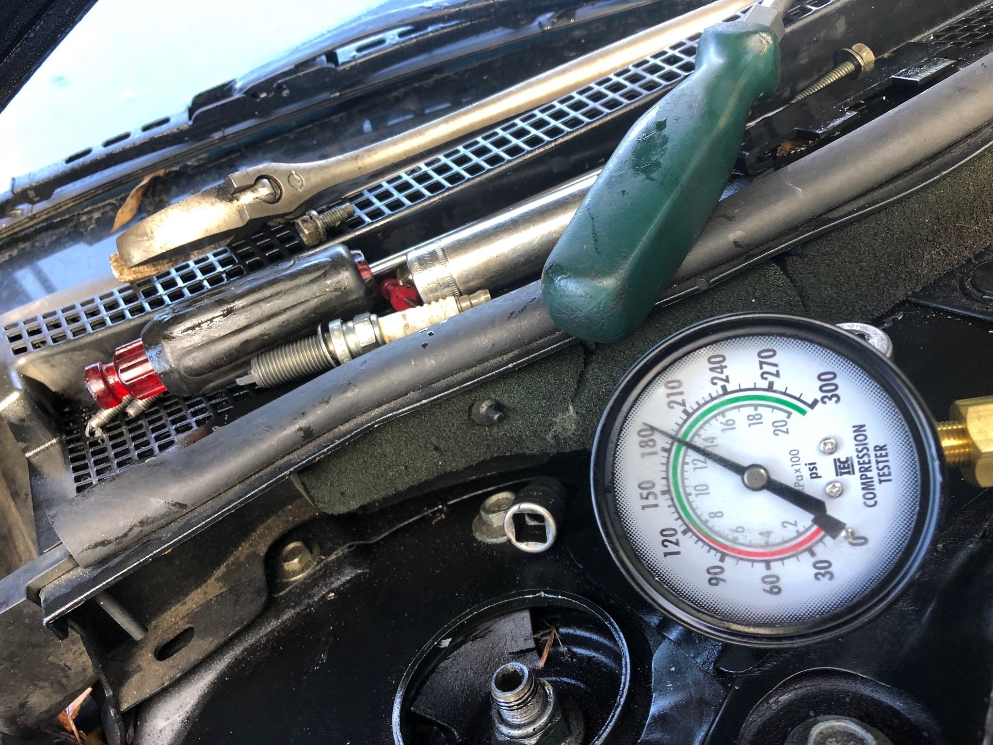

Do you know how much compression it should have? Because the spark plugs are black. Thank you
Dec 21, 2018 at 8:24 AM
At least 140 to 160.
Dec 21, 2018 at 10:41 AM

I am not guiding myself with the points since i lost the marks. What i do is put the piston on the top and this is the compression it has, but car doesn't have spark in the coils.
Dec 26, 2018 at 8:43 PM

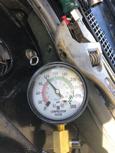

In this position I moved 1 teeth and it gave me that compression. Car still doesn't have spark in the coils.
Dec 26, 2018 at 8:50 PM

In this position I moved 2 teeth and it gave me this compression and still car doesn't have spark in the coils. Which position should i leave it on, even though it doesn't have spark?
Thank you

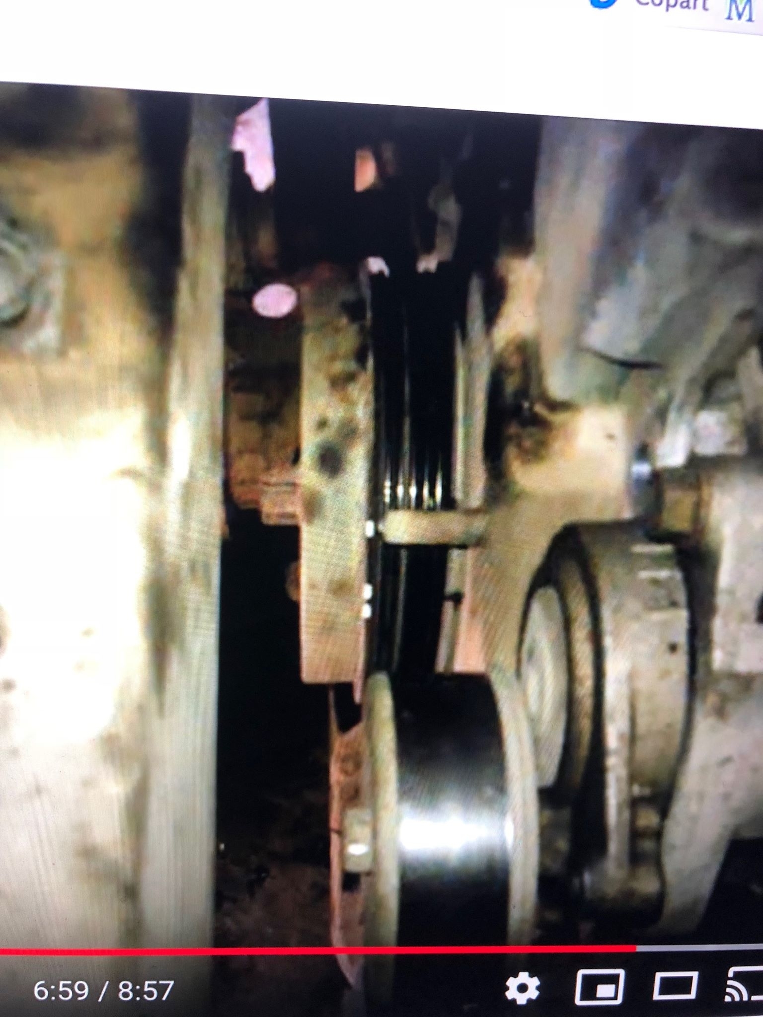

This is how i put the pulley with the mark when the piston is up.
Dec 26, 2018 at 9:56 PM
Sorry, away for a while.
You need to set the chain exactly as the diagram shows. you moving the chain around can result in bending of valves.
