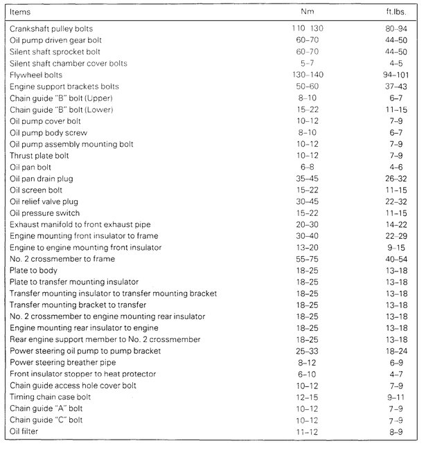

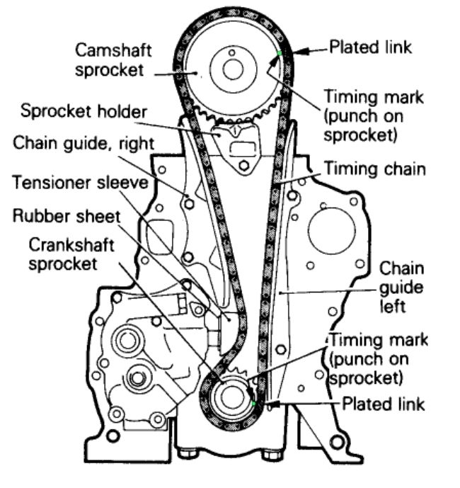

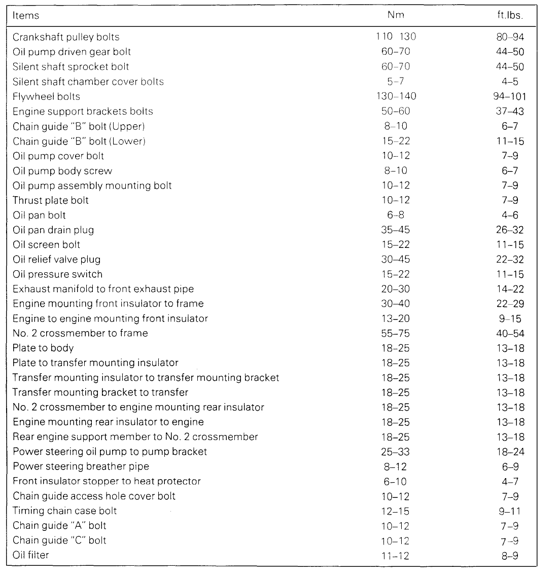

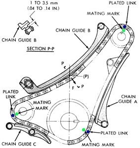

I am replacing timing chain need to know how to set timing where to match marks. diagrams show one link directly across from mark on sprocket, bottom mark looks like it is two notches away not directly across. And I need torch specs on valve cover, oil pan , harmonic balancer. A good diagram would be nice . I keep looking but I get taken to Camero and Jeep V-6's. All but mine. Thank you.
