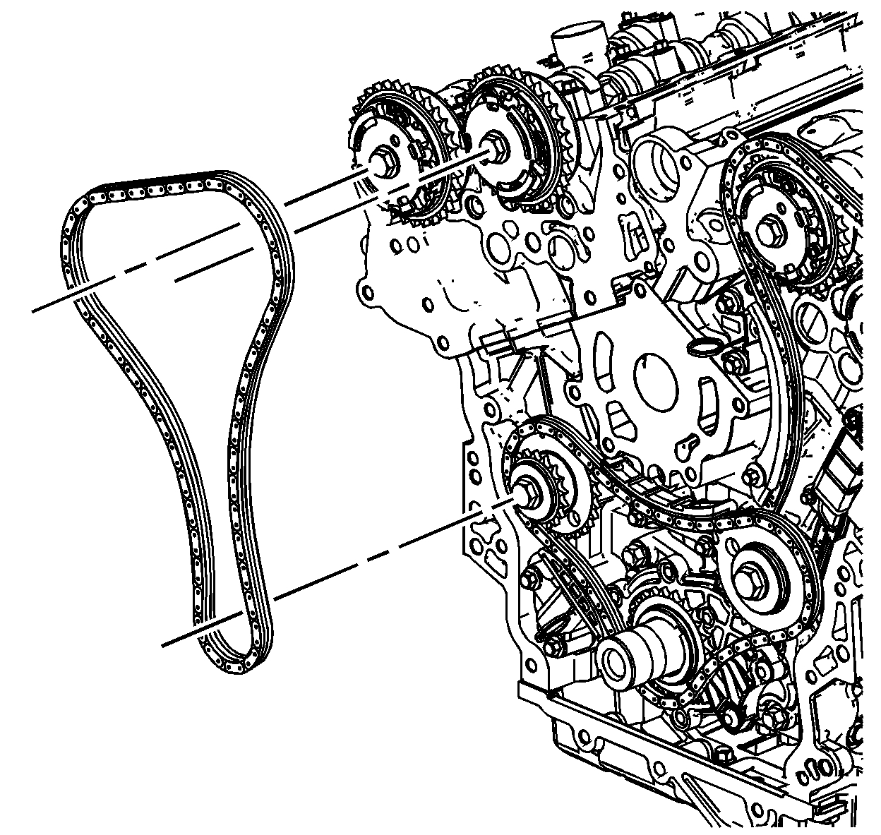

I was trying to replace right bank timing chain and the camshafts jumped
2013 CHEVROLET TRAVERSE
92,000 MILES
MDINSKEEP59
Replaced head gaskets and first two timing chains. While attempting to replace right bank timing chain, the camshafts jumped. Not sure what to do next. Never had this problem before.
Jun 9, 2020 at 5:10 PM
The only thing that can be done is to do it over. Here are the directions specific to the secondary timing chains. The pictures attached correlate with the directions. I am going to provide the directions for all three. You can pick and choose what you need.

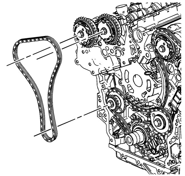

9. Remove the primary camshaft timing chain. Refer to Secondary Camshaft Intermediate Drive Chain Removal - Right Side See: Engine > Overhaul > Secondary Camshaft Intermediate Drive Chain Removal - Right Side.

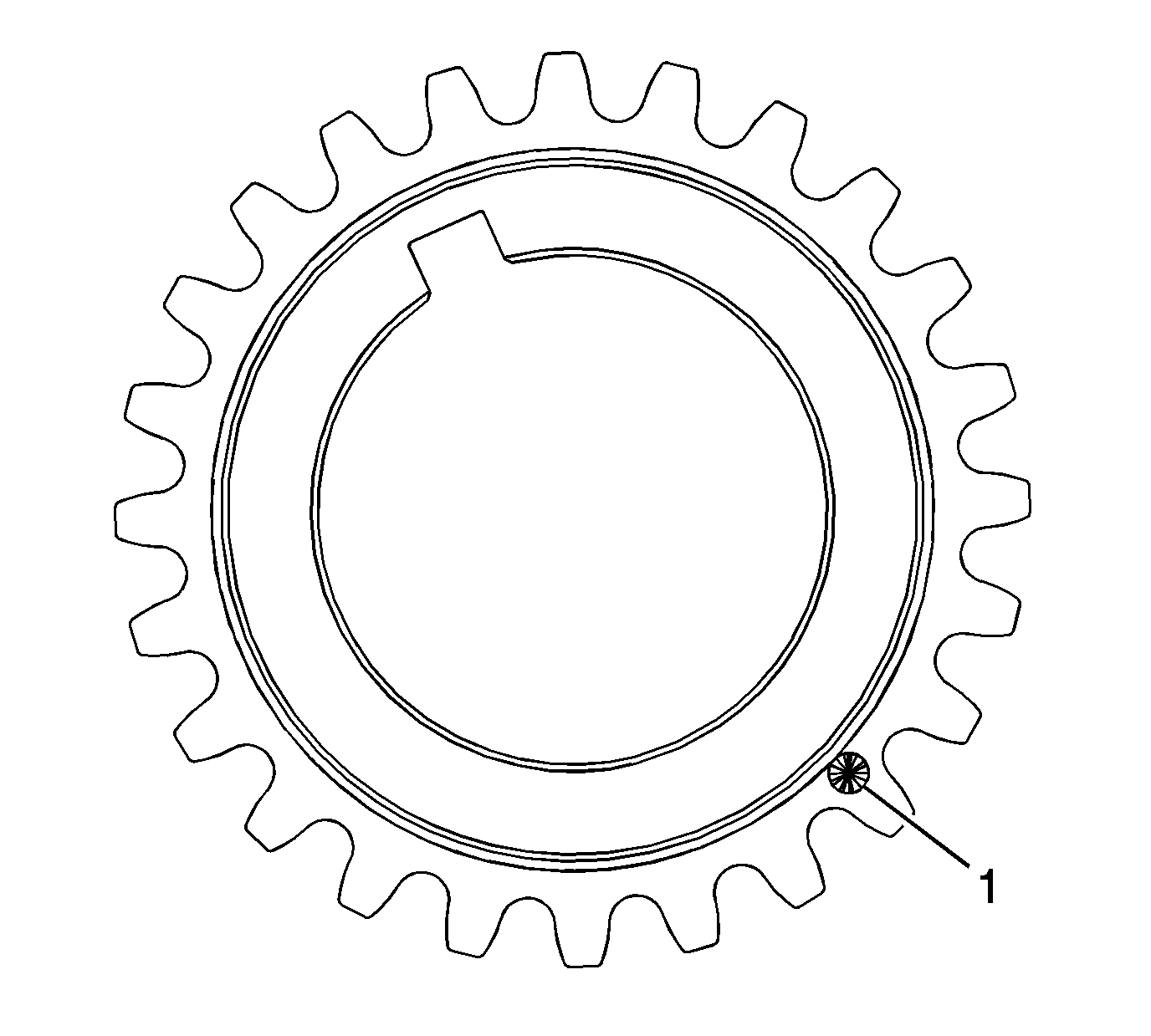

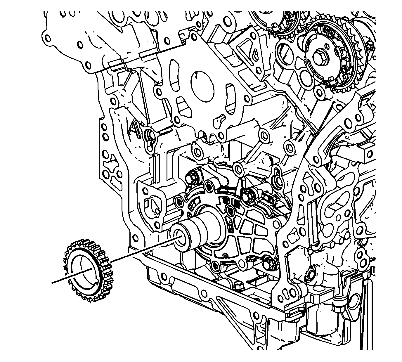

1. Ensure the crankshaft sprocket is installed with the timing mark (1) visible.

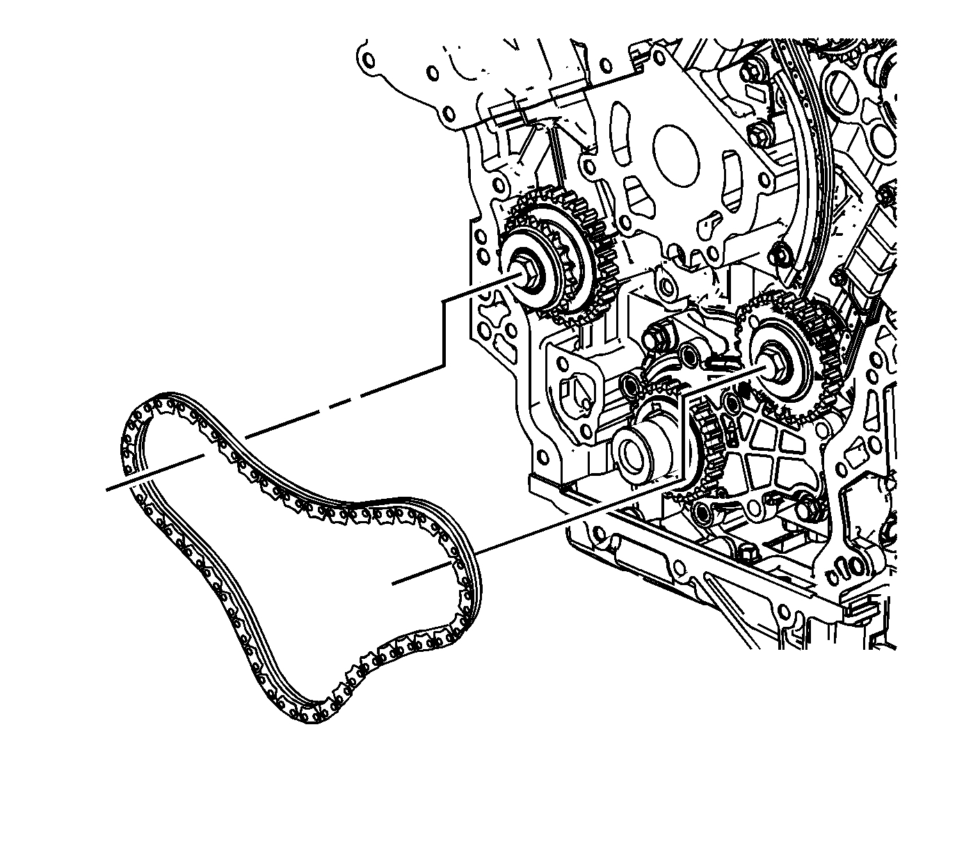

2. Install the crankshaft sprocket on to the nose of the crankshaft.
3. Align the notch in the crankshaft sprocket with the pin in the crankshaft.
4. Slide the crankshaft sprocket on the crankshaft nose until the crankshaft sprocket contacts the step in the crankshaft.

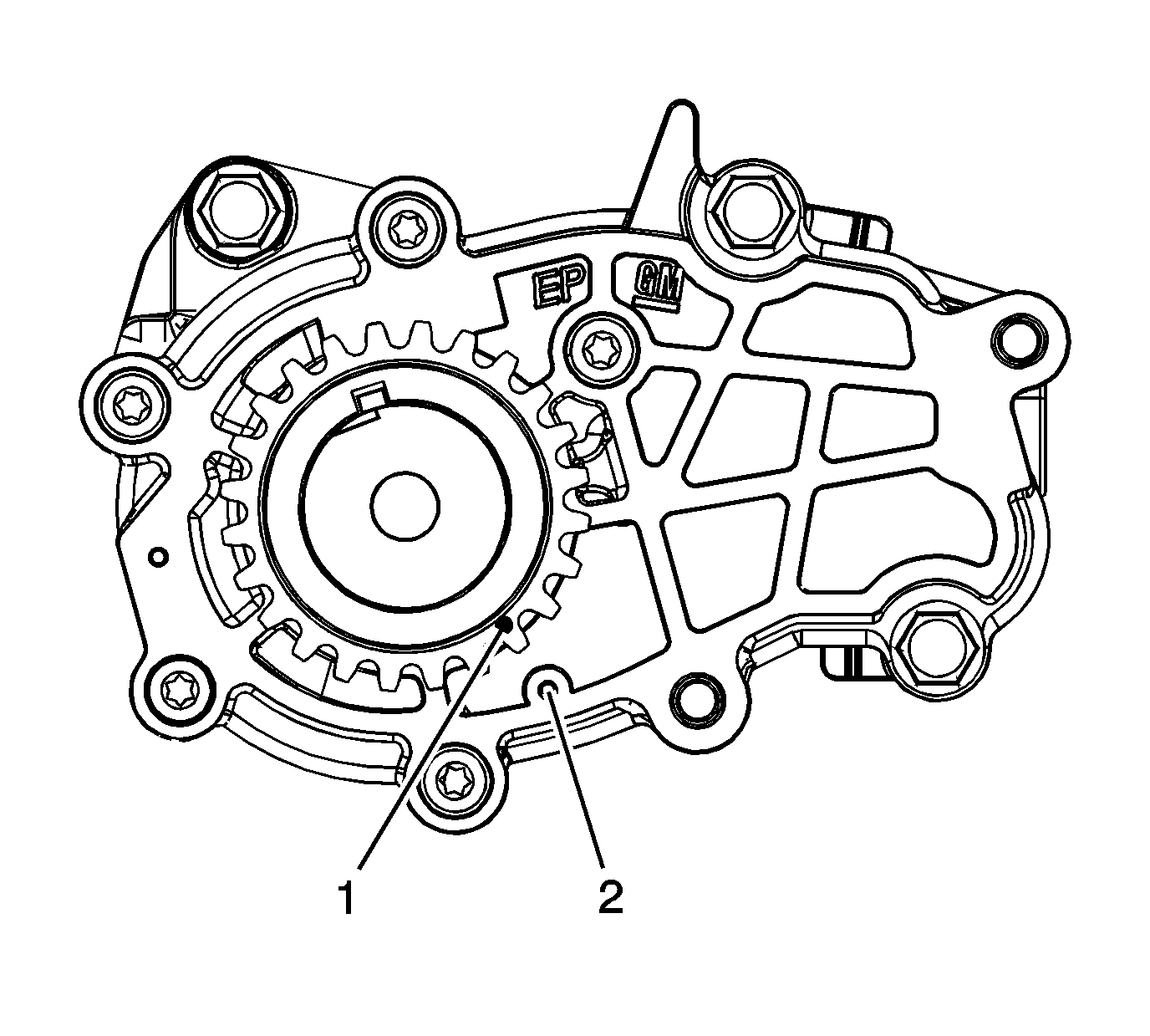

5. Ensure the crankshaft is in the stage one timing position with the crankshaft sprocket timing mark (1) aligned to the stage one timing mark on the oil pump cover (2) using the EN 46111 - crankshaft rotation socket. Refer to Timing Chain Alignment Diagram See: Timing Component Alignment Marks > Components > Timing Chain Alignment Diagram - Stage One.

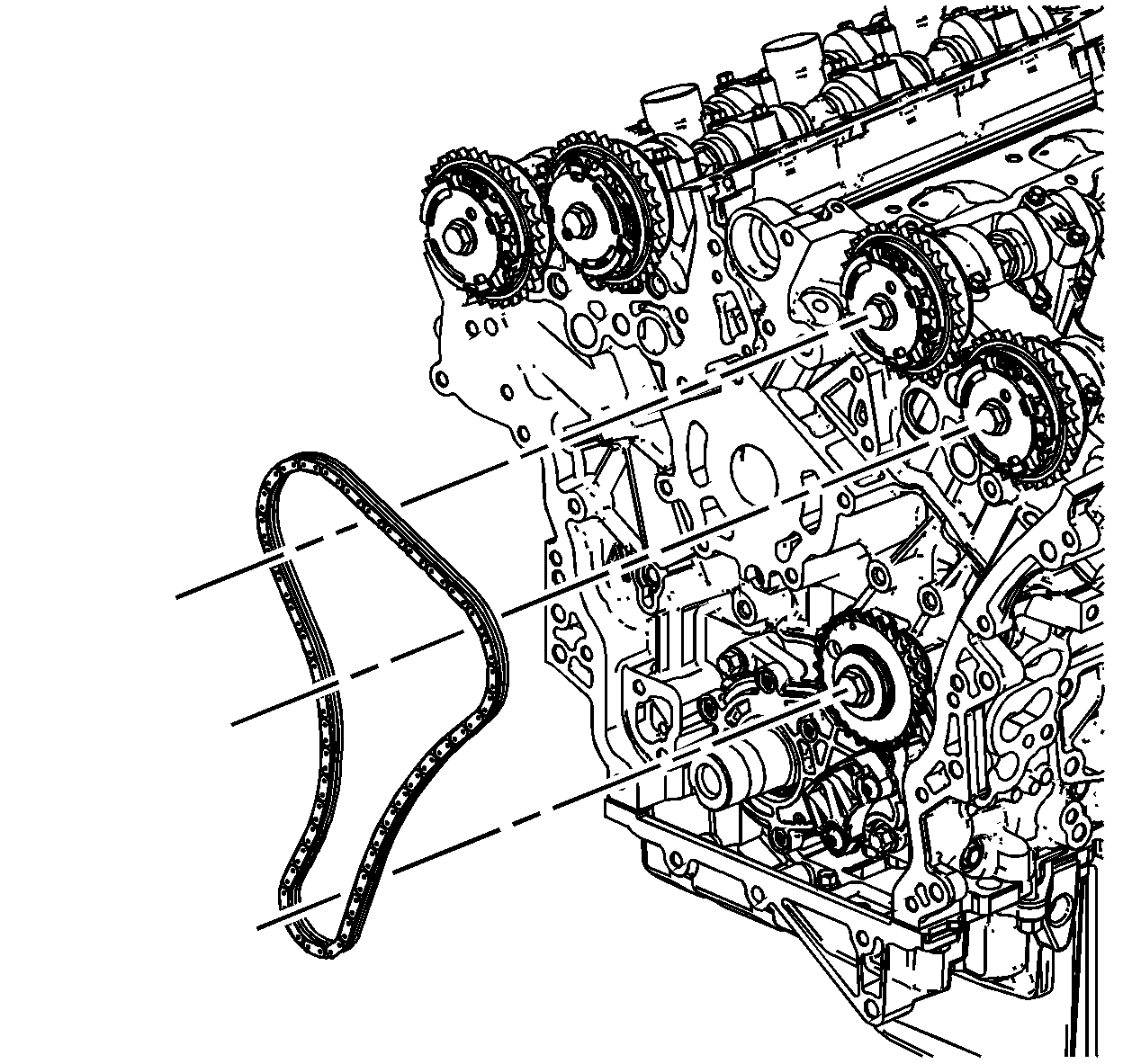

6. Install the primary camshaft timing chain. Refer to Primary Camshaft Intermediate Drive Chain Installation See: Engine > Overhaul > Primary Camshaft Intermediate Drive Chain Installation.

pic 7
14. Remove the left bank secondary camshaft drive chain. Refer to Secondary Camshaft Intermediate Drive Chain Removal - Left Side See: Engine > Overhaul > Secondary Camshaft Intermediate Drive Chain Removal - Left Side.
15. Clean and inspect all of the camshaft timing drive components. Refer to Camshaft Timing Drive Components Cleaning and Inspection See: Engine > Overhaul > Camshaft Timing Drive Components Cleaning and Inspection. Replace components as necessary.

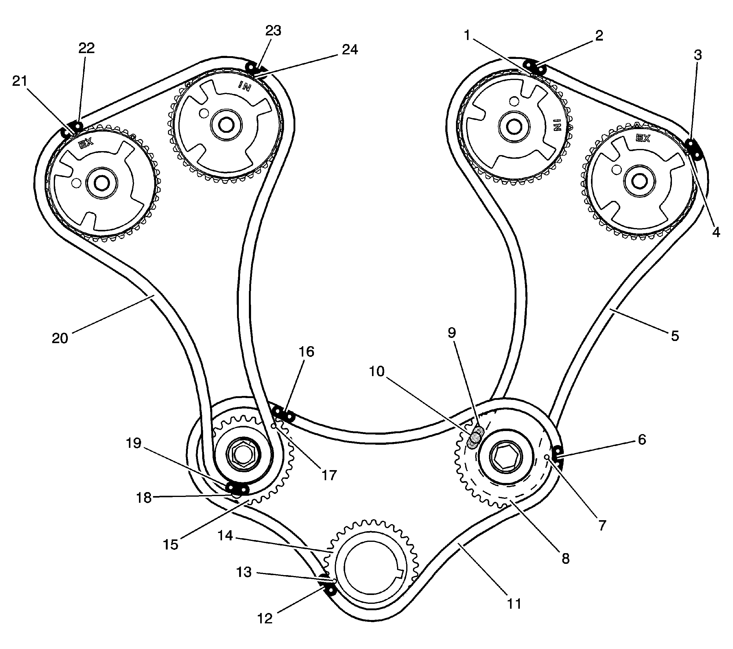

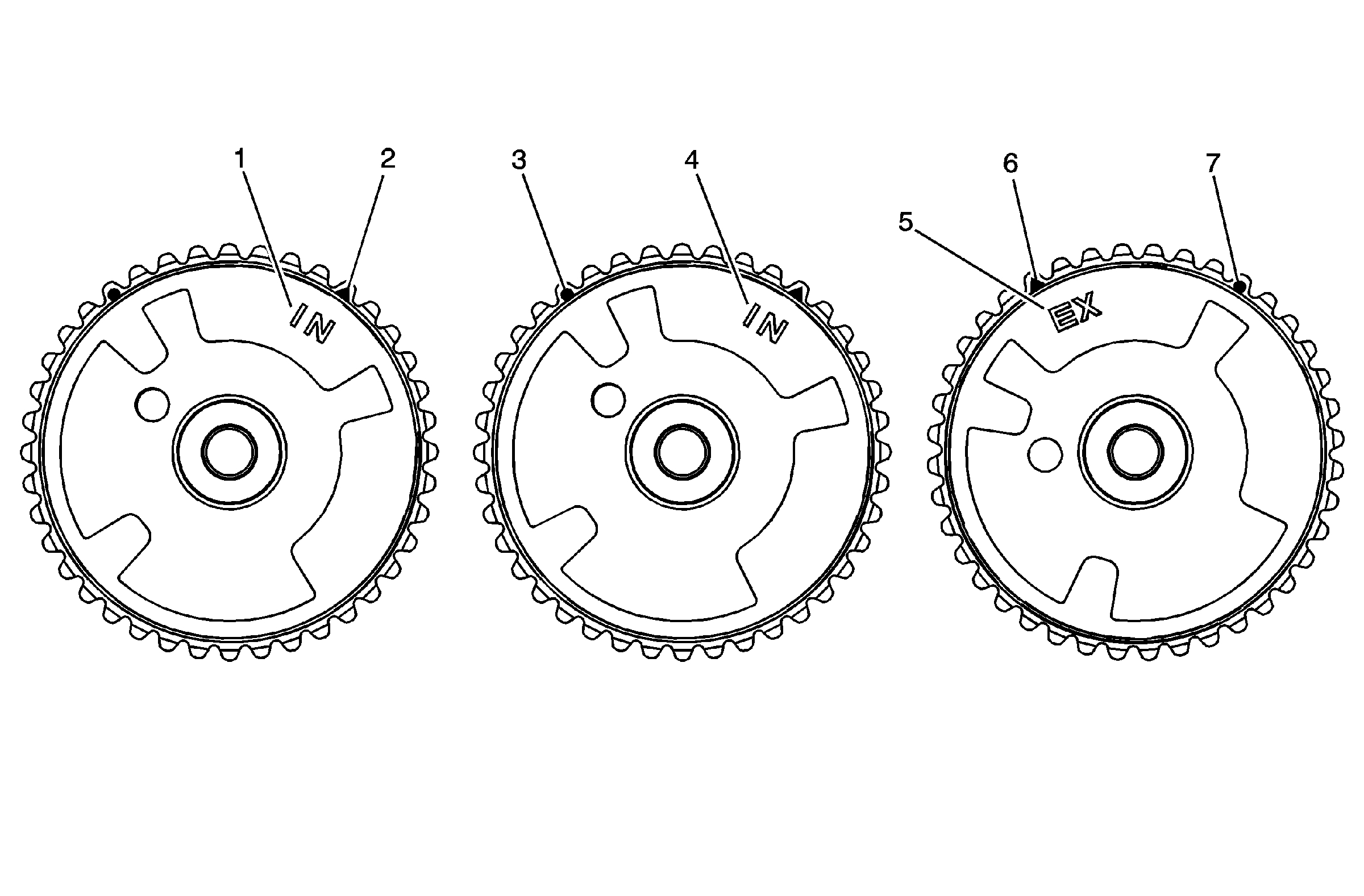

Camshaft Position Actuator Timing Marks
pic 11
1 - Right Intake Camshaft Position Actuator Identifier
2 - Right Intake Camshaft Position Actuator Right Side Timing Mark- Triangle
3 - Left Intake Camshaft Position Actuator Left Side Timing Mark- Circle
4 - Left Intake Camshaft Position Actuator Identifier
5 - Exhaust Camshaft Position Actuator Identifier
6 - Exhaust Camshaft Position Actuator Right Side Timing Mark- Triangle
7 - Exhaust Camshaft Position Actuator Left Side Timing Mark- Circle
Stage One
pic 12
1 - Left Intake Camshaft Position (CMP) Actuator Timing Mark- Circle
2 - Left Intake Secondary Camshaft Timing Drive Chain Timing Link
3 - Left Exhaust Secondary Camshaft Timing Drive Chain Timing Link
4 - Left Exhaust Camshaft Position (CMP) Actuator Timing Mark- Circle
5 - Left Secondary Camshaft Timing Drive Chain
6 - Primary Camshaft Drive Chain Timing Link for the Left Primary Camshaft Intermediate Drive Chain Sprocket
7 - Left Primary Camshaft Intermediate Drive Chain Sprocket Timing Mark for the Primary Camshaft Drive Chain
8 - Left Primary Camshaft Intermediate Drive Chain Sprocket
9 - Left Secondary Camshaft Timing Drive Chain Timing Link for the Left Primary Camshaft Intermediate Drive Chain Sprocket, behind hole in sprocket
10 - Left Primary Camshaft Intermediate Drive Chain Sprocket Timing Window for the Left Secondary Camshaft Timing Drive Chain Timing Link
11 - Primary Camshaft Drive Chain
12 - Primary Camshaft Drive Chain Timing Link for the Crankshaft Sprocket
13 - Crankshaft Sprocket Timing Mark
14 - Crankshaft Sprocket
15 - Right Primary Camshaft Intermediate Drive Chain Sprocket
16 - Primary Camshaft Drive Chain Timing Link for the Right Primary Camshaft Intermediate Drive Chain Sprocket
17 - Right Primary Camshaft Intermediate Drive Chain Sprocket Timing Mark

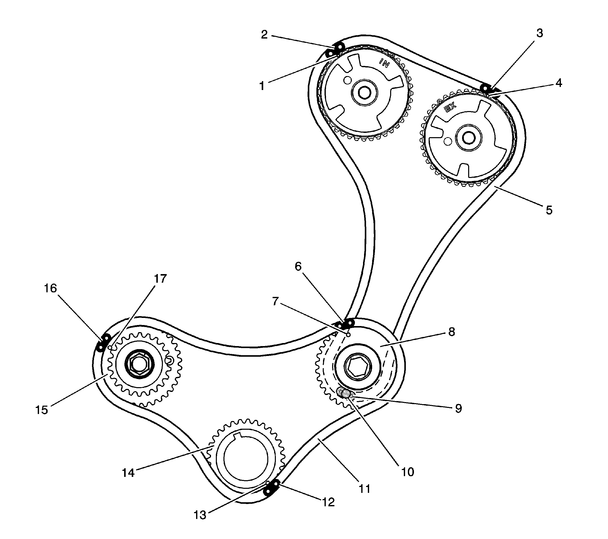

Stage Two
pic 13
17 - Right Primary Camshaft Intermediate Drive Chain Sprocket Timing Mark for the Primary Camshaft Drive Chain
18 - Right Primary Camshaft Intermediate Drive Chain Sprocket Timing Mark/Window for the Right Secondary Camshaft Timing Drive Chain
19 - Right Secondary Camshaft Timing Drive Chain Timing Link for the Right Primary Camshaft Intermediate Drive Chain Sprocket
20 - Right Secondary Camshaft Timing Drive Chain
21 - Right Exhaust Camshaft Position (CMP) Actuator Timing Mark- Triangle
22 - Right Exhaust Secondary Camshaft Timing Drive Chain Timing Link
23 - Right Intake Secondary Camshaft Timing Drive Chain Timing Link
24 - Right Intake Camshaft Position (CMP) Actuator Timing Mark- Triangle
______________________________________
Let me know if that helps or if you have other questions.
