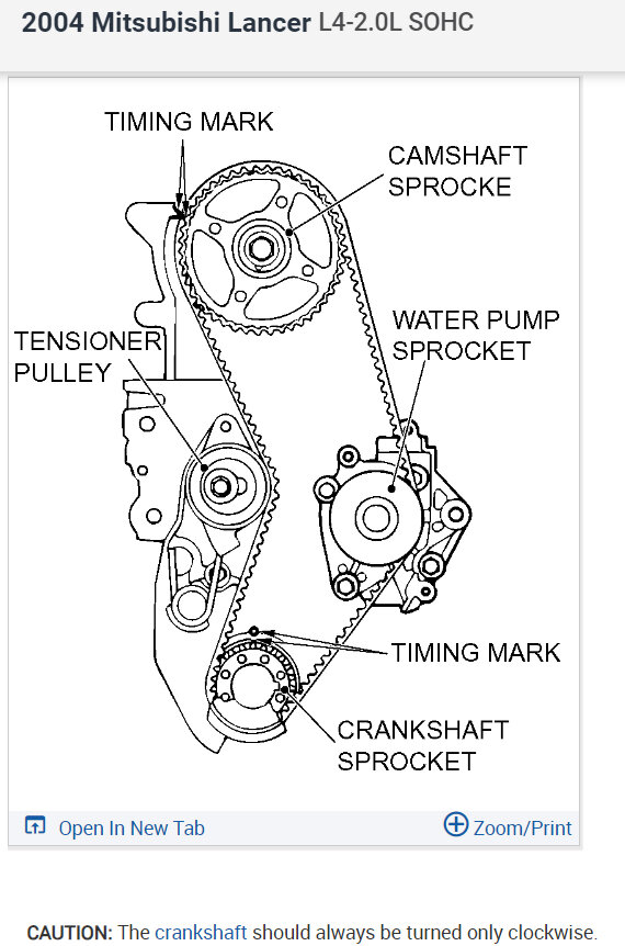

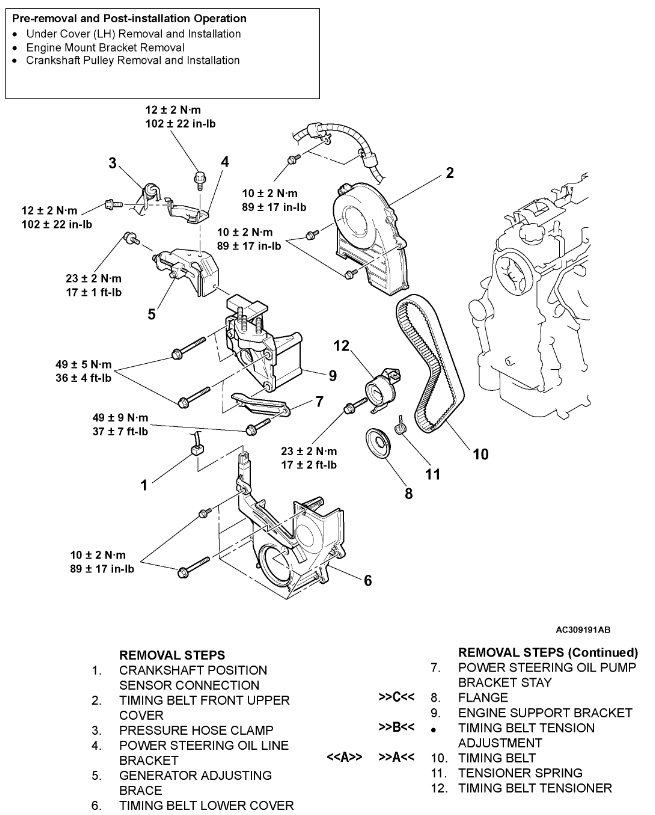

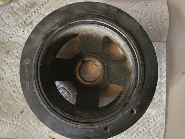

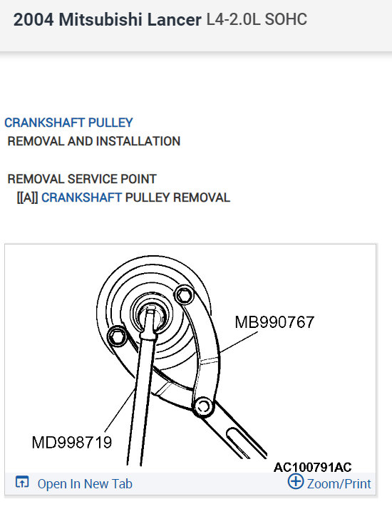

Had a heck of a time trying to remove the crankshaft pulley. In the process I damaged the lower timing belt cover. I think I can fix that. Before I remove the timing belt itself, what direction do I turn everything to get to TDC? Clockwise, counterclockwise? And where are the marks to align the crankshaft? I found the one for the camshaft.
