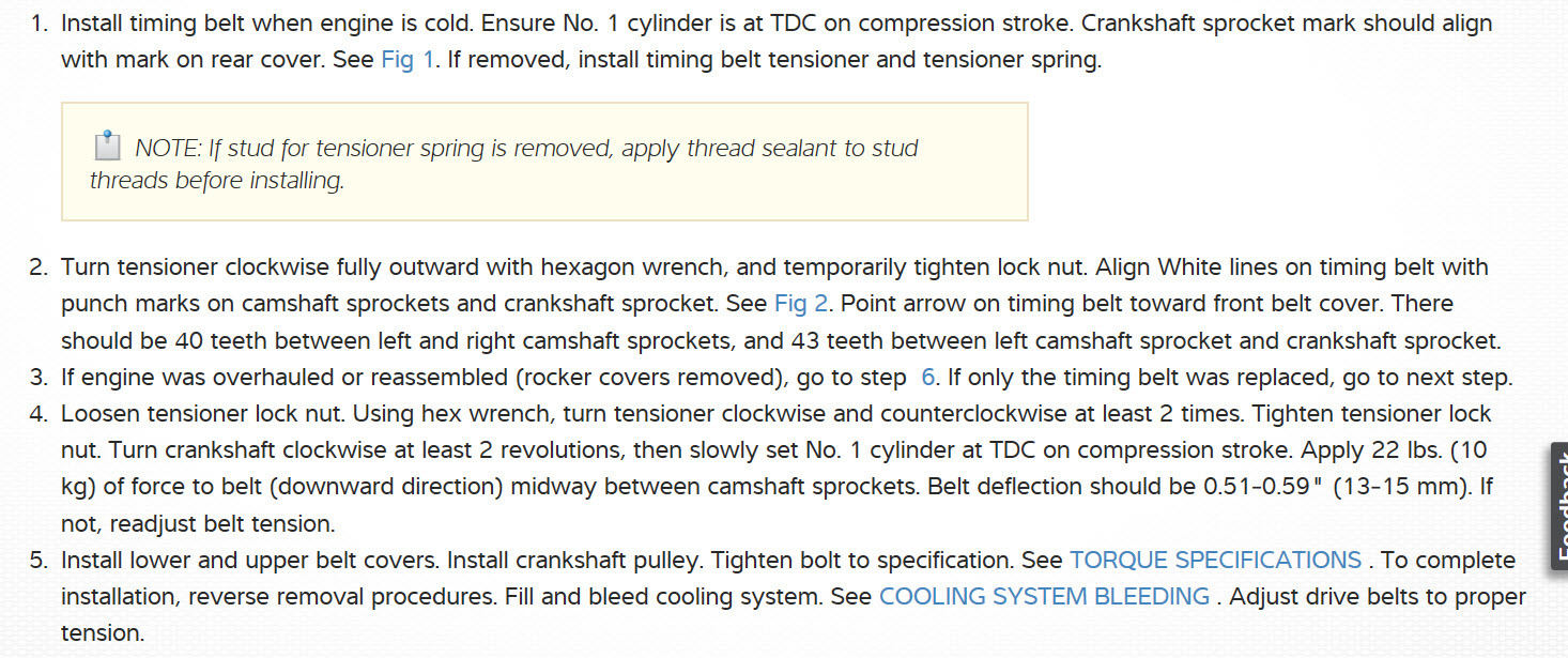

Timing belt broke and wanted to know if the right timing is the marker on the block match themarker on the gears also if you could give me from start to finish instructions on how to time it

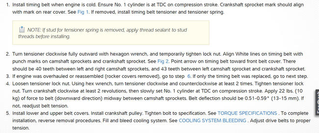

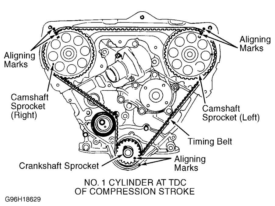

make sure to read all instructions along with pics. if car starts and it misfires it may be bent valves as this is an interference engine. Check out the diagrams (Below). Please let us know if you need anything else to get the problem fixed.

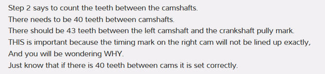

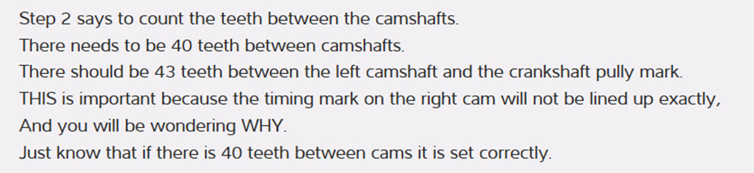

I have been struggling with P0030 code (multiple cylinder misfire) and have replaced literally everything.
Finally removed front of engine, put crankshaft at Top Dead Center, one camshaft pulley the timing marks lined up perfectly , the other would line up if I moved the crankshaft to 15 degrees before Top Dead Center was exactly one tooth, so I fixed that and it runs way worse.
Took it apart again, rotated the crankshaft and all marks line up perfectly.
The camshaft that was off was not for cylinder number one.
Do I need to re-time the engine anyways?

Good afternoon,
I would start by checking the compression to be sure there is nothing internally wrong.
Was this present before the repair?
