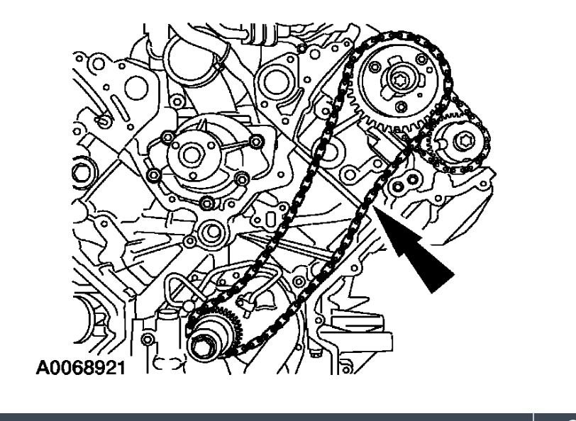

The timing belt skip time. Guy at shop say it would be better to replace engine than to do timing belt.

Good afternoon,
You have a timing chain.
Yes, this engine is what is called an interference engine. That would mean a very major repair.
https://www.2carpros.com/articles/how-a-timing-belt-works
It would be better to replace the engine with a good used engines.
Image (Click to enlarge)
