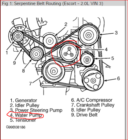

Got bolt out, how do I remove pulley to install new water pump?
Aug 21, 2018 at 7:50 PM
If it does not unbolt which it looks like from the picture it is pressed on from the factory just remove the bolts around the housing and the pump will come off. If I am off base here please send a picture or video of what you are talking about.
