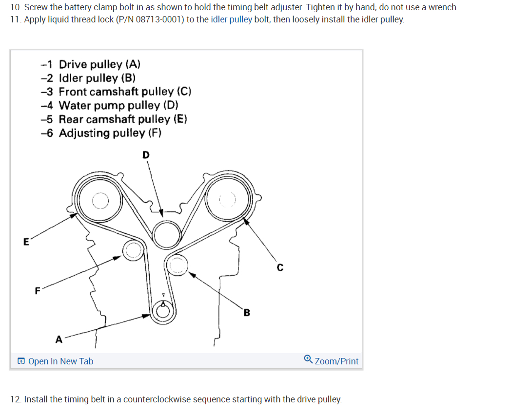

I changed the water pump that was leaking and went ahead and changed timing belt also set the timing marks. Now the car will run, but will not idle and runs rough. Need help
Jun 18, 2016 at 7:17 PM
JOHNNY G.JR
  • 320 POSTS

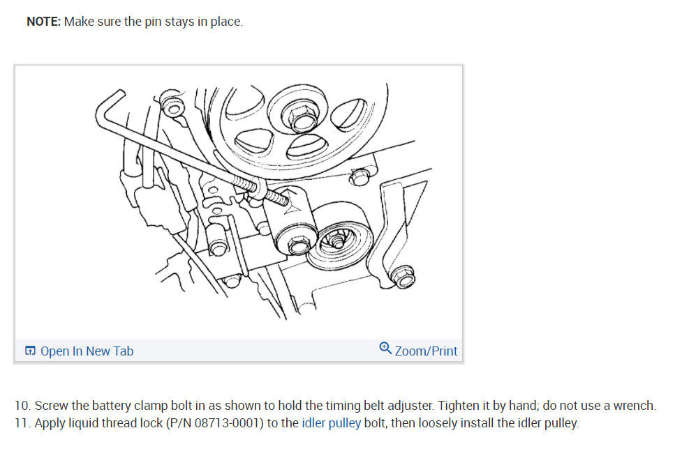

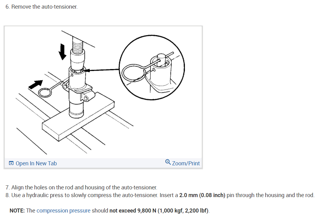

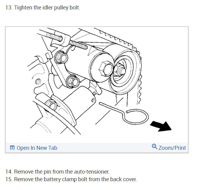

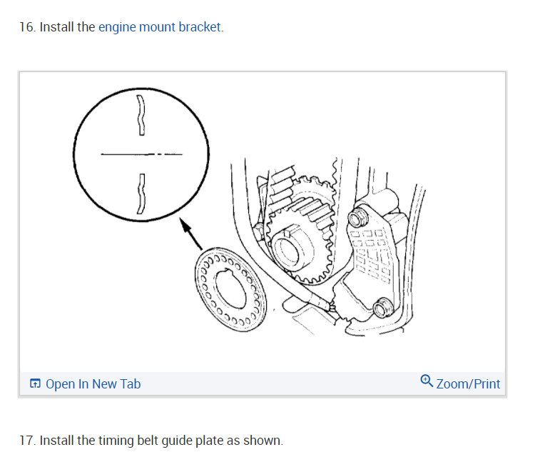

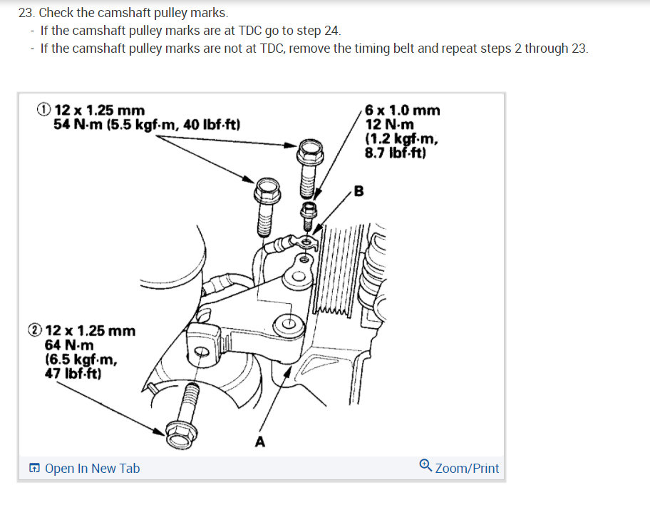

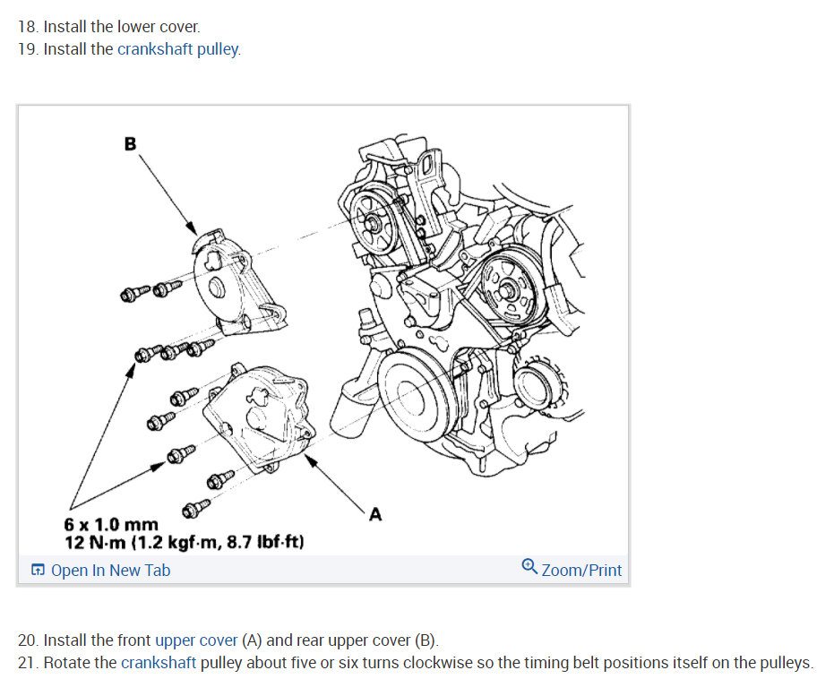

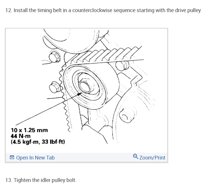

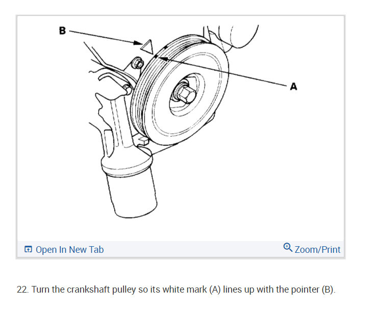

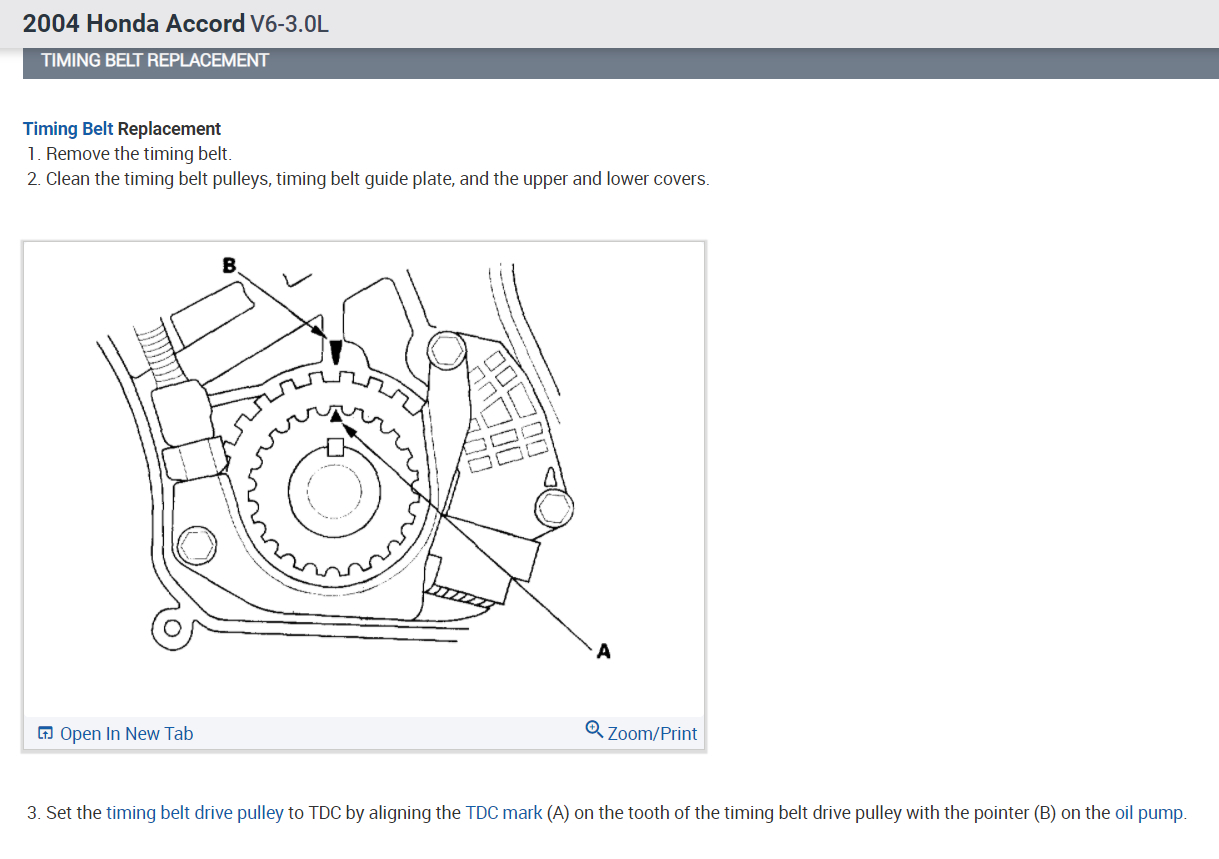

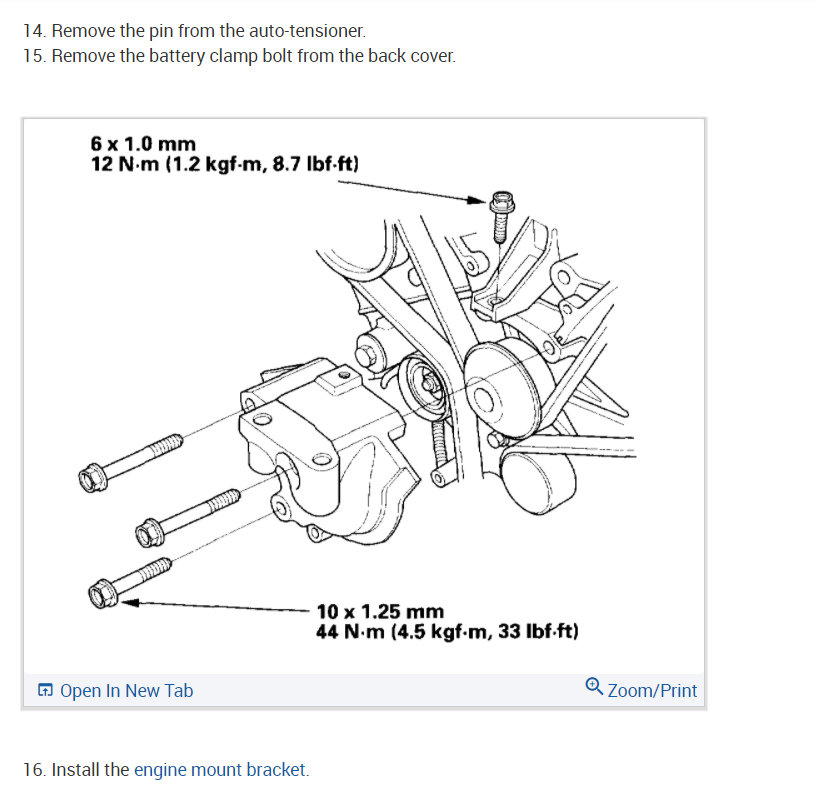

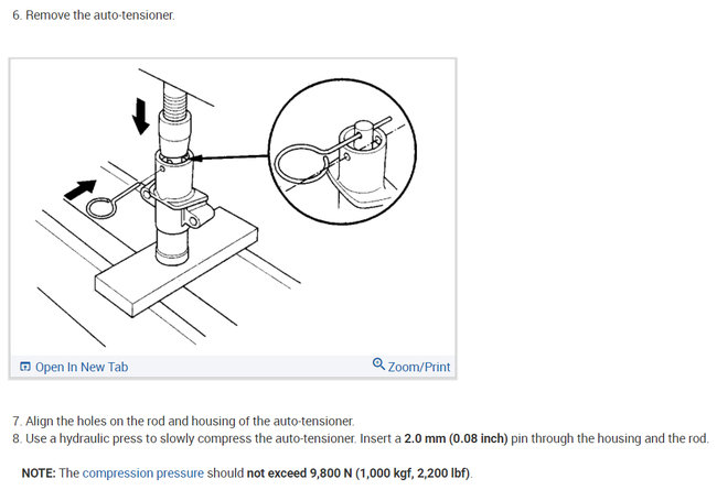

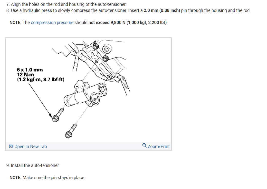

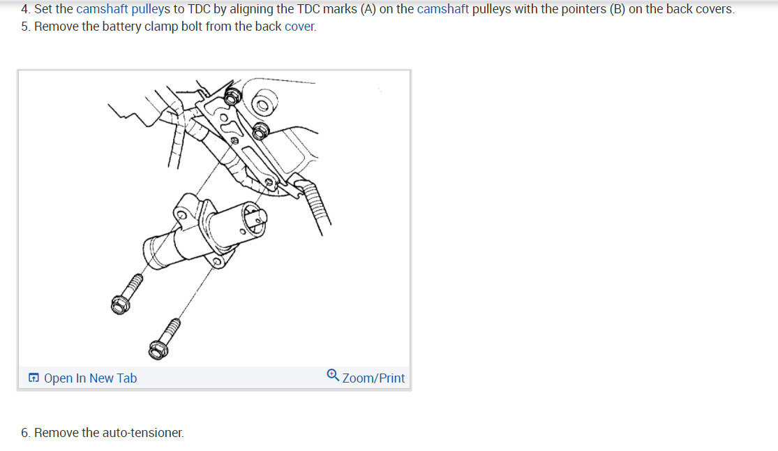

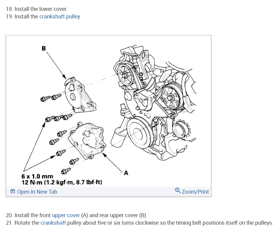

its very likely belt is one tooth off, when tension was applied on idler pulley cam pulley moved out of proper alignment. Here are instructions on how to replace the timing belt correctly. Here is a guide to help you step by step with instructions in the diagrams below to show you how on your car.
https://www.2carpros.com/diagrams/honda/accord/2004
Check out the diagrams (Below). Please let us know what happens.
Jun 18, 2016 at 7:48 PM
JOHNNY G.JR
  • 320 POSTS
alignment with crank pulley hope this helps ,i have had same problem years ago.

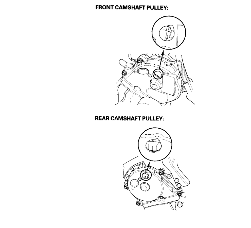

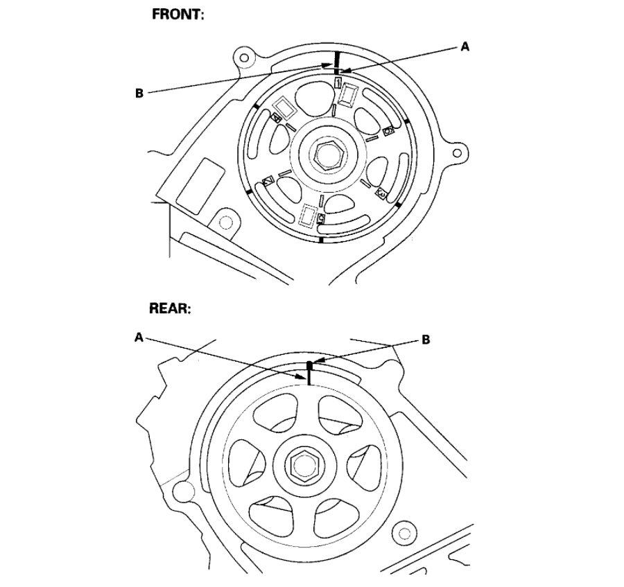

there was one issue I ran into on the front bank cam sprocket it did not have a timing mark like the rear bank and crank sprocket so that may be the issue.
Jun 19, 2016 at 4:29 AM
DIRTRCR610
  • 5 POSTS
the only thing I could find online was going off the number 1 stamped into the sprocket and not sure if that was right.
Jun 19, 2016 at 4:40 AM
WRENCHTECH
  • 20,761 POSTS
https://www.2carpros.com/images/external/103033472.gif
Jun 19, 2016 at 5:34 AM
DIRTRCR610
  • 5 POSTS

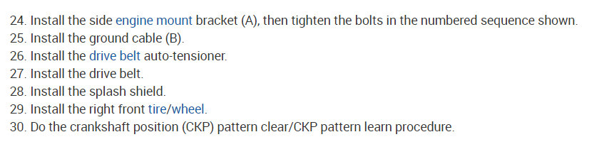

that is how I have it timed is there anything else I can do other than a compression test? I have a very low budget. lol, the manual said something about resetting the pcm idle.
