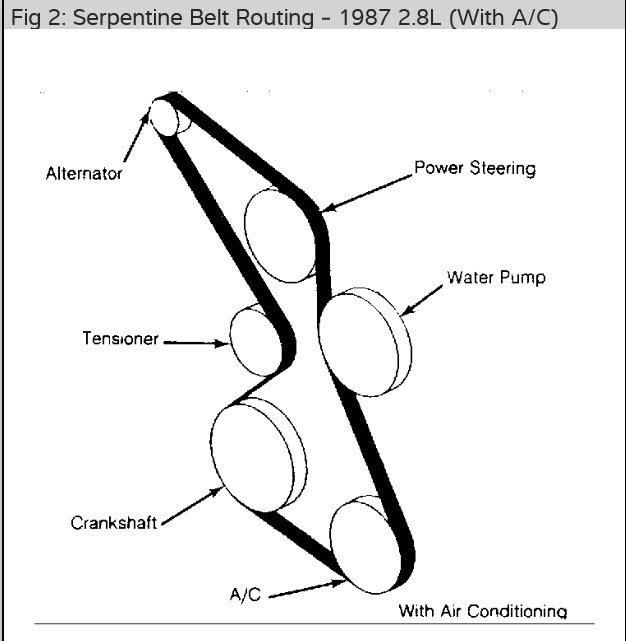

I lost my timing belt and I hope to know the size of it.
Jun 6, 2017 at 2:14 AM
HMAC300
CERTIFIED EXPERT
48,601 POSTS
it is the fan belt not timing belt. yours has a chain under timing cover front of engine.
