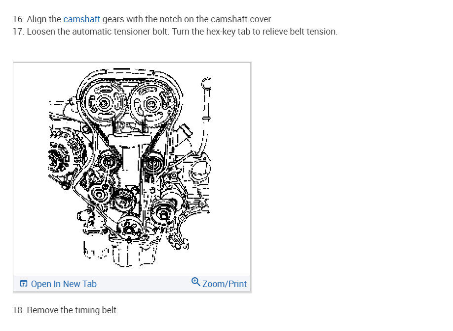

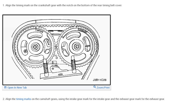

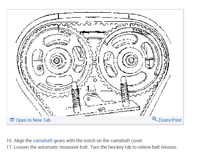

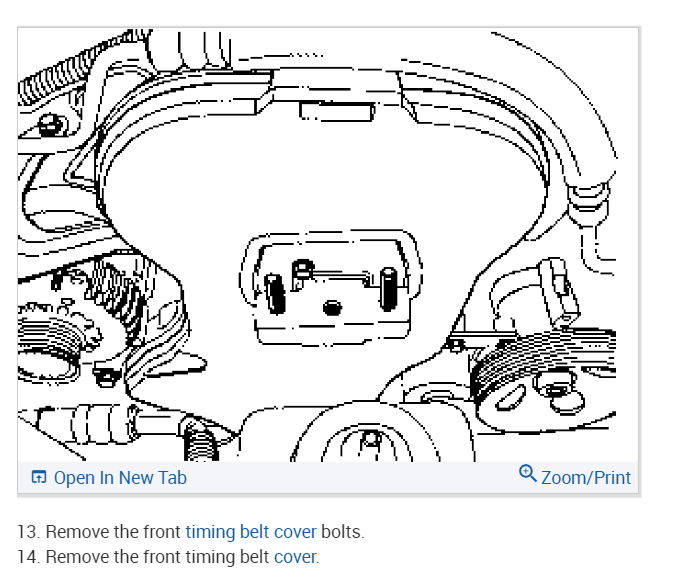

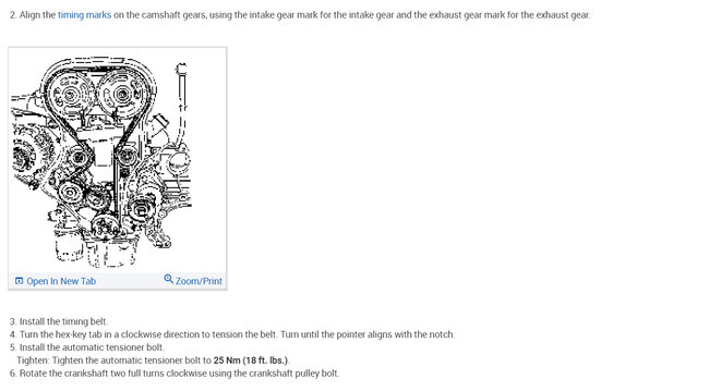

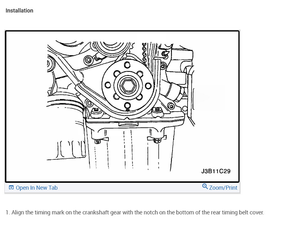

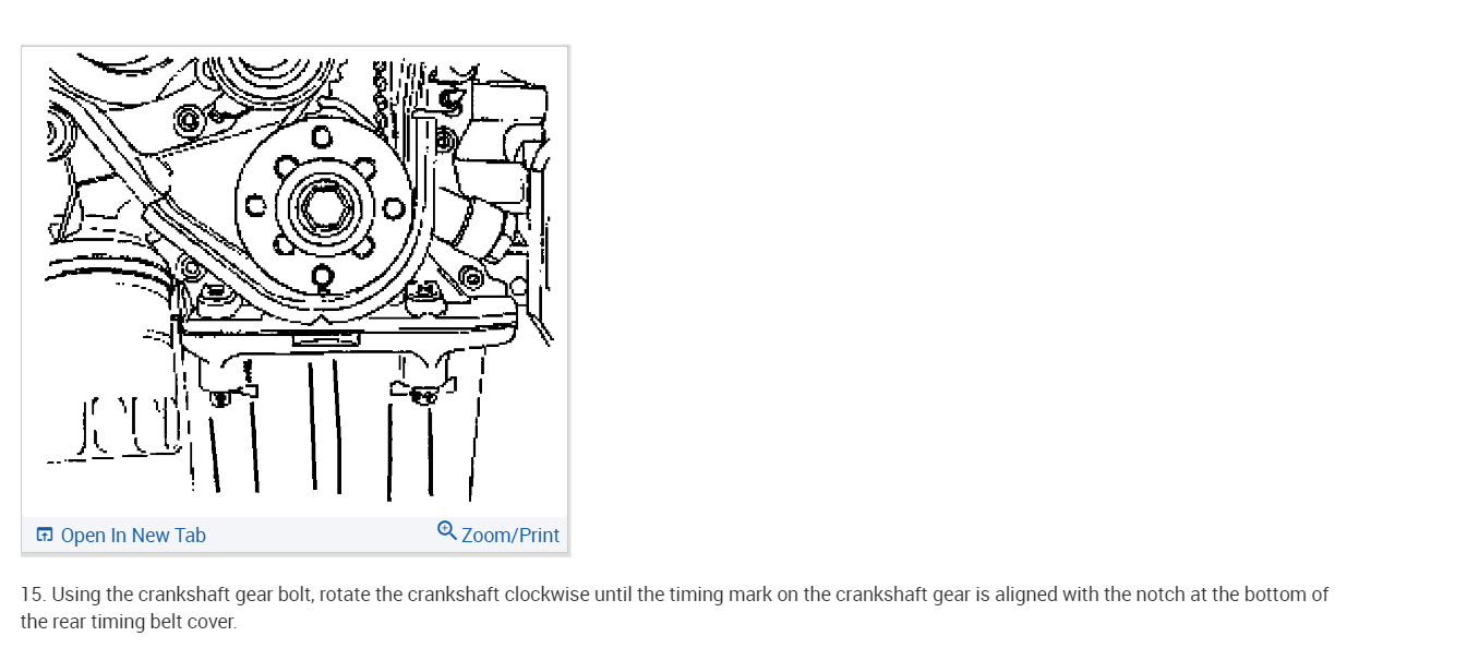

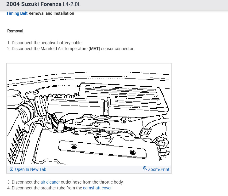

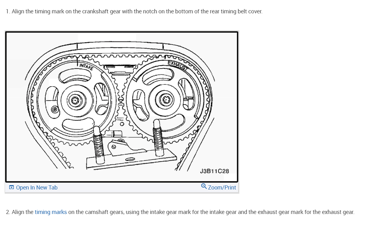

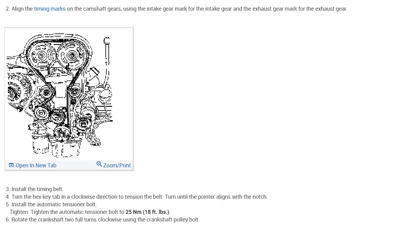

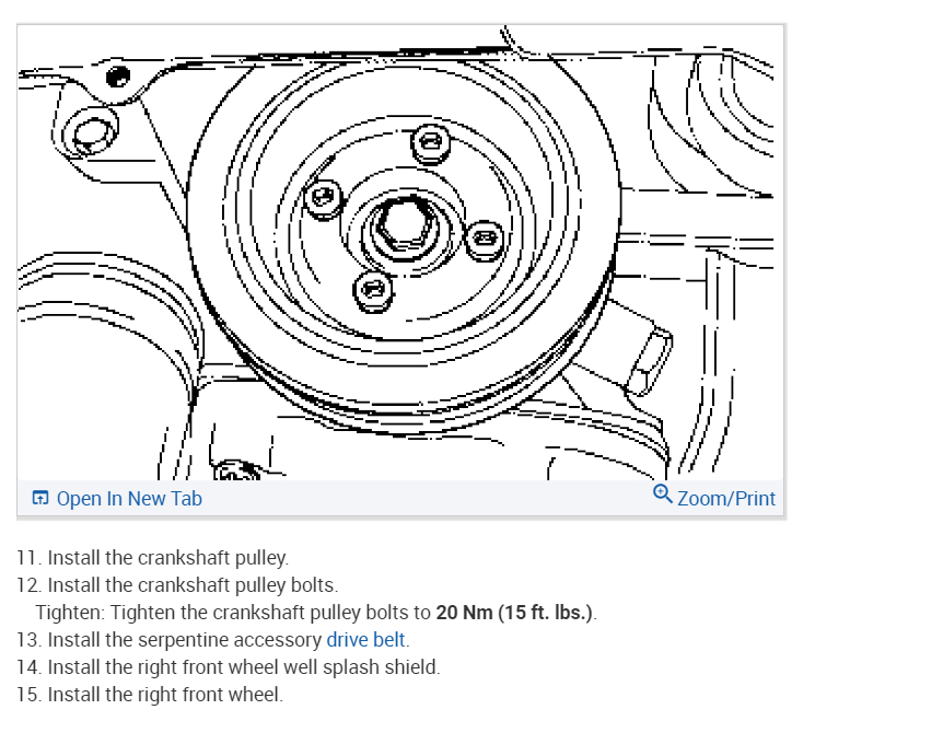

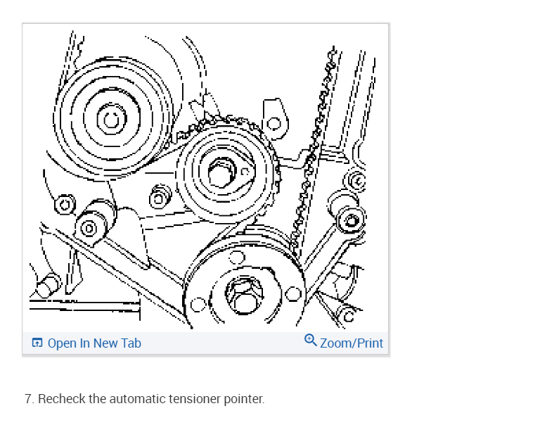

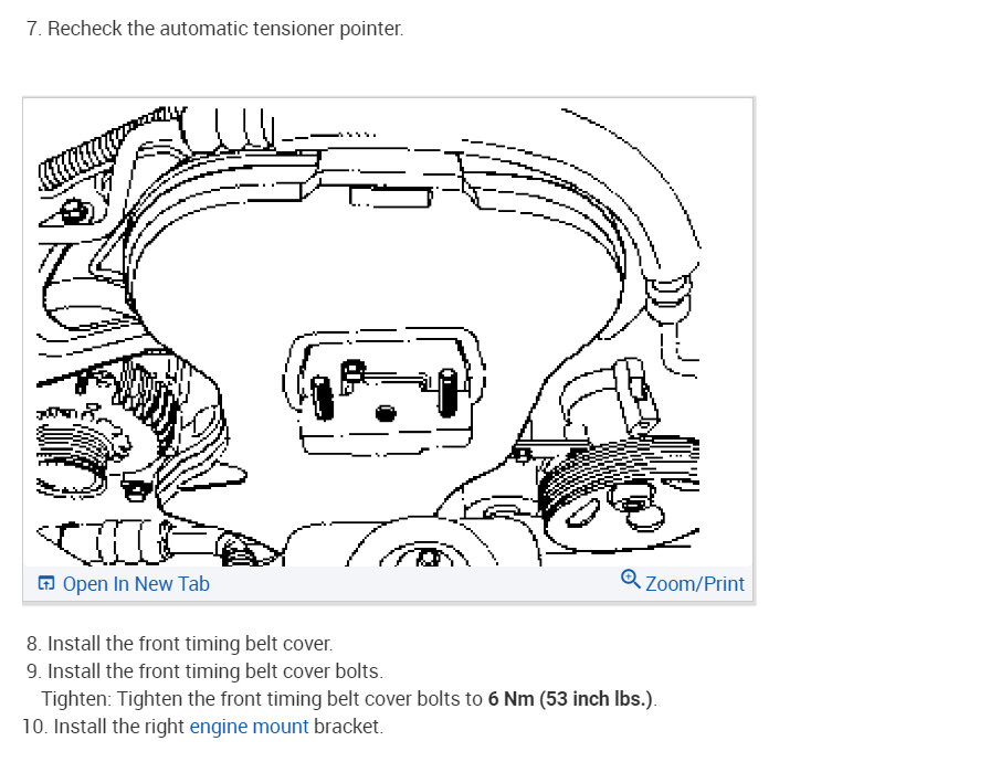

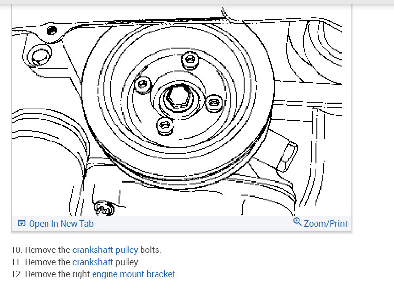

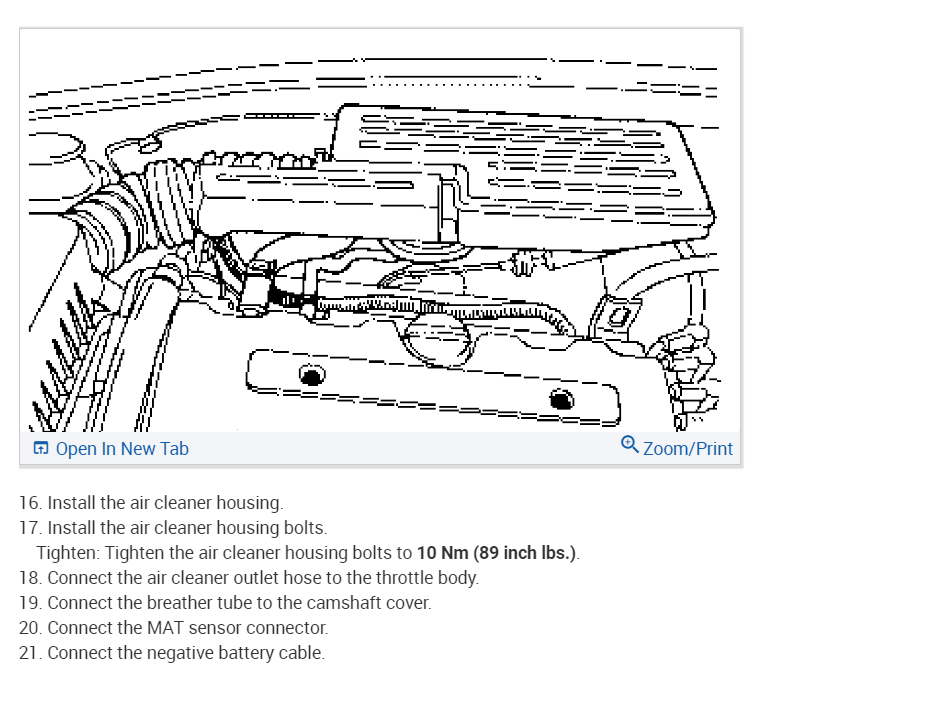

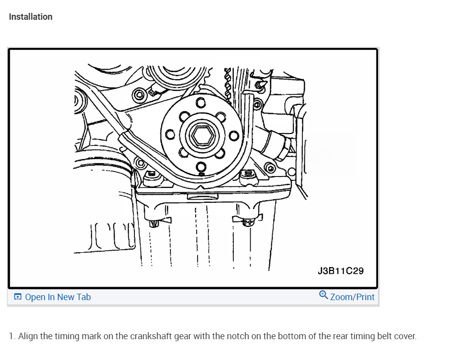

Nine times out of ten you will be okay. This is a non-interference engine but on rare occasions a valve can connect a piston. The only way to tell is replace the belt and see how the engine runs or do a leak down test by removing the valve cover and rotating the camshaft to shut the valve manually. Here are the instructions on how to change the timing belt in the images below. You will need to rent an electric impact gun and use a jack and a piece of wood to support the engine from the bottom. Please let me know how it goes.
