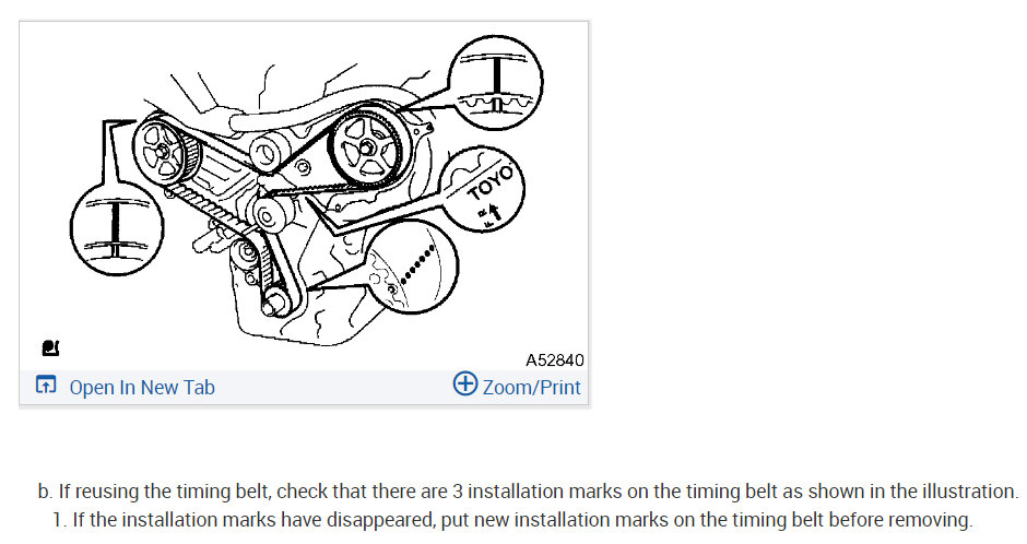

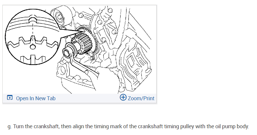

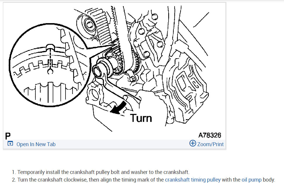

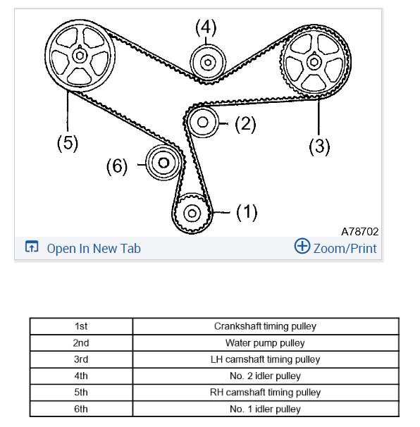

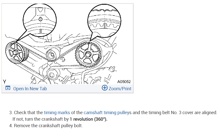

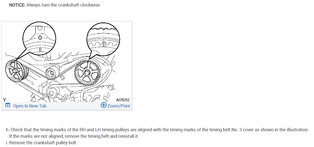

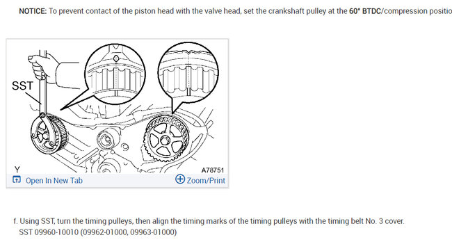

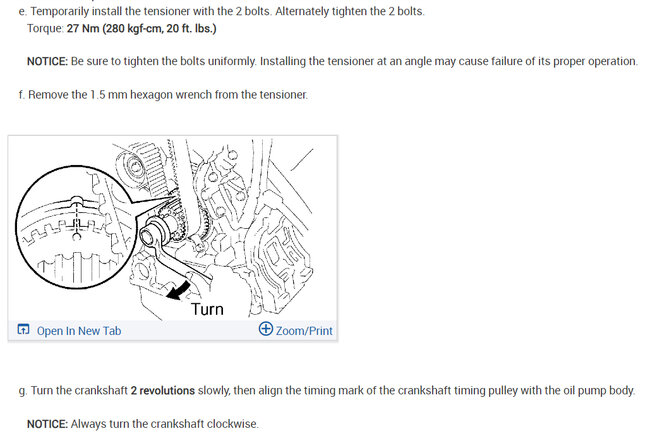

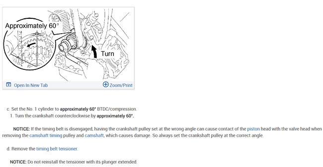

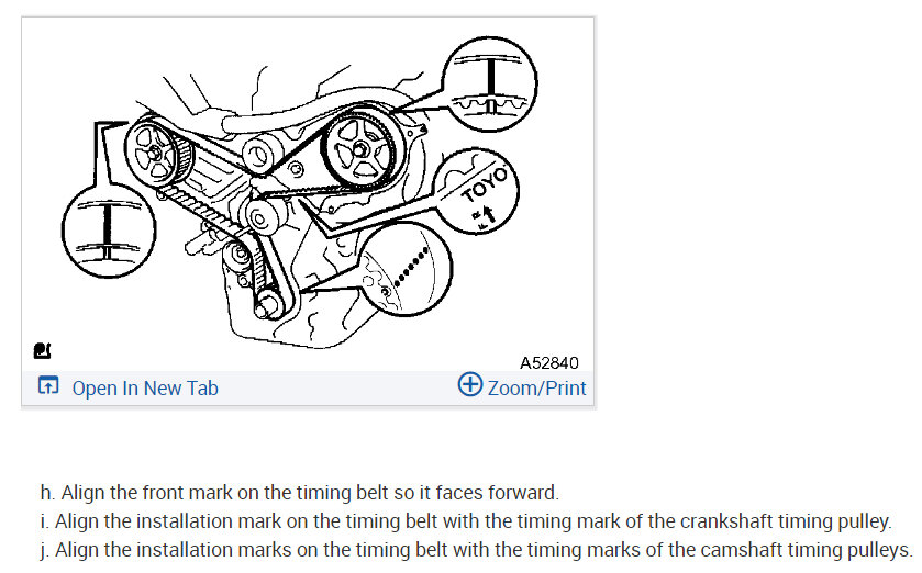

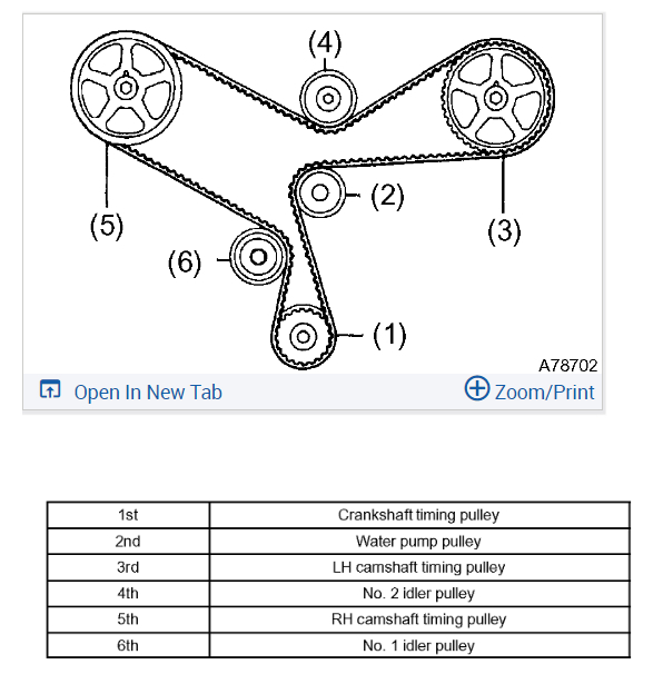

On both left (front) and right (rear) cams you will see a mark on the gear wheel in the shape of "I", this will line up with an arrow on the backing plate directly above it pointing down. The crank sprocket at the bottom will also have an arrow pointing upwards to match with an arrow stamped on the block pointing downwards.

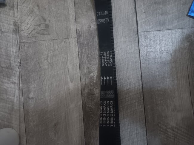

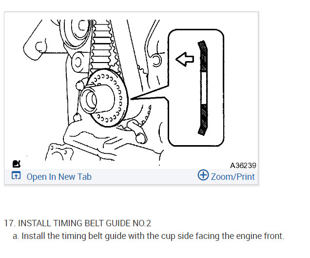

On the new timing belt there will be installation marks for each gear. Be sure the arrow on the belt is facing away from the car, not towards the engine. Match each line up with the line on the cams, and the crank sprocket will have a dot in the shape of "o" where the dotted line on the new belt will need to be installed.
